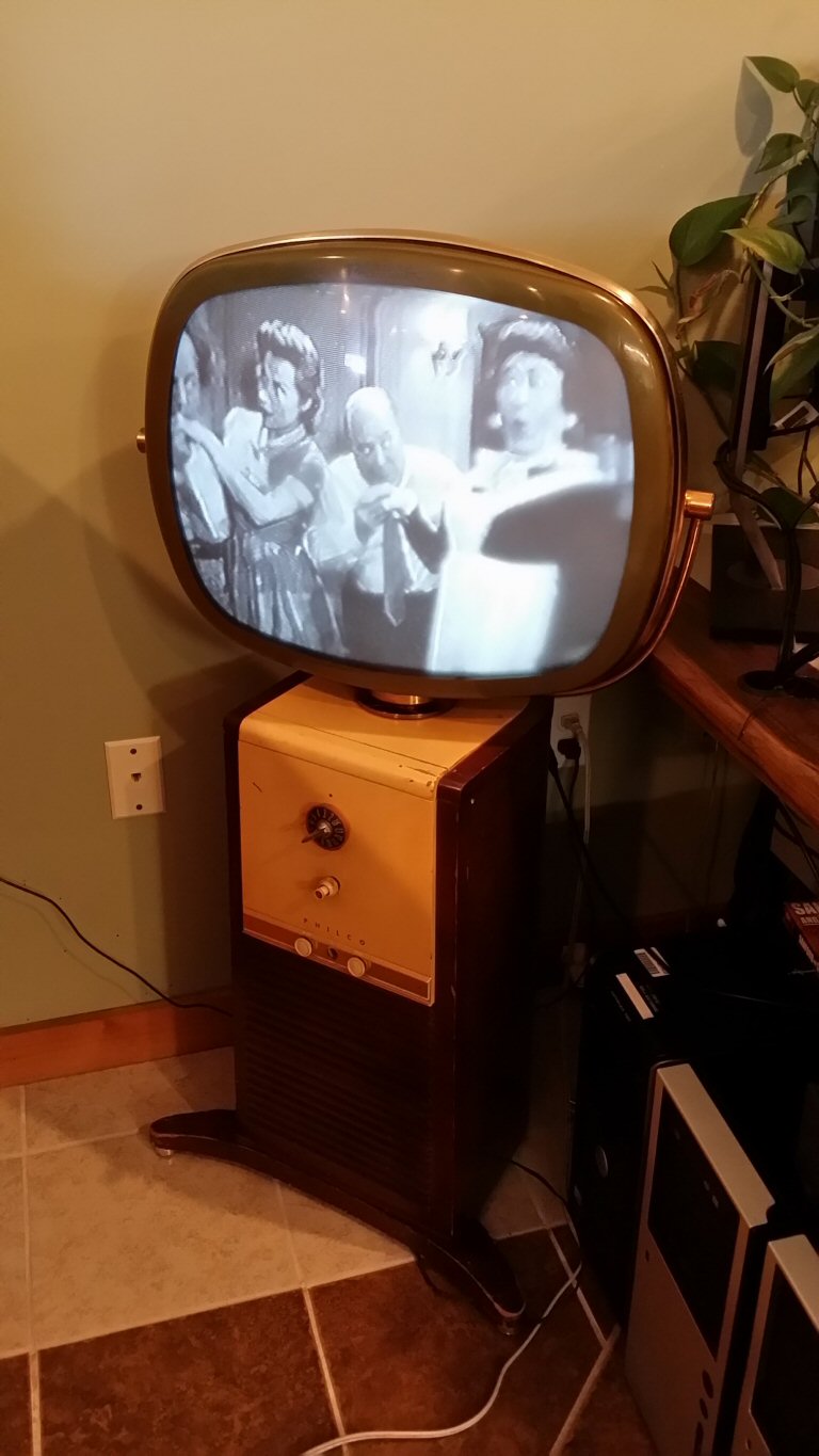

                Vacuum tube sets not forgotten. Today, my Sencore CR31A CRT rejuvenator has seen the light of day for the first time in ~20yrs, reviving a 21FDP4 in a 21" Predicta I was pretty much given a couple years ago.
                It took me a while to refresh myself with the instrument....but like back in the service center days, she never let me down!
                A near zero emission CRT (very dark) came right back to life!!
                YAY for bumping a very old thread!!
                    Oh, who cares!
                    This restoration is absolutely awesome! My hat off to you, seriously.
