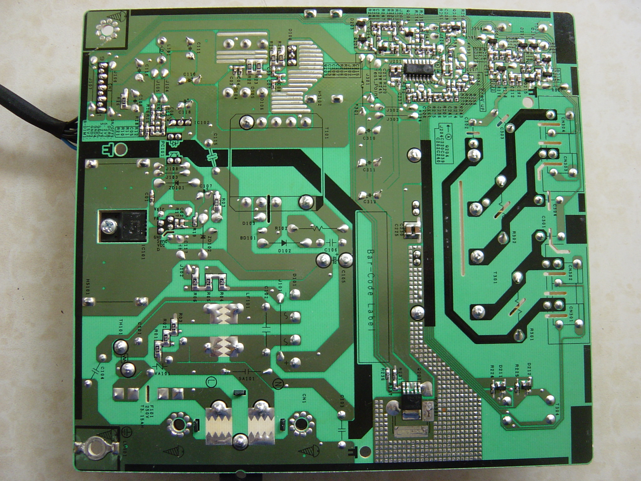

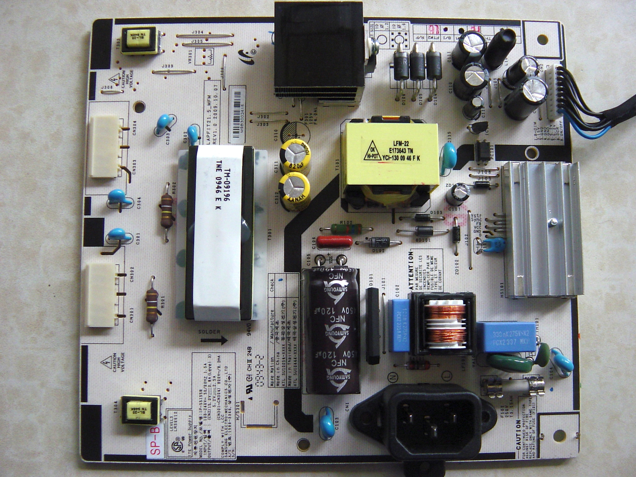

    Hi Guys,
    I've searched for info on this model, but there doesn't seem to be much... even here!
    I've repaired a couple of LCD monitors before, but the history of this one is unknown. All I know is that it doesn't power on.
    I've attached pics of the power board, which is marked with model number IP-55155B.

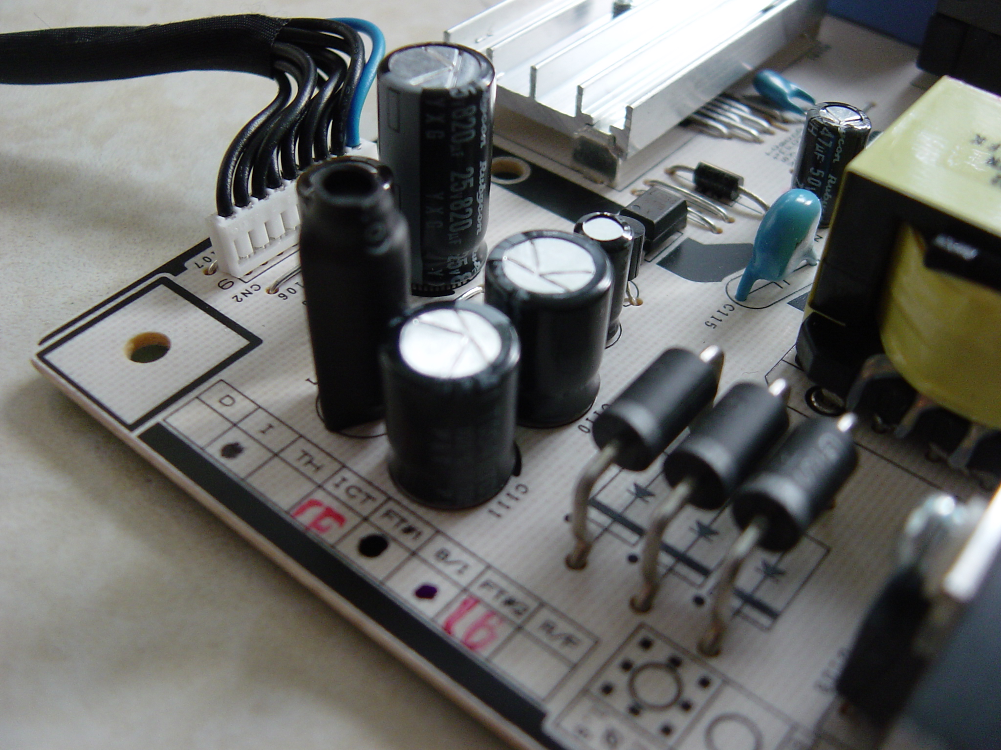

    I think that I might be imagining it, but the side of the cap C110 might be bulging ever so slightly, although it doesn't look like it in the pic. Is this likely to be the problem? [It's a 1000uf 10v 105c Rubycon ZLH]
    Thanks in advance for any help.

      So there is no DC output at all, I.E. 5V? What DC voltage do you get on that large filter cap in the primary side?

              Well, I've finally got back to this.
              The large cap sparked with a loud crack, when I accidentally discharged it. I guess it's OK!
              I also replaced the 2 ZLH 10v 1000uF caps at C110 AND C111.
              Still no signs of life, so what should I test next, please? [I don't have an ESR meter]

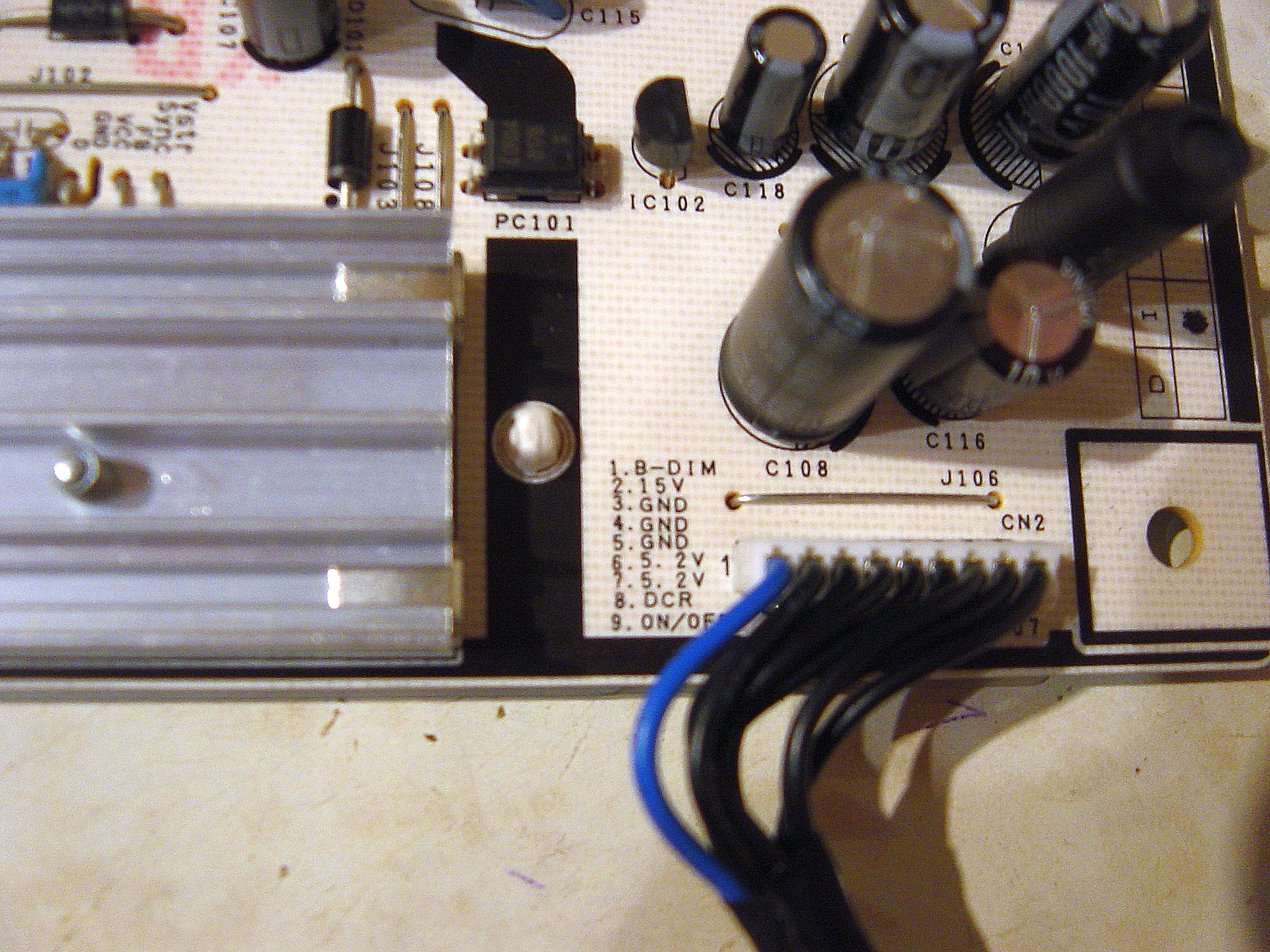

                can you give us a close up picture of the connectors on the PSU please
                    These connectors?

                      Can you go across those pins from 1 to 9 and check voltages...
                      Also follow budm's advice

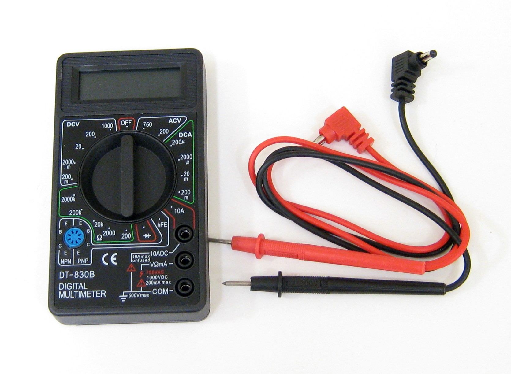

                        BTW, what setting should I use on my DT830B multimeter, to safely discharge that big cap?

                          I just use a 12Kohm resistor across the contacts
                          Never done it with a multimeter but sure its possible, someone will confirm this

                            OK, this morning, I have desoldered one pin of F301, powered up the board, and taken the following voltage readings...
                            The big cap reads 336v
                            F301 disconnected [if I'm testing it correctly] 0.0 to 0.01 on setting 20 DCV
                            The voltages across the the connector pins...
                            1 [B-DIM] 0.0
                            2 [15V] 13.5 to 14.5 unstable
                            3 GND
                            4 GND
                            5 GND
                            6 [5.2V] 5.0 to 5.2 unstable
                            7 [5.2V] 5.0 to 5.2 unstable
                            8 [DCR] 0.0
                            9 [ON/OFF] 0.0
