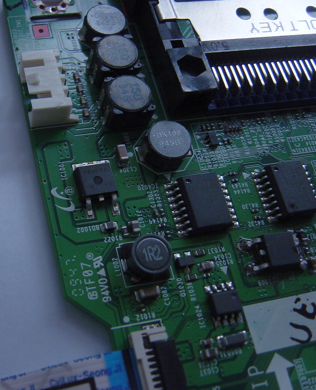

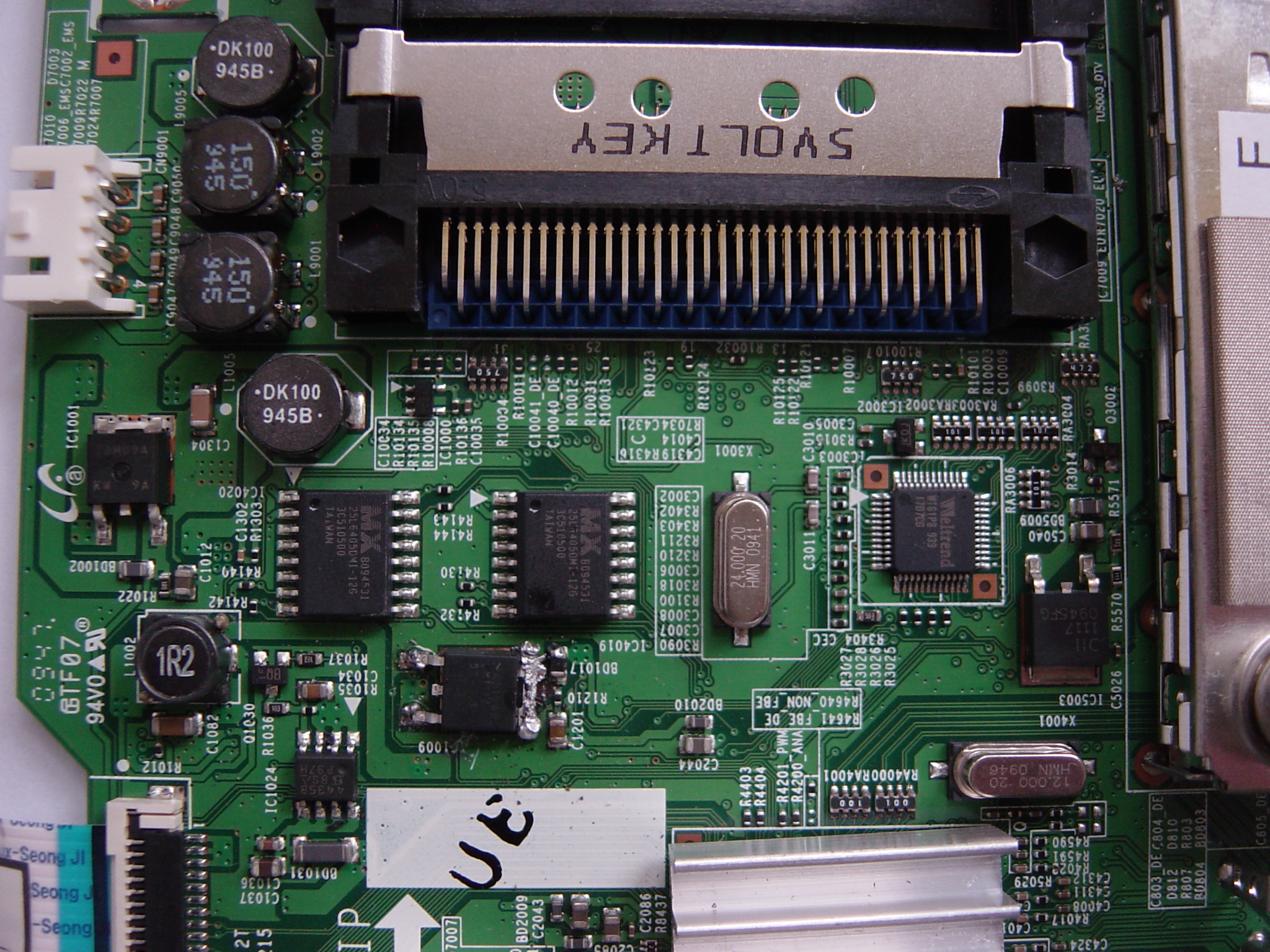

                                #75
                                Re: Samsung SyncMaster LD220HD HDTV/Monitor - no power on
                                There's not a lot of daylight here [foggy], but here's some more pics...
                                I just noticed that there's also "J66" in the centre circle of IC 78M09A at IC1001.
                                • selldoor
                                  Slow Learner
                                  • Dec 2010
                                  • 7870

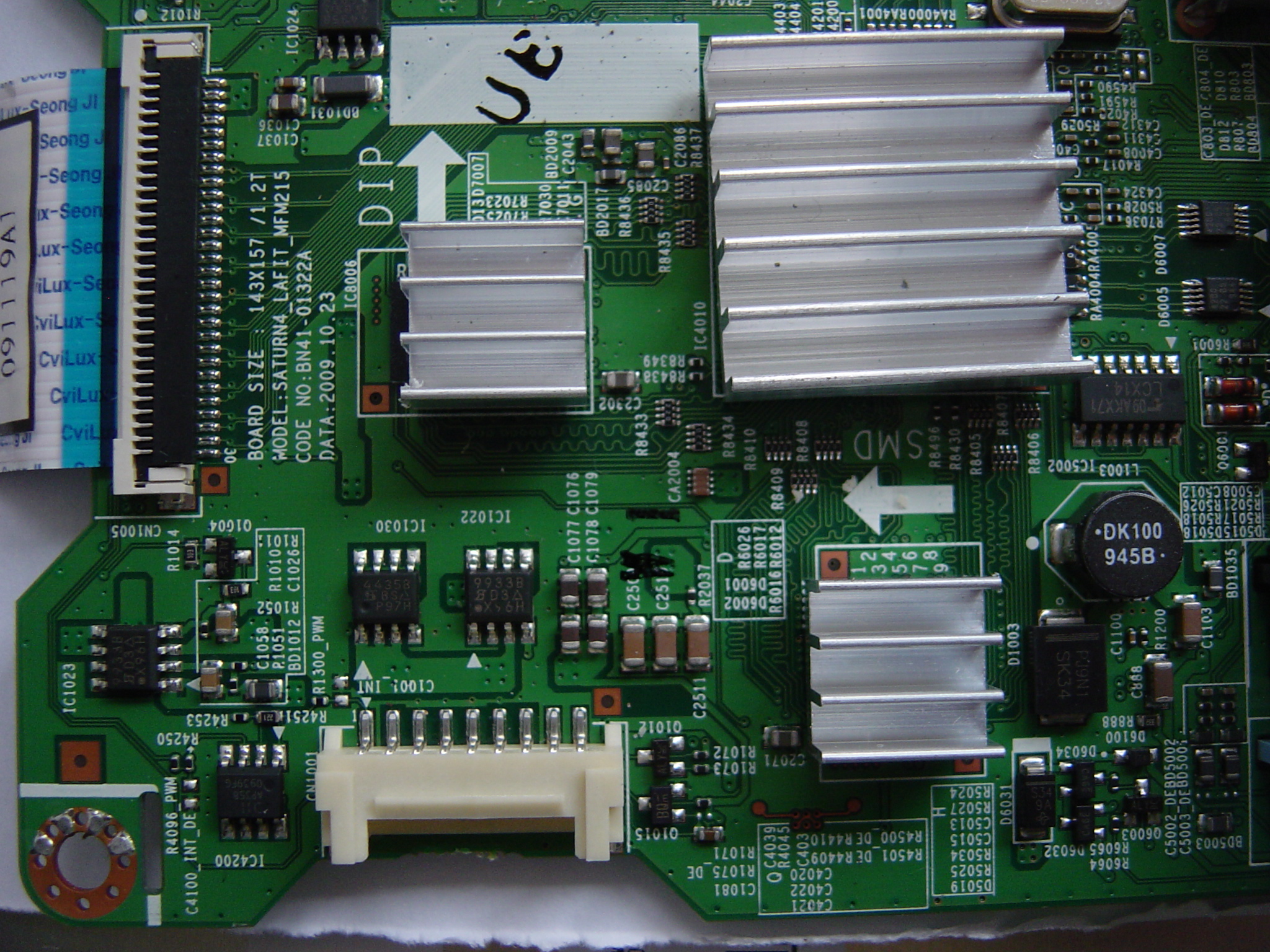

                                  #76
                                  Hmm - Im slipping!!
                                  The first one IS a 78M09A dont know how I didnt find it.
                                  Here is the data sheet
                                  http://www.alldatasheet.net/datashee.../L78M09AB.html
                                  Should be 9Volts !! Will have to think about that.
                                  • oddbodd
                                    • Mar 2013
                                    • 121
                                    #77
                                    Is this L78M05ABDT-TR a suitable replacement, do you think?
                                    • selldoor
                                      Slow Learner
                                      • Dec 2010
                                      • 7870
                                      #78
                                      Not sure why you would think that - are you looking at the datasheets
                                      the 09 in the 78M09A iindicates it is 9v fixed output
                                      the 05 in the L78M05ABDT-TR indicates it is 5v fixed output
                                      We dont of course know that it is faulty maybe just not getting voltage in.
                                      the 0 0 0 test result suggests that might be the case.
