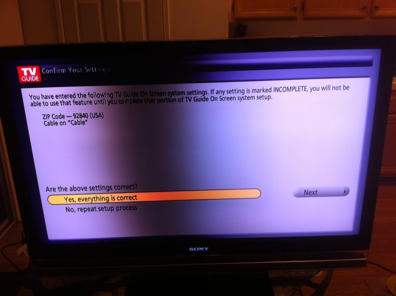

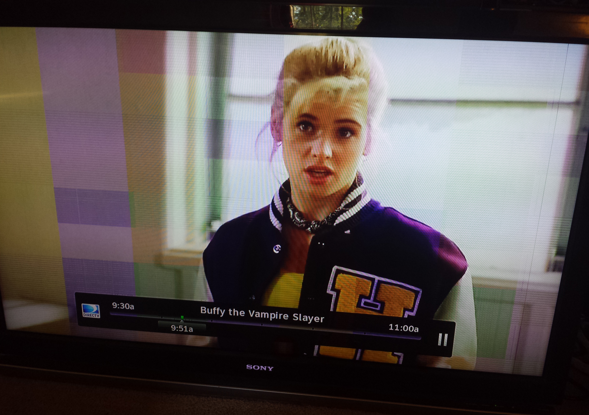

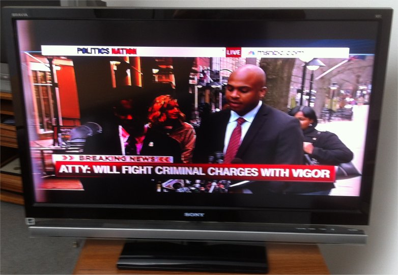

I'm thinking this is a bad panel. Just want to be sure before I scrap it out.
Sony Bravia XBR KDL-52XBR6 - Bad Panel?
Re: Sony Bravia XBR KDL-52XBR6 - Bad Panel?
It looks more like bad video processor, possibly FRC fault. I would not immediately call bad panel, but the single pixel vertical line on the right is worrying me. Is that always there?Please do not PM me with questions! Questions via PM will not be answered. Post on the forums instead!
The line might be a panel issue... but the other colour issues I don't think are.Please do not PM me with questions! Questions via PM will not be answered. Post on the forums instead!
Sorry to bring back a zombie thread...don't seem to be able to post a new thread to this area for some reason, even though I've had a badcaps login for years and years!
Anyway, a couple of days back I saw the Geek Squad guy at the Best Buy next door start putting detritus from his installs into the dumpster, including a LCD TV (which he obligingly left by the side of it). Once he'd vacated the area, I went to take a look only to find a rather nice looking 40" Sony XBR6. I knew there was a good chance of something being wrong with it (I mean, who would throw out a perfectly good TV?), but I decided to drag it back over to my office and take a look. Turning it on, I found what I thought at first glance might be a bad T-con board, but after doing some research over the weekend I now think it might be at least one bad tab bond (though applying pressure to the top of the surround does nothing to change the presented image).
I find myself left at a bit of a crossroads with it. I could tear it apart and try the temporary tab bond fix you can find pretty readily via Google. But I don't know how long a fix like that might last, so I'd be disinclined to sell it on to someone, and I don't really need another TV of any description for our place. Or I could strip it and sell the parts on eBay - a good T-con board for these could bring $100 all by itself! Then maybe $40 for the stand; $25-30 for the power supply board; $60-70 for the video board, etc... I could end up getting some pretty good money out of it.
What do you guys think? Do you think I'm on the money with the tab bond prognosis? In many ways that would be better than a bad t-con board, since those appear to be hard to come by and quite expensive when one does happen to find one.
