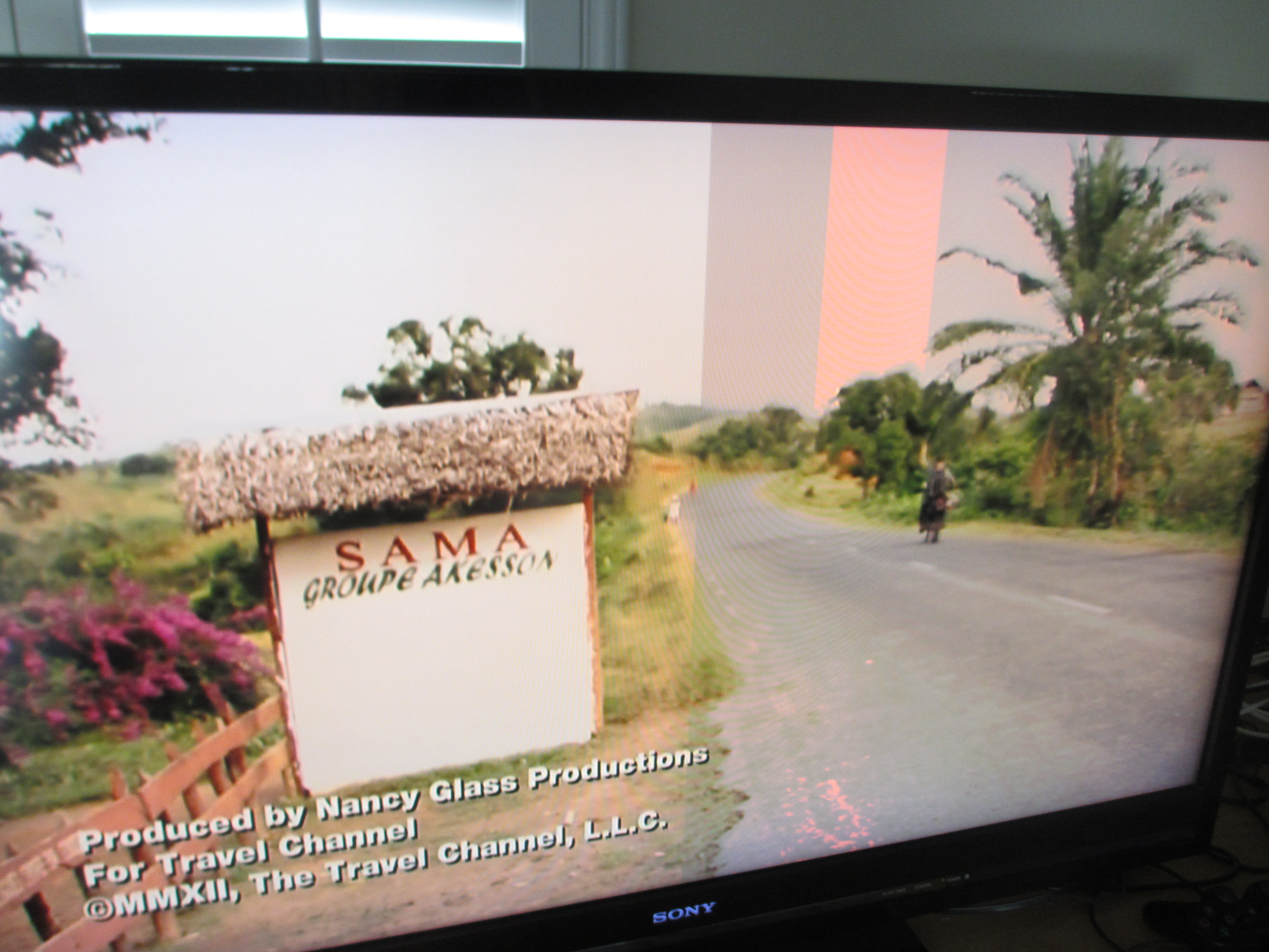

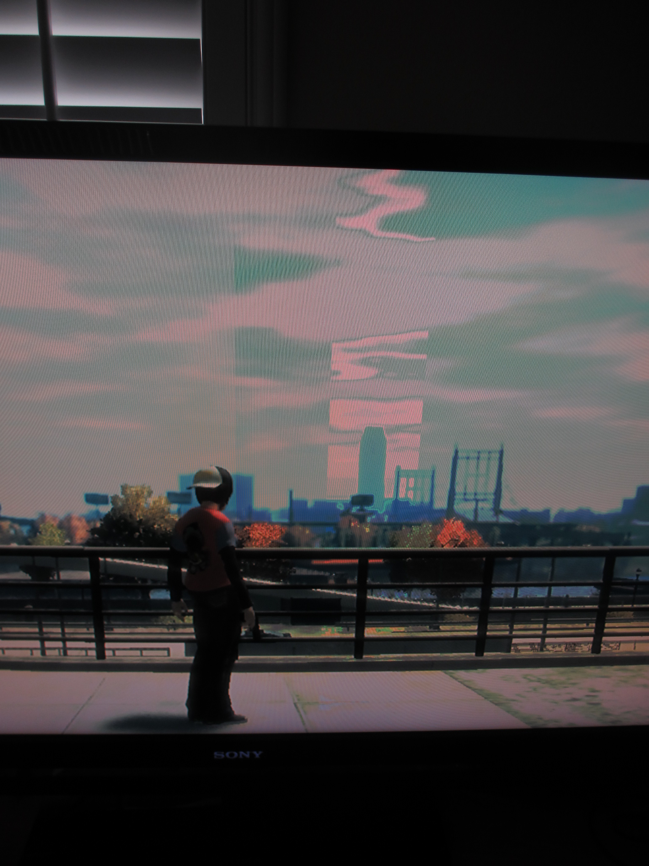

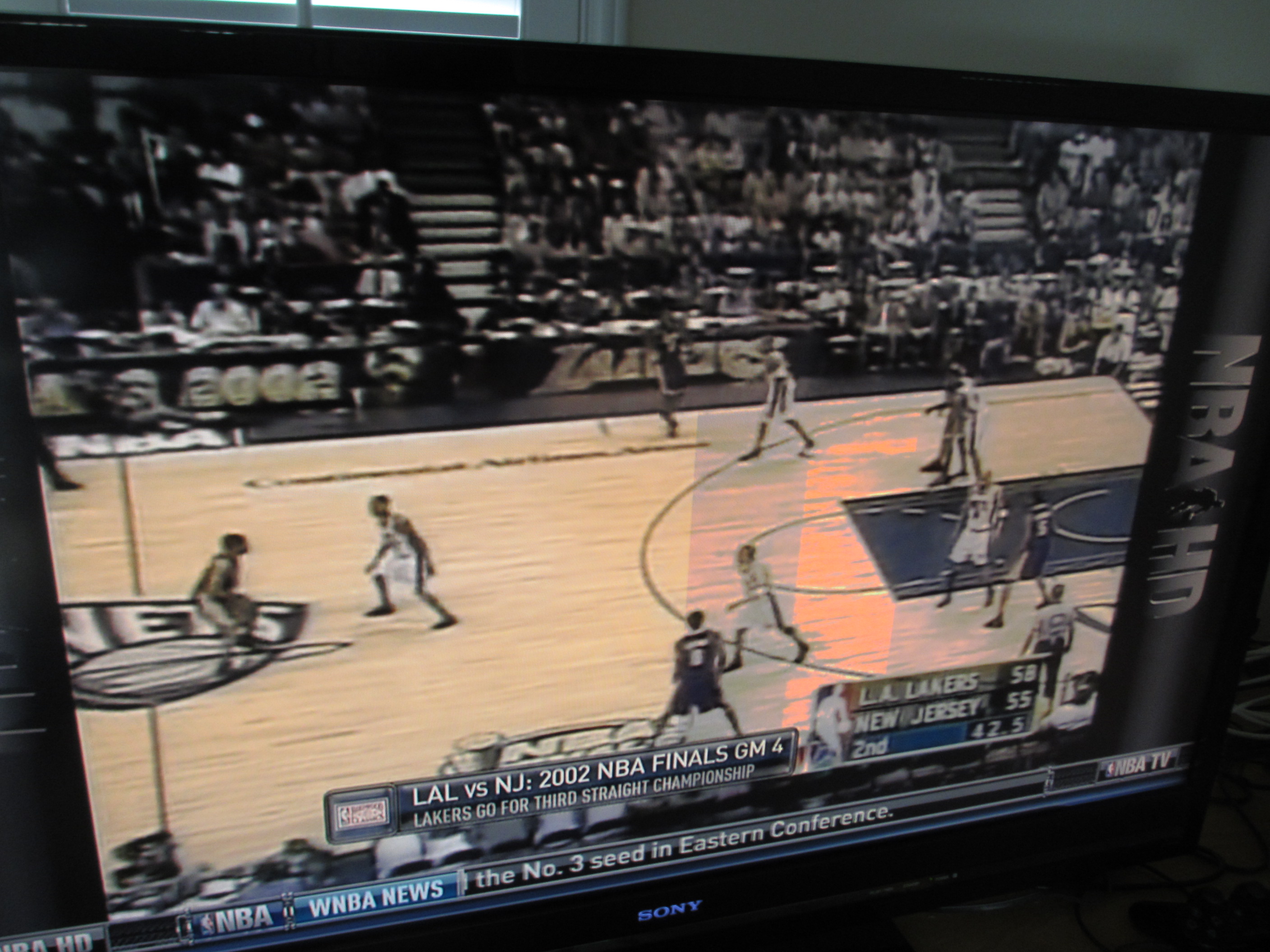

    Have a Sony LCD Model KDL-46Z4100 with approximately 2 abnormal 3 inch vertical bars around right of center. You'll also see the screen to the right of these vertical bars are darker than the left side of the LCD. The unit is about 5 years old and no issue since purchased new. Bars stay on 24X7 without any changes due to temperature or duration of using the TV. Noticed these bars are only visible if the screen has a lighter background and are completely unnoticeable when background is black or certain darker colors. Basic service diagnostics show good with about 4,000 hrs on unit. I have not seen any example of this posted online. Have you seen this before?

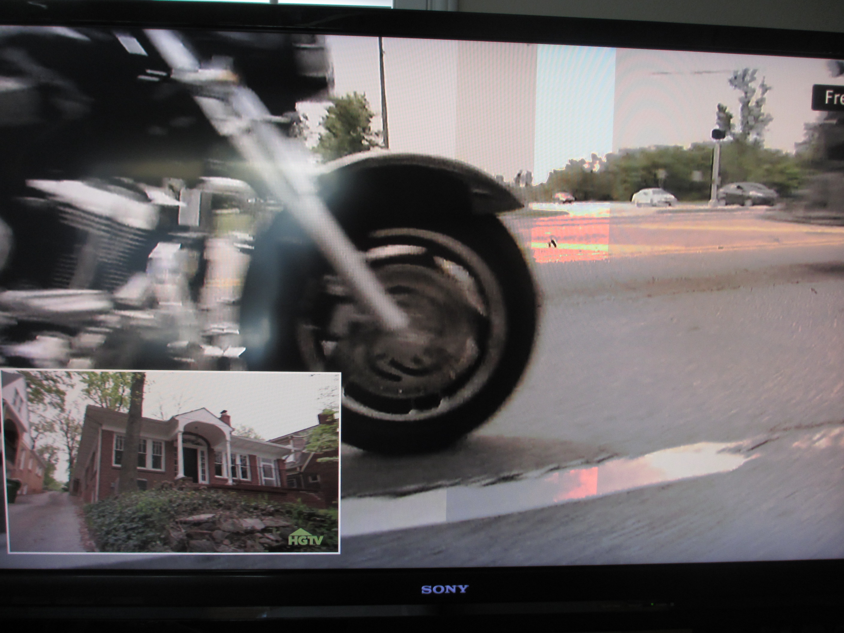

            Tom66. Thanks for the clarification on the t-con not affecting the Ethernet port. Would like to clarify my findings. The right half of the screen is darker than the left. There is a lighter colored bar (reddish/yellowish) which is 3" in width that runs vertically from top to bottom that displays on top of this darker area. This colored bar appears only when there is a lighter color behind it which is shown in the picture attachments.

              I have seen that effect with motion FRC failure, but I cannot be certain it is not a panel fault. Does this TV have 100/120Hz feature or similar?

                Now I'm getting somewhere. If I choose to "freeze" the picture, the abnormal dark area and discolored vertical bar displays on the right but a picture in picture appears on the bottom left. This PIP continues to display the current program without any display abnormalities. This means the system is rendering the video properly but only on the left.
                Does this indicate a failed panel on the right?
                  Re: Vertical Bars - Tab or T-Con?
                  It indicates -either- a panel or t-con fault, and in my opinion by looking at the noise it is most likely t-con.
