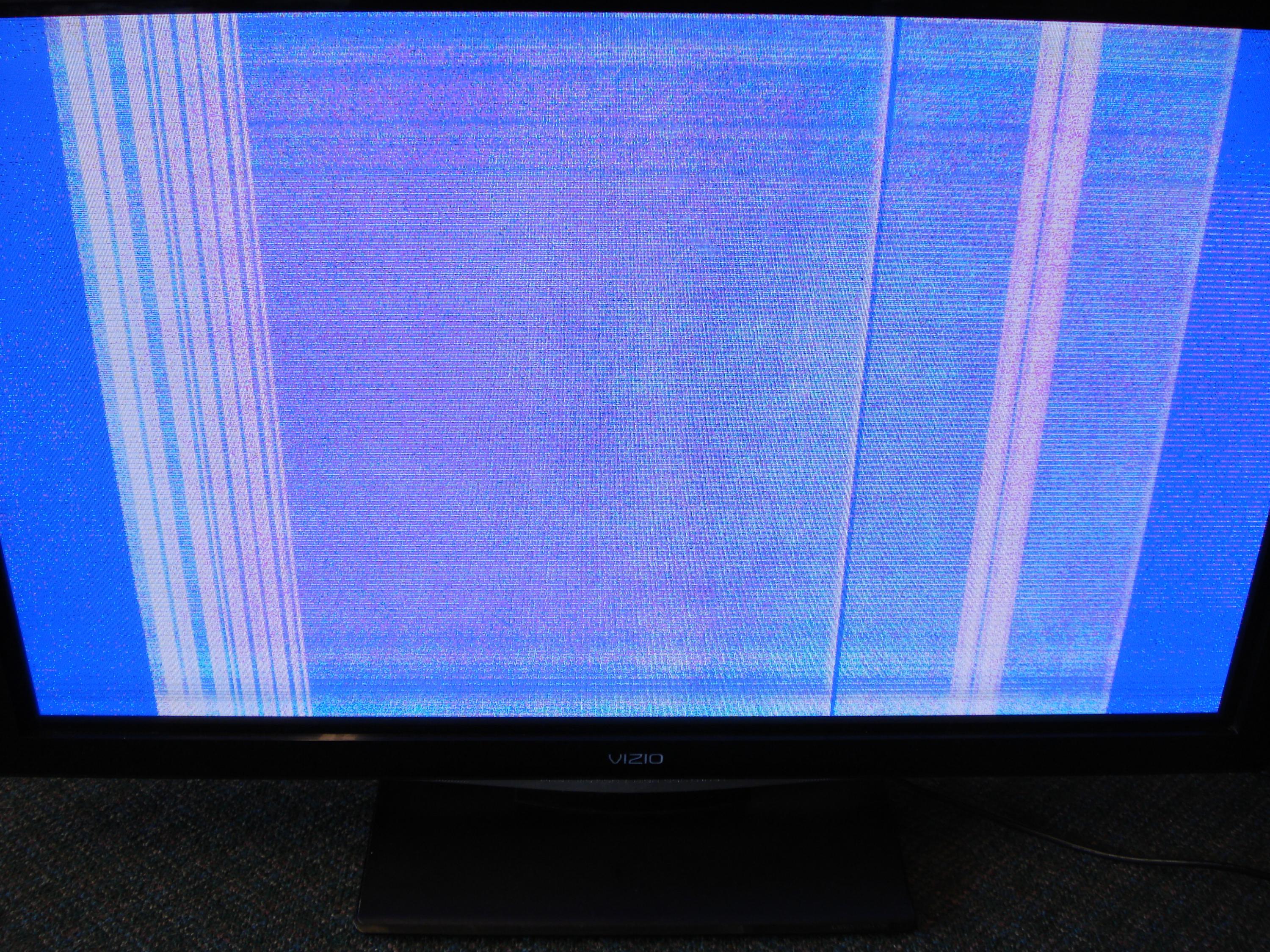

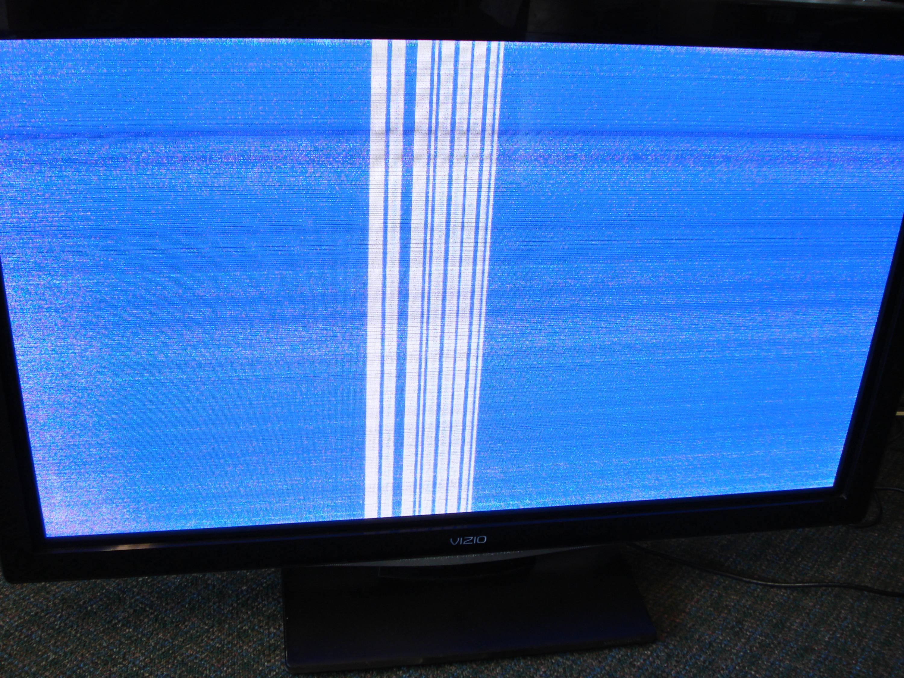

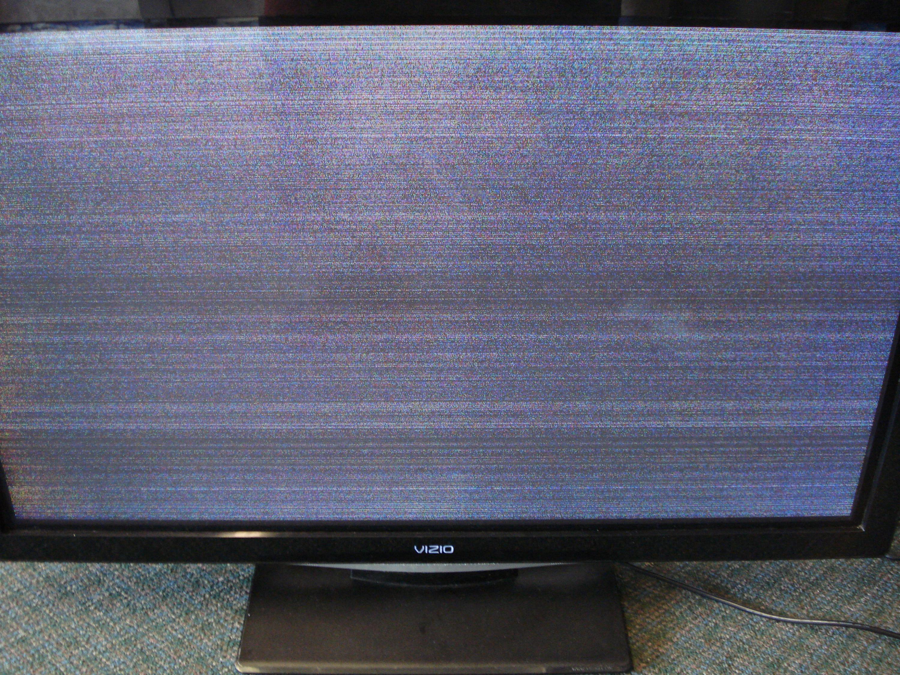

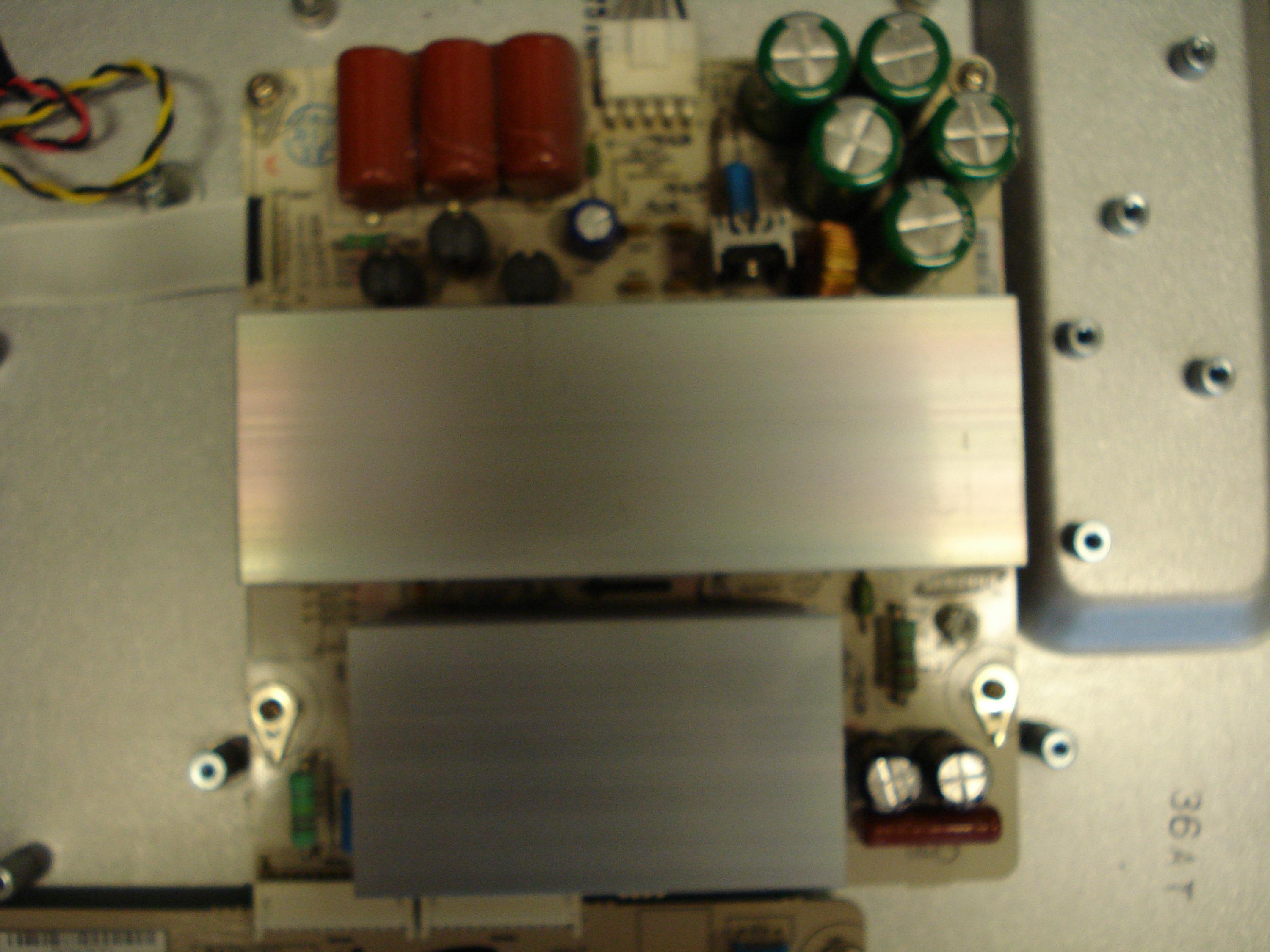

    I got a couple of pictures to show you. TV change from number one picture
    to number 3 piture in a couple of seconds. It stays in picture 3. But vertical line shift right to left and then shift back to the right step by step.
    Please help me. I have the back cover opened. I can show you the pictures later.

    Re: VIZIO VP423 HDTV10A Samsung Line vertical and horizontal lines
    How do your capacitors look?

      A tough one but it looks like a t-con board problem.
          Ah yeah. Thought it was weird to have Vizio with Samsung LCD, very rare. Samsung PDP means test pattern can be initiated using 3-4 pin jumper usually to see if control board is the cause or if it is elsewhere. It looks more like buffer board or -Vsc fault.

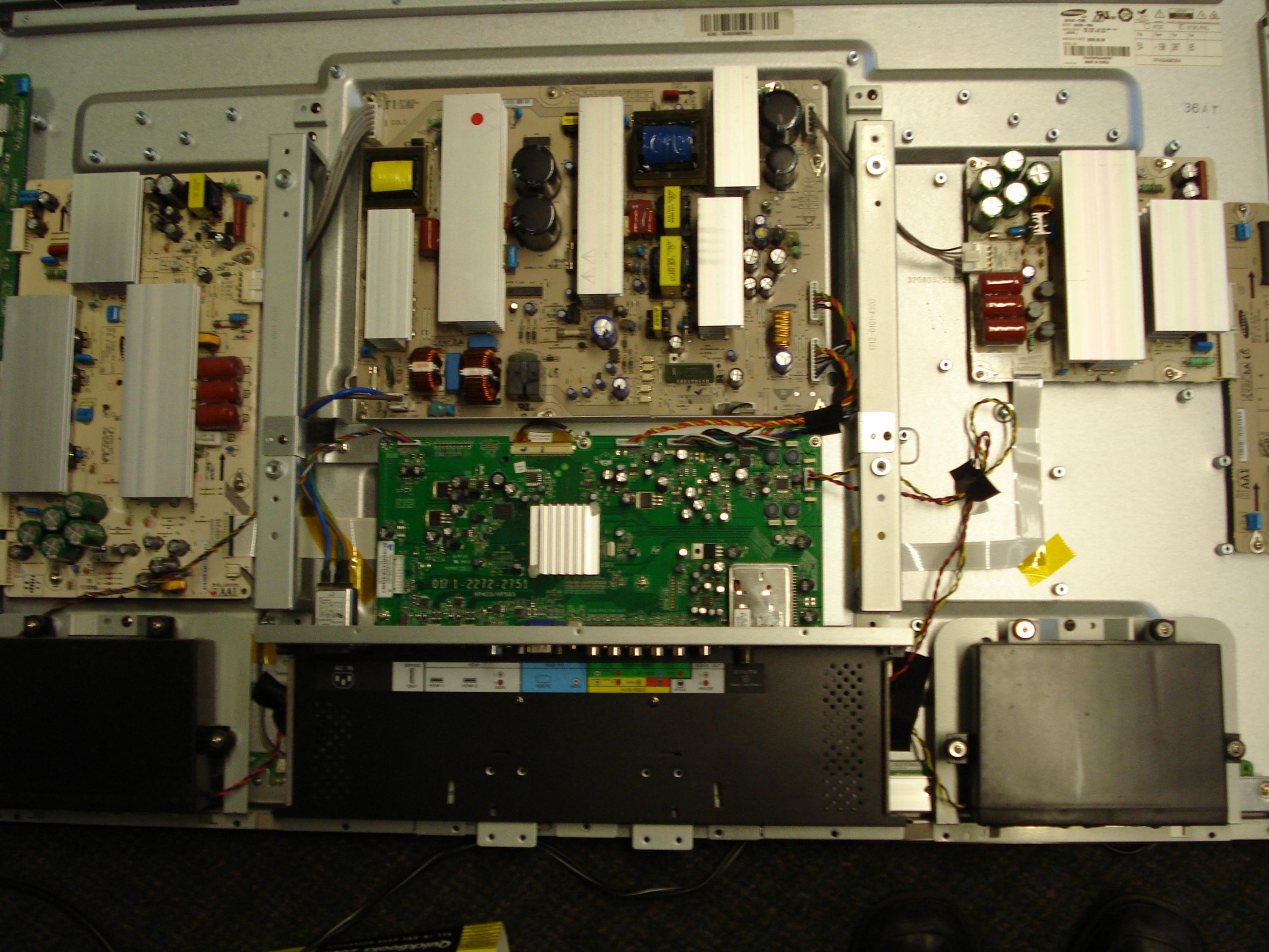

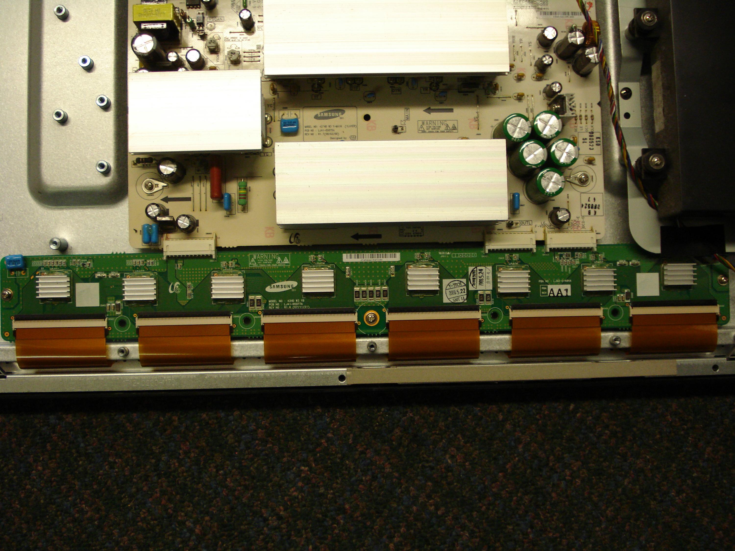

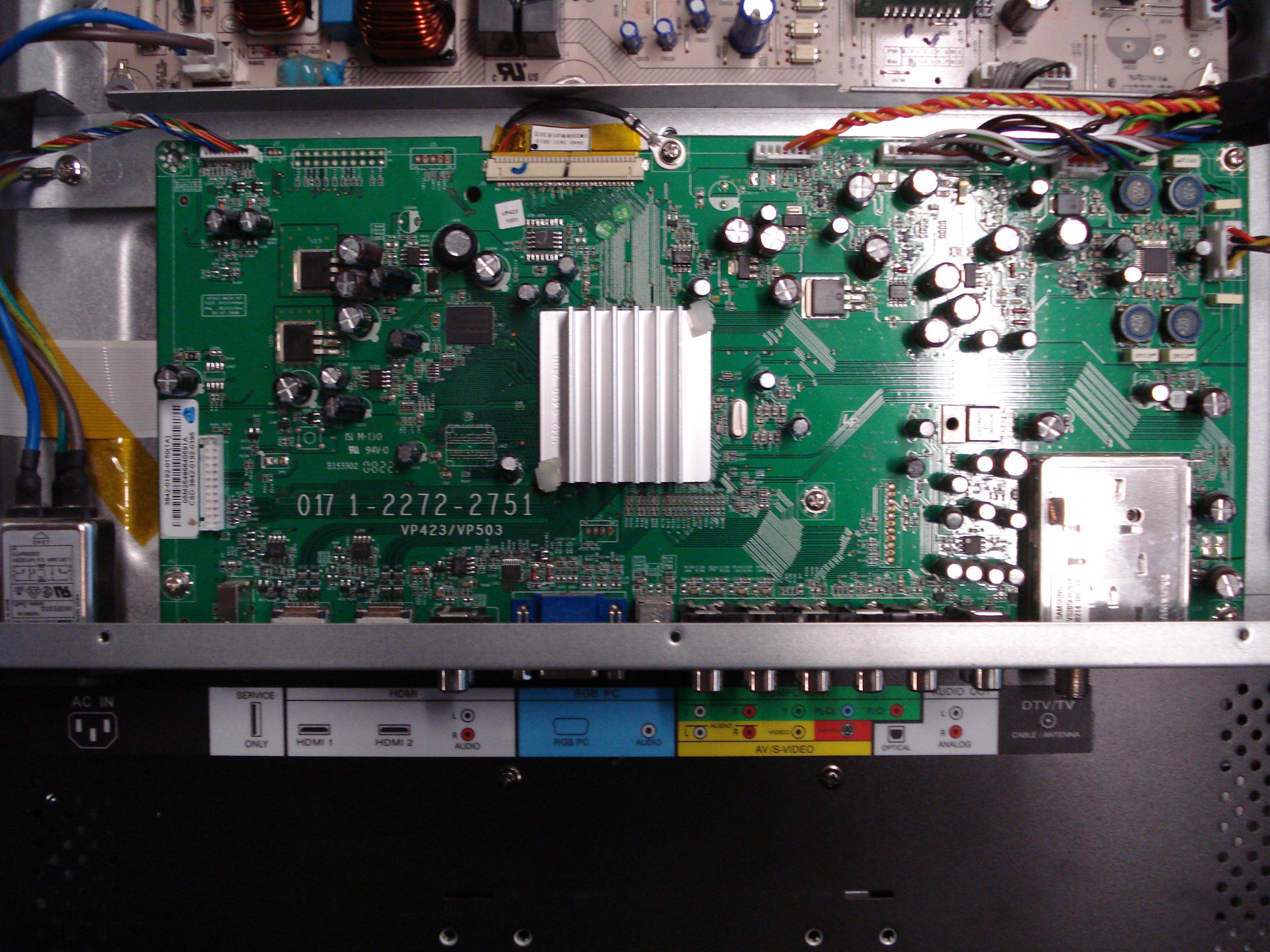

              Here are the pictures under the over. Caps are ok from visual inspection.

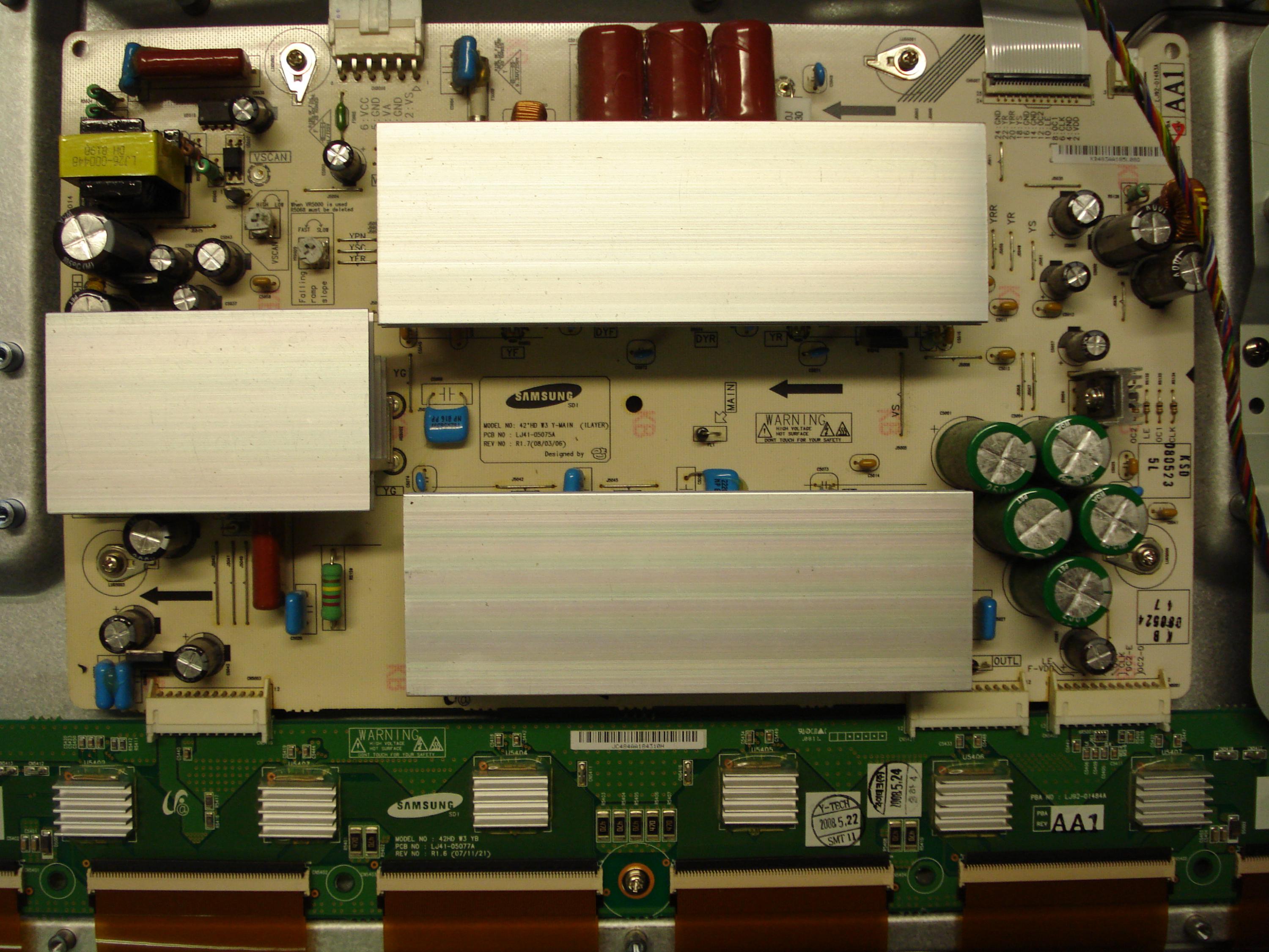

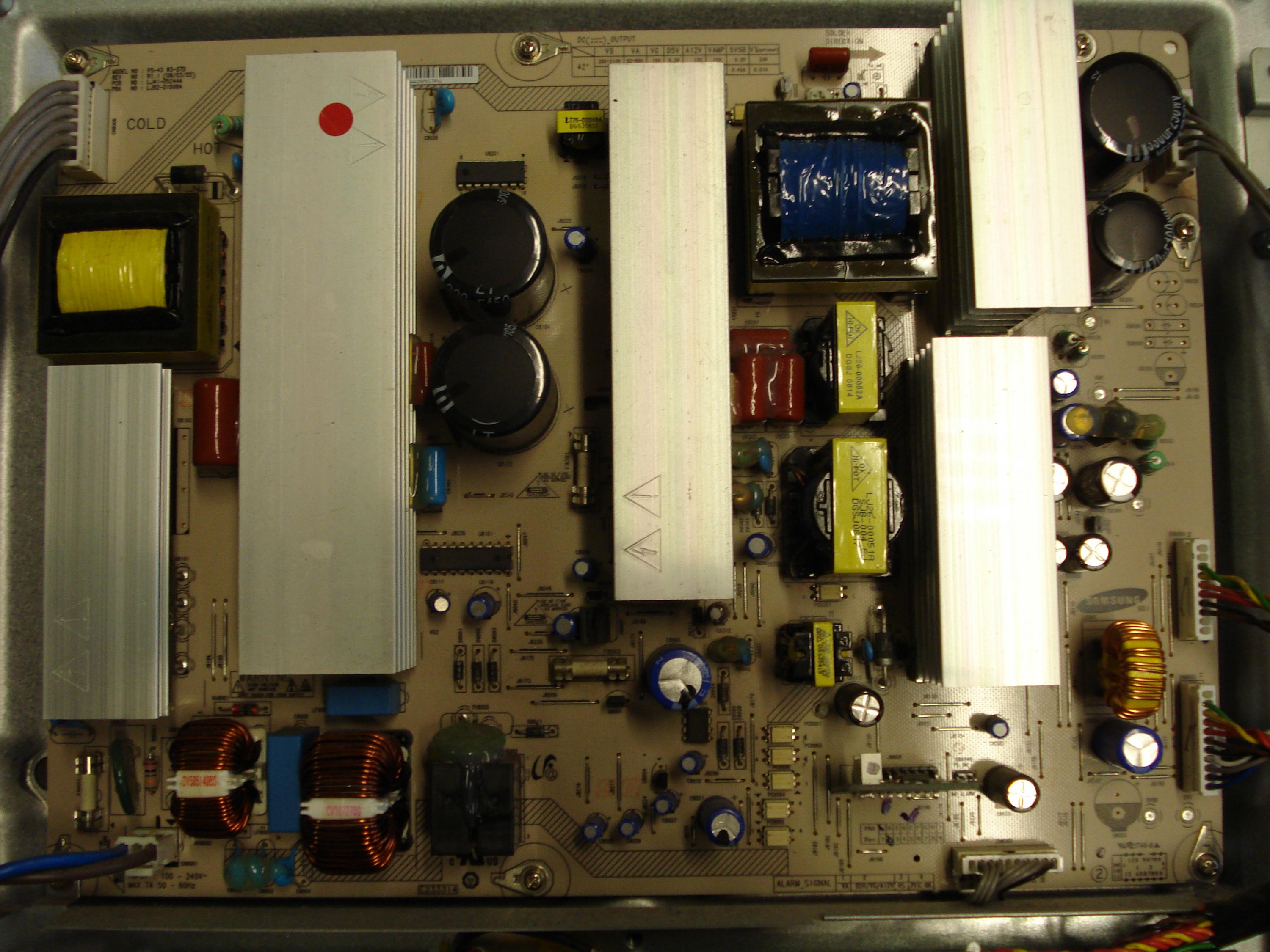

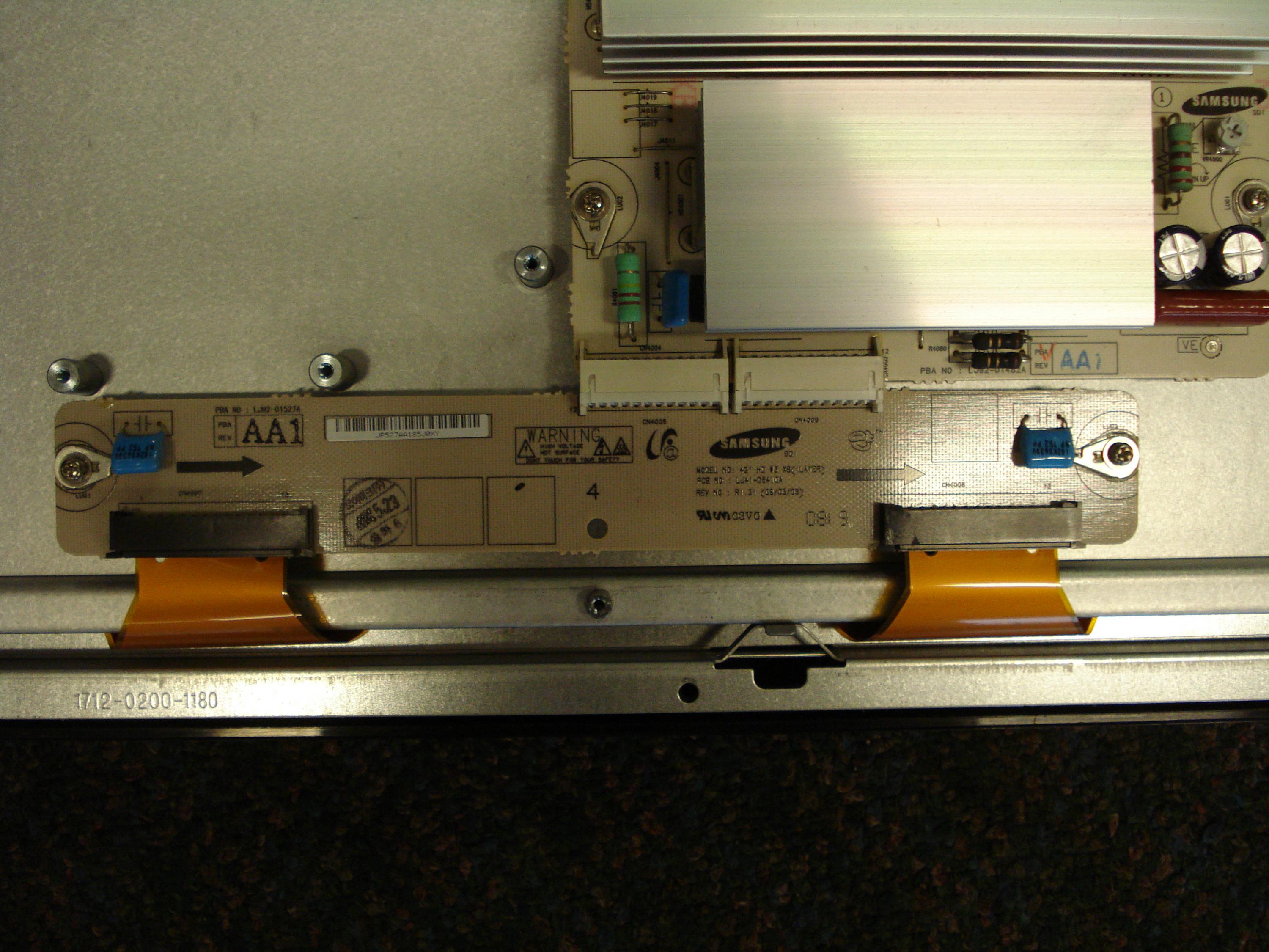

                Three more photos
                    Tom,
                    Buffer board on ebay is about $30. Should I go ahead order one?

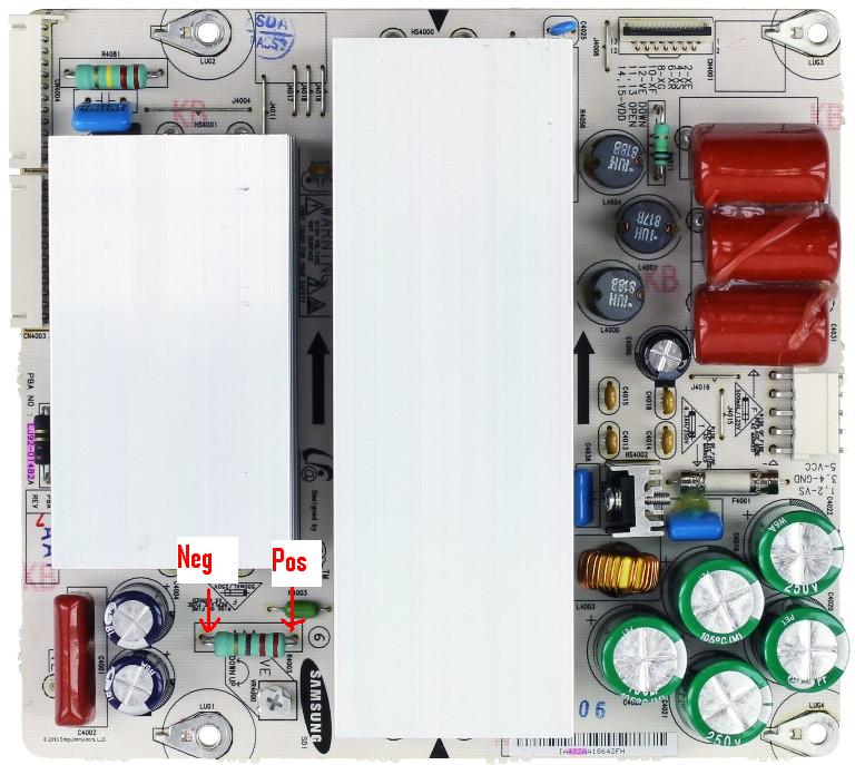

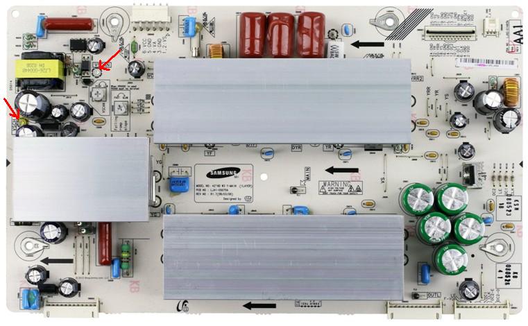

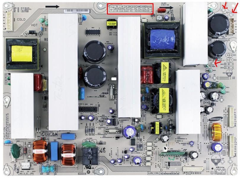

                      I'd check all the panel and power supply voltages to confirm they are good before placing an order (see red markings in attachments). All measurements are taken by placing your neg lead on a metal part of the chassis and the positive lead on the test point. VE voltage sample on the X-main is taken differently. Ignore the VSCH measurement - not needed. Compare your measurements to the panel label specs.
