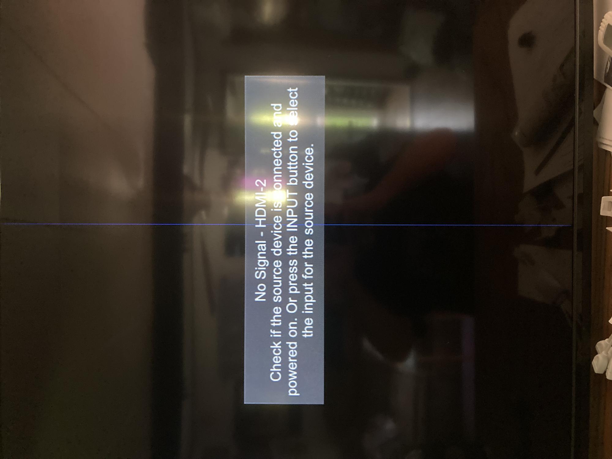

    Vizio E60-c3 blue vertical line (dead center)
    My Father called me he has a Vizio E60-c3 that's probably 3-4-5 years old but it has a thin blue line running down the center of the screen (photo) I tried a couple things but I'm sure one of you all have seen this already. Been a while since I've been here hope all is well. Thank you in advance.

    Re: Vizio blue vertical line (dead center)
    looks like a screen/panel issue developing, could try cleaning all the lvds ribbon connectors.
