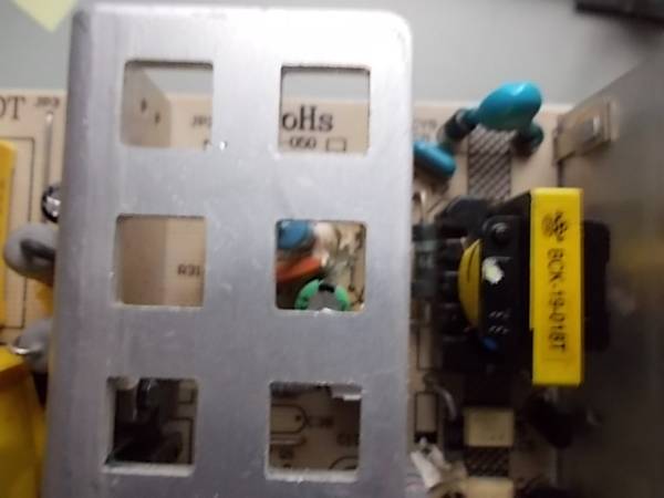

                      Have just received the same model.Different fault,in that it took a long time to come on,LED flashing then going back to Standby.All the caps looked good,But using my ESR meter, the Capxon one( where the Green one is shown in the photo)was 47uF @35v,but with an ESR of 18Ω.Replaced and now excellent.

                        Re: Wharfedale LTF37K1CB Power Issue
                        Ahh will check that out tomorrow Rtech. Hope this is it
