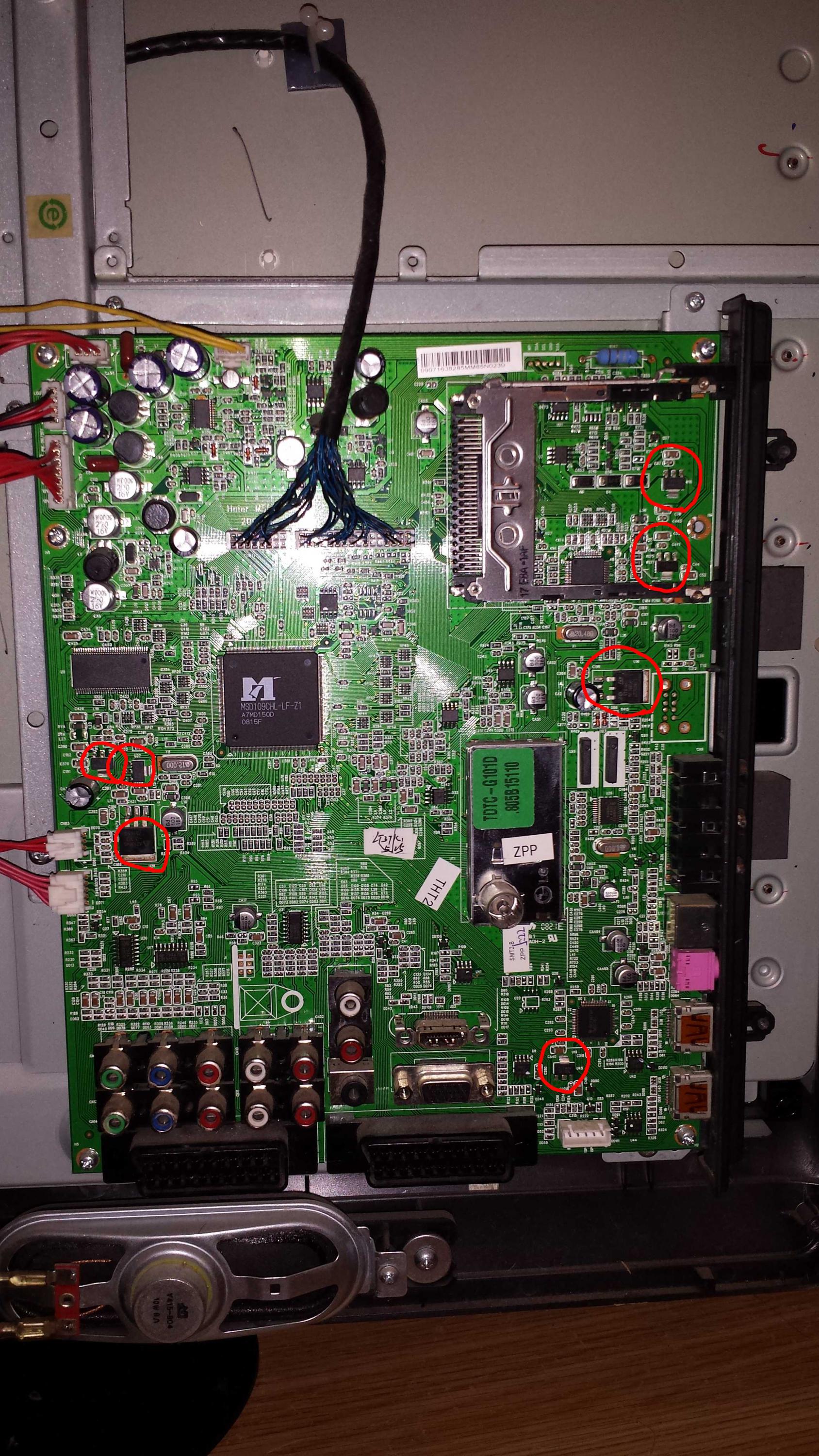

                                ok. What area do you suggest?
                                  Re: Wharfedale LTF37K1CB Power Issue
                                  See the pictures of the regulators that need to be tested.
                                  Please read this any report the results as retiredcaps format has indicates.

                                    Starting at the top right and working clockwise round.
                                    )11 8CH -> line 1 of the IC
                                    17-33L -> line 2 of the IC
                                    pin 1 = 0.00
                                      3.3V regulator, right now the input voltage is too low for it to work
                                      [B[/B])11 8CH -> line 1 of the IC
                                      pin 1 = 0.00
                                      pin 2 = 0.14
                                      pin 3 = 0.85

                                      Variable regulator pin 1 voltage of 0.70V + 1.25V ref then the output should be 1.95v but you are getting 3.22V, so it is bad. Variable regulator pin 1 voltage of 0.70V + 1.25V ref then the output should be 1.95v but you are getting 3.22V, so it is bad. The voltage between pin 1 and pin 2 should always be 1.25V for 1117 series variable regulator.
                                      )11 8CW -> line 1 of the IC
                                      1117L -> line 2 of the IC
                                      pin 1 = 0.70
                                      pin 2 = 3.22
                                      pin 3 = 5.03
                                        Righty. I will get a new 1117 variable regulator tomorrow and swap the bottom bad one then check voltages again in all the other regulators.
