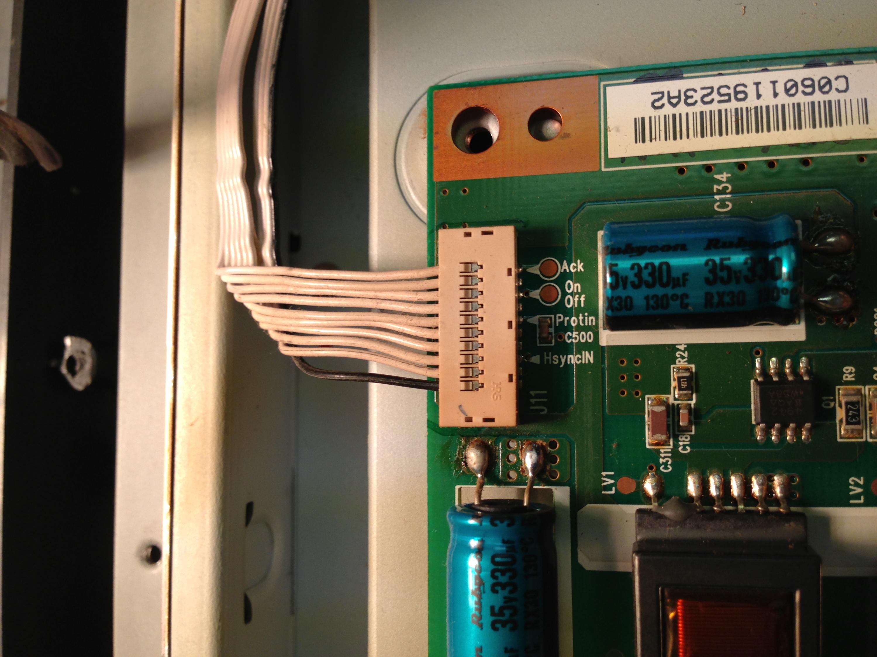

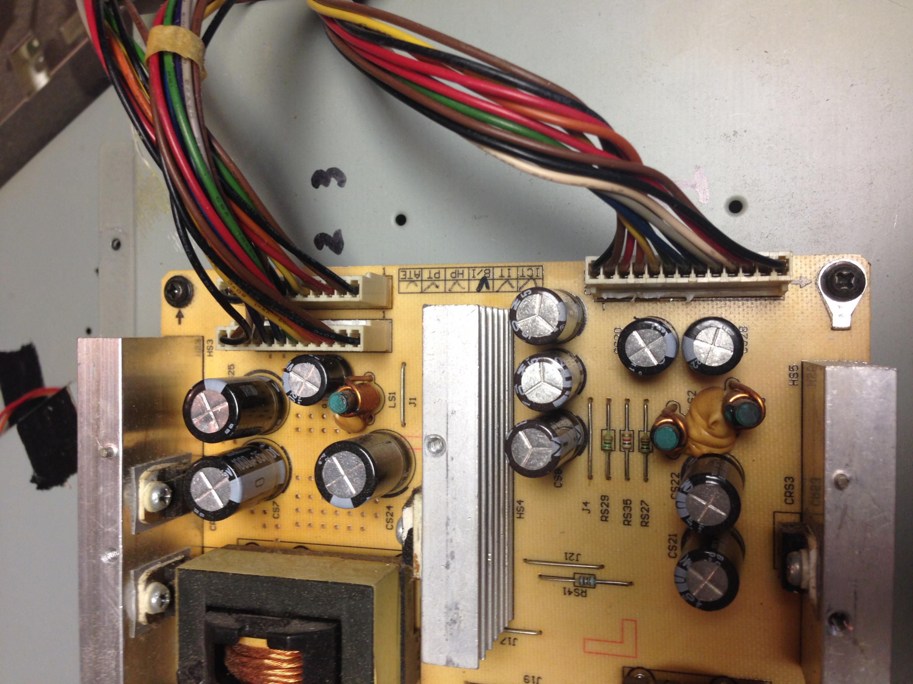

    added a few more pics...
    How do I remove the connector in the last pic?

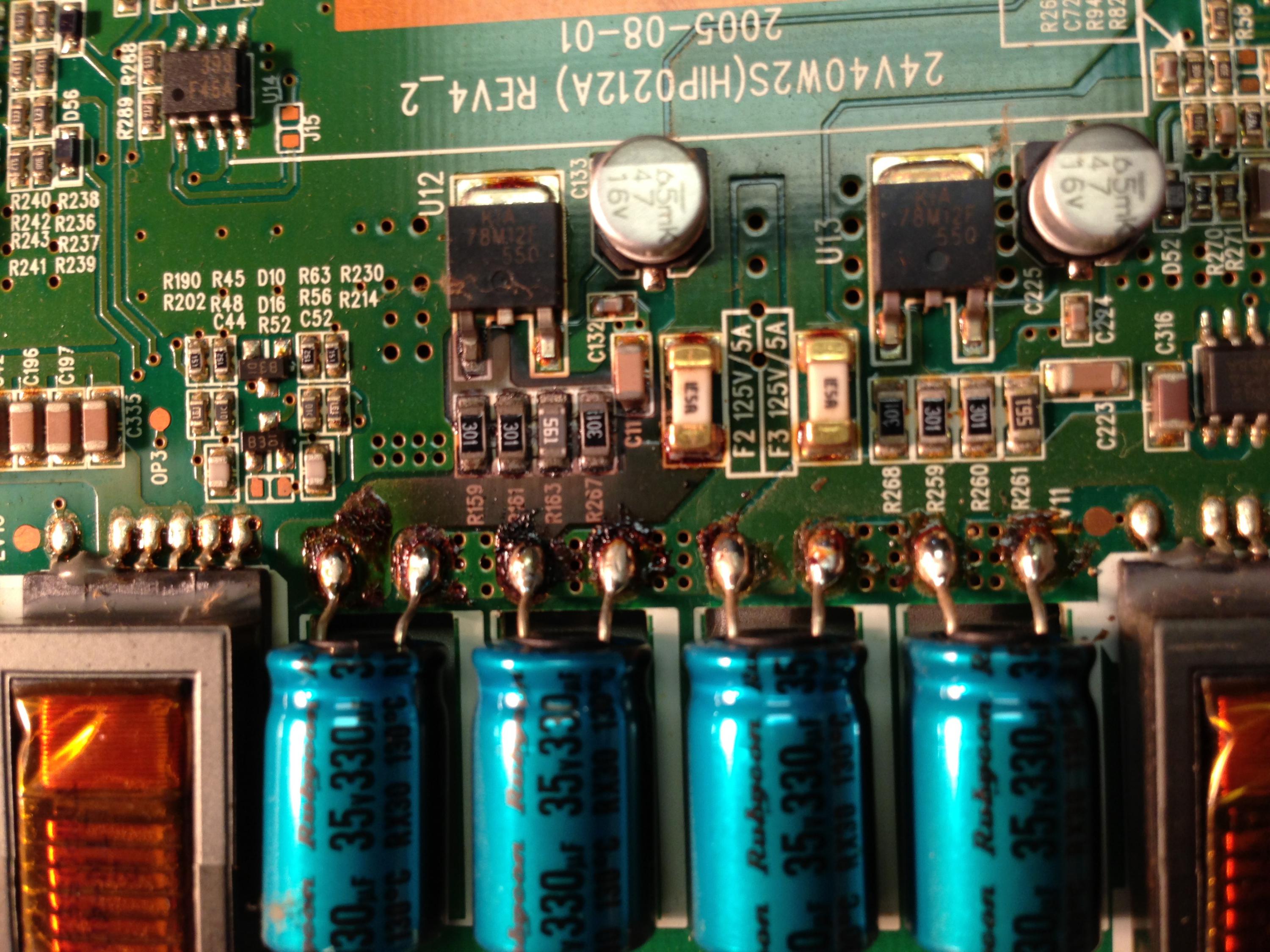

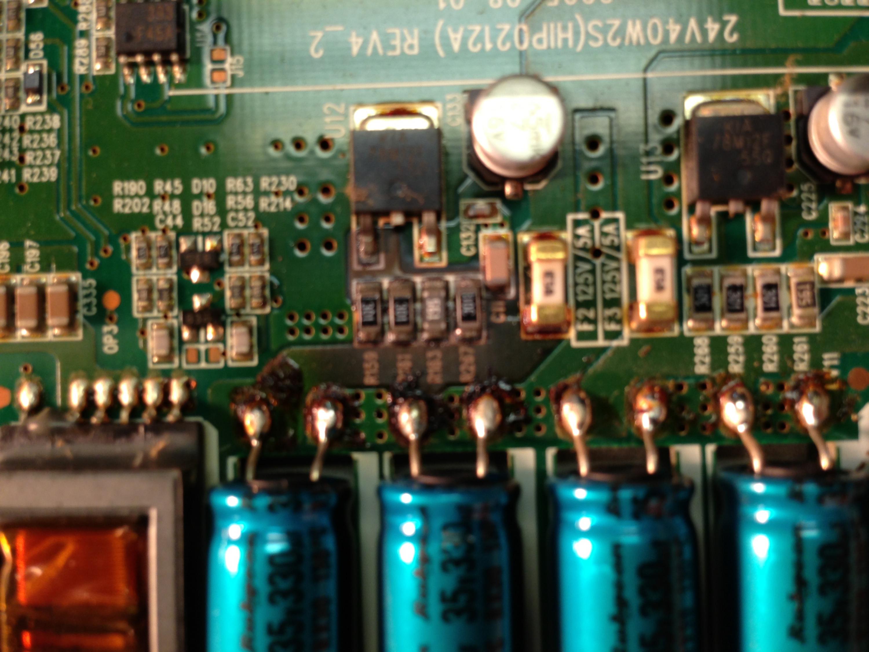

      Re: Viewsonic n4060w w/FSP276-3F01 power supply
      I'm not sure if it is removable or not. Try gently pulling it upwards (not to the side!), away from the board.
      Looks like R159, R161, R163, and R267 are the troublemakers here. The heat seems to have originated from them, not from that voltage regulator.
        Can I test them in the circuit? If so, how?
        Do you think it might have ruined the board?
          The heat can be due to those bad filter caps which allowing high frequency AC ripple to get to the circuits and caused the invereter to be running at the wrong frequency due to beat frequency of the switching power supply and the frequency of the inverter circuits. I would check the ESR of those blue caps or replace them.
            Ok, I now have some time to place an order for the parts I need to try fixing this TV. I found the 4 caps but don't know exactly what to be looking for to get the smd resistors. If someone could check my caps and tell me what part# from Newark for the SMDs it would be great.
            The Resistors say 301 & 195. I did find a calculator and it said they are:
            301 = 300 Ohm
            195 = 1.9m Ohm
            They are both 3.2mm X 2mm
            caps: Newark Elec Part #65R4235
            NICHICON - UPW1V331MPD1TD - CAPACITOR ALUM ELEC, 330UF, 35V, 20%, RADIAL
            Thanks!!

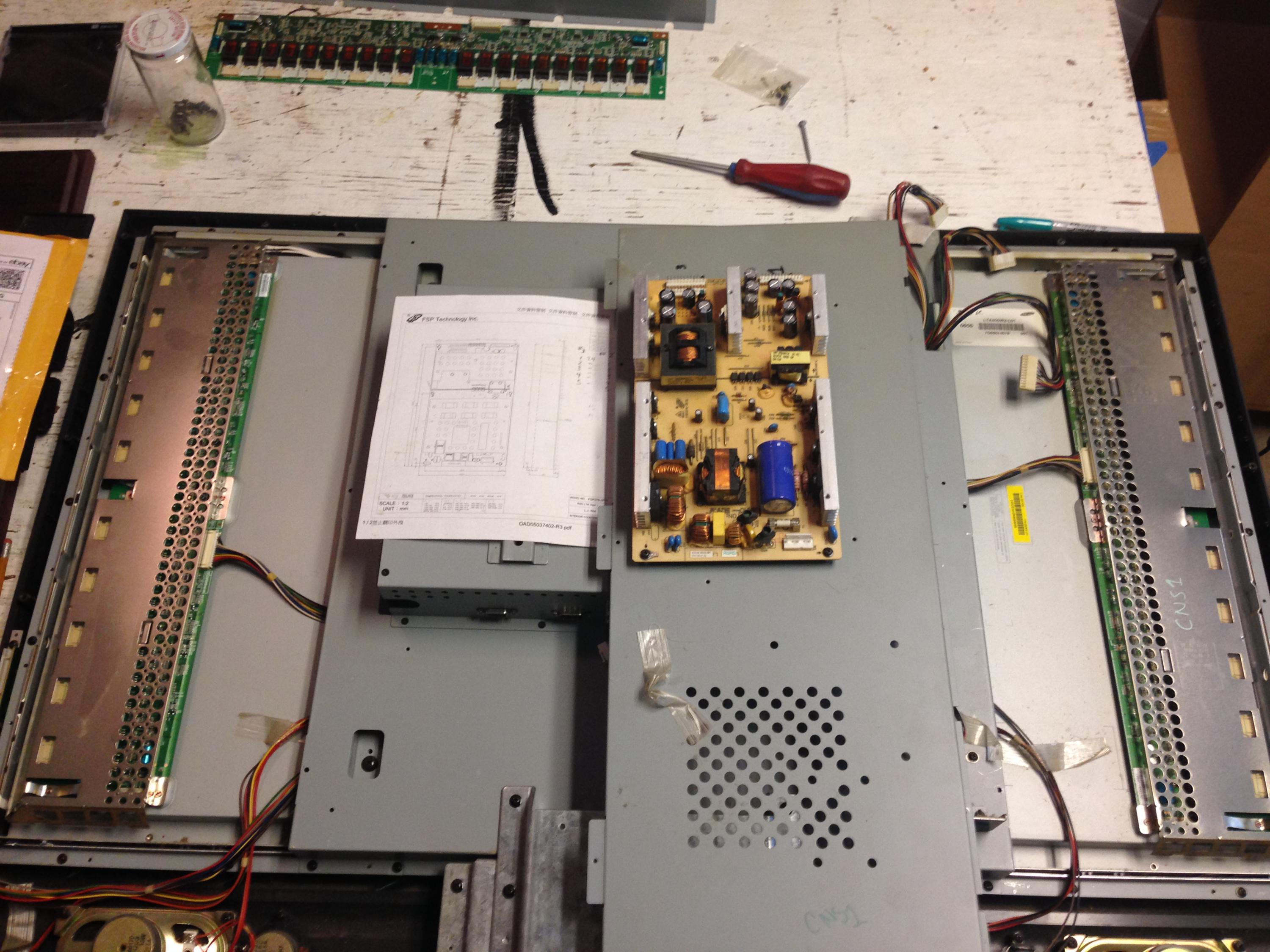

                      OK, it has been awhile so I do not remember all the questions and answers. So there are TWO inverter board, one has some burnt on it, is that the master one or the slave one?
                      Can I see the whole backside of the TV?

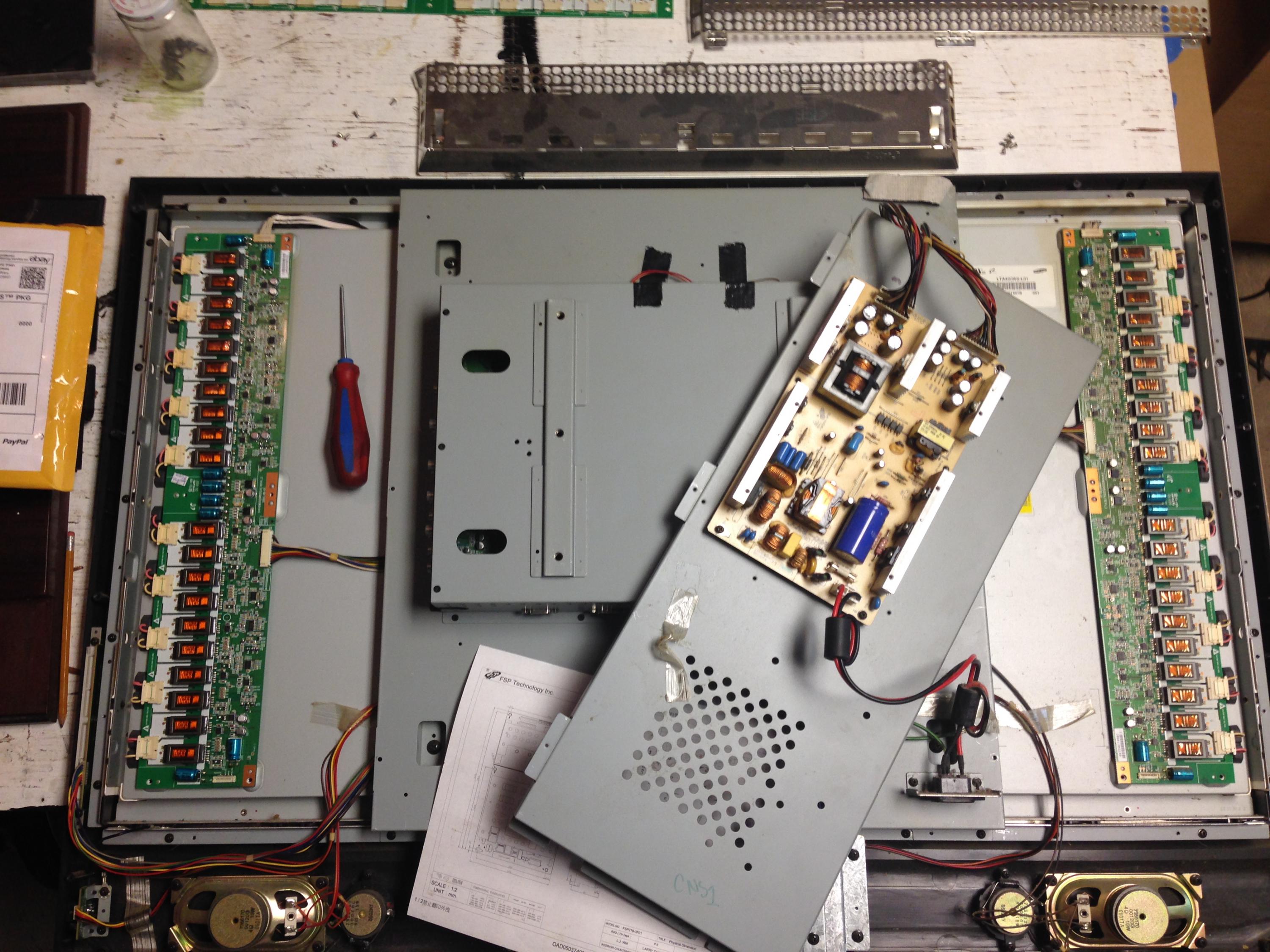

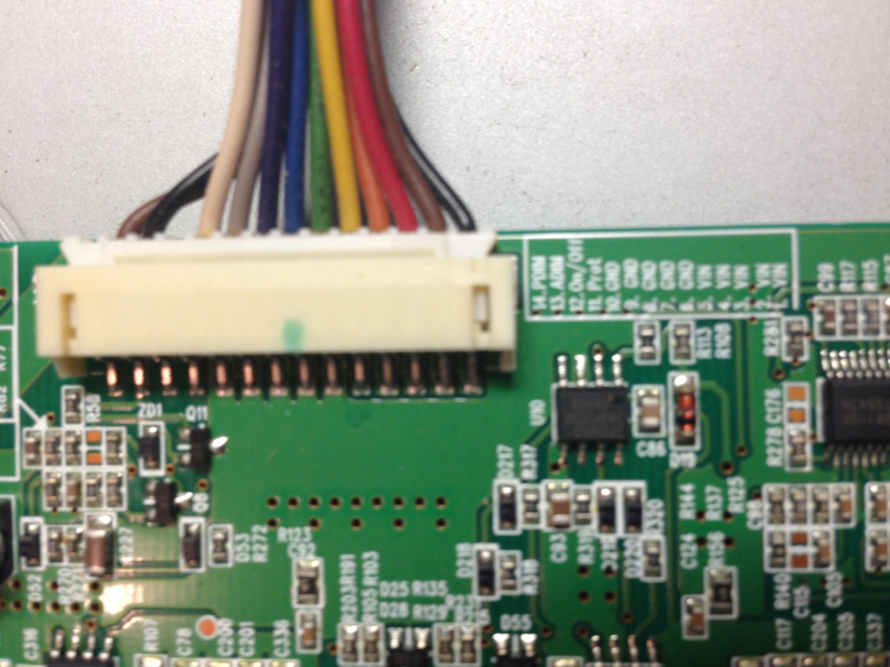

                          #32
                          Those vdc's were pulled at the power supply headers that lead to the inverters.. (pic 4)
                          Testing them directly at the inverter boards (pic 3)gives me the following:
                            Yes, the signals are correct, pin 12 on the inverter board is the BL_ON (ON/OFF, or INVR ON). But since the TV has MASTER/SLAVE INVERTER boards which work together so one of the two may be bad, or both have failed. You only replaced one, right?
