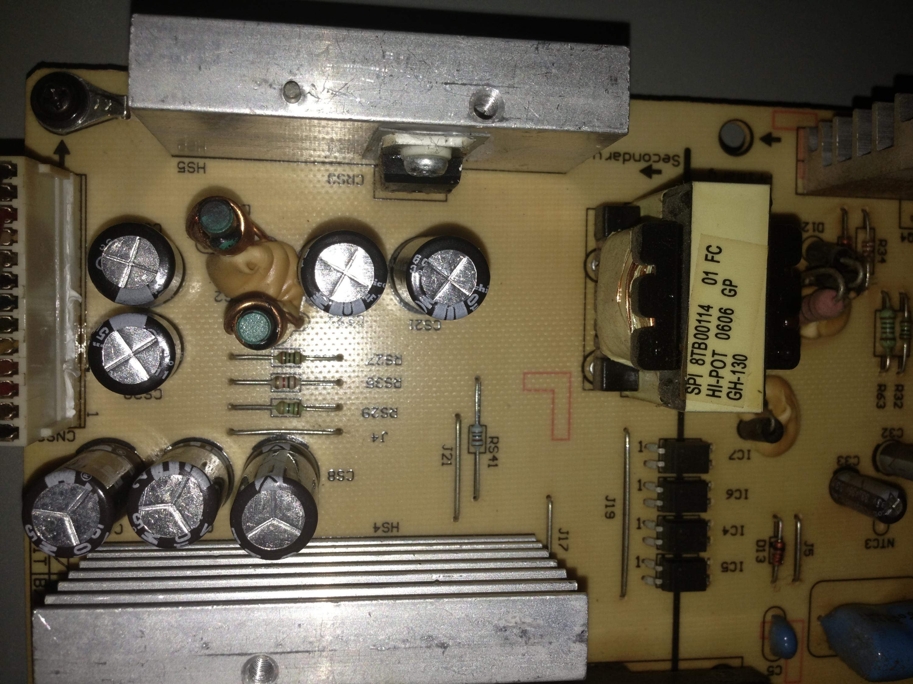

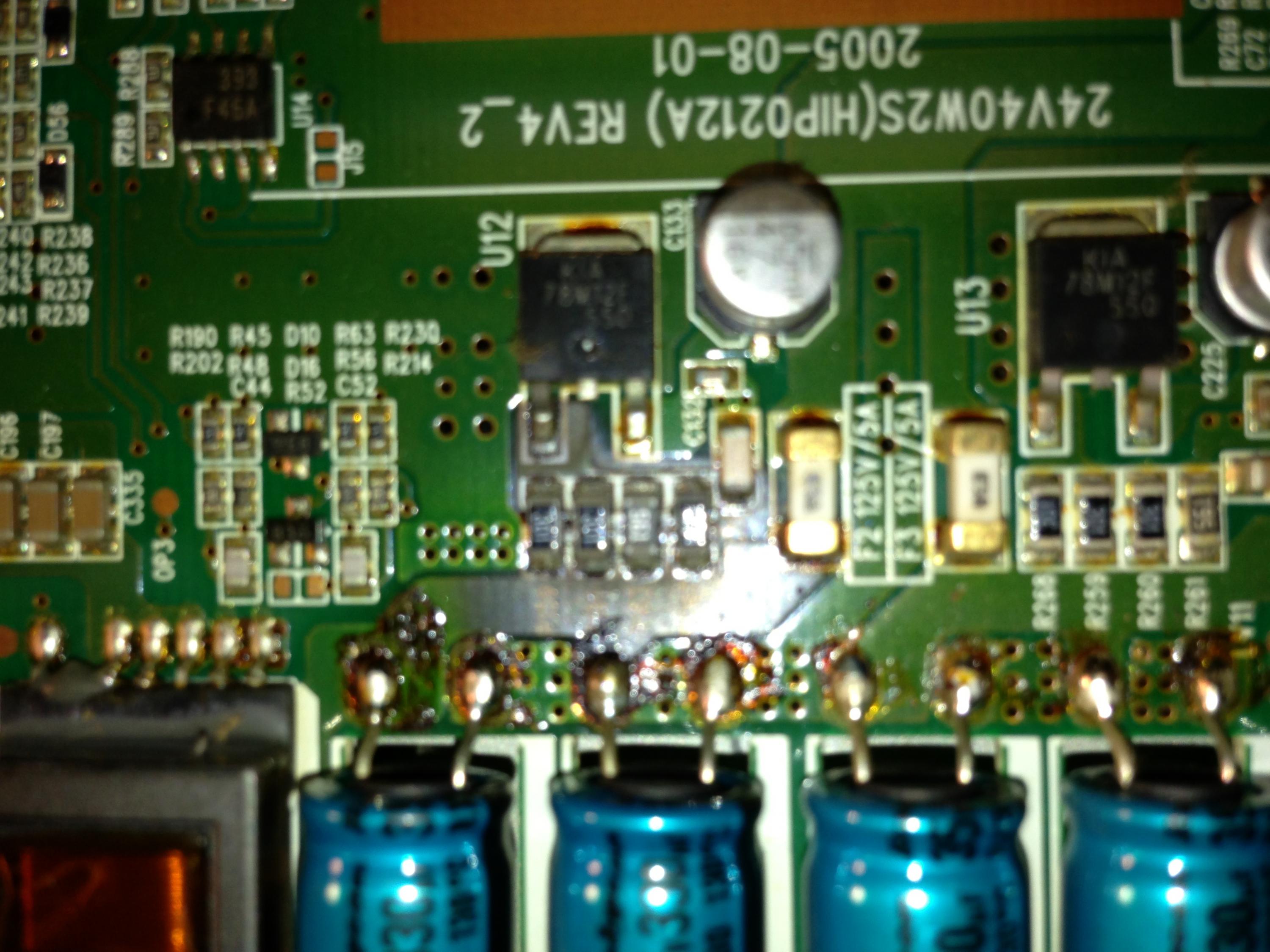

    I was given a Viewsonic n4060w w/FSP276-3F01 power supply from the guy next door along with a cap kit he bought off ebay for the secondary side. He never got around to installing the caps but thought it was the problem. I installed them and there was no change.
    Should this TV have a red standby LED when the unit is plugged in and turned off?
    When I press the power button the LED lights up green (no flashing, solid green till I power down). I connected a DVD player to it and tried blindly to find the right input to see if there was sound and either didn't find it or there isn't any sound.

    What are the brand and series of the replacement caps? Did you replace all the caps? I know Viewsonic loves crappy caps like CapXon so all of them should be replaced. It helps a lot to post some high resolution pictures of the board in question
    • 6of1
      • Sep 2013
      • 43
      Re: Viewsonic n4060w w/FSP276-3F01 power supply
      I believe the replacements are Nicholson (or something like that). Not all the caps were replaced, but every cap on the secondary side is new.
        They look like nichicon which is good. I would still replace all of the little caps, they look like CapXon (I have seen them dry out in a few Viewsonic monitors) That big blue cap, did you install that too? Either way, measure the DC voltage across it, but be careful, don't touch anything while it's on

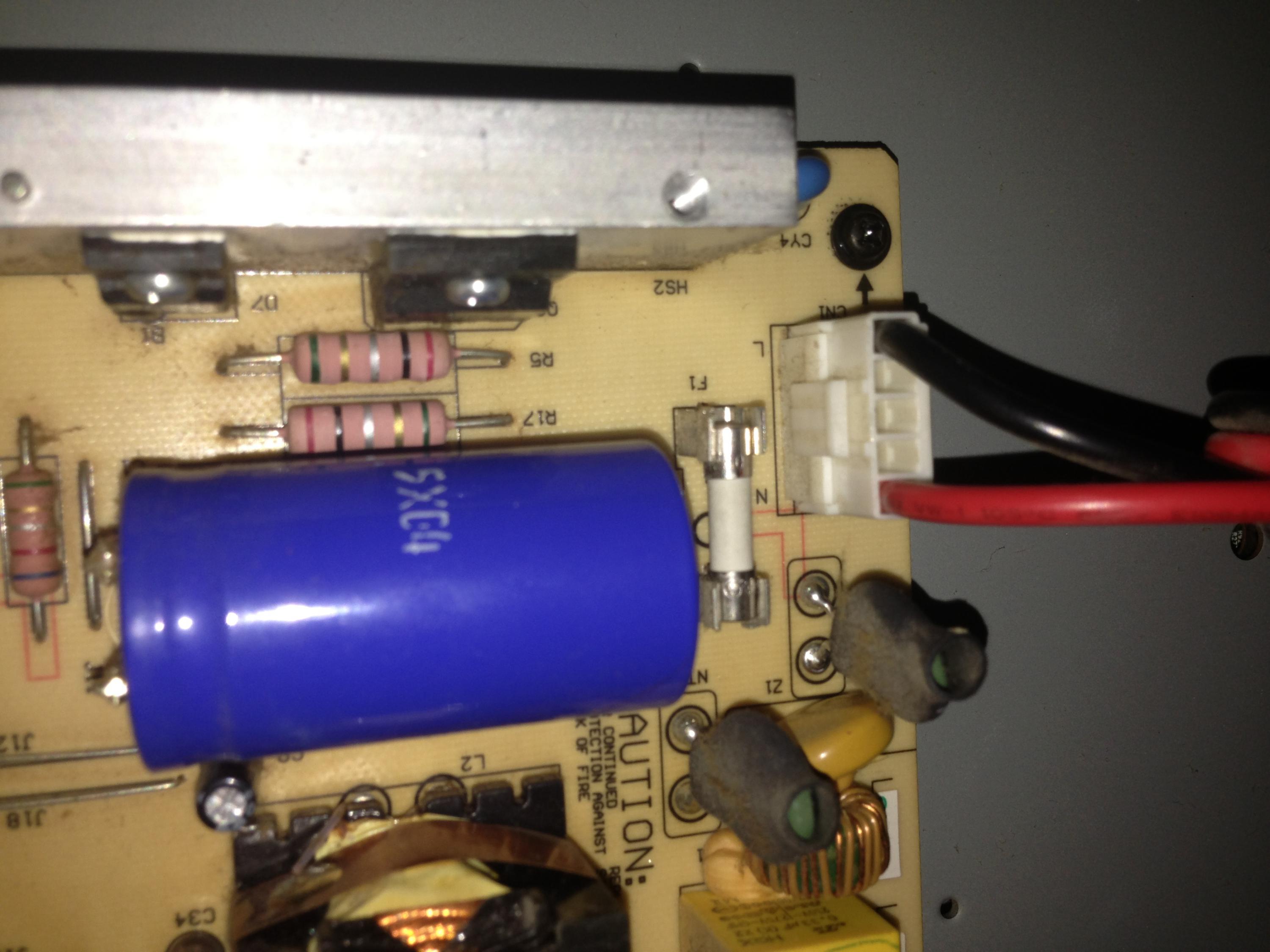

          No, I didnt install the big blue one. I can borrow a multimeter, just need some instruction on how to use it. Would I be getting a green light when I press power button if the primary side is the problem? Wouldn't the green light mean I do have standby voltage?
          I will try and get the specs off those tiny ones on the primary side so I can search Newark electronics (unless someone has these part numbers?)

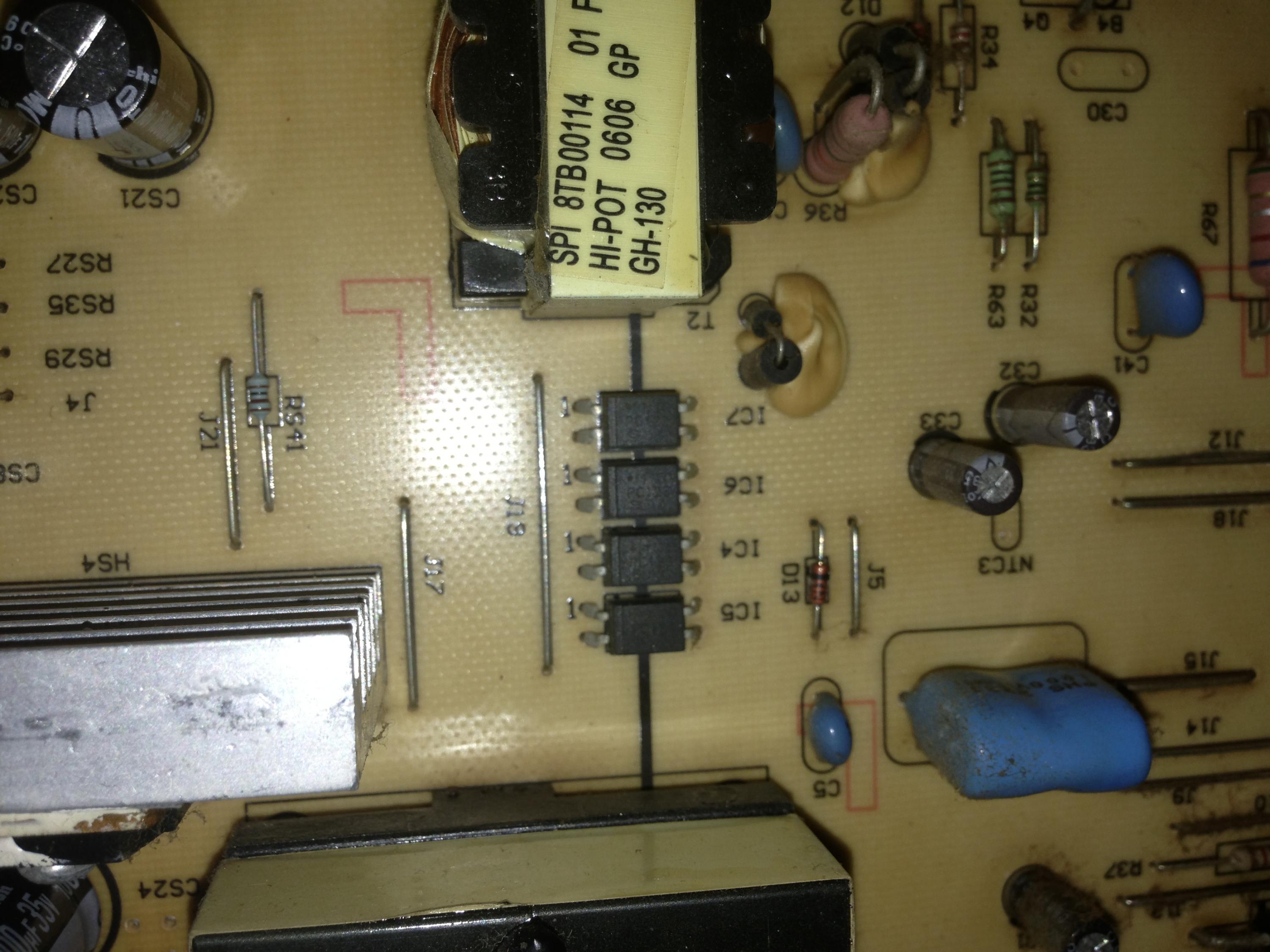

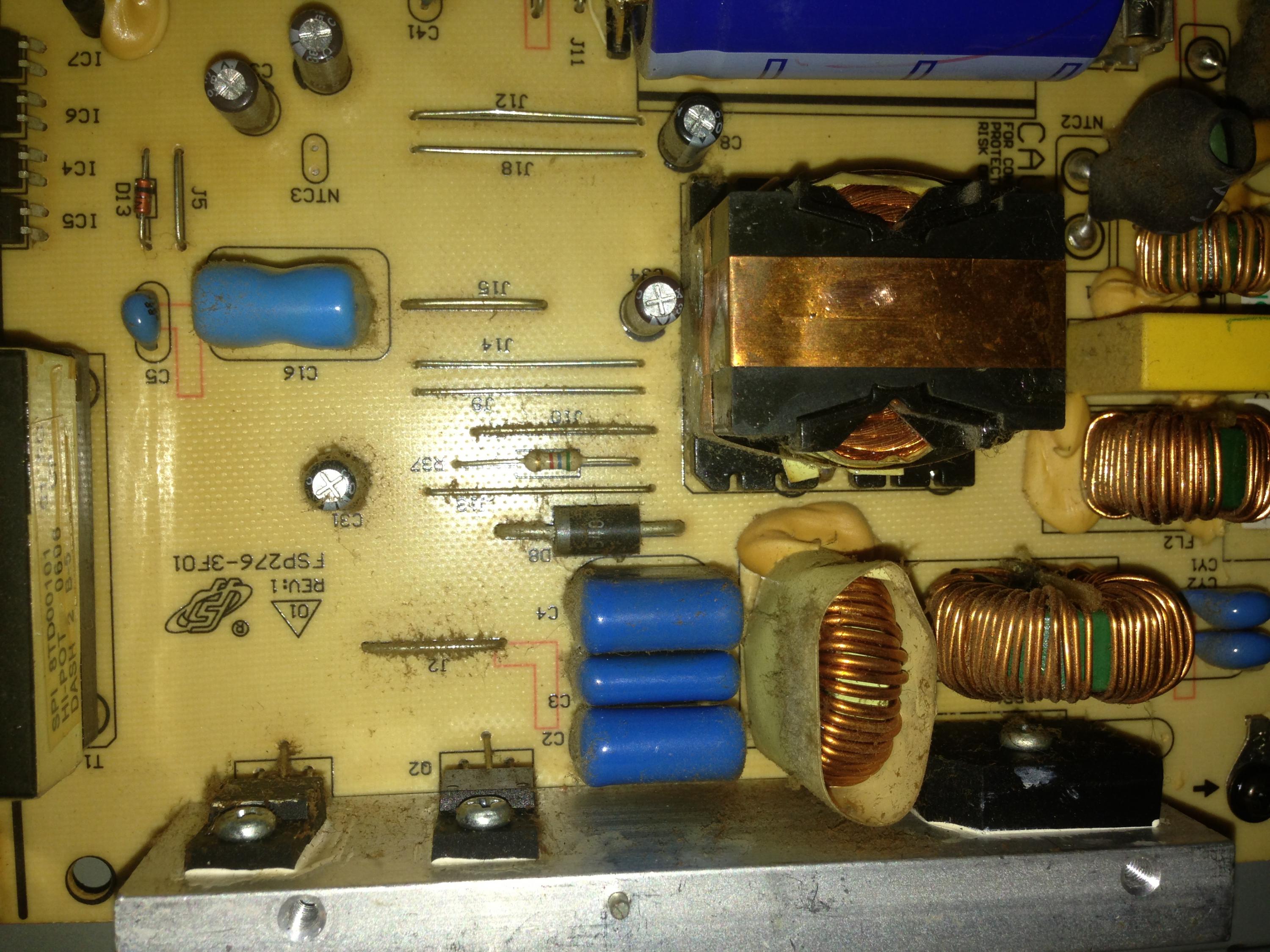

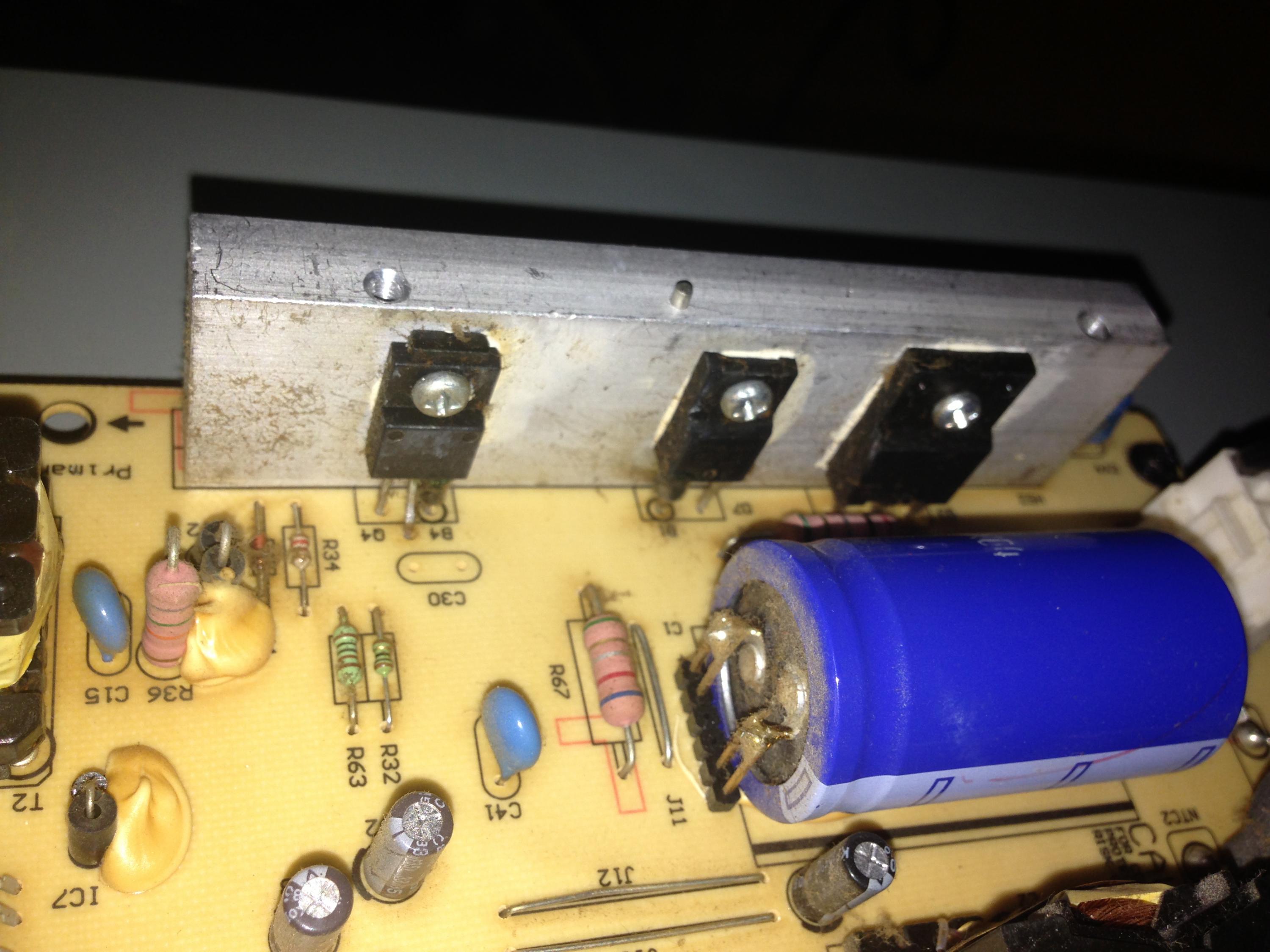

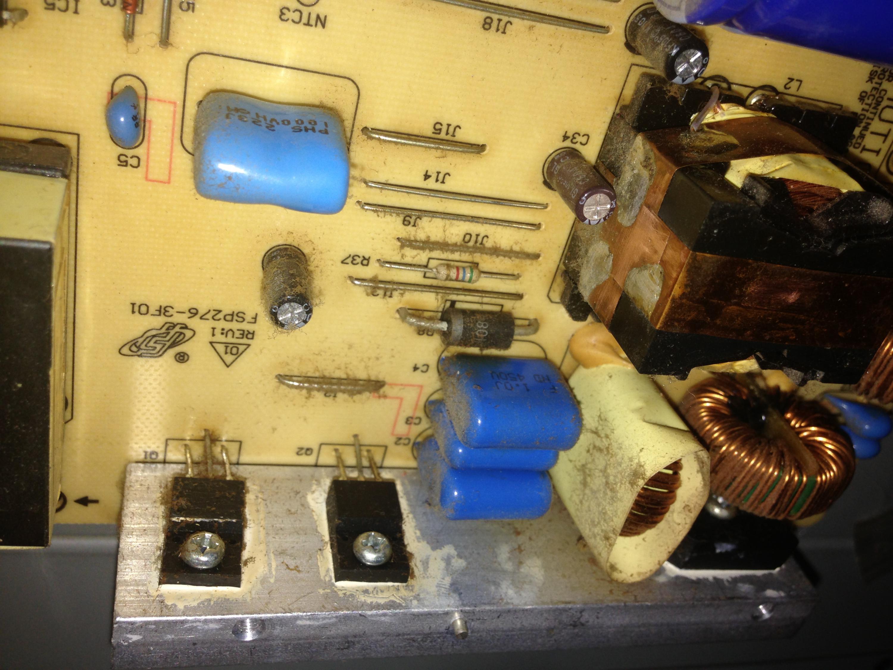

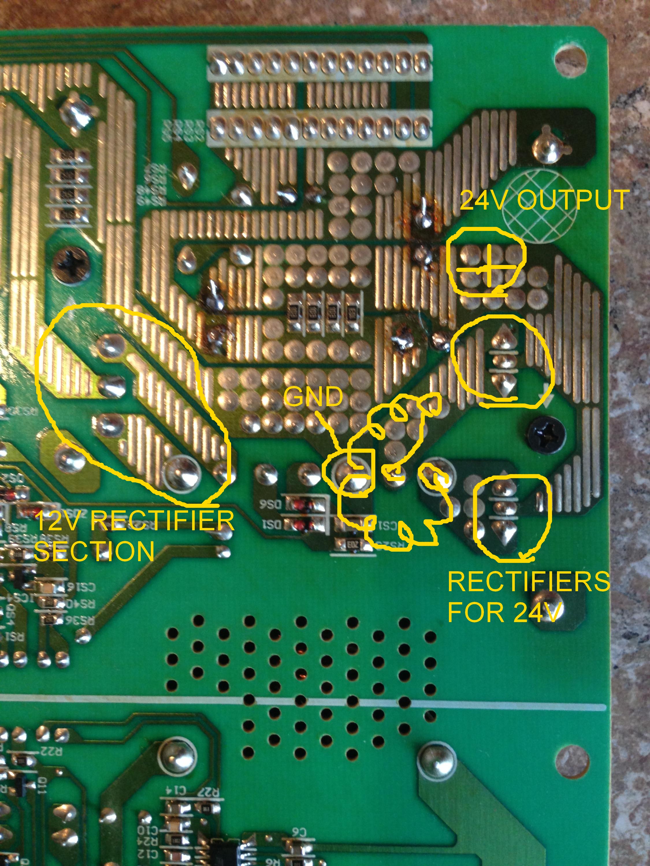

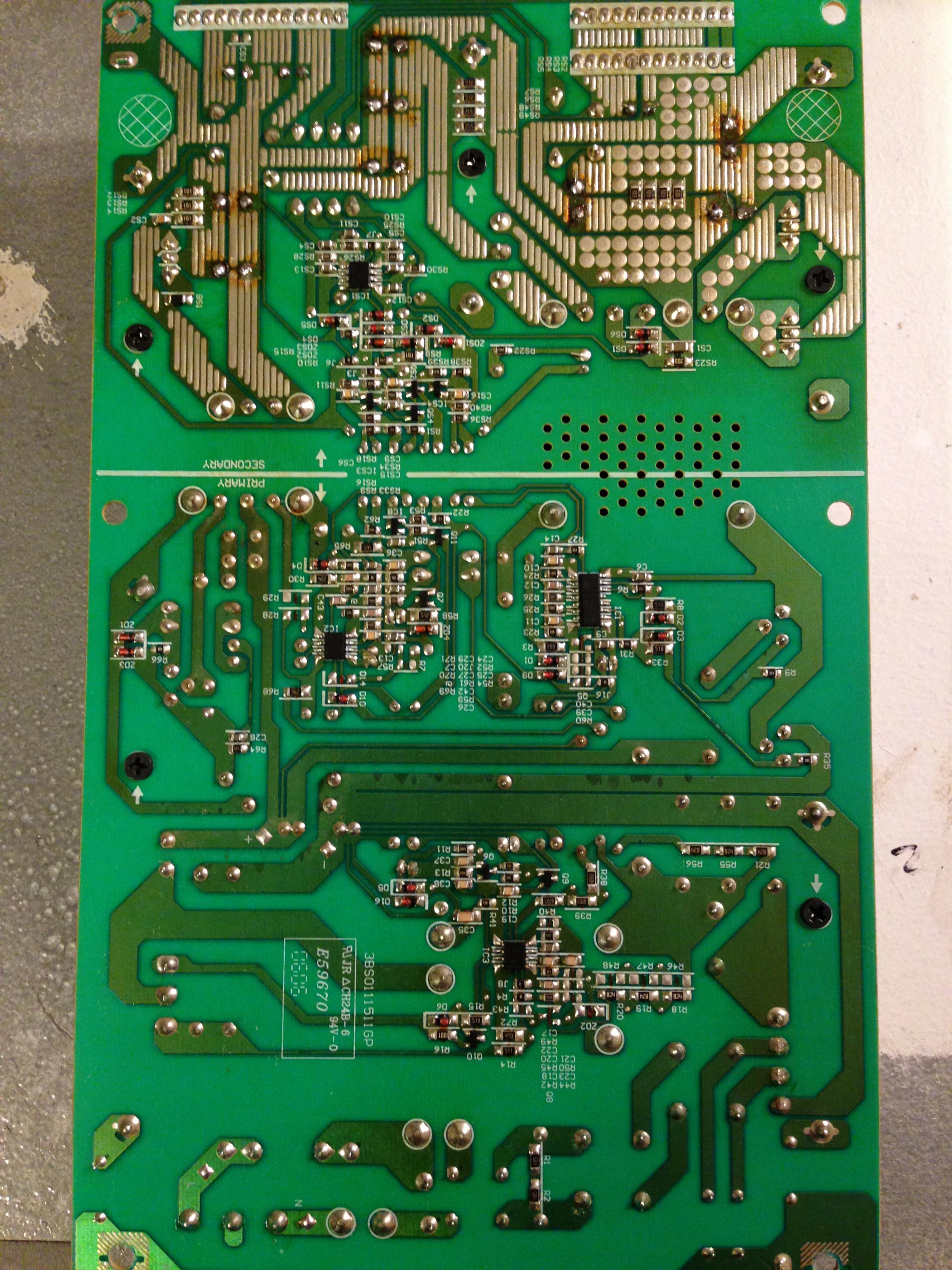

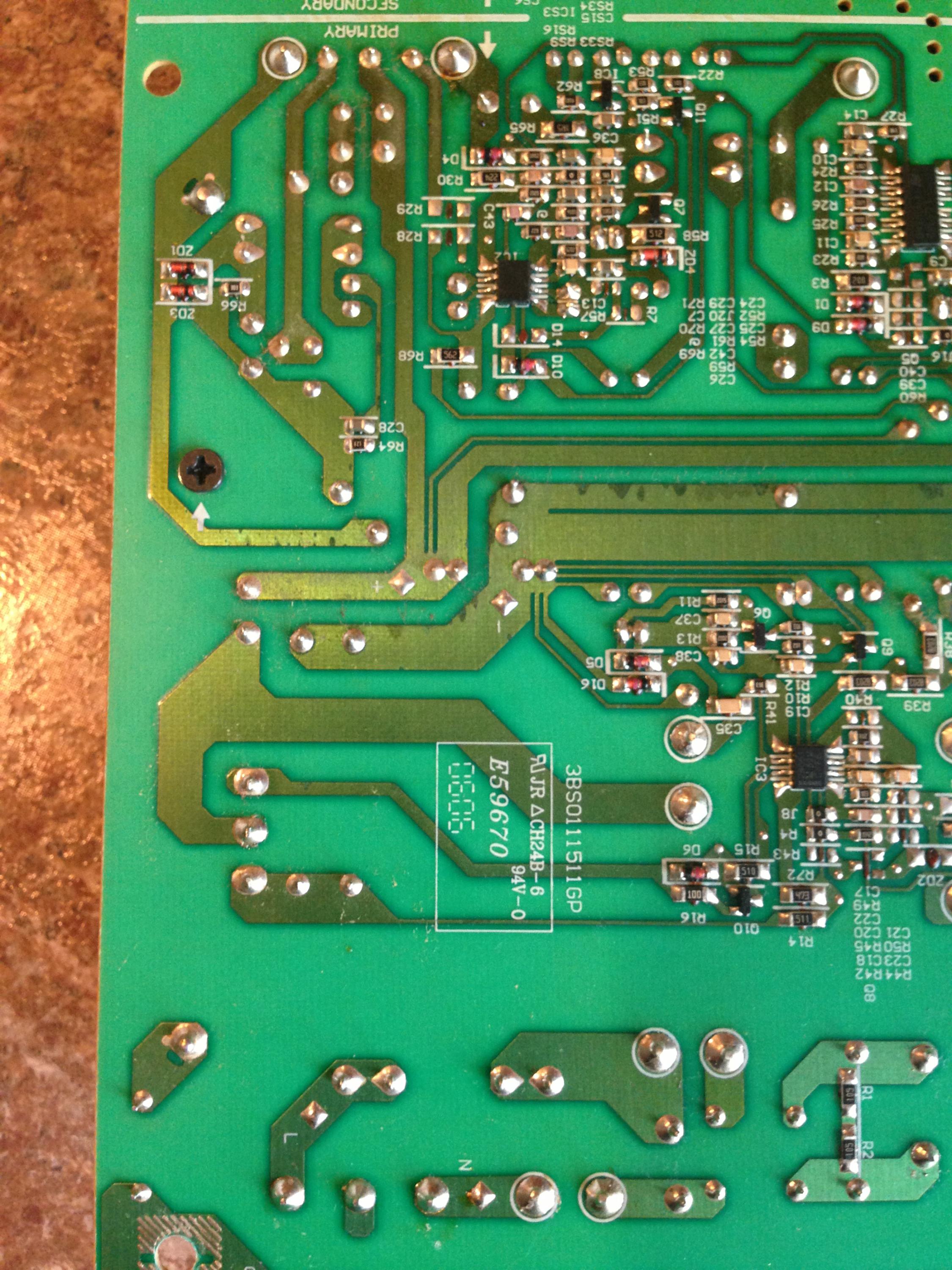

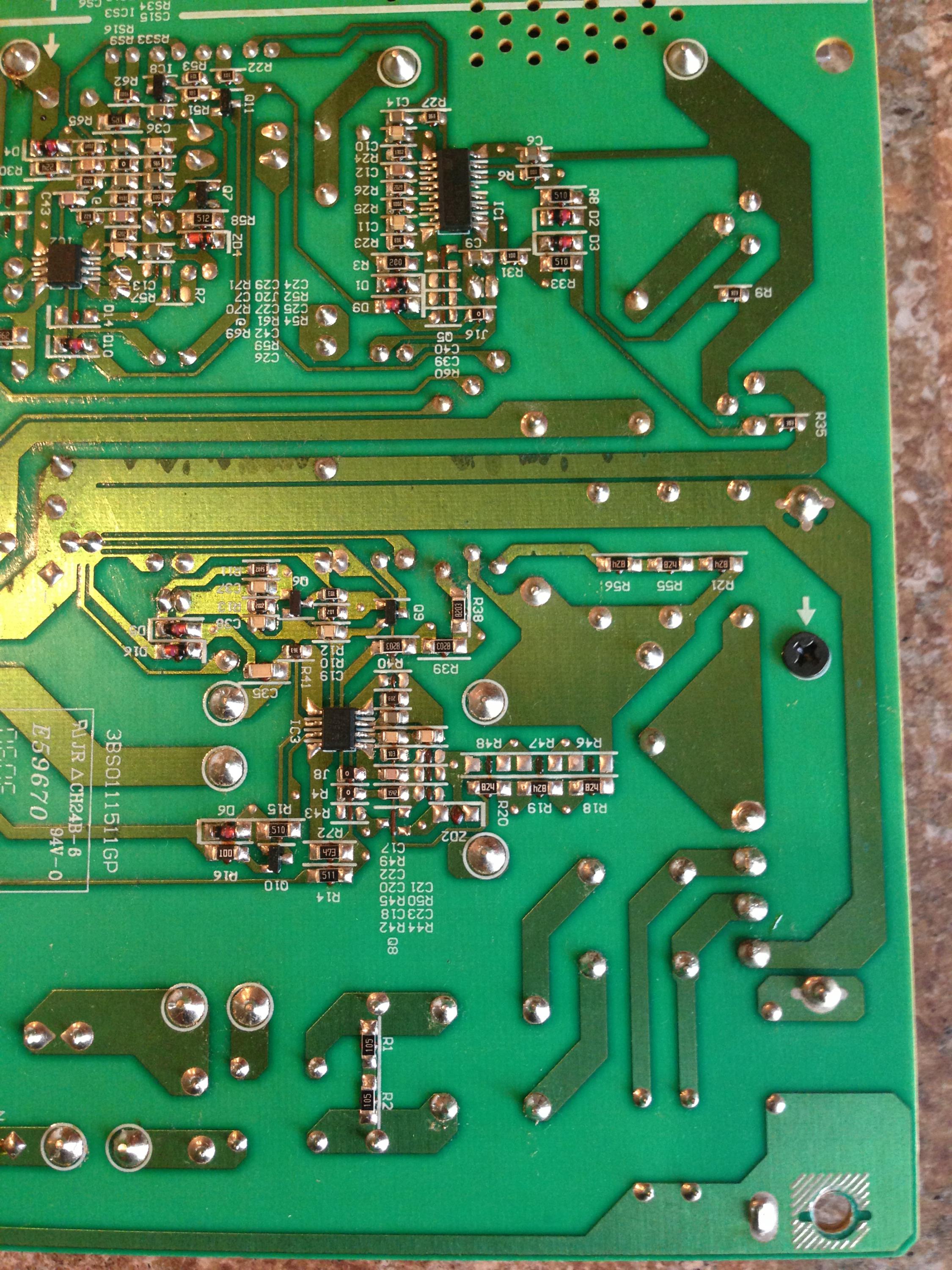

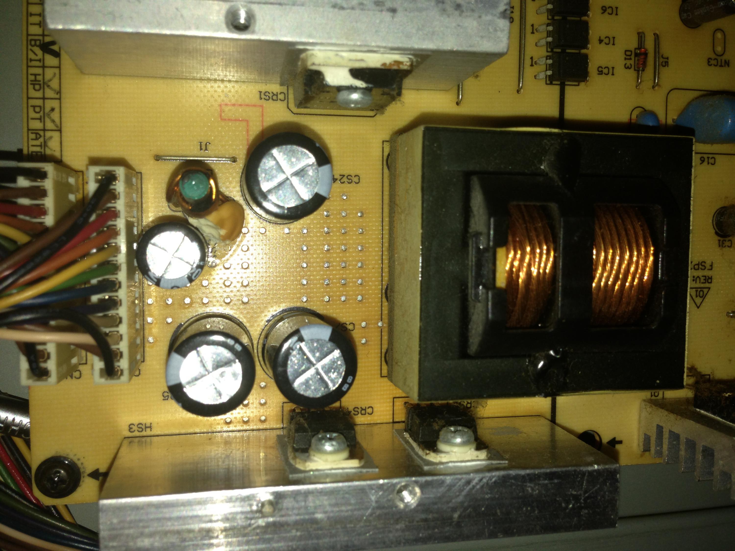

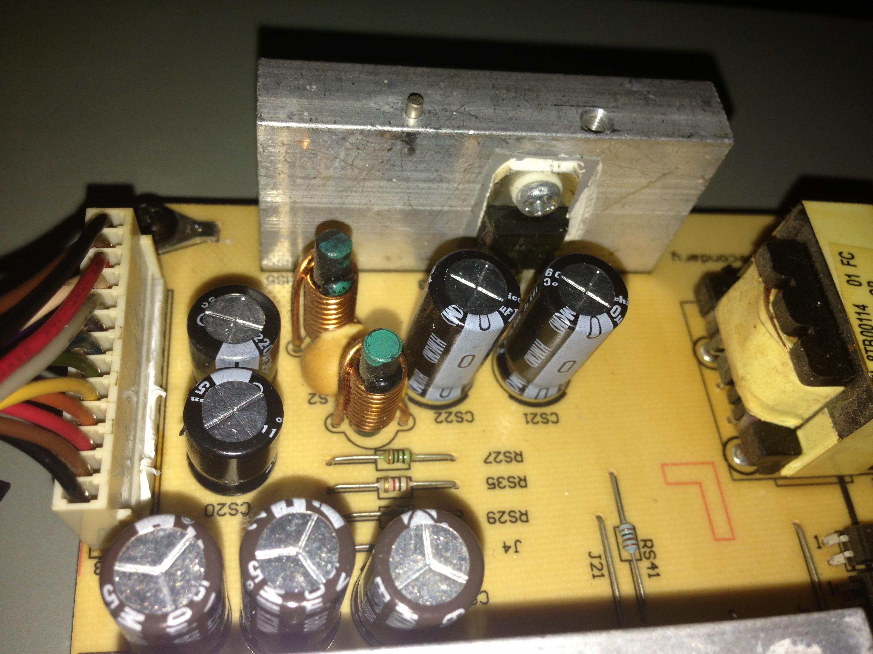

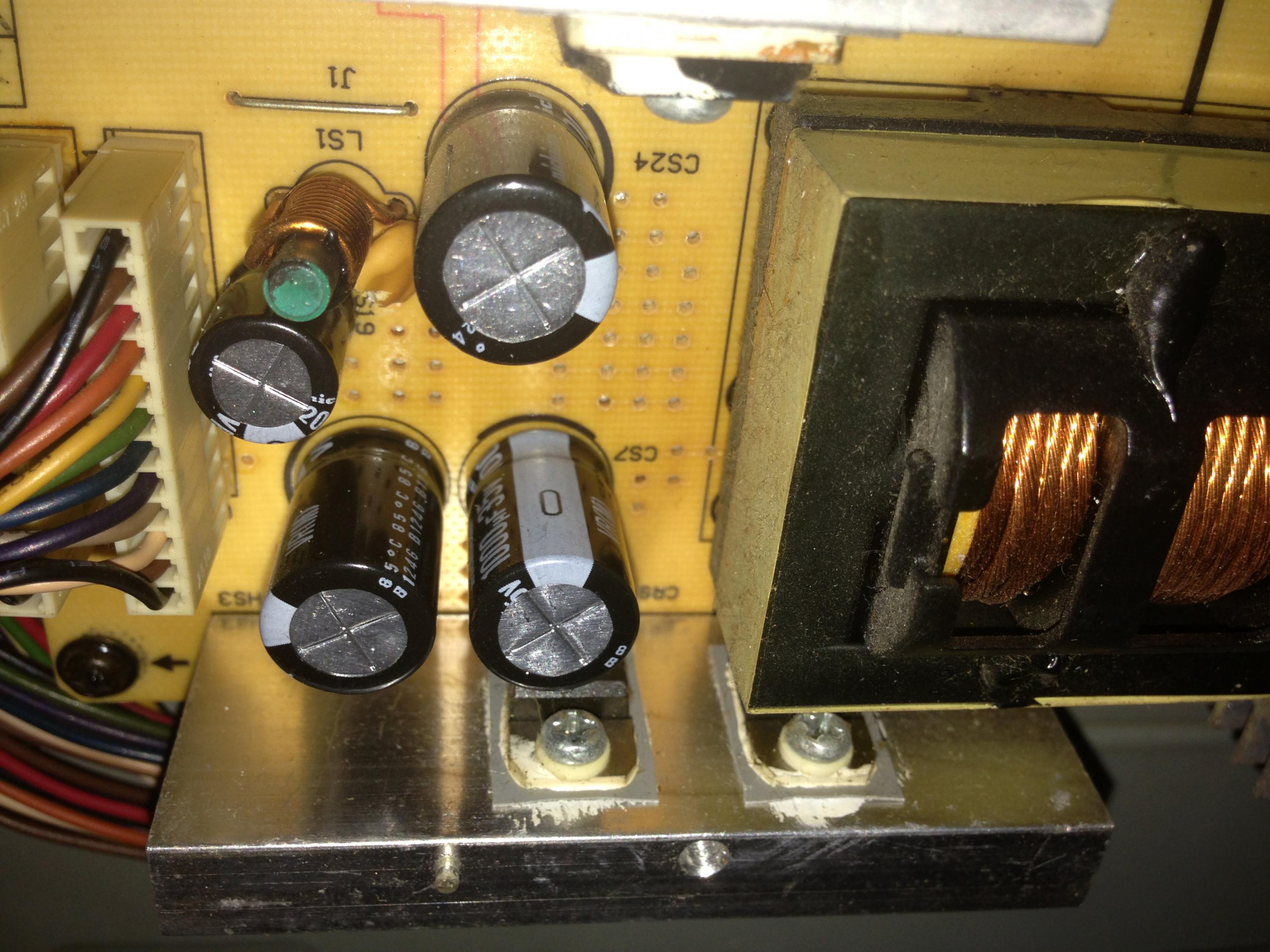

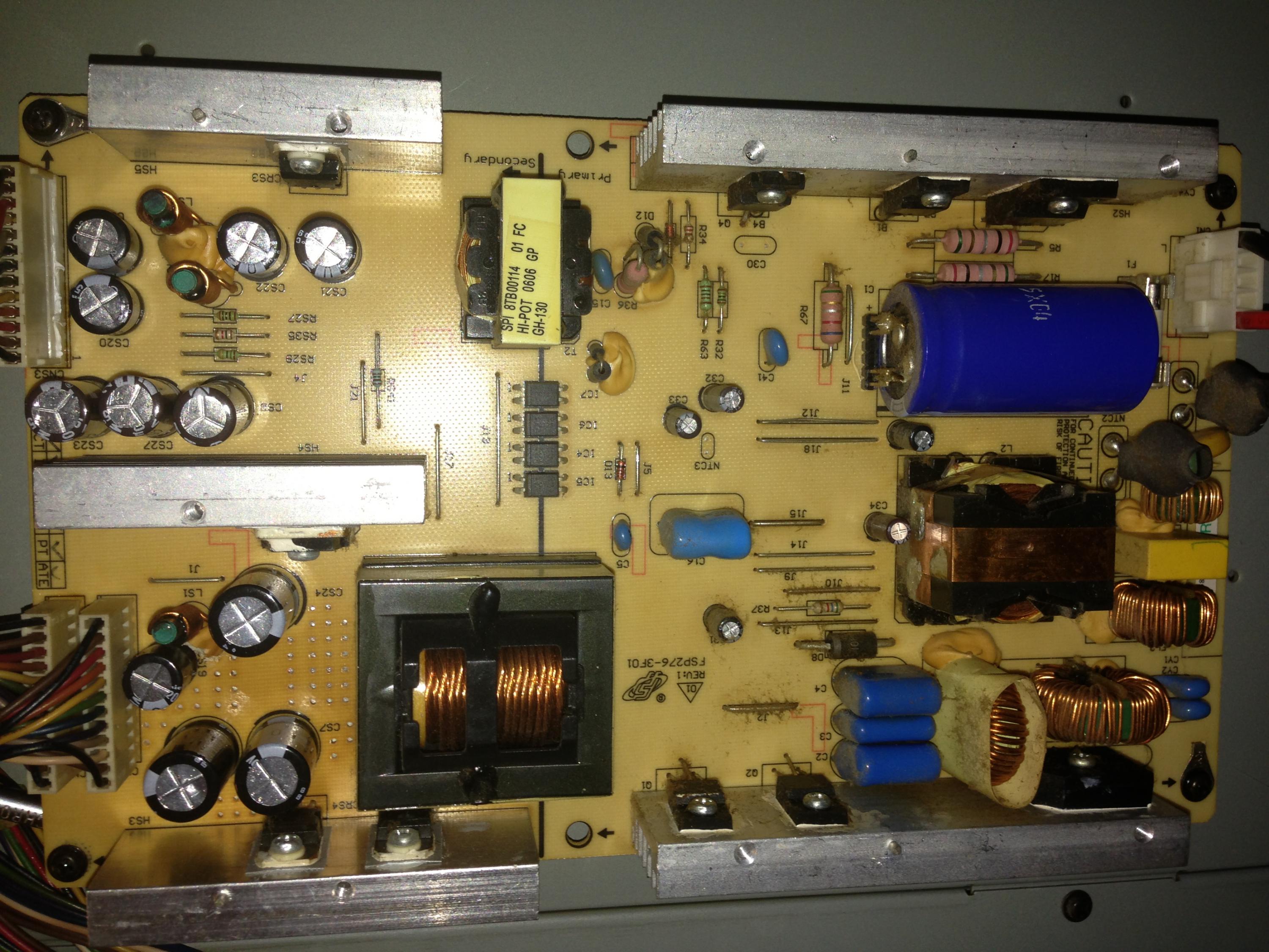

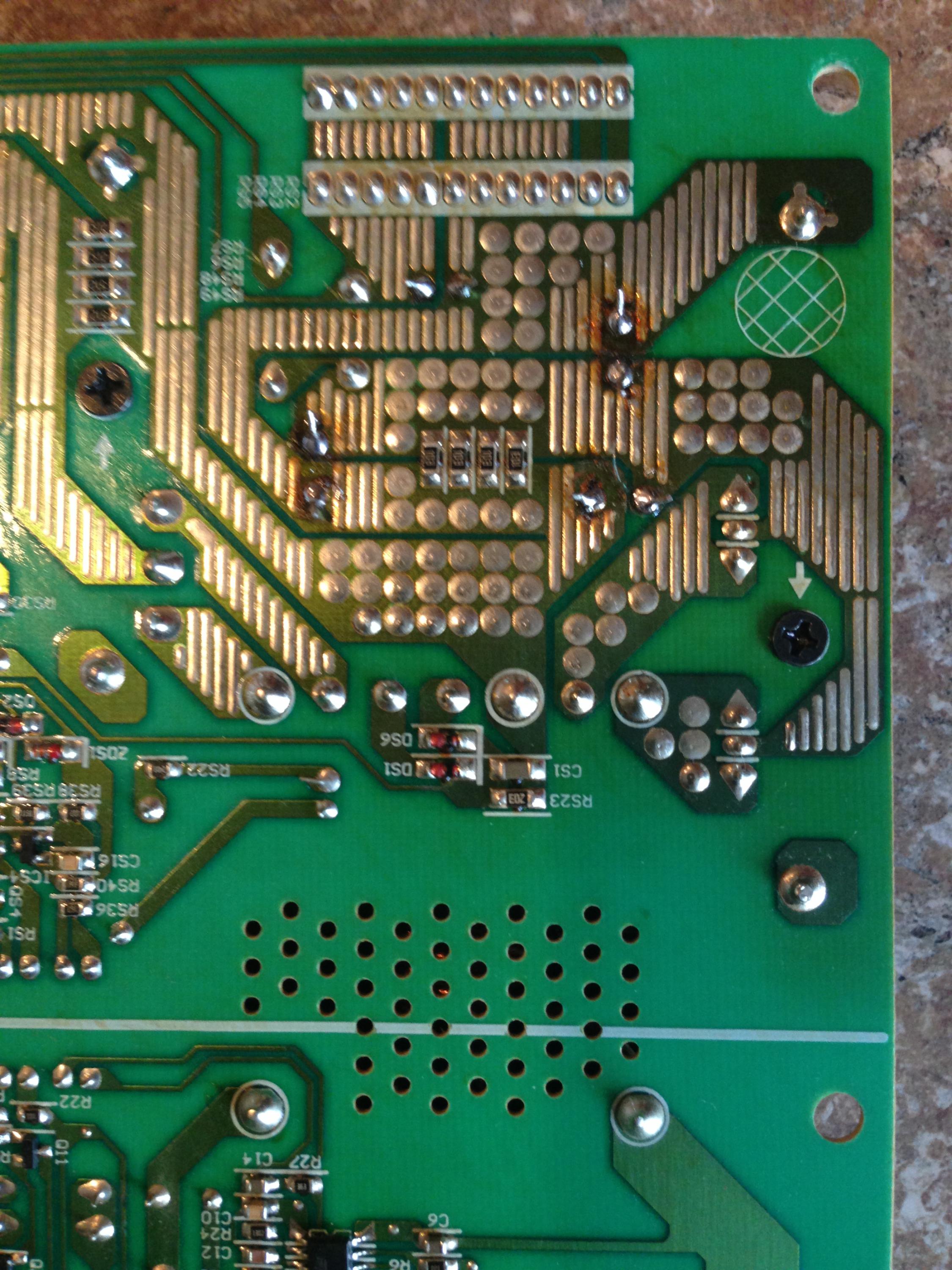

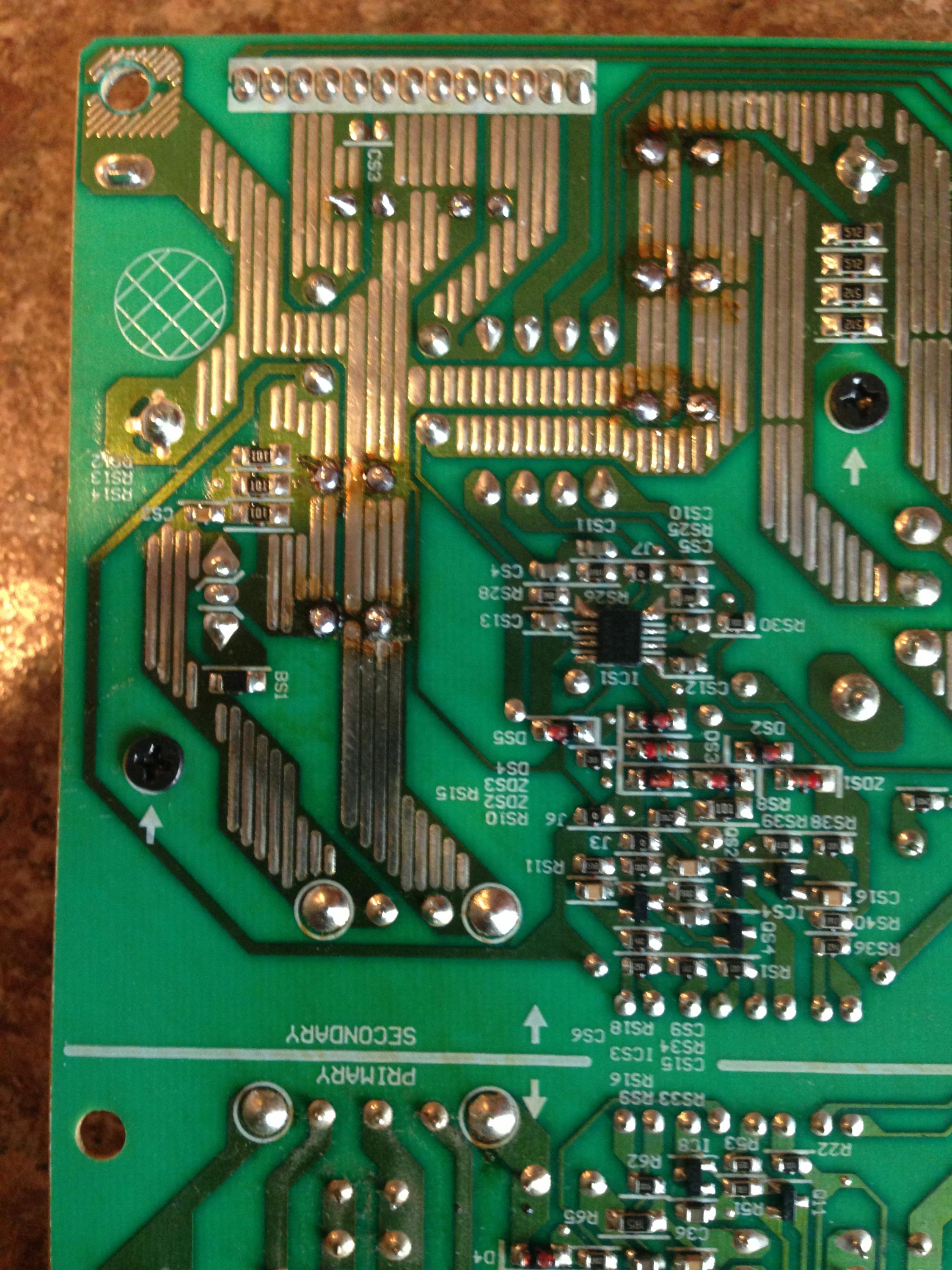

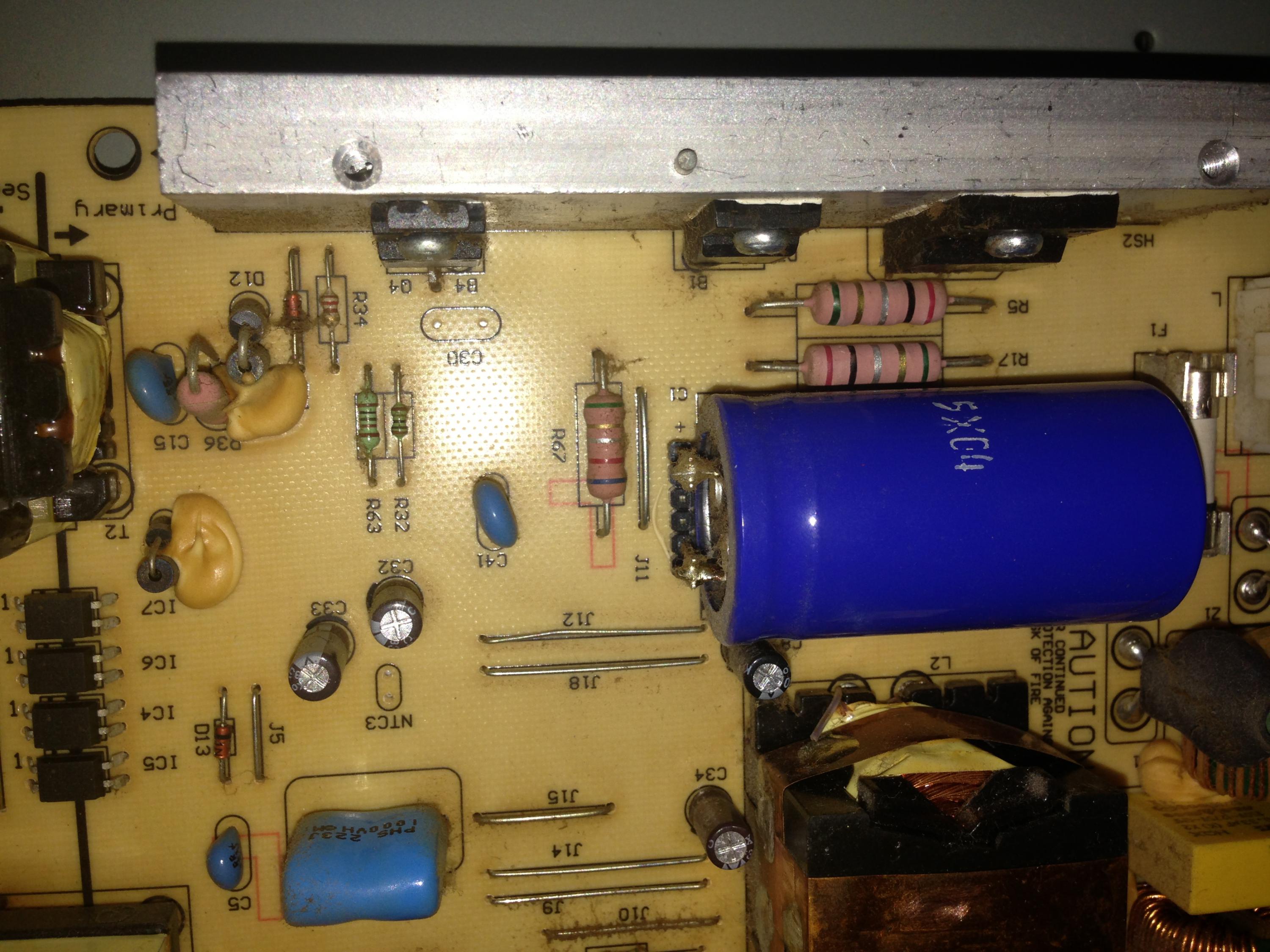

              Hope these are close up enough.. I tried scanning the board in my scanner but it was blurry and too big to post.
              I looked it over before I bothered with the caps and to my untrained, noob eyes nothing jumps out at me.
              Does standby power working mean the problem should be on the secondary side? if its the PSU thats the problem

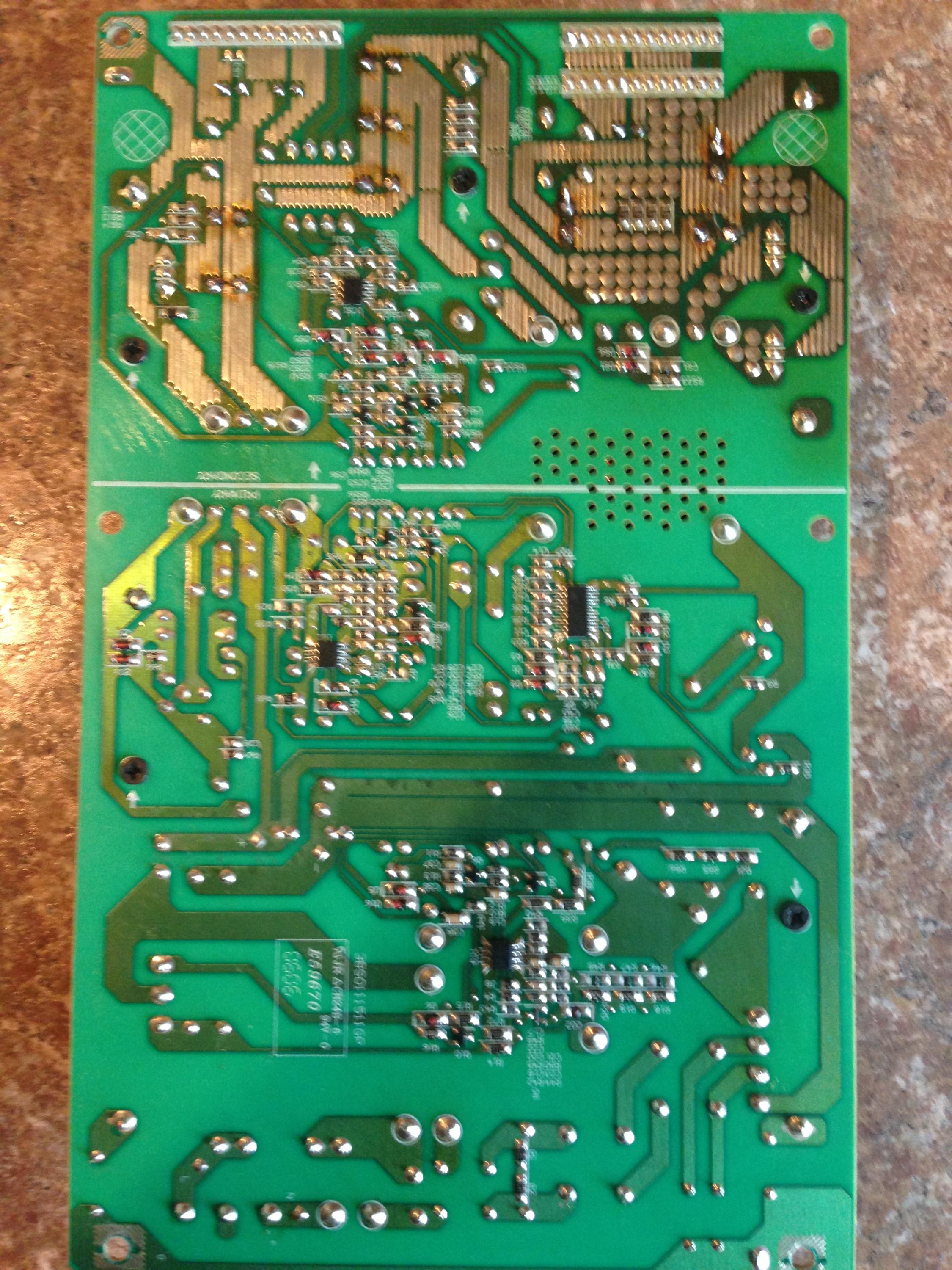

                Can you redo the picture of the whole bottom side (pic 1), it is blurry?
                Next step is to find out if the DC voltage on that LARGE blue cap will be at around 380~400VDC when you hit the power switch, at OFF mode it should have about 160~170VDC measure right at the two legs of the cap, be careful no to touch anything with your hands, to be safe you should plug the TV into the GFCi outlet.
                  Here is a new pic of the backside. Hope its clean enough (I'm taking these pics with an iPhone).
                  Going to reinstall the PS in the Tv to test big blue cap (per buds instructions) now, thanks guys.
                    Ok, big blue cap tested.
                    Off: 155~165
                    TV Power on: Shot right to 400
                      Did it stay at, or around 400V (380 to 410V)?

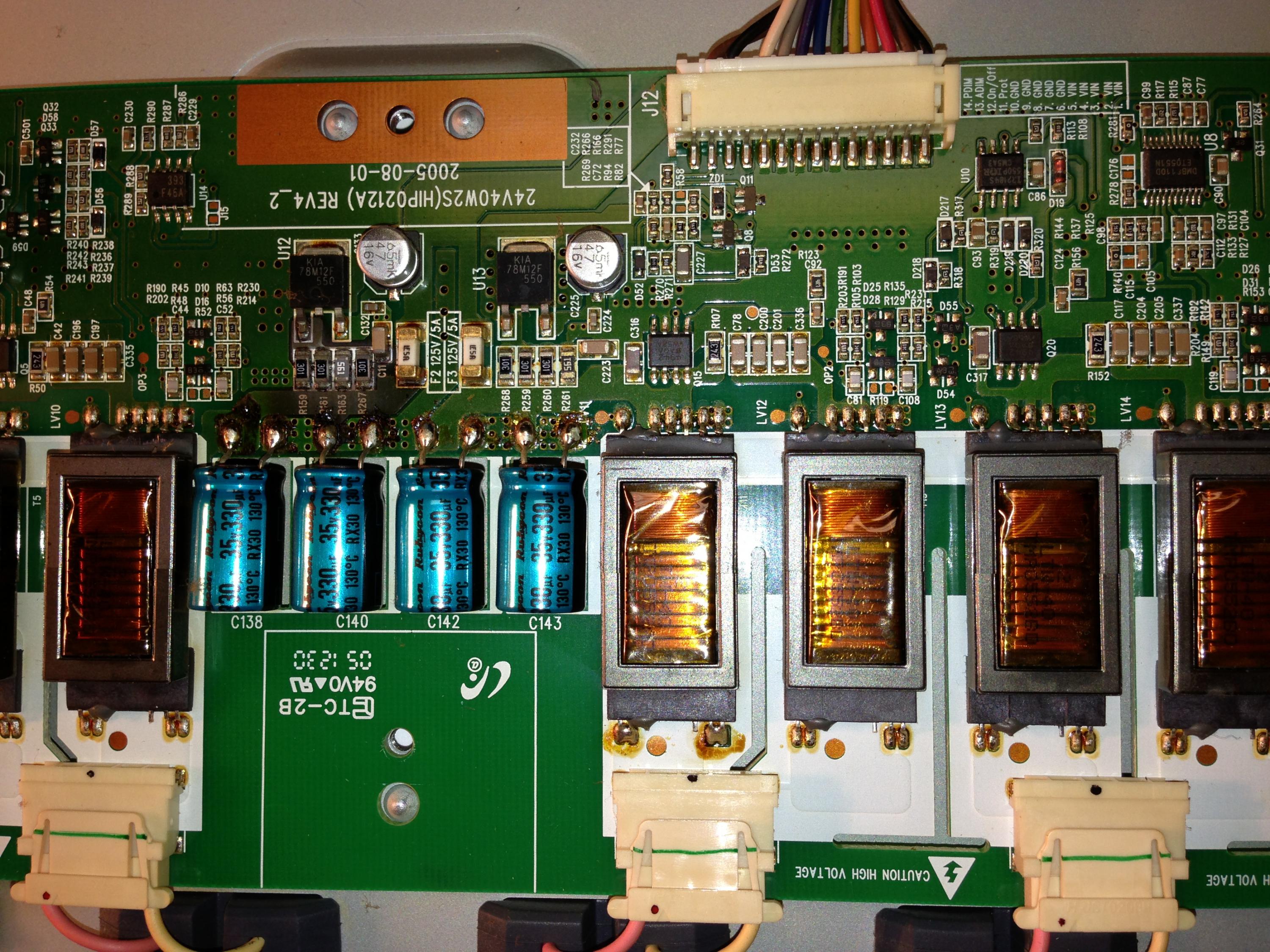

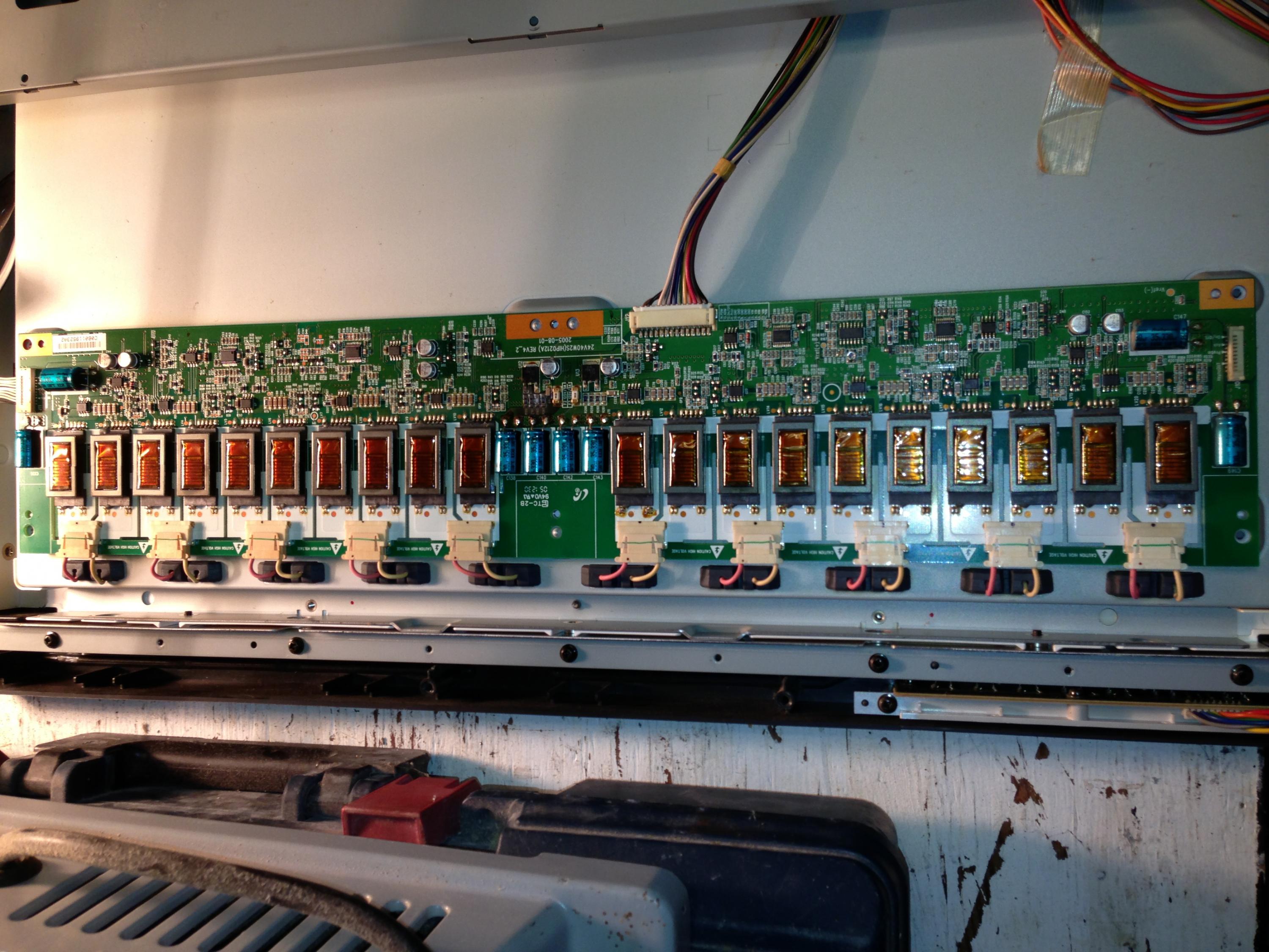

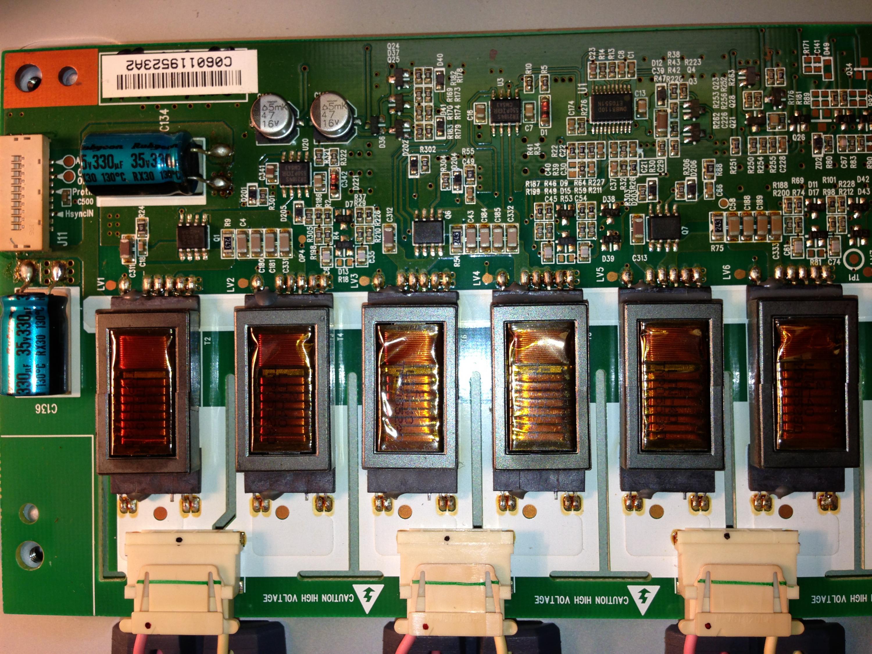

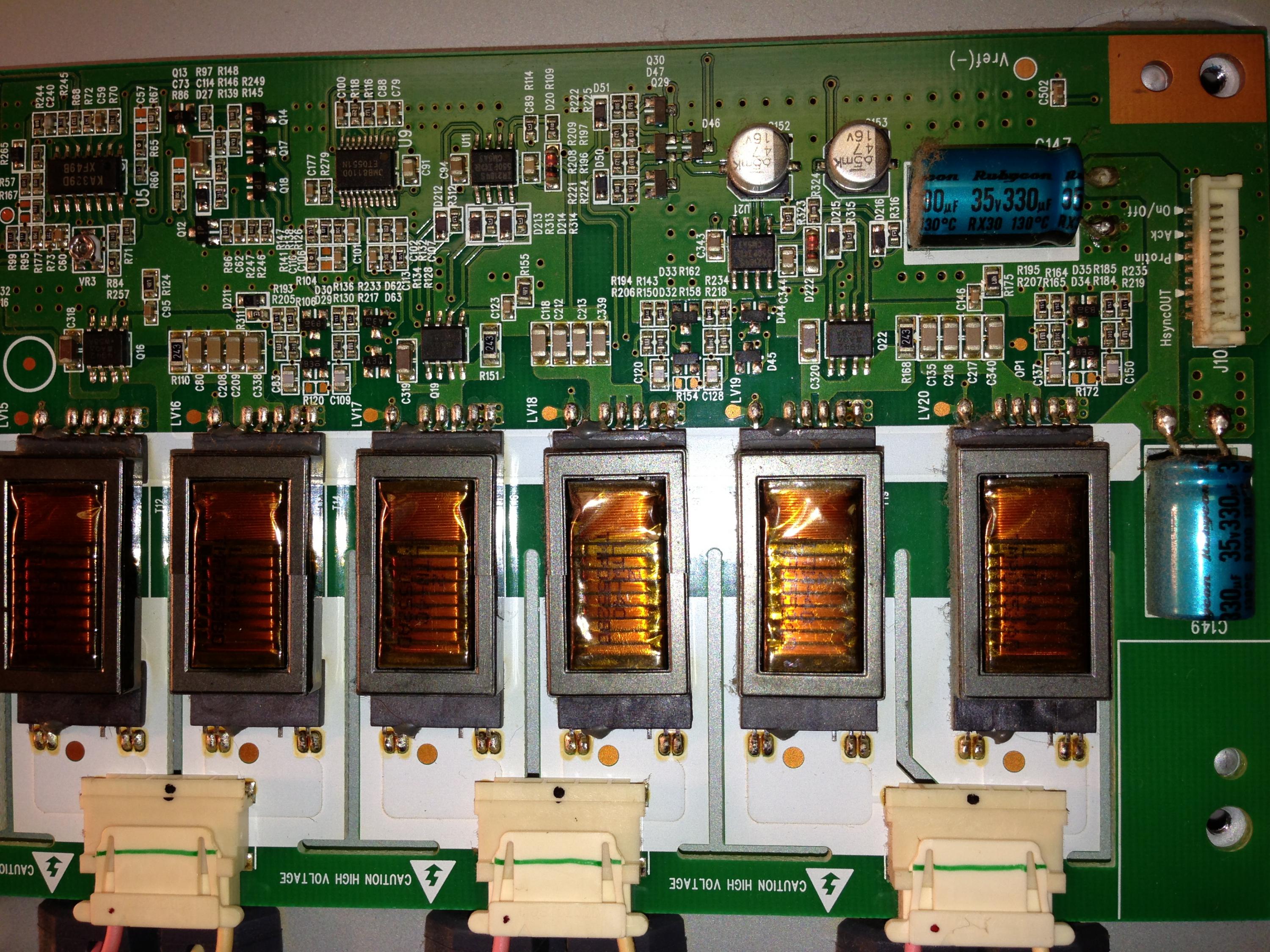

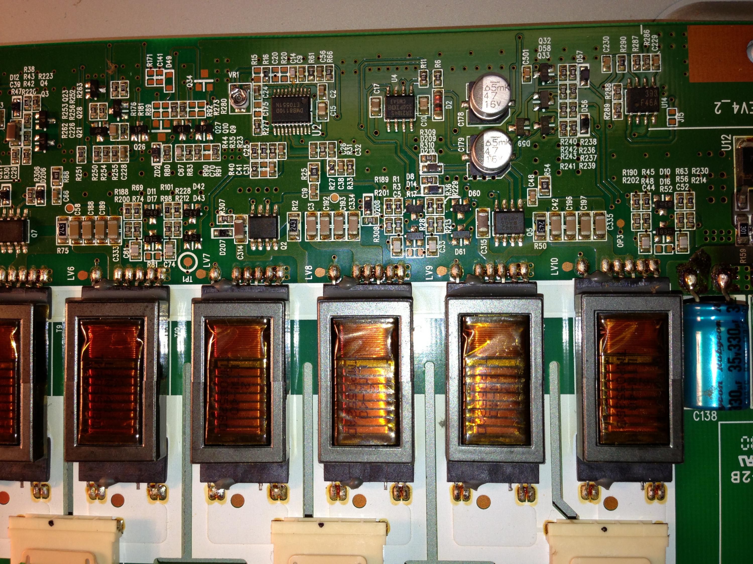

                                        well I have her opened up and I guess I have 2 inverter boards? one on either side of the screen. The one has what my limited knowledge looks like burnt area. I tried taking pictures but the lighting was so awful I need to find a lamp.
                                        Question though, If I have 2 inverter boards and the screen is black on both sides does that mean the both of them are probably messed up?
                                        Ok, looking for a lamp, hope to have pics up soon!
                                        Originally posted by budm
                                        By the way, the voltage reading are from all the boards are connected, right?
                                        I missed this question..
                                        No the inverter cables were disconnected. Is that bad?

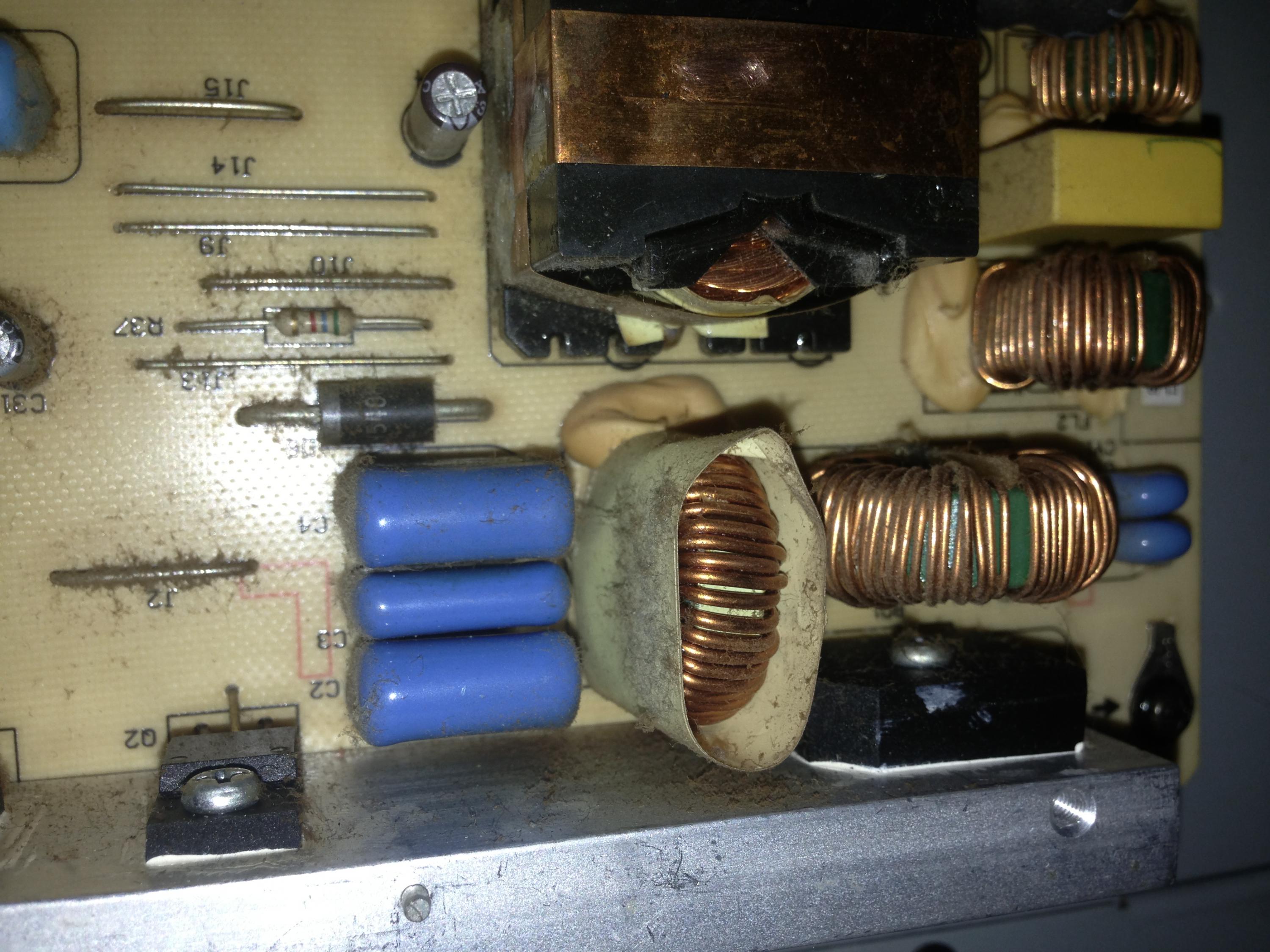

                                        Ok Pics are up of board 1. In pic 4 you can hopefully see the discoloration of the thick traces.
