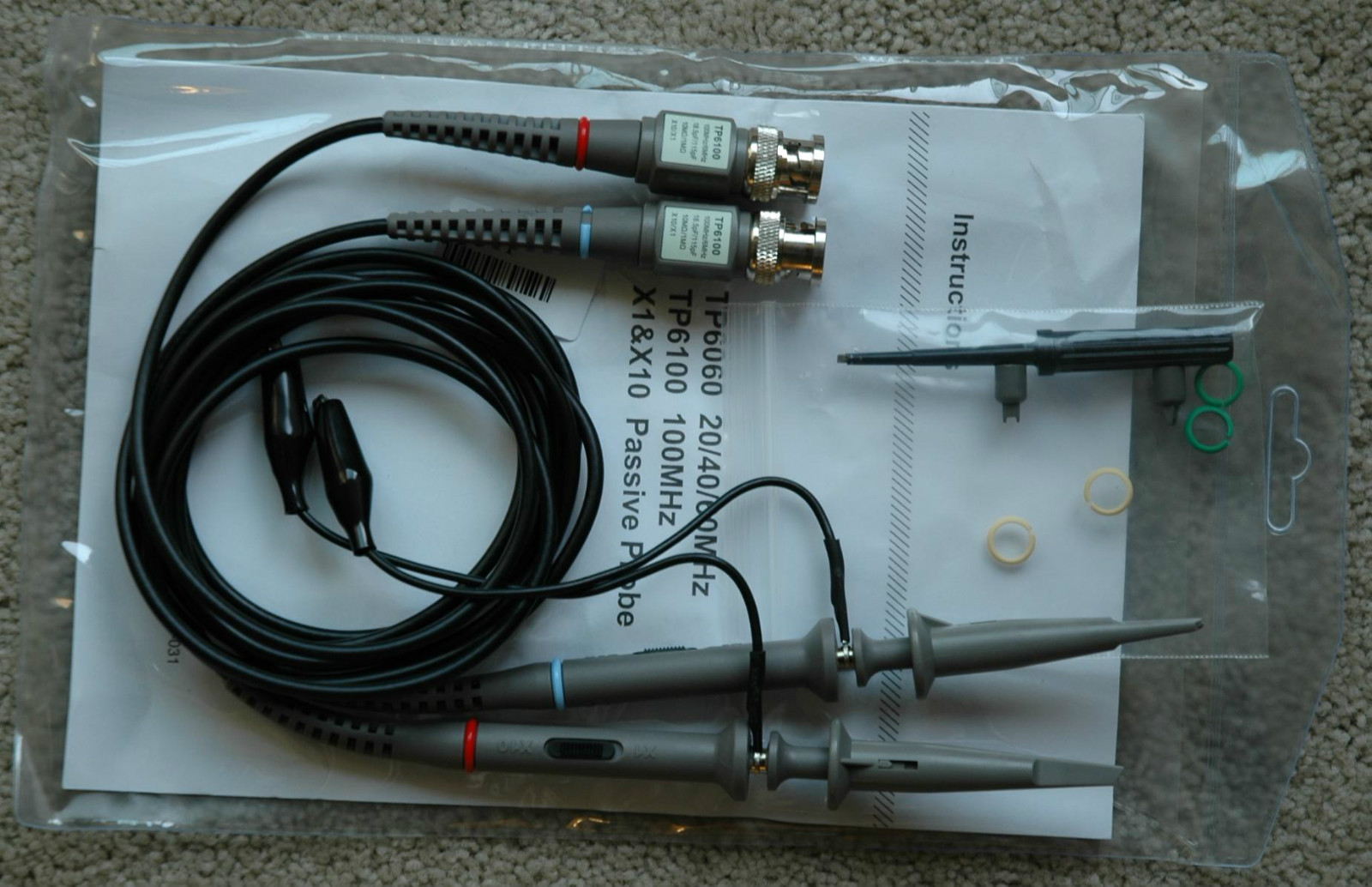

    Hello everyone. I just bought my first oscilloscope. It's a Hitachi V-1065A DC-100MHz 2 Channels 40W oscilloscope. Seeing how I'm going to use it to try and fix TVs I thought this would be the right place to post. It doesn't come with any cables, I've never used one before. I ordered it through E-bay. The link to it is http://www.ebay.com/itm/261258262152...84.m1497.l2649
    It doesn't appear to come with any cables. What types of probes should I buy for it? Also, does anyone have any good reading material on how to operate one of these things? If it turns out I bought the wrong one for fixing TVs, I could always resell it. I did a little research and someone said that a 100MHz one would be ideal for TV repairs.
    One last question, what exactly do I do with it when I get it? I know they show sin waves and stuff, but what exactly are they for? Reading clock-pulses and stuff like that? Thanks.

    You really need to understand what characteristic waveforms that you expect
    to see in the various areas of the equipment you are fault finding. No simple way to explain this in detail.
    There are inexpensive 100MHz 10:1 probes on eBay which should be ok for most measurements but they tend to be less durable and their voltage rating cant be trusted. Try to measure Horizontal deflection waveforms in a CRT TV and you might damage the probe and oscilloscope.
    To safely take measurements in this area, you need a 100:1 probe rated at 2Kv or more.
    I like to use genuine HP probes like 10071A. They never fail but the plastic cord covering goes stiff after 10 years of use.
    Try searching for "how an oscilloscope works"

        The brand of probe doesn't matter.
        You can use the 100:1 probe for most other measurements also but it may be a little clumsy because of its likely larger size and the 100:1 attenuation will be problem when measuring small signals.

                      Basically, to answer your last question (this applies to passive probes), probes are generally manufacture specific as the probe, if it's an attenuating probe like the standard 10:1, need to be compensated by adjusting a small screw inside the probe that is adjusting a cap. This is done by connecting the scope to a 1 KHz square-wave signal at 300mV to 1V Pk-Pk and there is a small access hole in the side of the probe to insert a tuning tool. You adjust it for maximum squareness of the waveform. When you turn the screw one way, the sides of the wave peak-up and when yo turn it the other way the sides have a smooth curve.
                      Active probes are generally only needed for circuits that have an impedance higher than about 1 meg ohm. The passive probes (10:1) generally have a 10 Meg Ohm resistive input an between about 7 to 15 pf input capacitance depending on the scope brand. This is why the probes are generally scope brand and model dependent. The problem you get into is that the probe will not compensate as I described it above. You can use another brand or model of 10X passive probe so long as it will compensate to your scope with a nice square (both sides & top & bottom) square wave. Since the 10X probes are generally 10 Meg Ohm, they will not load down a 1 Meg Ohm Circuit much and your measurement accuracy will remain fairly high with about a 10% error on voltage readings on the low side due to the voltage divider effect of the 1 meg ohm ckt with the 10 meg ohm probe. If the circuit impedance is below 1 meg ohm, your accuracy will be even better.
                      My recommendation would be use a passive probe and use a TP6100 for your Hitachi V-1065A, hope this helps

                          Thanks for the reply. I found a couple P6100's on E-bay. Was the TP6100 a typo?

                            I think I found a pair! http://www.ebay.com/itm/Two-x1-x10-1...item2580c95723

                              here's photo

                                Okay, those are the ones I just bought. They look identical, minus the rings. It comes with rings but they're not on and the ground is hooked up on the picture of the two I bought, everything else is good though.

                                      I think the 2KV one will be enough. Any voltages higher than this in a CRT TV are DC which have no need to be checked with an oscilloscope if at all. These voltages are usually measured with a multimeter and 1000:1 probe. Best to avoid these areas for now.
