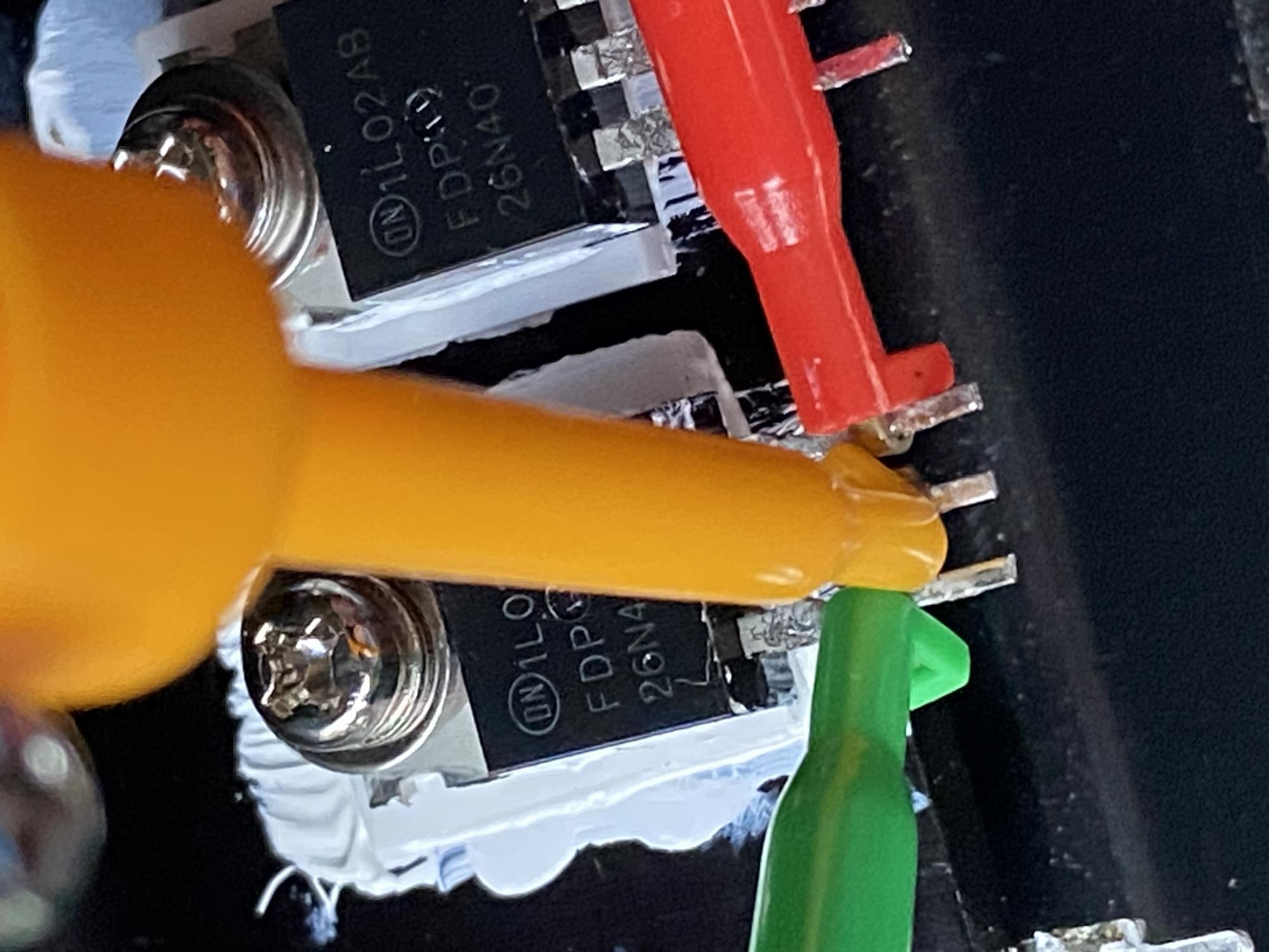

    N channel mosfets testing as P type?
    Working on a smps.
    Using Fluke 115. Red probe in red socket. Black probe in black/common socket. Meter set to diode mode.
    Removed a pair of mosfets marked 1L02AB FDP
    26N40 from the circuit.
    The pair of Mosfets are still screwed to the single heatsink. Mosfet printing facing me.
    I did the test where I short the left and center pins. I put black probe on right pin and red probe on center pin. I get OL. While keeping black probe on right pin, I put red probe on left pin and get OL. After a few seconds I move red probe from left pin back to center pin and still get OL.
    Now, even after I short the left and center pins, if I switch the probes put the red probe on the right pin and black probe on center pin, I get .49v. The center pin never measures OL even after shorting the left and center pins when measured like this.
    This happens with both mostets. But there is no short from the left pin to the center pin (gate to drain).
    What's the deal?

      Pics?!! A video!
      Seriously, I have no way to hold my phone and use both hands to test the mosfets.
      Watch any video on "how to test N channel mosfets". That's exactly what I did. Only when I switched polarity of the probes did I get a reading. But what deepens the mystery is that mosfets usually short at the gate and drain pins. I show OPEN between those pins.

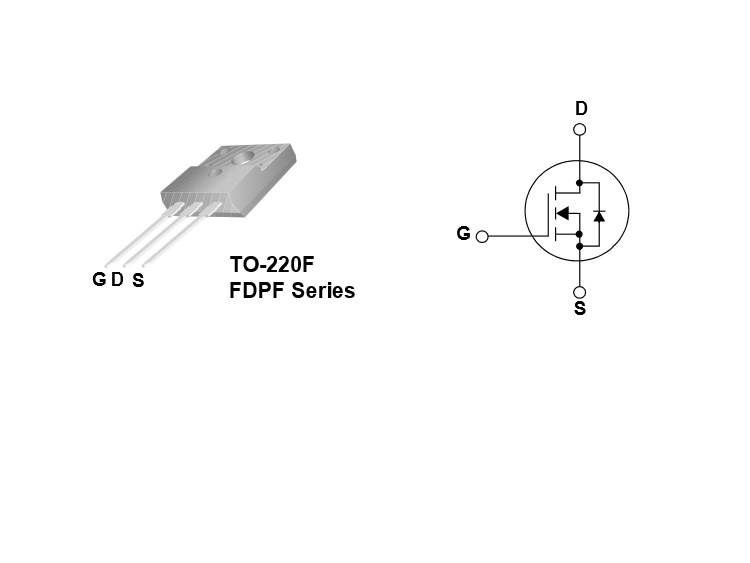

        You are likely measuring the internal diode junction across source and drain

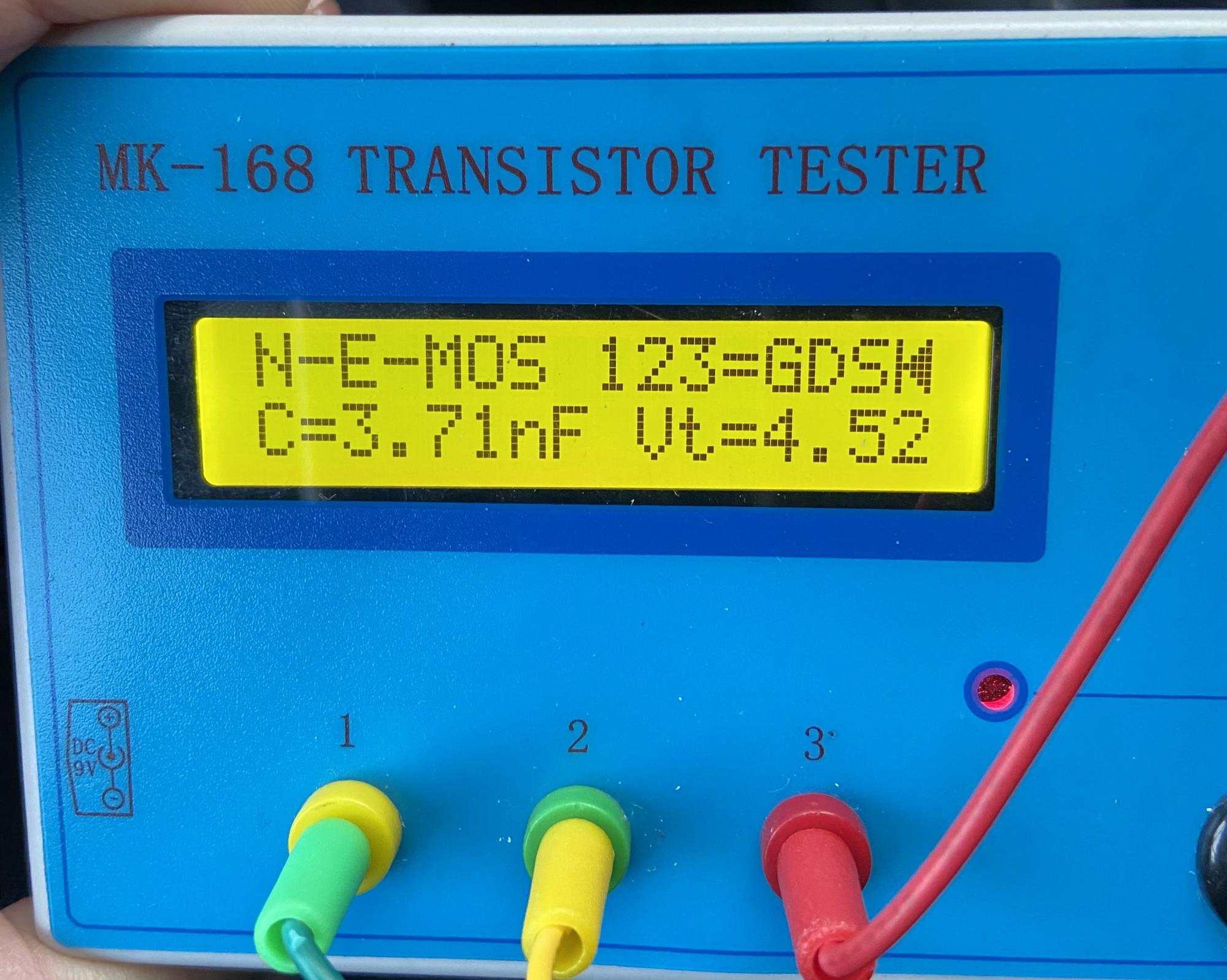

                          I don't know how helpful this will be, but...
                          if I place the mk168 parts tester leads just on the left and center pins (gate and drain), I get a capacitor with either 2652pF or 1947pF depending on orientation of the leads.
                          If I place the leads on the left and right outer pins (gate and source) I get a capacitor with either 3274pF or 3190pF depending on orientation of the leads.
                          If I place the leads on the center and right pins (drain and source) I get a diode with a diode with a Uf of 561mV and a C of 3.76n. I get the same results when flipping the leads, but the "direction" of the diode changes.
                          • eccerr0r

                            well that's exactly what it should show so far, just need to charge the gate properly I think.

                                    Have you looked at the datasheet? maybe the meter does not supply enough gate threshold voltage to turn on the mosfet , It seems to need a min. 3v, max. 5v

                                      Yes. And the mk168 tester identified the pins as that in the picture. Gate, drain, source, going left to right with printing on the mosfet facing you. I just installed a new battery into my fluke and I'm getting the same results.
                                      Do you agree with everything I've read that I should be placing negative probe on the right/source pin and the positive probe on the center/drain pins to get a reading? That gives me OL. if I switch the polarity of the test probes, that's the only time I get a .49v reading from source to drain. Shorting the gate and drain makes no difference. I always get the same .49v reading between drain and source

                                        There is a diode inside between drain and source.
                                        The fluke 115 diode test range (according to the spec.) is 2.00v, now check the data sheet for this mosfet On Characteristics, Vgs Gate threshold voltage
