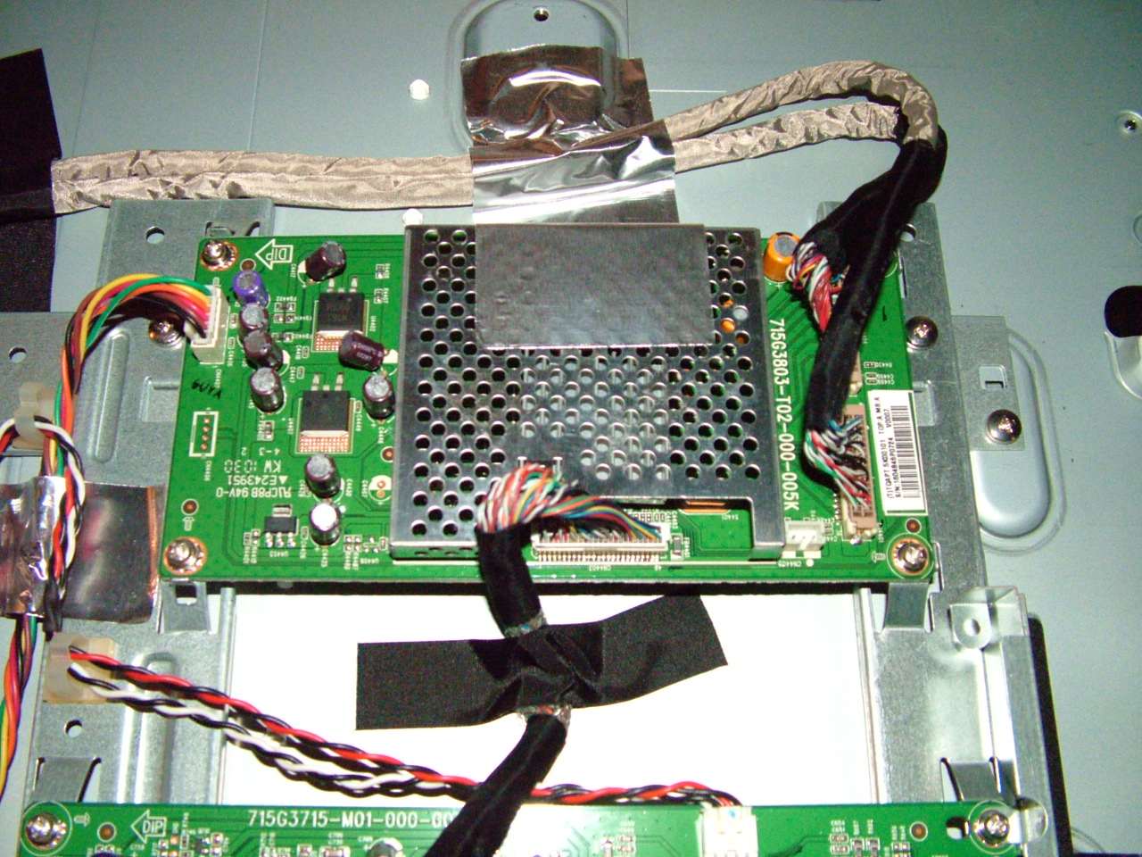

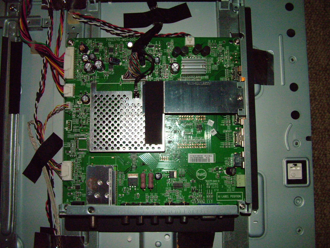

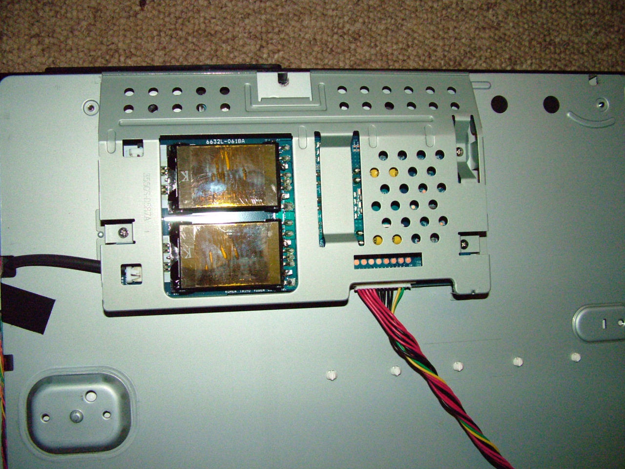

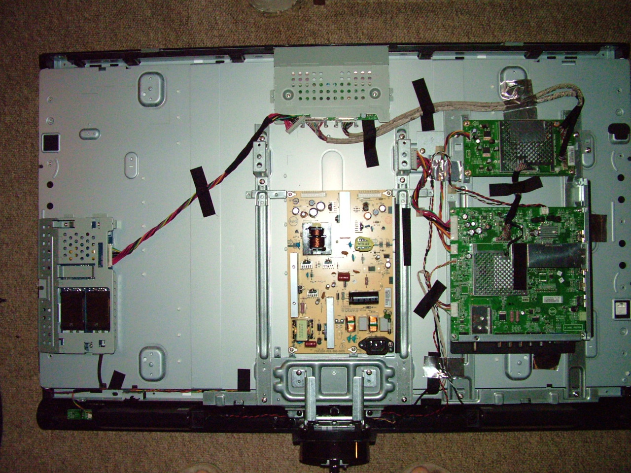

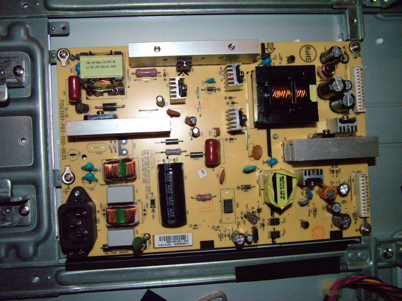

            Attached are pics of five boards and entire chassis. Thanks for your help.
              Re: Vizio E371VA lightning surge - no pic or sound
              Since the power LED is working, the 5vSTBY power supply is working, more likely that the main board is damaged.
              You can force on the backlights by connect 1K resistor btween the PS_ON pin and the 5VSTBY pin, and another 1 K resistor between the BL_ON pin and the 5VSTBY pin to see if the backlights will come on.Notes, you muast disconnect the wires between the main baord and the power supply board to do the force on test.

                I'm sorry but you're way ahead of me. Where are the pins you are referring to, and how do I connect this resistor? Please understand I am new at this. Thank you for your help.
                • sumdumgai
                  • Aug 2013
                  • 33

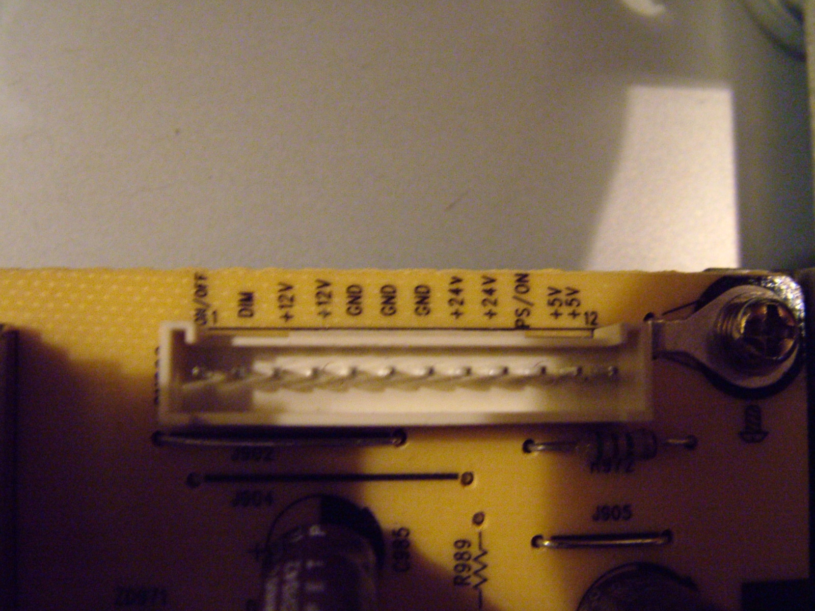

                  OK, I think I found the PS_ON pin (3rd pin) on the power supply board on the connector going to the main board. There are two +5V pins (1st and 2nd pins) next to the PS_ON pin. Are these the 5vSTBY pins? Can I use either as 5vSTBY?

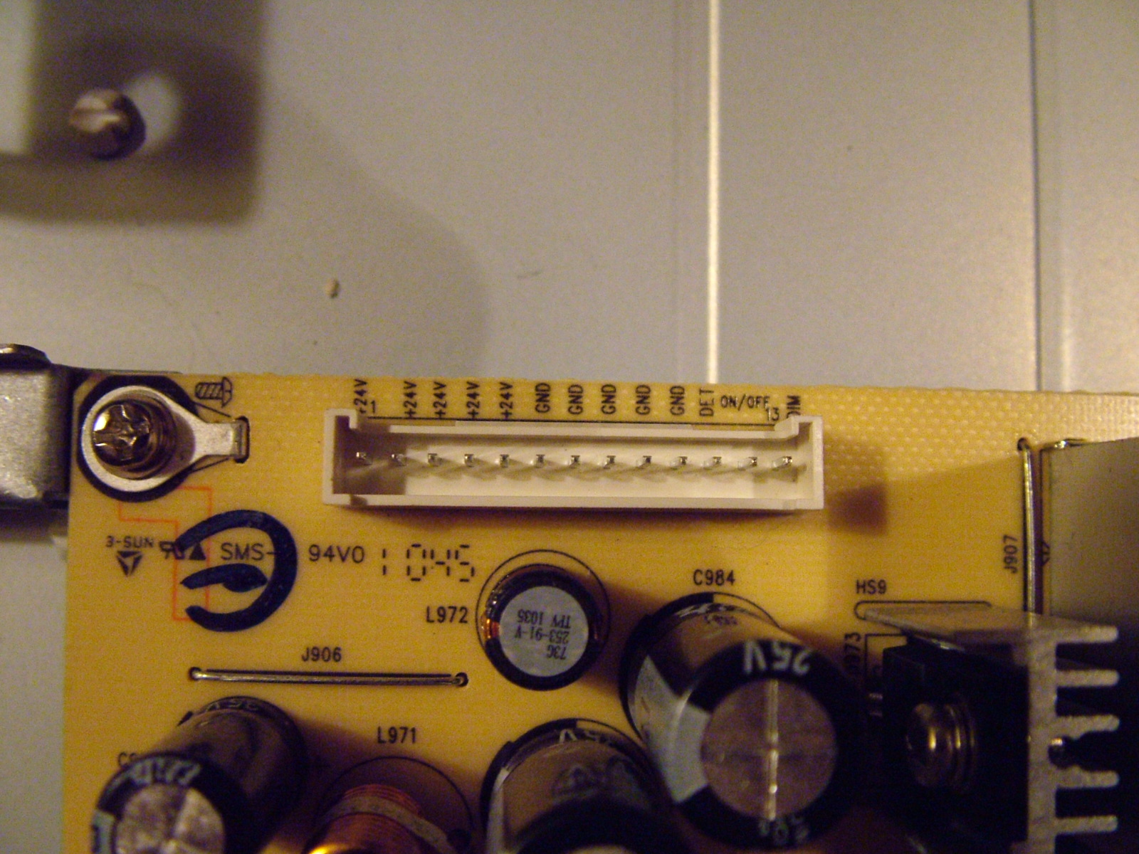

                  Where is the BL_ON pin?
                  Thanks for you help and patience.
                    Picture of main board connector on power supply attached. Is the BL_ON pin any of these? Thanks.
                      Can we get a pic of the other connector on the PSU?
                        on/off = BL_ON
                        May need to have 1K resistor between the DIMM (Backlights Dimming control) and the 5VSTBY if it is an analog control type signal, just do without for now to see if the backlghts will stay on.
                        Check to see if the 24V is present also.
                        Make sure to disconnect the cable between the power supply and the main board.

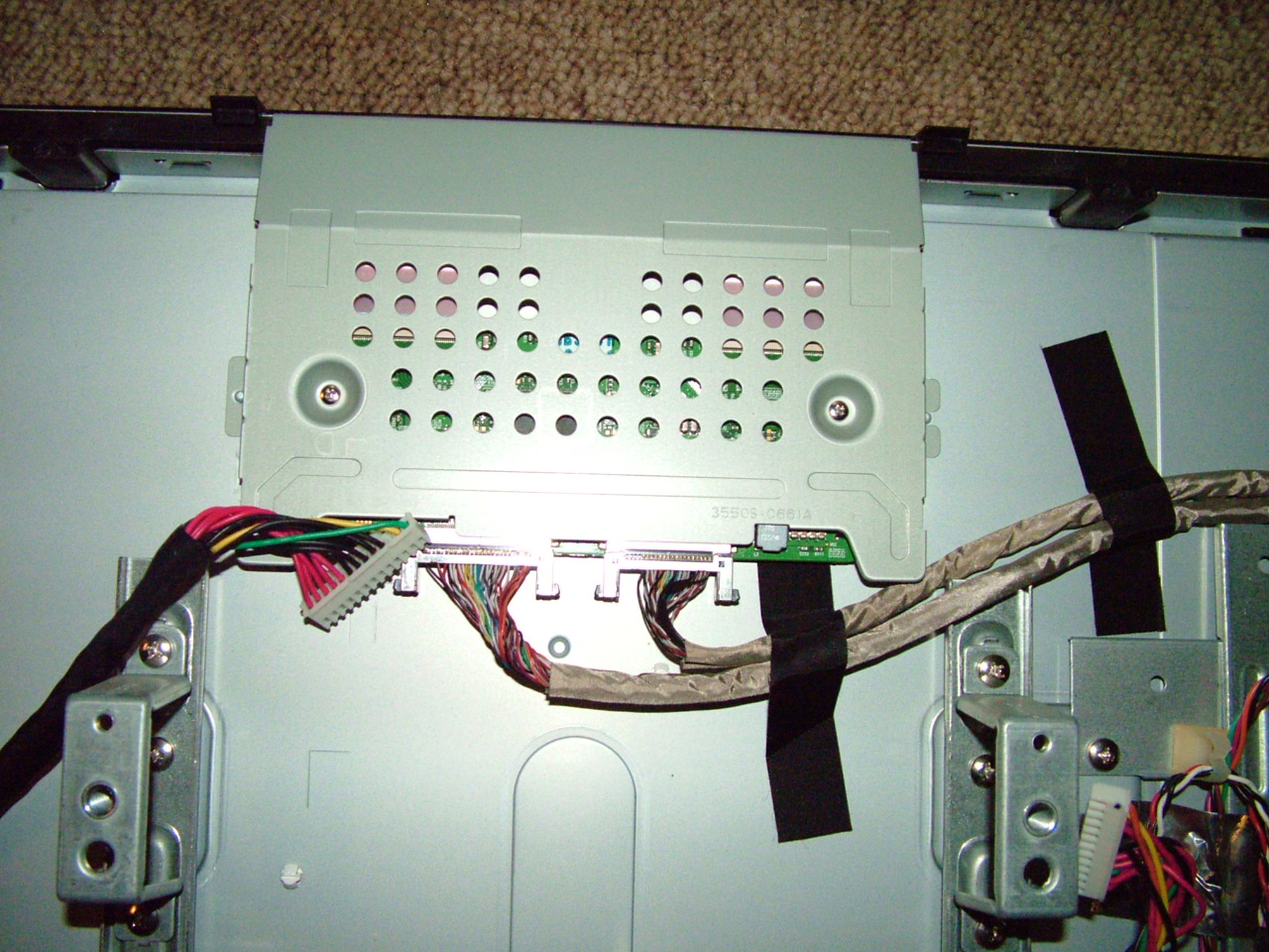

                          Pic of other connector attached.
                            So, if I understand you correctly, I am to connect a 1K resistor between the PS_ON pin and a +5V pin on the PSU, and another 1K resistor between the ON/OFF pin and the other +5V pin on the PSU connector that goes to the main board. The cable between the PSU and the Main Board is disconnected. The other cable on the other PSU connector remains connected to the inverter (I think). These connections should force the backlight to come on. I will also measure the voltage on the 24V pins on the PSU connector, with TV off and then on.
                            Please confirm. Thanks.
                              That is correct. You should measure 24V when TV is plugged in with the resistors in place.
