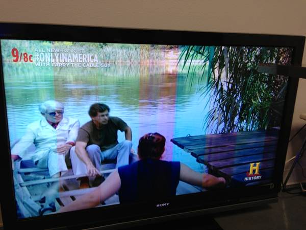

                                Possible purchase. Didn't want to start another thread, just a quick question.
                                What do you think that could be here, bad panel?
                                • Junky228
                                  • Jul 2013
                                  • 2
                                  #36
                                  Re: Sony KDL - 52W4100 powers off after turn on, gives 14 blinks
                                  Don't hold me to it but i think it's the bulbs failing.
                                    #37
                                    I would say t-con or panel, t-con being very likely. Notice how the bands on the picture don't follow where you'd expect the tabs to be so unlikely to be panel. Probably SONY MOTIONFLOW processor failing on T-con board.
