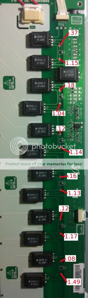

      Ha, I've watched that video a few times. My board is a bit more confusing. Here's what I came up with on the left side. Not sure I'll have time to get to the right side today, but I'll try
      and
      I was getting weird readings with the TCON unplugged so I just unplugged the whole unit in between reading each pad. The numbers given are as it stabilized right before shutting off.
      Any thoughts? The sequence is a little hard to understand and it's not a straightforward as I thought it would be. The one on the very top and bottom seem to be the most off.

        Thus far, I've tried replacing the right and left Balancer boards, and, as stated, the main board.
        OK, here is the top right side:
        and the bottom:
        I'm at a total loss. Anything stand out to you smart folks?

            OK, I read the thread again, are you getting 13 Error? or 14 Error? Page 59 of the training manual. 0V = BAD, 11.5 = OK.
