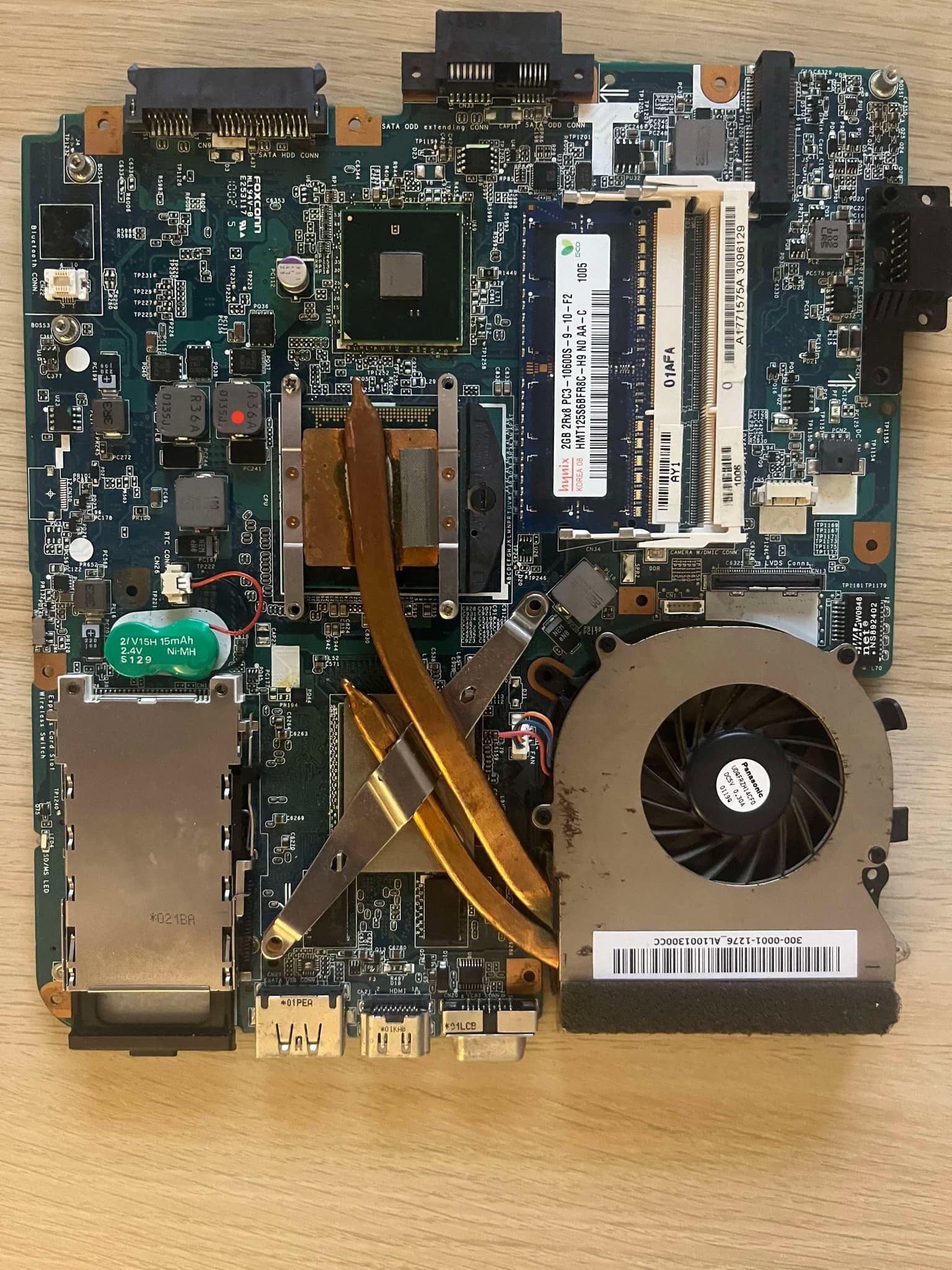

    Click image for larger version  Name:	IMG_5746.jpg Views:	0 Size:	570.2 KB ID:	3546325Hello,
    I am quite noob in advanced electronics, however I'm trying to fix a Sony Vaio PCG-71211M laptop mainly because I love old hardware. I don't want to send it to a technician because this computer is not important for me, I want to fix it as a hobby.
    Shortly, this laptop does not display any video output when turned on, no POST, nothing. The keyboard leds are on and I can actually turn Num Locks on and off. Sometimes the laptop turns itself off straight away, sometimes, mostly after some attempts, the laptops enters a loop in which the cpu fan spins very aggressively and the CPU, GPU and the entire area gets really hot. After some time, the computer shuts itlsef down completely. I ordered a new identical cpu just because I found one online dirt cheap, but no improvements. I tried multiple ram modules, nothing. After some debugging with the help of chat gpt, I was able to measure two filter near the CPU. One of them reads a constant voltage of around 7v, the second one (the one with red dot) oscillates between 9-ish and solid 0. I tried reading the resistance of the ceramic capacitors, all that I managed to read seems fine. However, I am too noob to be able to read next the other components, mostly because I lack technical knowledge and I don't know hot to read and interpret the schematic of the board which I was able to find. chat gpt suggested there might be something wrong with the power regulators, MOSFET chips or VRMs. I feel overwhelmed at this point and don't know what to do.

    If the mb part number is MBX-224 then its GPU which is bad. Known issue on this platform.
    New genuine GPU is not available and whatever is available are all fake remarked.
    So end of story.

      hi, thank you mcplslg123 !
      that seems to be the motherboard, indeed.
      well, that’s it then. Is there a way to test if it’s indeed the gpu, or should I just throw to scrape?

        Put some good quality bga flux around GPU and then heat it for 1 minute. Dont heat on top of the IC,just around it.
        It is likely to run for few hours/mins like charm and then gain revert back to original status.
        However, i strongly suggest to put it in garbage bin.
