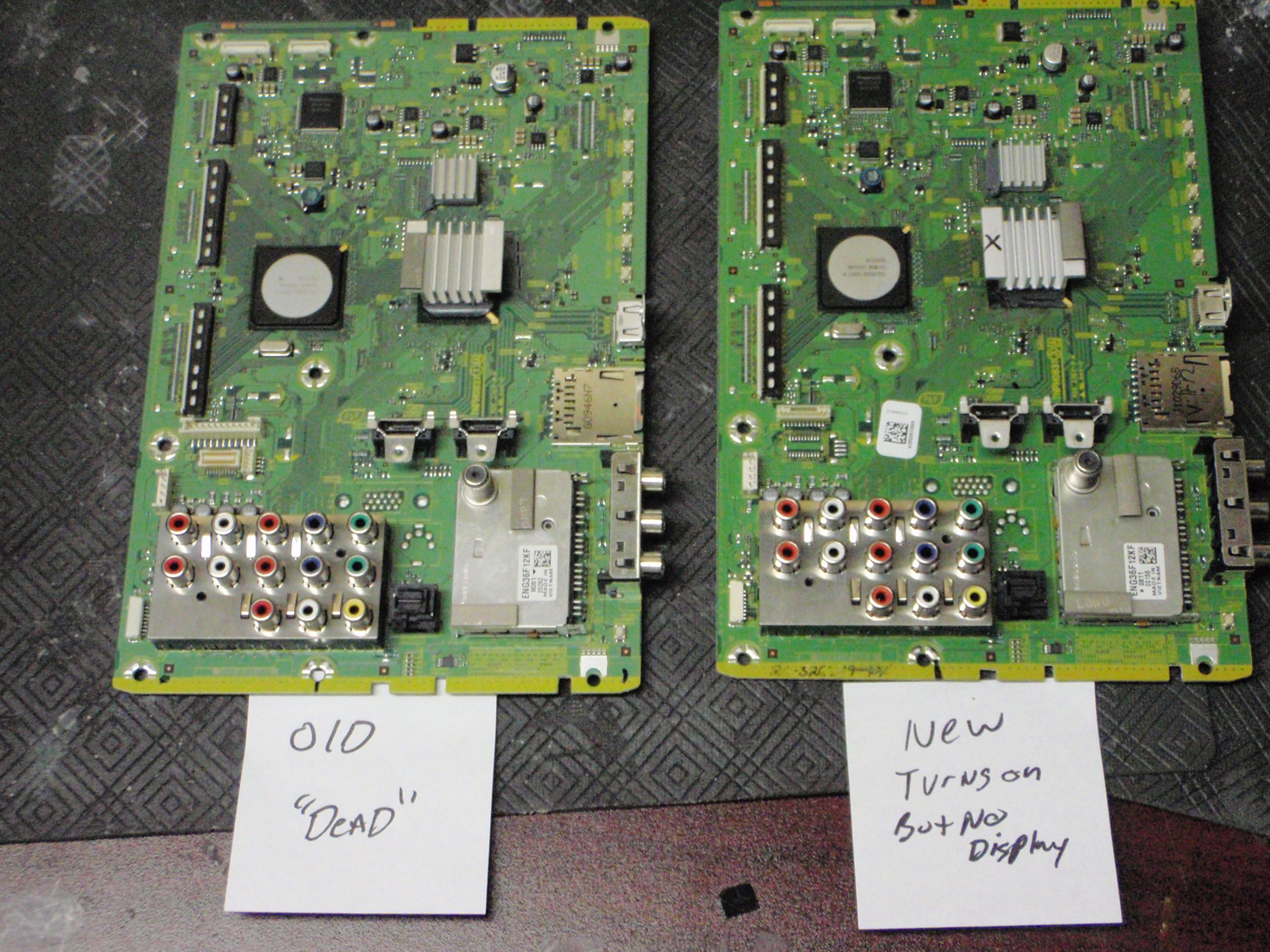

    Hi all been some time since i needed some help been doing pretty good on my own however this set has me miffed atm. OK to get started on the issue with this set it started out as no power on nothing no signs of life no response from power button, so i ordered A board and now i get power on and the panel indeed energizes no menu or a picture it seems to go to service mode but you can't see it on panel i would have to unplug tv to get it to get out of service mode.
    have both the service manual and troubleshooting manual for this set i think the problem is still in A board, could not find exact replacement for TNPH0831 (1) [A]
    so i ended up with TNPH0831(3)[A] as closest replacement and it is a panasonic re-certified replacement A board... any light on this would be great since i am stuck atm.....
    also according to the owner it has some sort of surge however i am finding out these sets have a lot of A board issues and the a board is very pricey want to go more in depth before i send this A board back .

            I think there's more to the revision of the main board than what you've posted. You can have identical board assemblies but different config and parts used on it depending on the model.
            Was the board you replaced from a 42" model?

                well according to the listing it is for a 42 inch Panasonic compatible with certain models this one being one of them, however i think you may be correct i may have a board that is not compatible, finding the exact board same revision i just have no luck finding.... the 2 boards look identical except a connector it does not use and its revision new one is revision 3 and original is rev 1 now i suppose there may be a secret way to change firmware however can't see nothing on screen to do it lol.. looks like i may need to send this bad boy back eh?

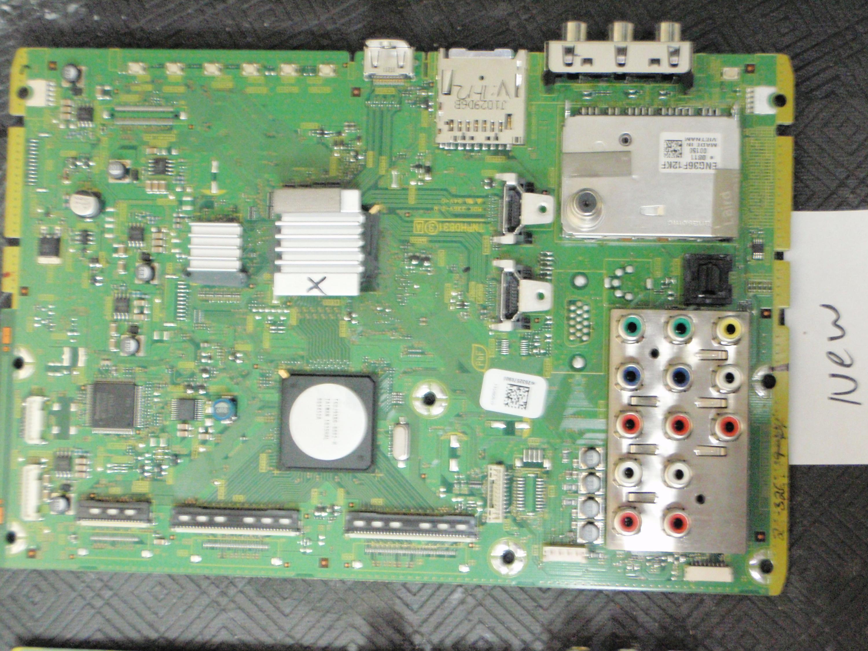

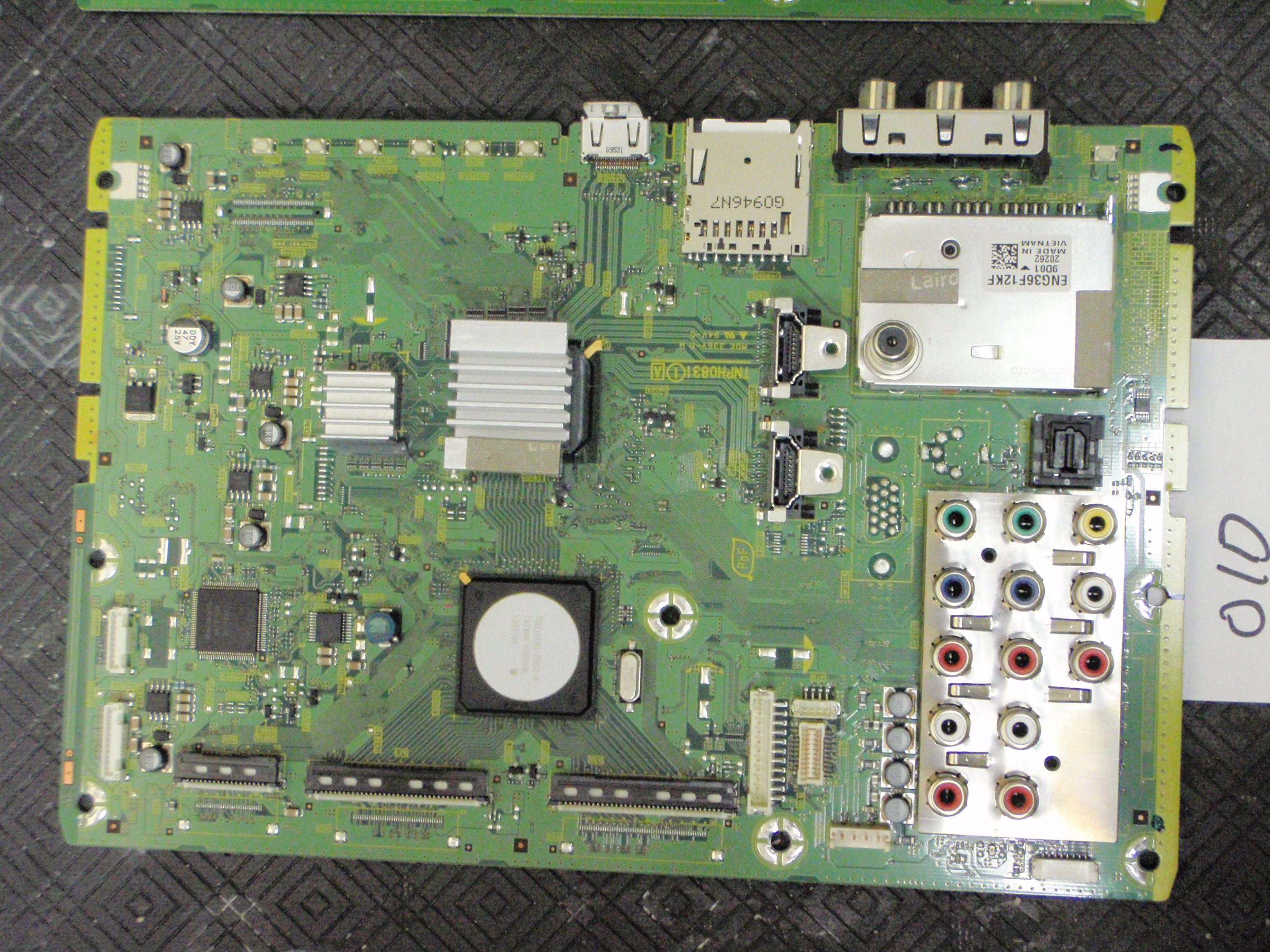

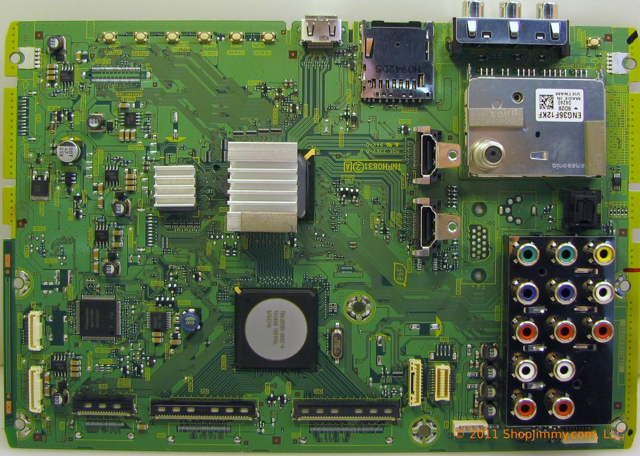

                  I had a look at SJ website and there are a lot of different versions of TNPH0831. I don't believe the 2 or 3 is what to look for. There is a suffix template on the board and the rev is determined by the placement of a series of jumpers.
                  If you post up some hi res shots of both boards it may reveal some clues of what you've got or check out SJ.
                  These are the revisions on SJ
                  TNPH0831 42S2
                  TNPH0831AB 46S2
                  TNPH0831AC 50S2,50C2,P5032C
                  TNPH0831AD 54S2
                  TNPH0831AE 58S2
                  TNPH0831AF 65S2
                  TNPH0831AG 42U2
                  TNPH0831AJ 50U2
                  TNPH0831AR 42PX24
                  TNPH0831AT 42C2
                  TNPH0831AU 46C2
                  TNPH0831AV 50C2

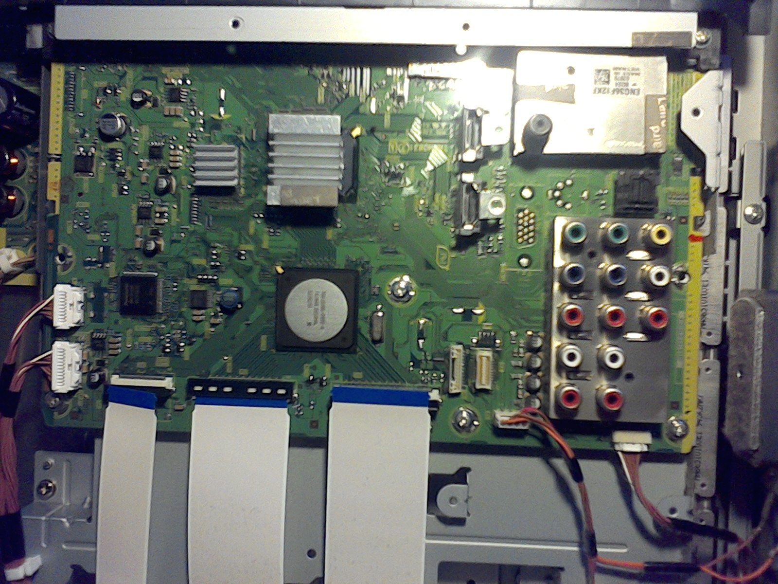

                    okay sorry been super busy however here is some pic's of the boards i cannot find these other numbers other then the ones in pic perhaps i am blind lol...

                      don't see any jumpers , having tough time telling what revision i have, i see the template for it but interpreting it is not very clear ... and both templates have same markings as far as i can tell if need more pics i will upload em...
                      suffix both look like it's marked as AB....

                        From what I can make out , neither had the jumpers there and that would make it no suffix which SJ had listed for your model which was the picture I posted from their site. I don't have any more clues at this stage.
