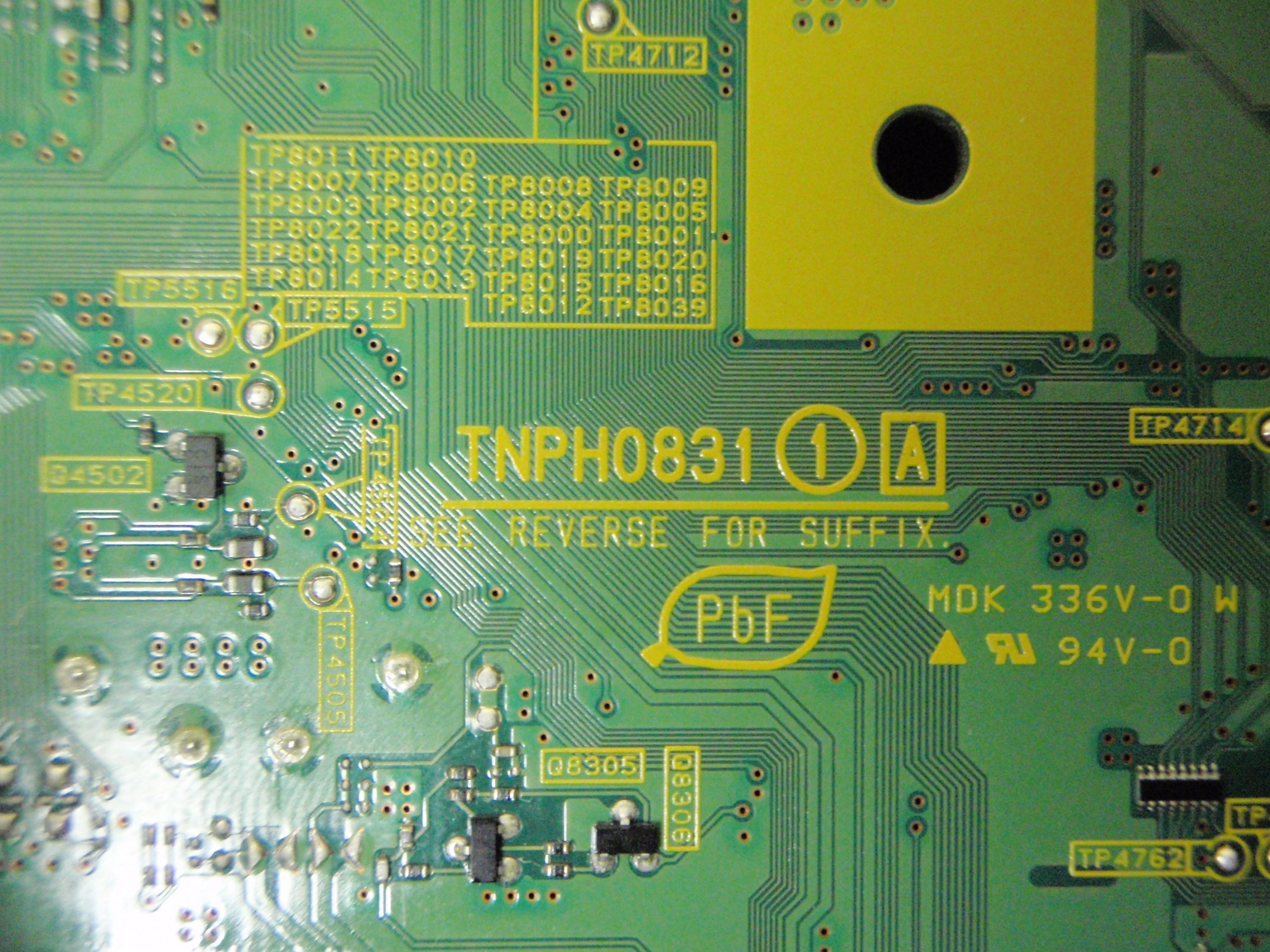

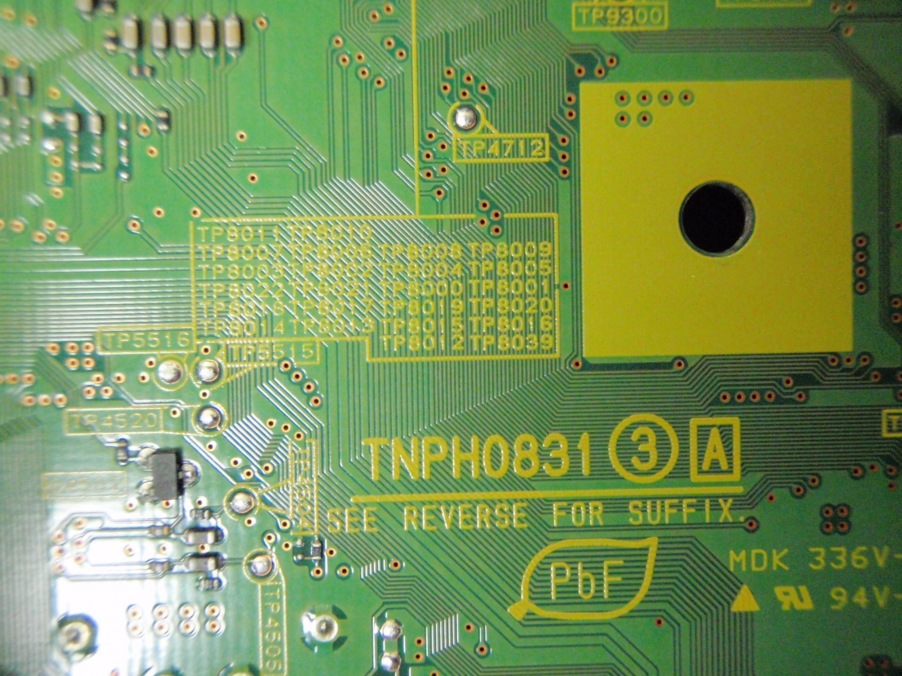

                  I had a look at SJ website and there are a lot of different versions of TNPH0831. I don't believe the 2 or 3 is what to look for. There is a suffix template on the board and the rev is determined by the placement of a series of jumpers.
                  If you post up some hi res shots of both boards it may reveal some clues of what you've got or check out SJ.
                  These are the revisions on SJ

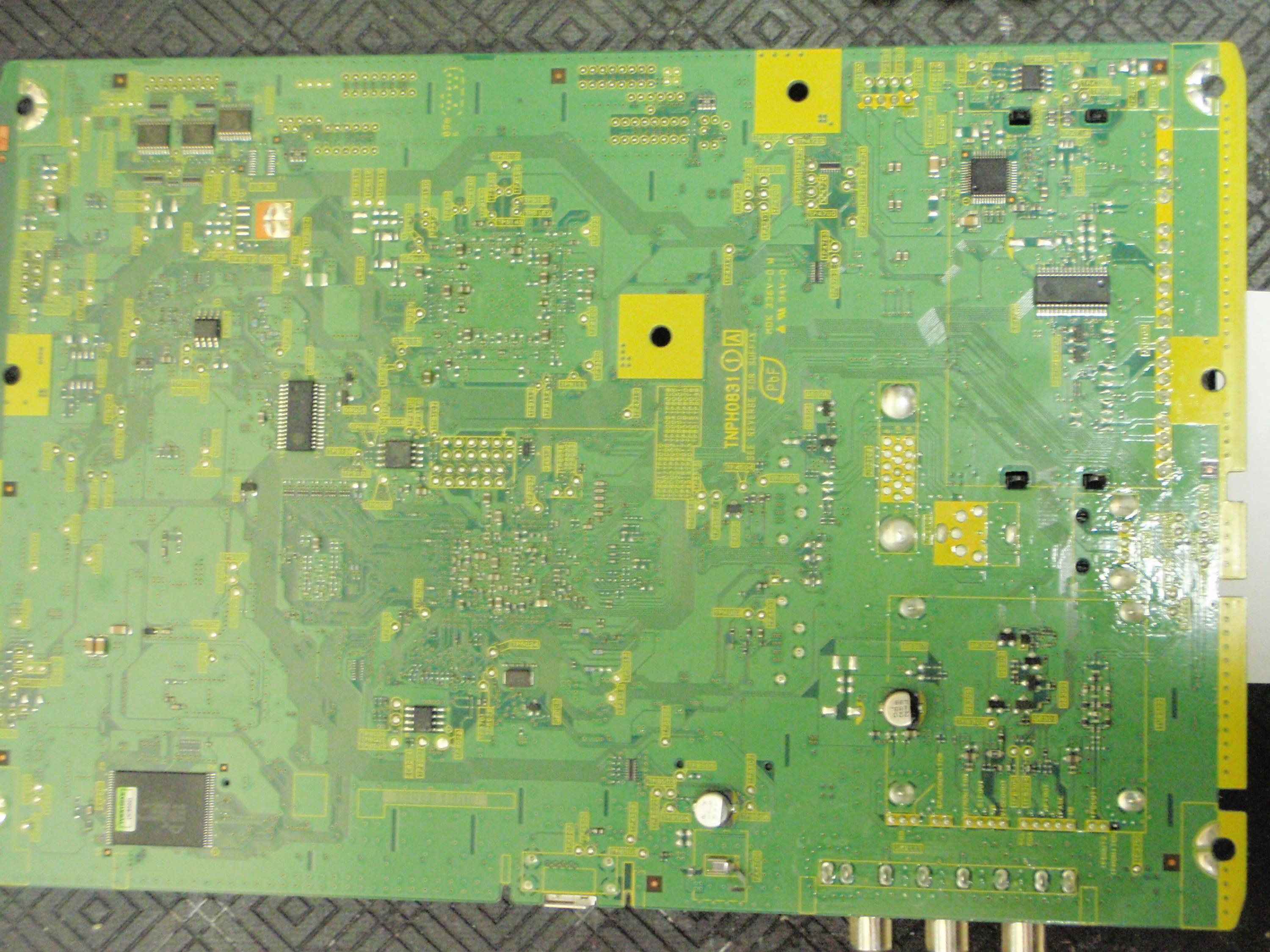

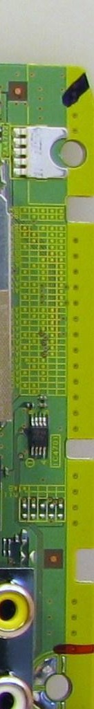

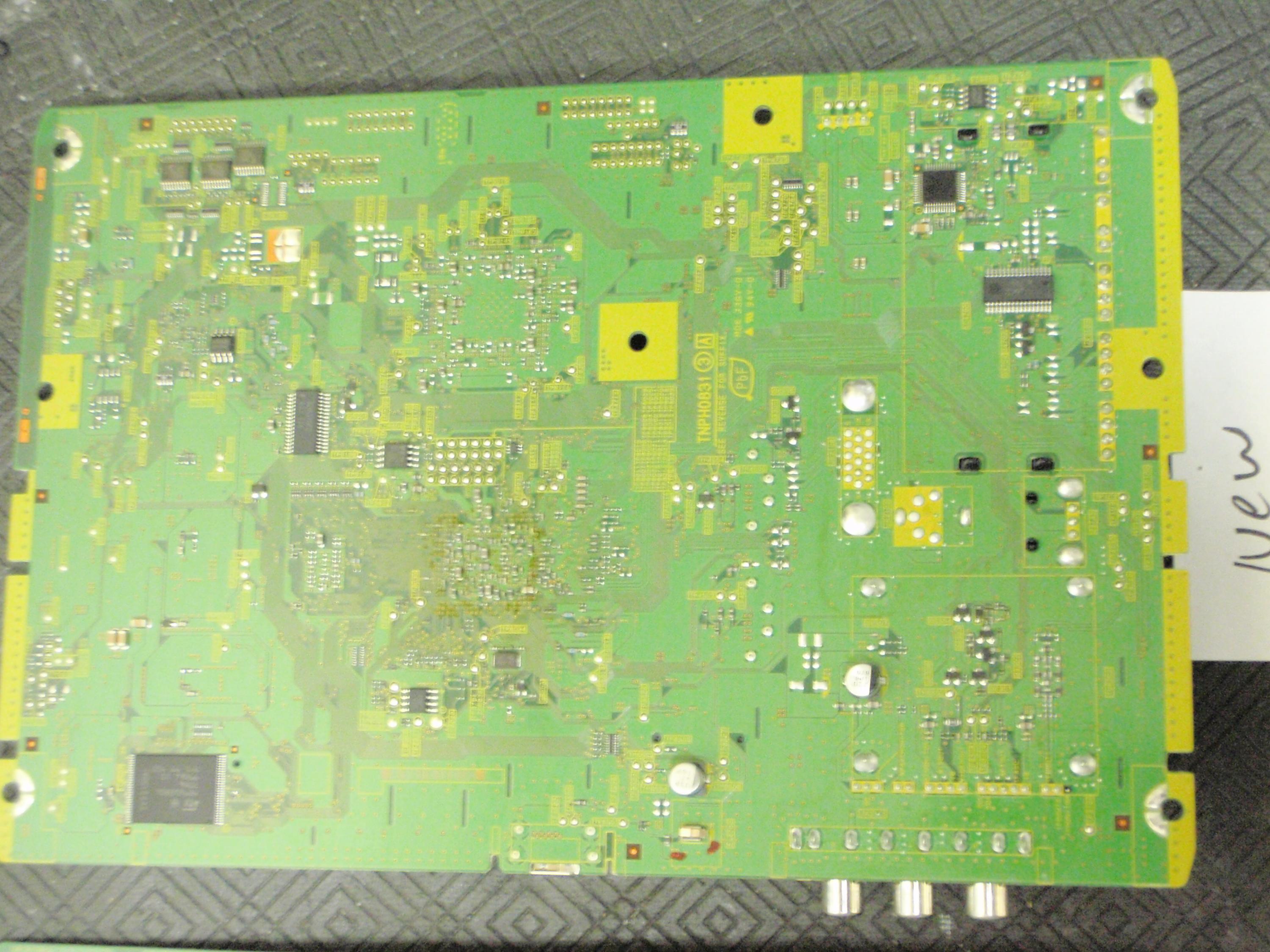

                    okay sorry been super busy however here is some pic's of the boards i cannot find these other numbers other then the ones in pic perhaps i am blind lol...

                      don't see any jumpers , having tough time telling what revision i have, i see the template for it but interpreting it is not very clear ... and both templates have same markings as far as i can tell if need more pics i will upload em...
                      suffix both look like it's marked as AB....
                        Re: Panasonic TC-P42S2
                        From what I can make out , neither had the jumpers there and that would make it no suffix which SJ had listed for your model which was the picture I posted from their site. I don't have any more clues at this stage.
