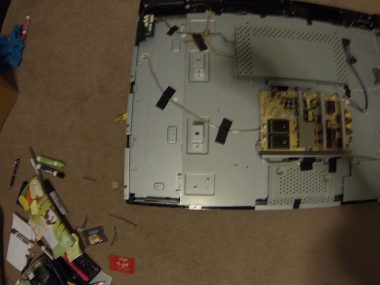

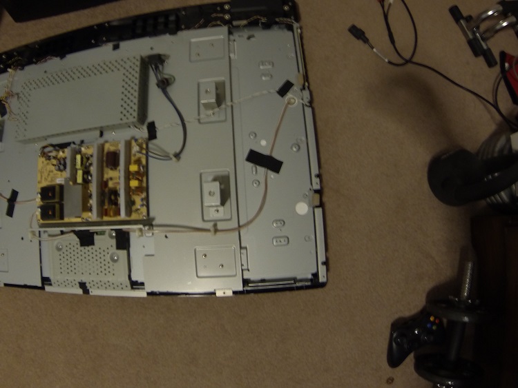

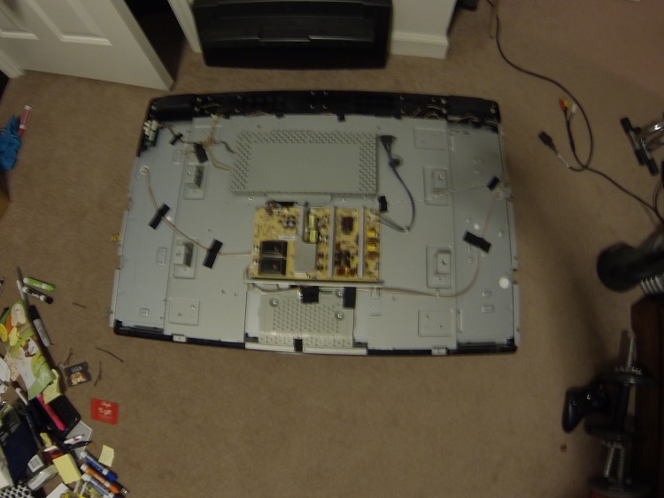

    I have this visio I'm taking a look at for an in-law. It works for a about 5-10 minutes, then the screen slowly fades to black and doesn't come back. the sound works fine and I can control volume with the side panel after the screen fades. once it's warm, you can cut the tv off and back on and the screen will come back but for less time than when it's cold.
    I took the back off and I don't see any caps bulging. I also haven't seen any pics with the layout that this tv has. maybe this is a newer model of this tv, but i'm not seeing the inverter boards on either side like in other posts I searched.
    any idea where to start? do I need to take more panels off to get to the inverter boards on this one? pics attached.

    It has power supply/backlights inverter board combo. So you do not see any glowing screen when the pictures go out, you may have to at the screen in dark room.
