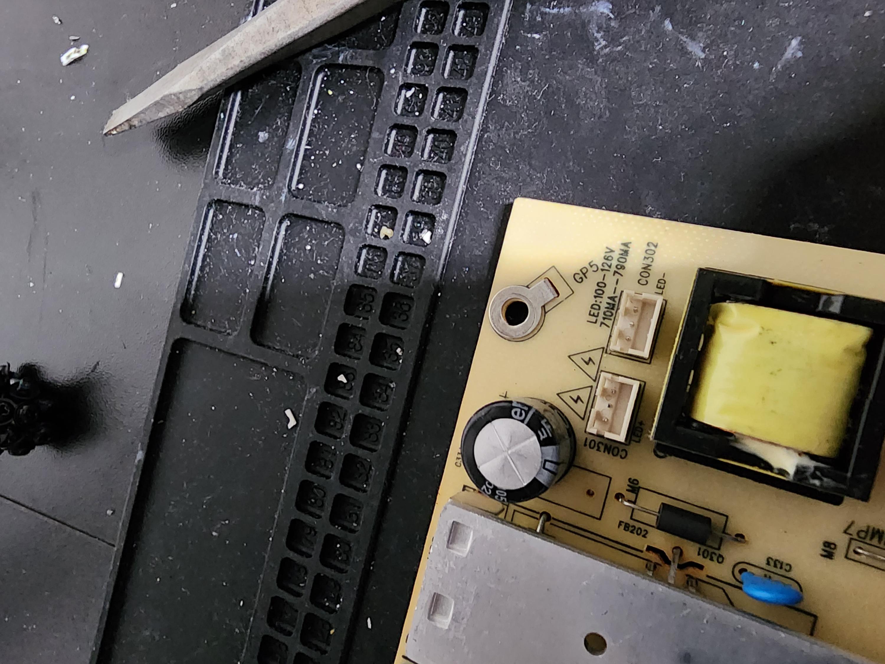

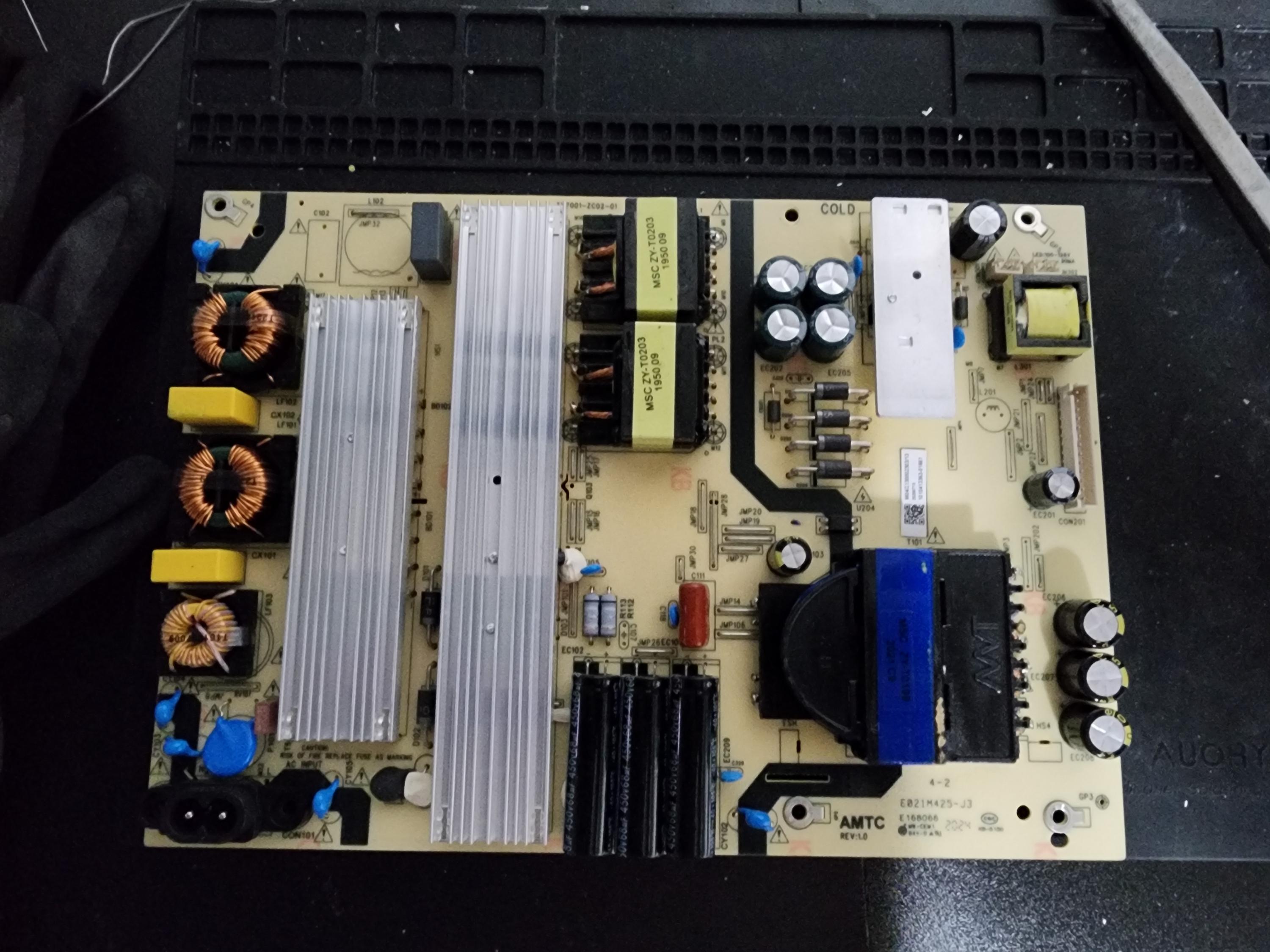

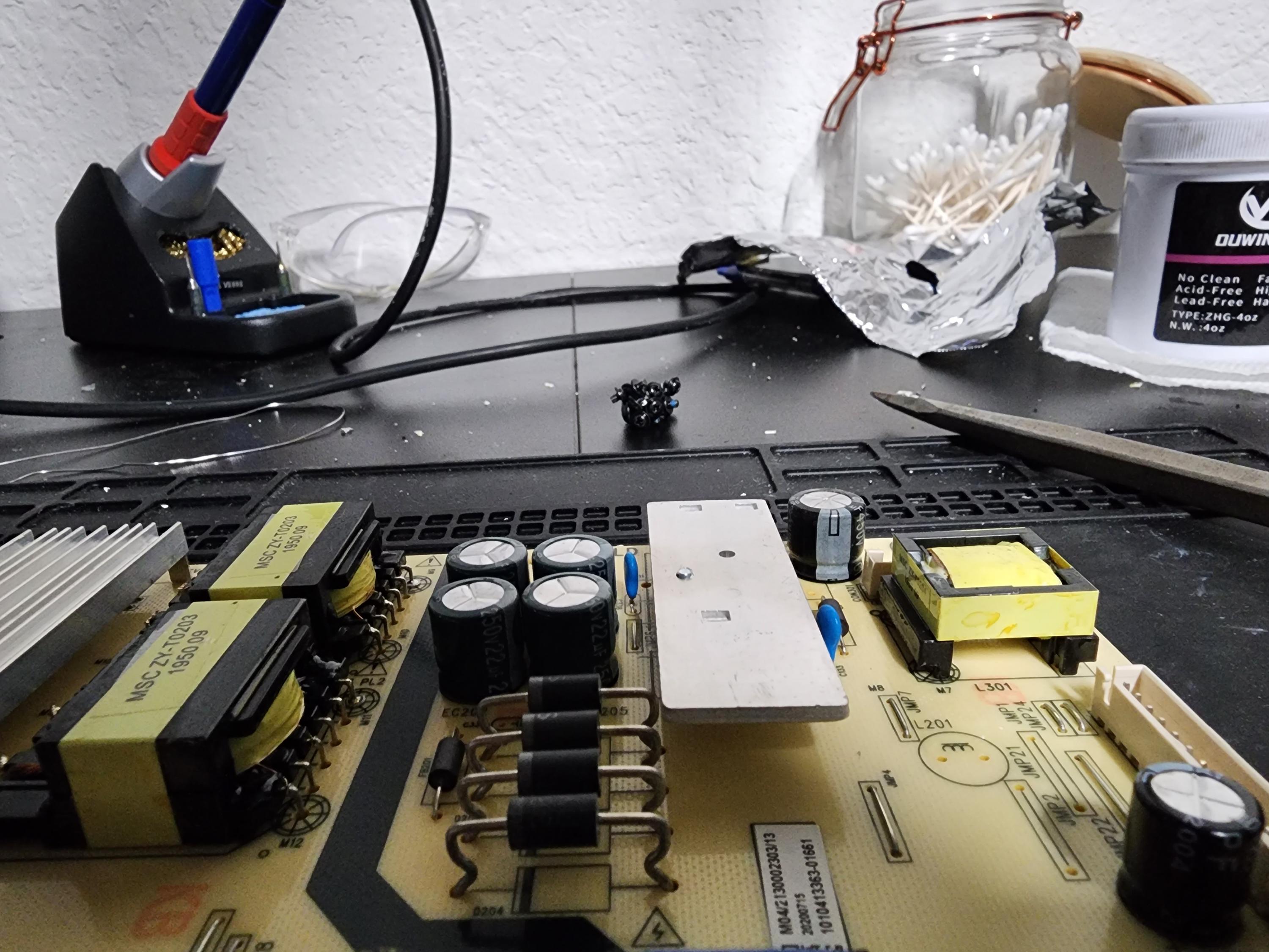

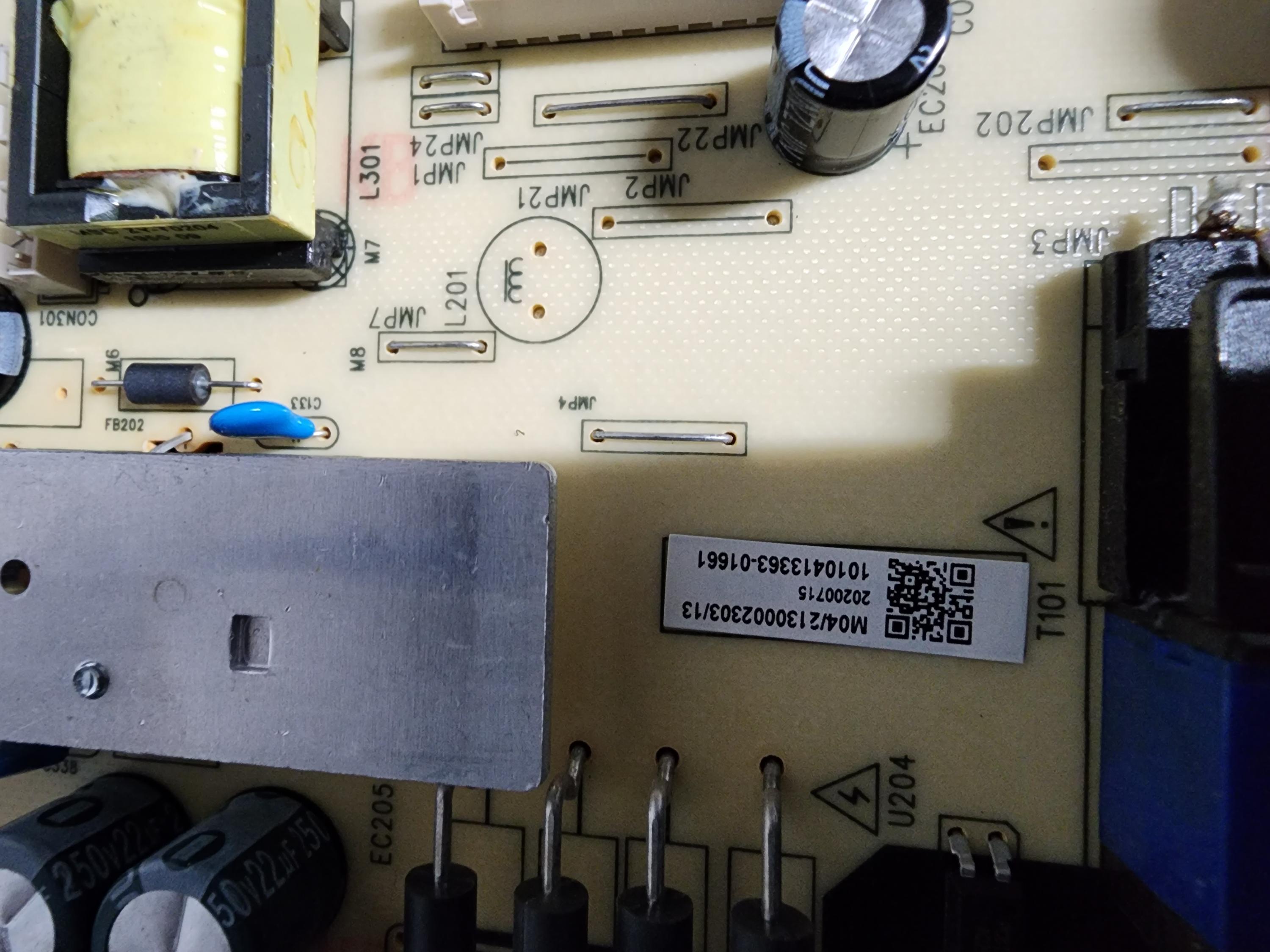

    On this TV I got black screen with with picture.
    Tested the LEDs and they work.
    Had a hunch that this was similar to a ONN tv thread I found and wanted to post about this to possibly help someone else.
    The capacitor by the LEDs is bulging, 450v 10 uf. I suspect this is the cause. Will post results after replacing the capacitor. You could just replace power board as well I assume.
    https://www.badcaps.net/forum/showthread.php?t=110615
    Will post results when capacitor arrives

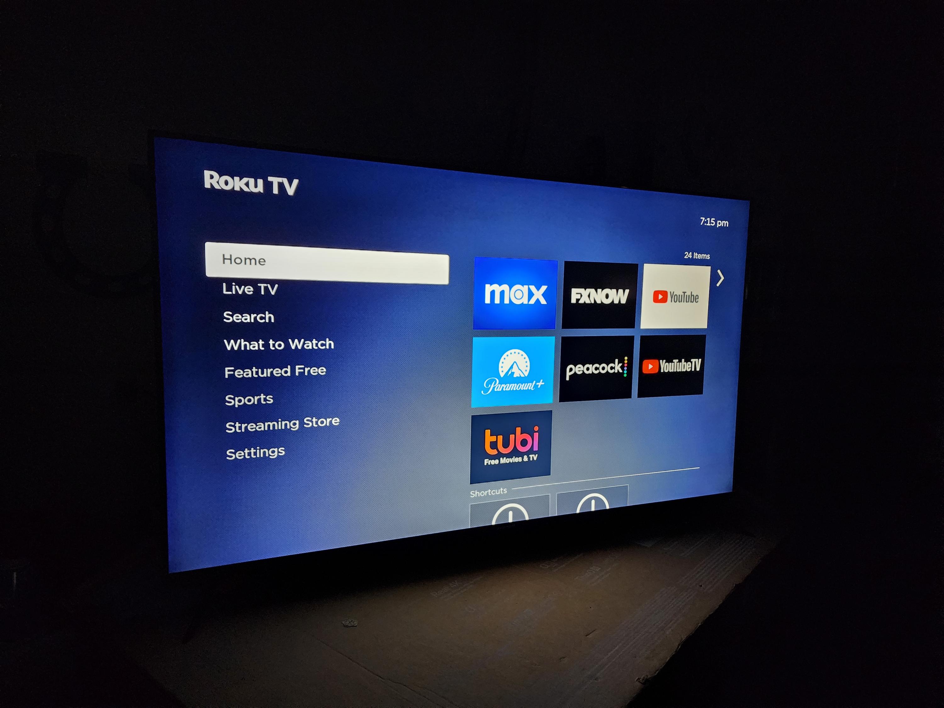

    Re: Element E4AA70R black screen shows picture
    Replacing capacitor was the fix.
    Used same type 450v 10uf.
    GL anyone has problem. Comment if fixes you!

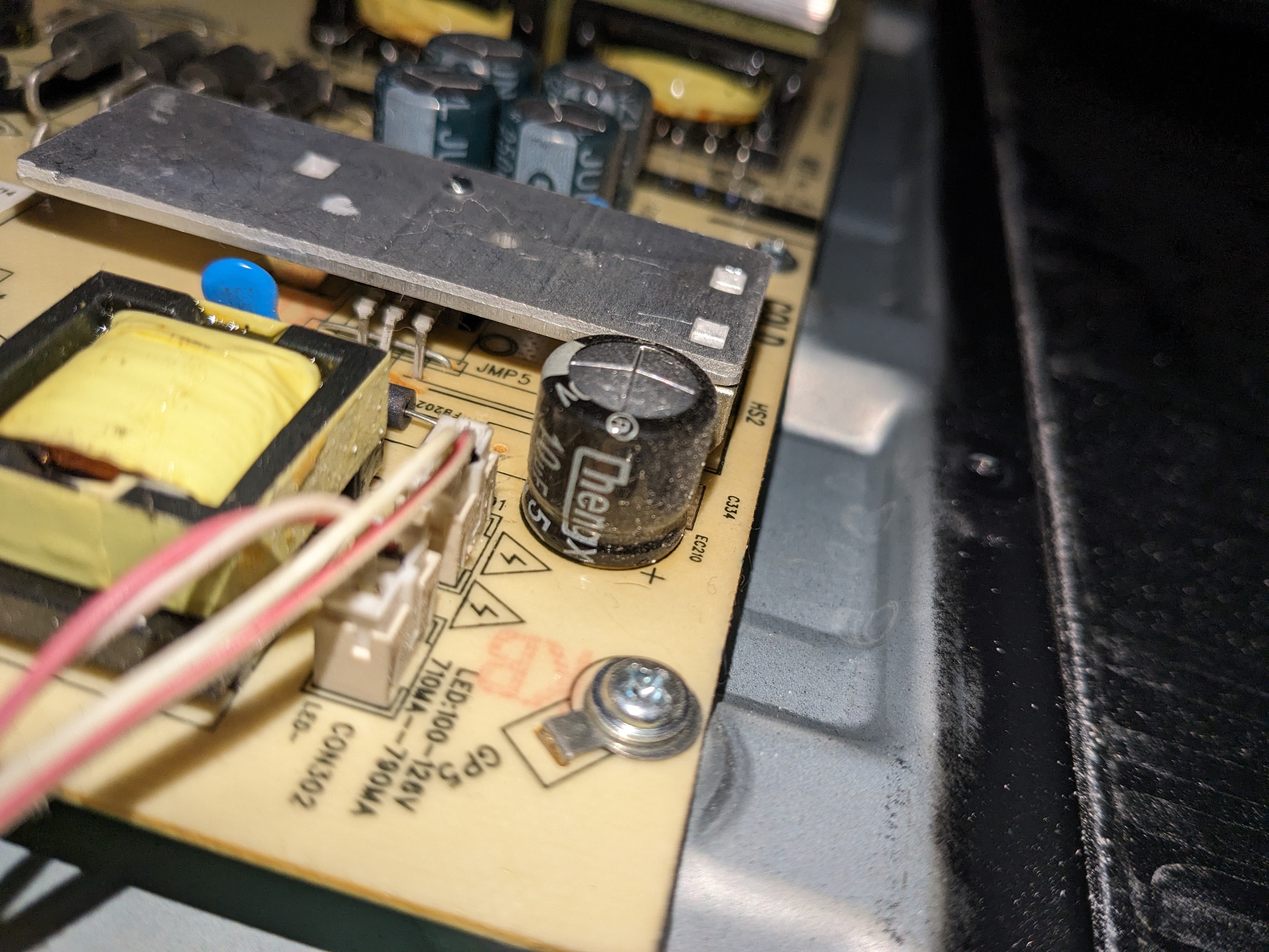

                        Replaced the capacitor and it's working! This one was difficult because the old capacitor somehow ruined the pad, so I had to scrape the trace and attach the solder to that.

                              Originally posted by diif
                              Why are you using poor quality caps when quality ones would extend the life of your repair ?
                              I've used cheap brands for years and never had an issue. The way I see it something else will likely fail before the cheap caps (especially in a LCD). If it were a vintage stereo receiver then better caps would be warranted for sure.
                              • diif
                                • Feb 2014
                                • 6978
                                • England
                                It's the garbage cap that failed and it's likely to be the garbage cap in the future. The price between quality and garbage is negligible. You have an opportunity to extend the life greatly spending a few cents more.
