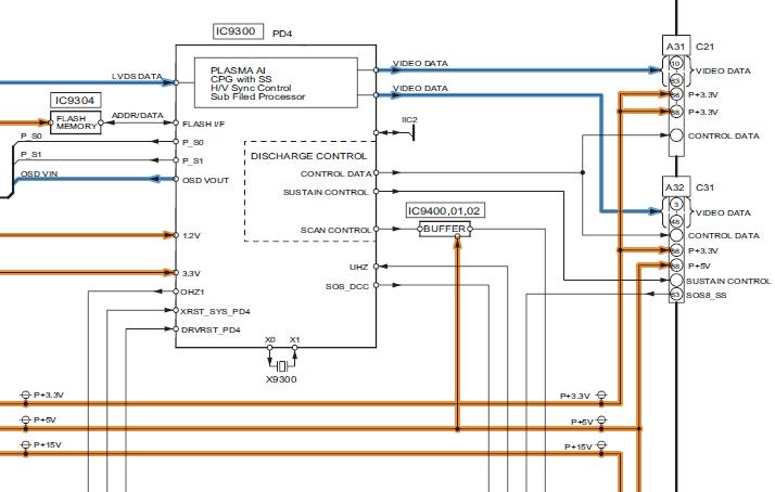

      i can't make much with such a close up but the second pic with the bands i'm wondering if it's the buffer boards?
      SC and buffers are a common fail if this is a model with the TNPA5081. A boards as well.
      Maybe get into the service menu and run the inbuilt patterns and the picture inverting procedures to see if it's generated by the A board or a panel issue?
      I have not faced this symptom before so I'm just throwing some other ideas out there,
      Was there any documentation telling what was done? It'd be helpful to know what the other board was, would Panasonic have records on it?

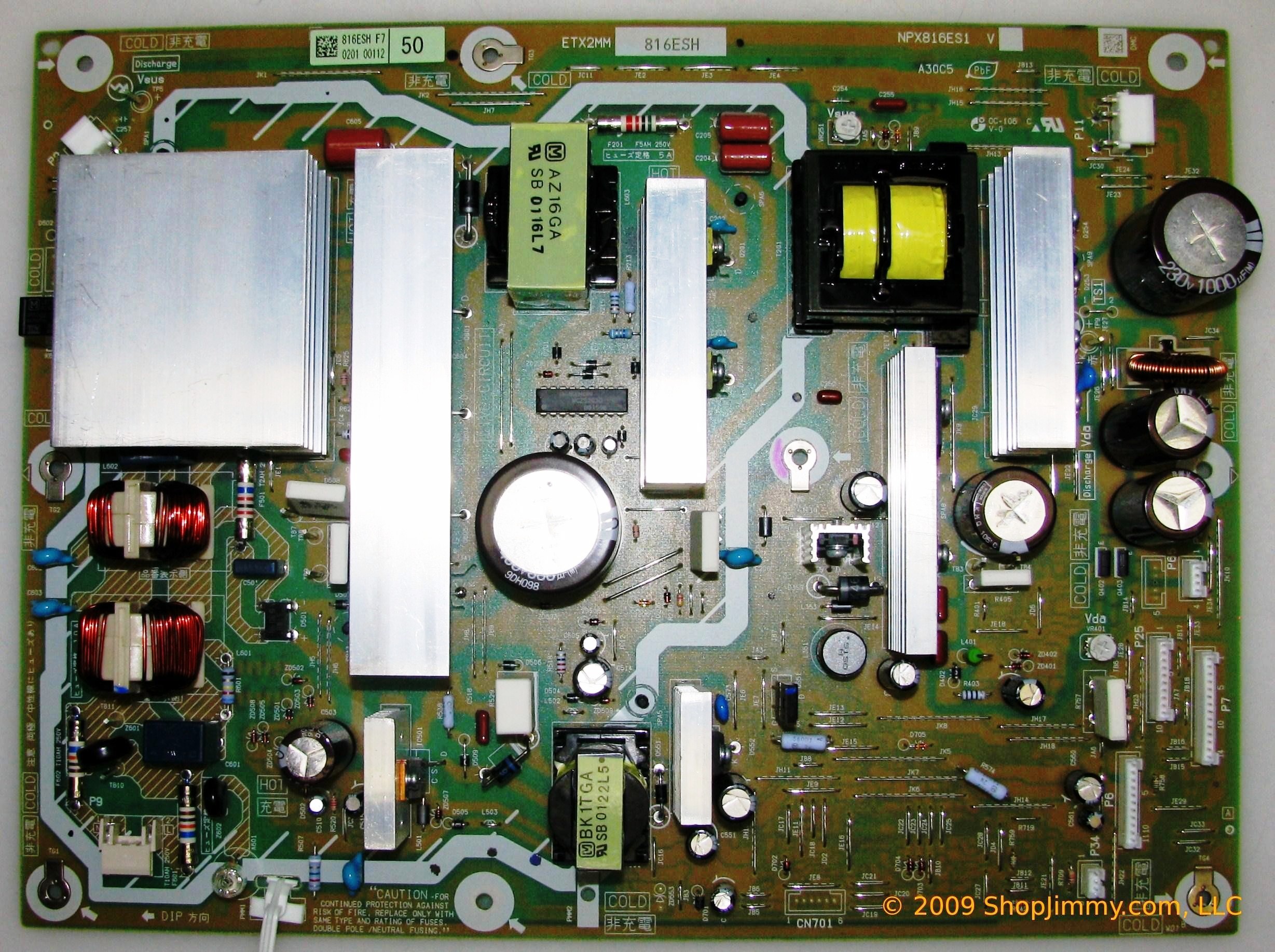

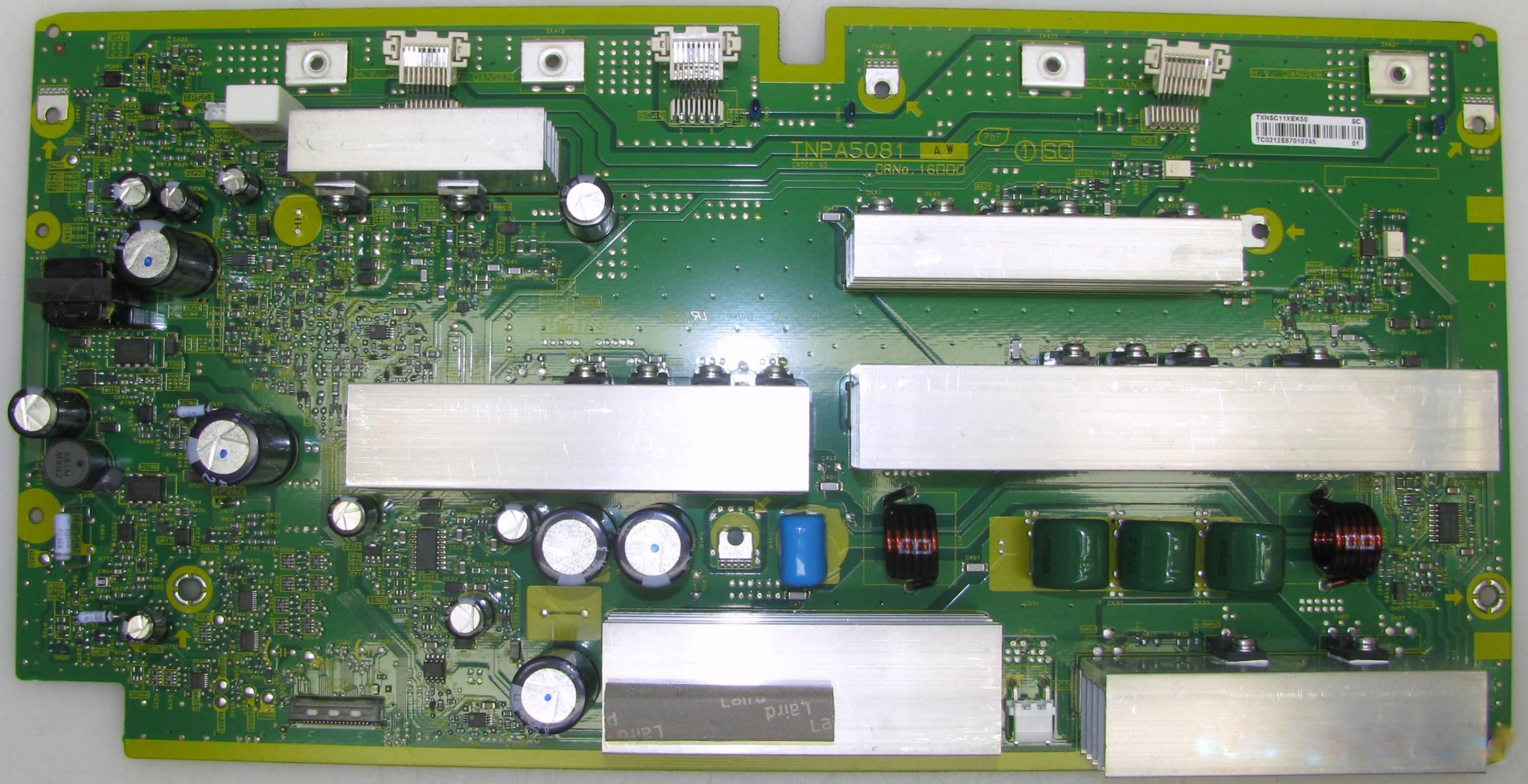

          If you could take a photo of the SC and P boards we can indicate where to test and adjust.
            Re: Problems After SC Board Replacement - Panasonic G20
            Jumping the gun a little here Tom, but this should be the board Rev AW I believe. The one I have here was shipped from the UK and was out of the TX-P50G20B. At least that's how it's marked.
            PSU I can't be 100% on but the adjusting pots are the same Vr251,Vsus & Vr401,Vda.

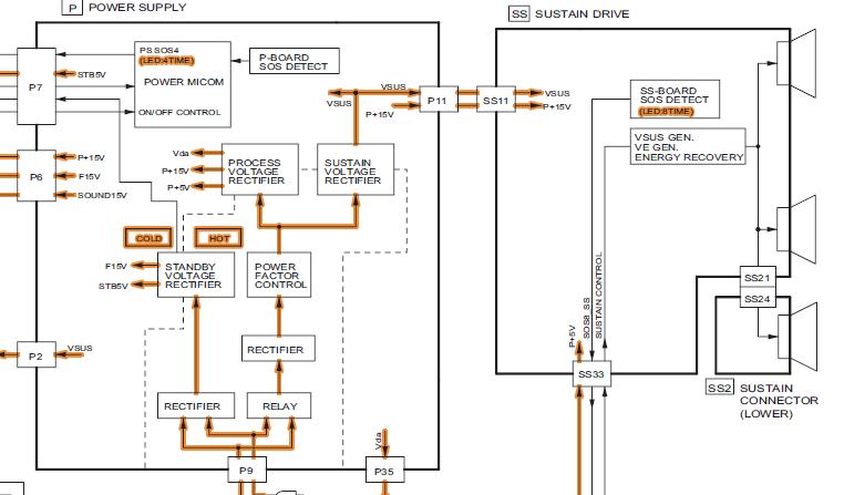

                We don't touch Vda; we touch Vad. Vda adjustment has the potential to damage the panel COF drivers, which are not replaceable. However, it looks to me, like Panasonic have made everything non-adjustable, so we may need to tweak Ve, if available, and Vsus, to compensate. Or an exact SC must be used.
                  What you see is all there is Tom. The SC has Vsus, 15V, 5V. The SS has Vsus 15V,5V.
                  The A board i suspect controls the others on the SS and SC?
                    I suspect Panasonic have got their panel tech so precise that they don't need adjustments any more. Even on 2008 panels there is only Vad on the SC and Ve on the SS, and Vad is specified as a fixed -140V.

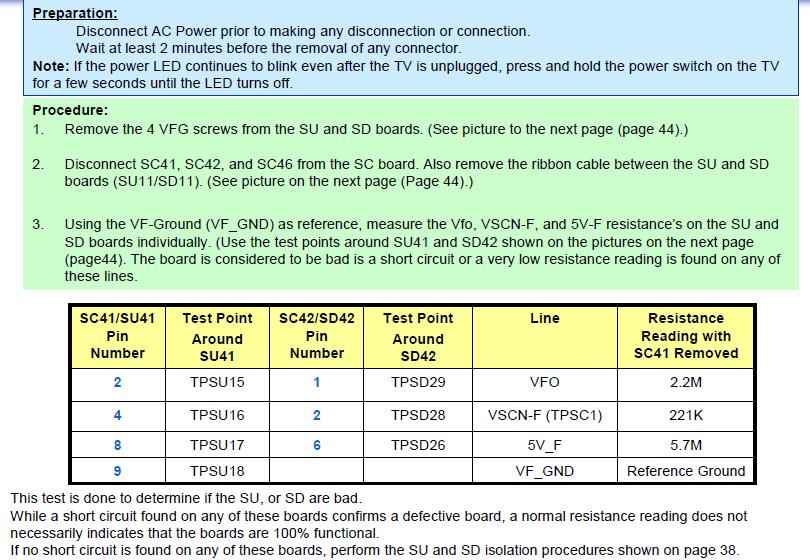

                              you'll need a multimeter capable of measuring above 6 Megohms but generally if the buffers fail there'll be a short or resistance goes substantially lower..
                              This is for the V20 but pinouts are the same for these tests, They quote 2.2Mohm for Vfo but the results I've seen on mine are around 1.9M.
                              As for the Sc, all you can do really is do a quick test for short on Vsus at Sc2, and go around the board and check all the heatsink mounted transistors for dead short across their legs.
                              If you're still unsure about the buffers but want to test the SC with power, connect the board normally,leave the buffers disconnected then you short the 2 pins at SC50 together on the SC, power the Tv and if the TV turns on then that confirms the Sc passed.

                                Thanks for the help......I've watched the TOM66 video many times but cannot figure how to apply it to my TNPA5336 and TNPA5337 boards, they are so different...Where is the "Y main output" ?...there are only the SU41,SD42 and SD46 connectors......am I making any sense?.......The SC test I understand and can do......Maybe this is all just beyond my capabilities......
                                  I recommend tw2005's guide above over my video for Panasonic plasmas. Easier to do, more reliable.
