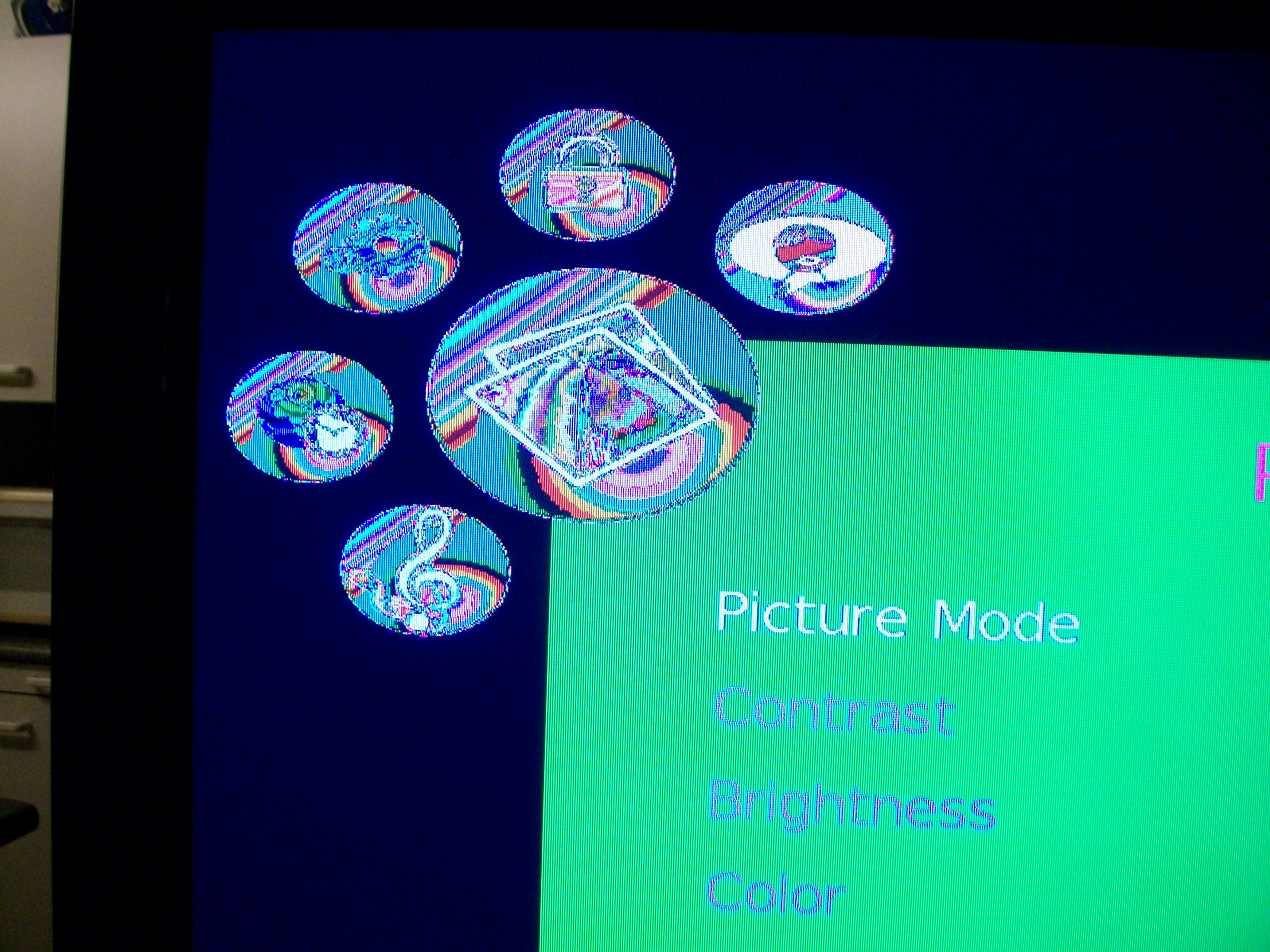

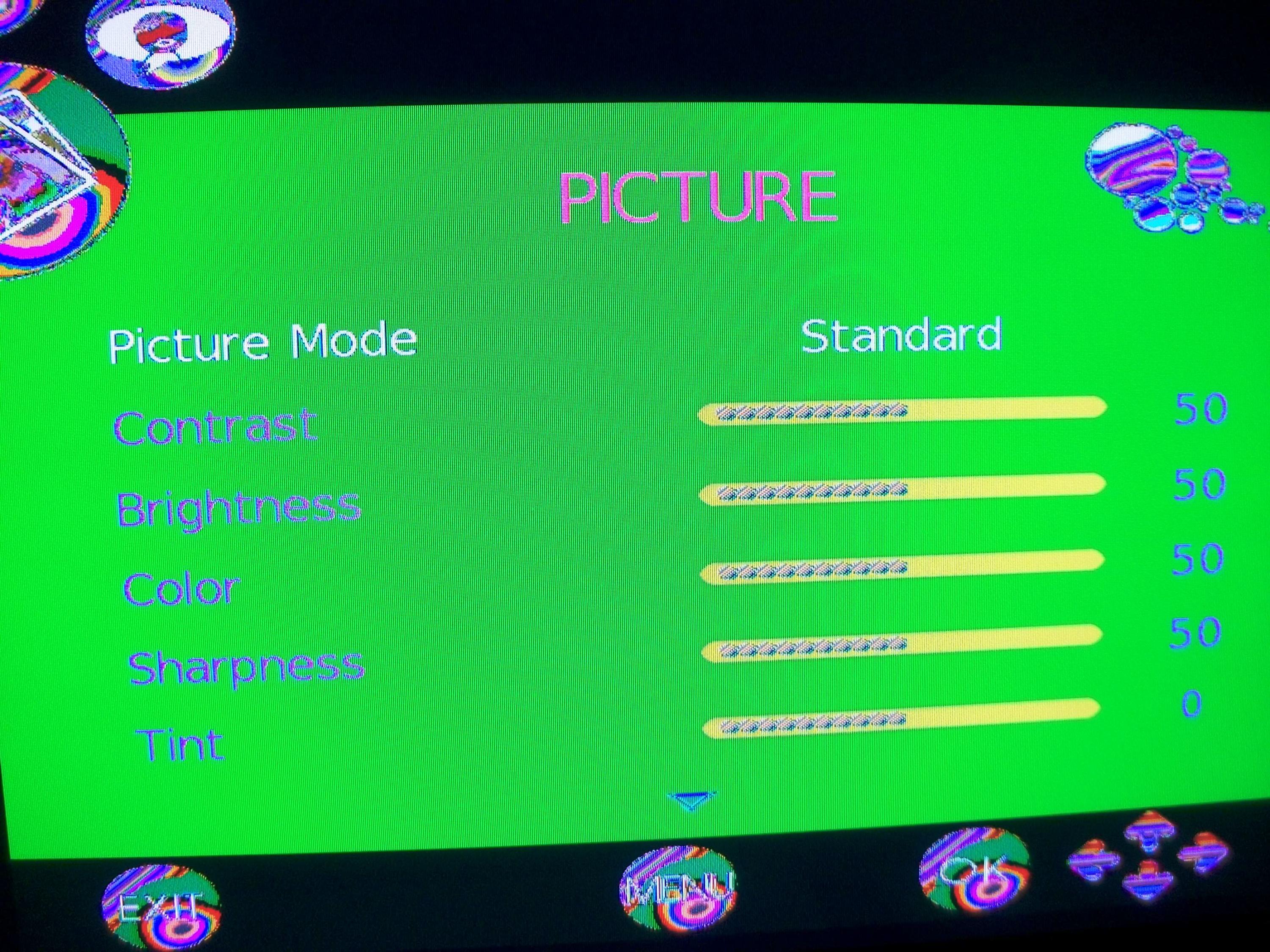

    Last night, I have picked up this TV and I was told by the owner that a technician told him, that the mainboard is the issue.
    I think the same thing, but I would like to ask you too, since I have never had this problem before.
    I haven't opened up the TV yet.
    I have did a basic TV reset, with arrow up and power button, which didn't help.
    I have tried changing picture settings, again did not help(doesn't have contrast).
    I have tried to download the newest firmware, thinking that maybe it would fix the problem, but with the TV's serial number did not show any available firmware.
    I have tried switching two numbers in the serial number and I have managed to get the firmware, but I'm hesitant about using it. It is wise to flash it?
    Any input would be appreciated.

    I am pretty sure this is an LVDS setting problem. The format is set wrong. Are there any options in the service menu for LVDS modes or formats?

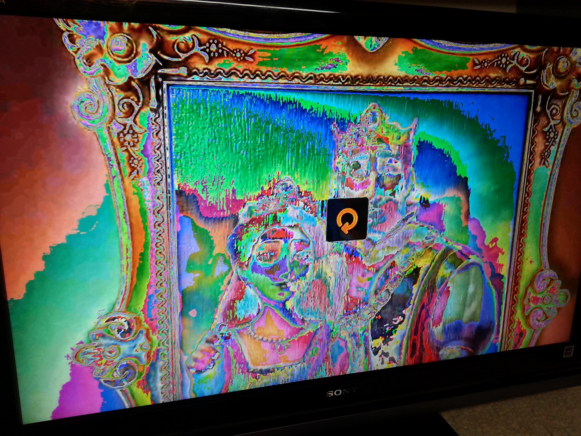

        That looks so much like this chinese cheapie i had which had corrupted eeprom data. I thought I'd share an example where it was a mainboard issue.
        https://www.badcaps.net/forum/showth...&highlight=mvm
        I did a reset within the service menu,fixed, but for Sony I have no idea if that's an option , never touched one.
        Here's some photos from back then, last is the fixed result

                            Usually the colours are good though. IMO, it looks more like the data format is wrong, like it is getting 10 bit data instead of 8 bit data or something like that.

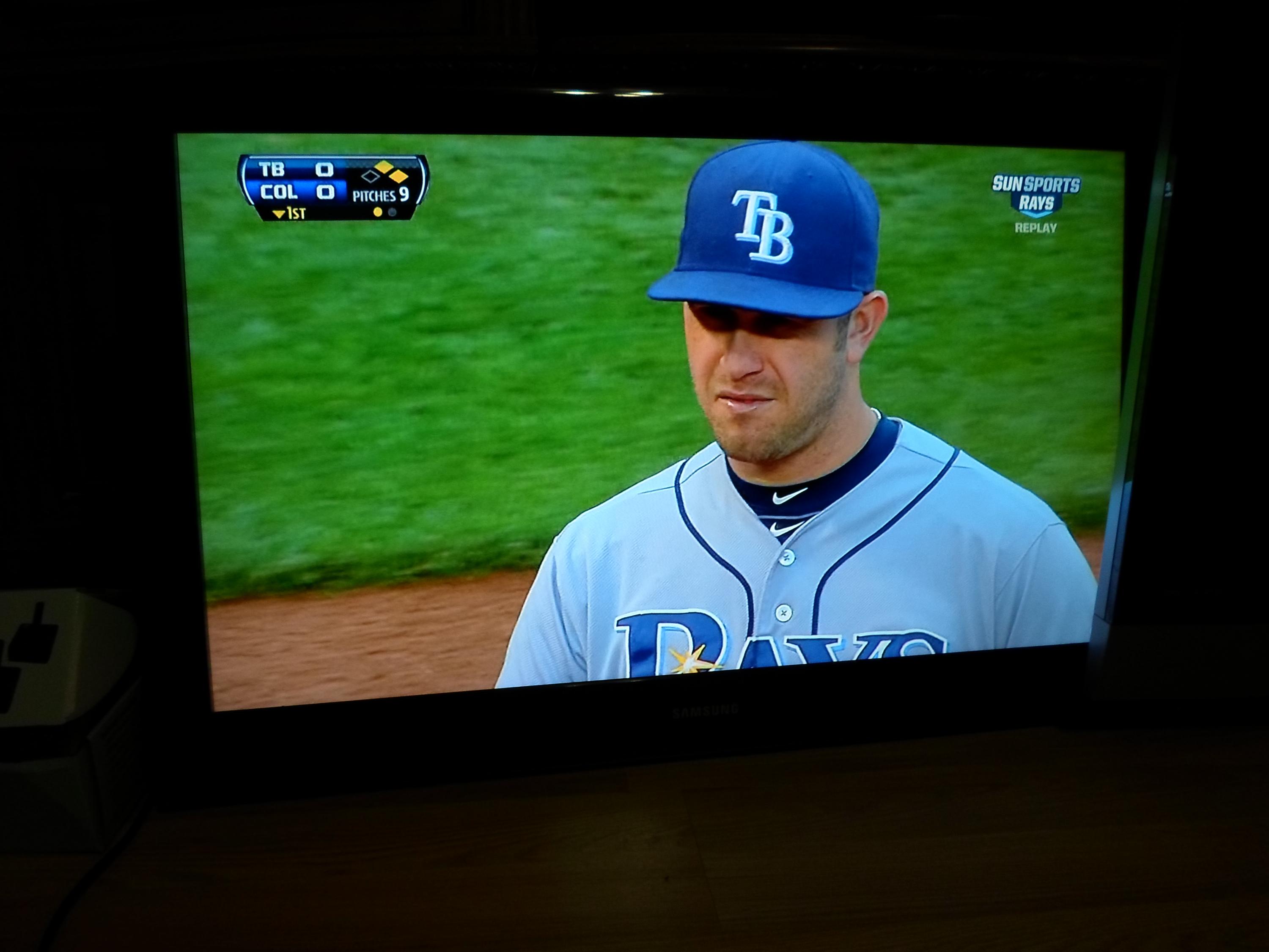

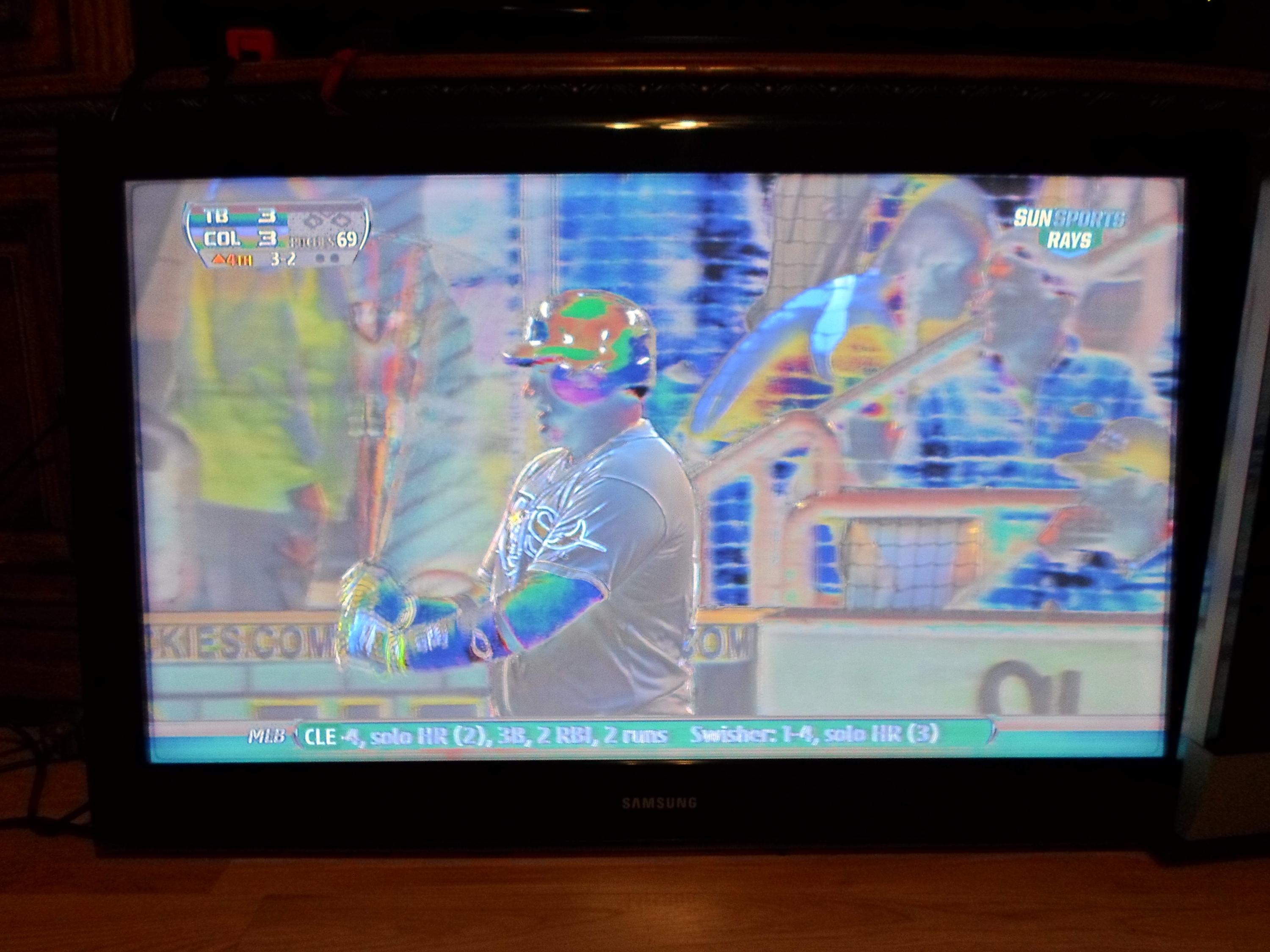

                              This is a Samsung I just picked up yesterday, suspecting the AS15-F chip. I had one before that had similar problem but was just a loose LVDS cable. Does this look similar to yours or no?

                                  Just replaced the AS15-F chip and that fixed this one.. It seems they are all set to go bad around this time of year
