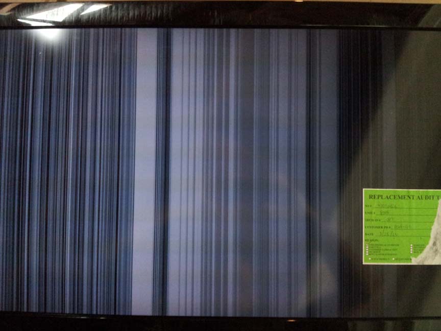

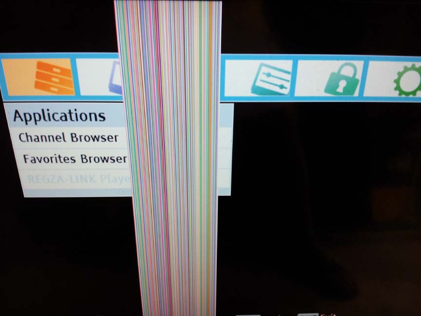

Before I toss these on the basis of bad panels...
  • craigc15
    • Jun 2012
    • 53
    I thought I'd post some pix here to get some feedback.
    The Toshiba 52" seems to be a common problem. I replaced the t-con w/no success.
    I replaced the main/t-con board on the Samsung 32" with no success.

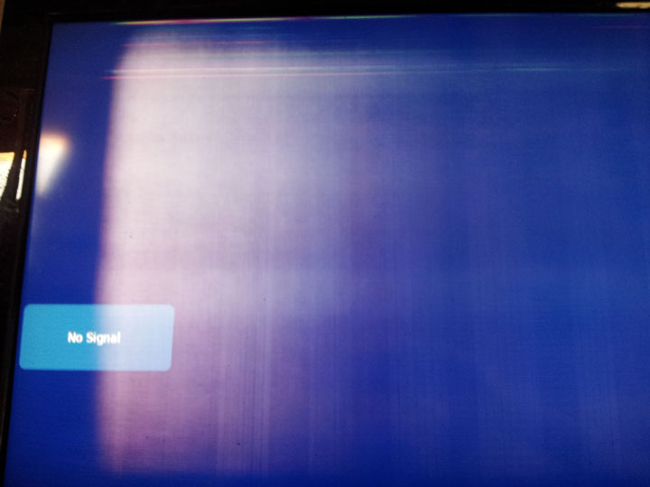

    I also replaced the main and t-con boards on the RCA with no success. The distorted video moves with the "No Signal" box.
    I haven't replaced anything on the Samsung Monitor yet.
    Has anyone had success repairing display driver boards?
    Thank you!
    Craig
    Re: Before I toss these on the basis of bad panels...
    Panel, Panel, Panel/Main, Panel/Main/PSU (bad caps if SyncMaster T24x series)
    You cannot replace the driver boards and besides there's little to no point. They only serve to connect the T-con to the tab bonds. Just like a connection block.

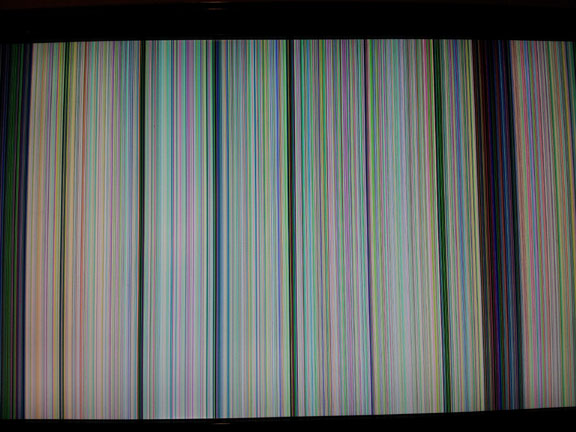

      The monitor is a SyncMaster T240HD.
      What capacitor(s) are problematic?
      Thanks!
        All of them. Crappy Samwha or Capxon usually bulge.

            Craig, I have been playing with some of these Toshiba's. What I have been finding is the tab to screen bonding is not making a good connection sometimes. I have taken like a wide paint scraper, set it on the tab and put it up against the LCD screen so it doesn't get to hot, take hot air solder gun and run it over a few times, hold down on the scraper while it cools. Sometimes it's the small IC in the middle of the tab that has to be resolder. I had some that stayed working and some lasted a couple of months. Just a thought if you wanted to try something.

                I checked the PS and Main boards for Samwha or Capxon caps and there aren't any.
                The PS has Sam Young caps, none are bulging. The PS voltages are good and there is no unusual AC ripple on any of them.
                The main board has all SMD caps with no manufacturer printed on them. None of them are bulging either. I checked the ESR on all and they seem fine.
                Anything else, or is it a bad panel?
                I'll check the continuity of the LVDS cable tomorrow.
                It would be a real shame to have to toss this monitor. It is in like new condition.
