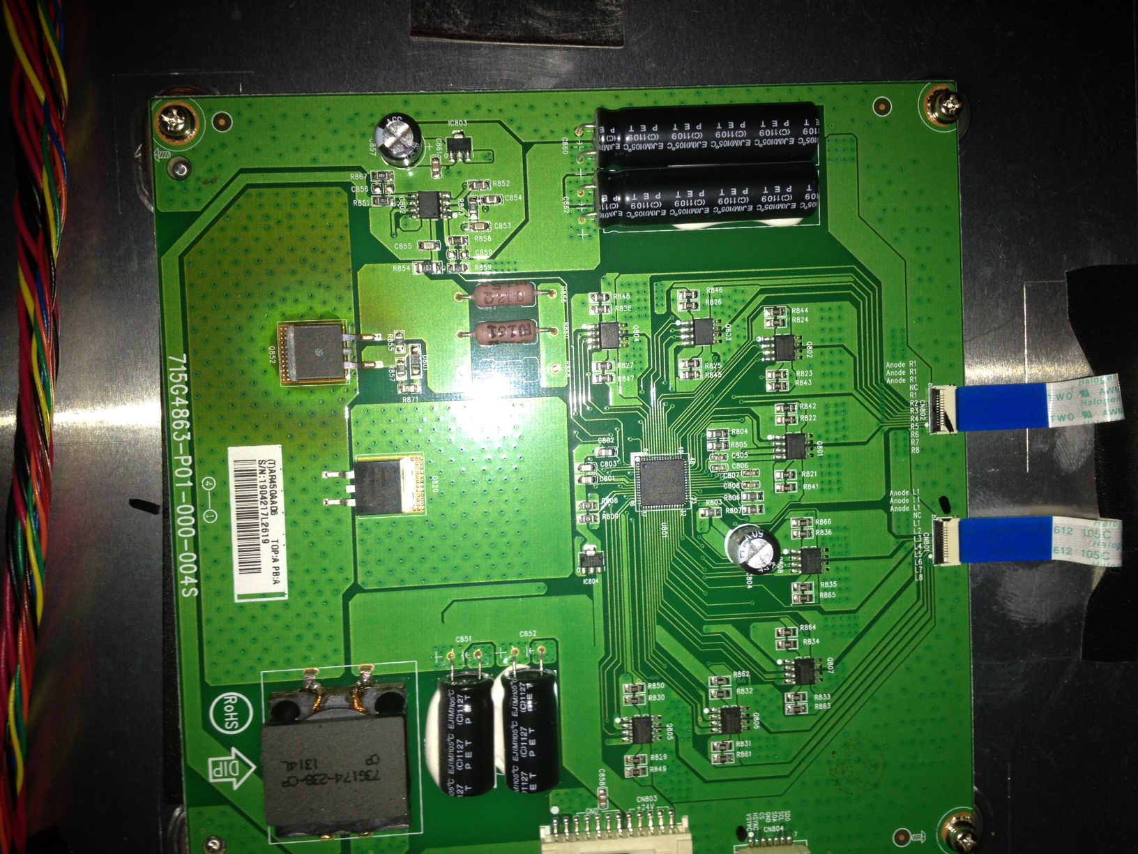

                        Re: Vizio M3D460SR no picture
                        I'm having the same issue with this same model. The Vizio light will come on bright when powered up using the side button or remote, and go dim when powered down. Complete black screen. I don't see any sign of of backlighting at all. I dont know about sound, it's silent now, but I had the speaker muted because I was using an external Vizio soundbar. I also seem to have good link lights on the embedded ethernet adaptor. A red led coming from the opitical sound port in the back. Now this may sound like a stupid question, but is the below board shot, and would it cause the issues I'm having in the manner I'm describing?
                        LED Driver Board:
                        The part with the dark shade around it is labeled Q852:
                        Thank you in advance for any advice.

                          So as a shot in the dark, I bought a power board and slapped it in. Worked for about 10 seconds, the display had a bunch of lines and grainy picture, then stopped working again. I'd imagine I've either fried the power board again or blown the small white fuse out.
                          Any ideas?

                                It's a bad tcon board. Vizio has had a lot of issues with them
                                Bad tcon 100 percent positive if u can find
                                  Just got this model in the other day, no picture, turned out to be a bad tcon board. it worked fine initially once plugged in but as it heats up, the picture starts flickering until itll go out. And also the tcon board let out an annoying whine.
                                  The Tcon board is 46T12.C01. Its pretty hard to find for the m3d460sr model but I was able to buy the Seiki version (less than $15) and swap over the parts from the bad m3d460sr tcon to exactly match it and get it working.
