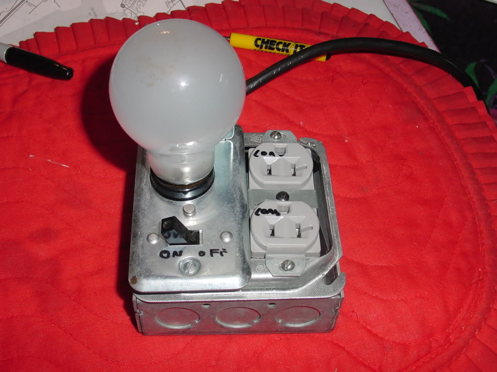

    Bulb tester
    Budm,.
    I built one of the bulb testers like you have pictured in photo bucket I have a Insignia NS-PDP32-09 I'm working on that has a short. Very time i Plug it in it blows the fuse in the middle of the power board . My question is will the bulb tester work with a plasma TV? I can't get a light bulb to light I have tried a 100 watt and a 75 watt bulb' Also the fuses have stopped blowing when hooked to the bulb tester but no light comes on .and the tv is still dead no signs of life at all.Thanks Budm hope you can help.

    Re: Bulb tester
    If you mean the tester converted from a cfl bulb that is only for use with a lcd set with ccfl backlights.
    "I can't get a light bulb to light I have tried a 100 watt and a 75 watt bulb' Also the fuses have stopped blowing when hooked to the bulb tester but no light comes on .and the tv is still dead no signs of life at all.Thanks Budm hope you can help".
    Have you now moved on to using a filament bulb in place of the mains fuse?
    That should light whatever?

      Selldoor,I'm using a filament bulb,it will not light when hooked up to the bulb tester

        Sorry I dont understand what you are doing? Picture? rough hand drawing?

          Selldoor It's a dim bulb tester. Go to budm's photo bucket page he has a picture of one he build to check shorts

            Re: Bulb tester
            Selloor
            here's a link to the dim bulb tester on budm's photo bucket page
            http://i807.photobucket.com/albums/y...s/DSC01682.jpg
            I made one of these to check for shorts. But the light bulb will not light The fuse blows every time i plug the tv in.

                Re: Bulb tester
                OK - Budm has several "Bulb" testers so now we know which one you mean.
                Unfortunately I dont know how it works - I am guessing you just plug in whatever you are testing and if it is shorted the bulb will light fully and stay lit.
                If its not shorted the bulb will light then start to dim as whatever you plugged in
                powers up.
                Have you tested your dim bulb tester - perhaps plug in a table lamp?
                If that works try a 40watt bulb in the tester.
                  Re: Bulb tester
                  Please verify that the lamp connections are in series with the outlet. Test it like what selldoor recommended.

                    plugged table lamp into dim bulb tester and it lighted up.So should I try a 40 watt on the plasma TV?
                      Re: Bulb tester
                      A non-lighting bulb with standby light is good.
                      Turn the TV on, the relay should click and the bulb will likely light full bright, what is important is if it varies in brightness or stays lit.
