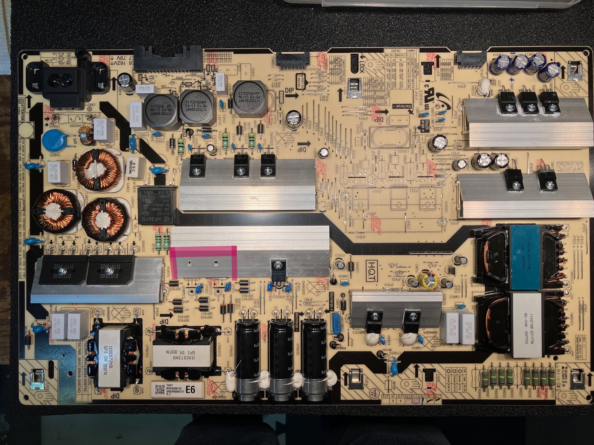

    I have a Samsung power board BN 44–00 874C that is dead. I have looked for a schematic but no such luck. I opened it up and found two Mosfets burnt QP801CS and QP802CS, also the main fuse. I replaced them and checked the two blue capacitors in front of them. They both tested good. I checked the Diode on the same heat sink and the two capacitors in front and they checked out OK. I plugged it in again and that blew the fuse and the Mosfets the second time. I plugging it in again hooked to a 100 W watt light bulb. The light bulb starting started flashing off and on. I checked the three big capacitors and they seem to be OK and also the two bridge rectifiers. I did find 4 small caps CM851-854 that were bulging and out of spec so I changed them also.
    I plugged it in again and still have the bulb flashing 1 to 2 times per second.
    Would some somebody know why the light bulb would be pulsing like that?
    Have included some photos.
    This has got me stumped. Any help would be appreciated.

    usually when replace Mosfets​ we change the ceramic caps too against new one,
    you need to add load just plug the BL socket at it and see the behavior of yours DIY lamp and the output at sockets which goes to MB

      I changed the ceramic caps that you mentioned and plugged it in with 100w bulb. The lighted flashed for a few seconds and went out. I tested the 3 big capacitors and they are 156 volts. the standby voltage is 12.7 volts and I am getting 281 volts at some channel outputs. This is from testing on the bench. Is there any other test that need to be done?

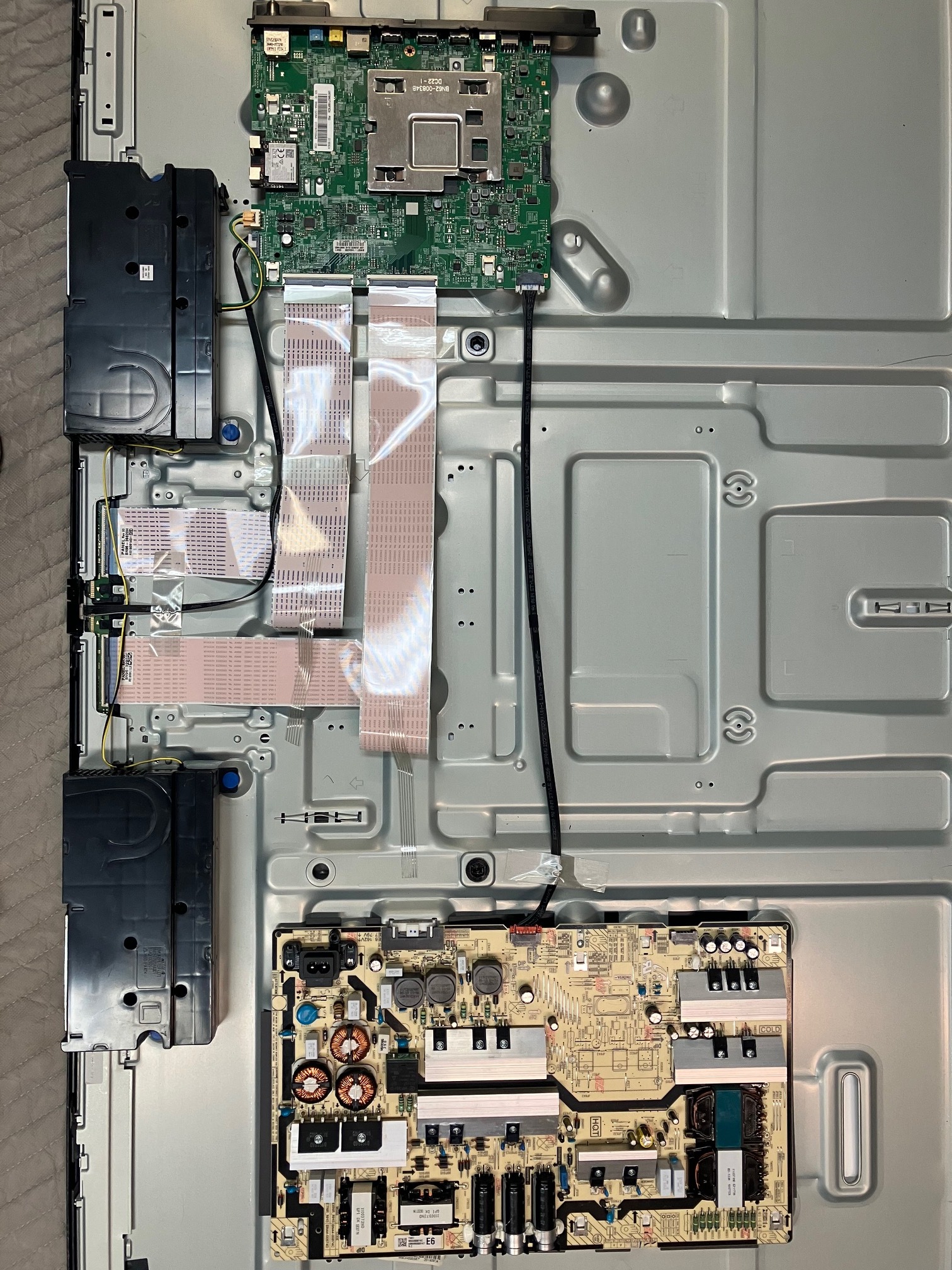

                  • Larrob19
                    • Mar 2025
                    • 30
                    Diah, There is only 1 line to disconnect from the PB to the MB. CNM802. Disconnecting this makes the LEDs flash on and off. Click image for larger version

                      • Larrob19
                        • Mar 2025
                        • 30
                        OK, I tried it without the lamp, the relay clicked and the LEDs came on dim, then went bright then the relay clicked and they went off. Then started all over again. Next step?

                            • Larrob19
                              • Mar 2025
                              • 30
                              Yes that's it. As I said in post #1 I replaced the 4 small caps because they were bulging and out of spec. Could there be other Caps not doing there job? But where?
