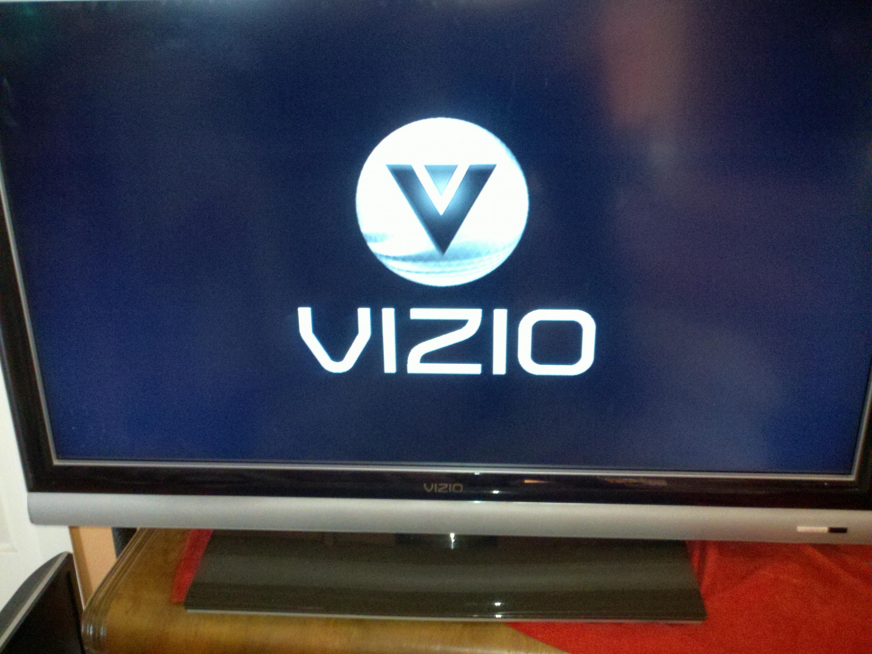

    VIZIO VT420M morning..what would cause this? see pic thanks
    stuck on logo screen
    cant find firmware update for usb...may not be one?
    any other thoughts....
    tv will turn off and on with the remote
    thanks dave

    Re: VIZIO VT420M morning..what would cause this? see pic thanks
    tried it with different sources -
    tried the button board
    no other buttons work
    sound?
    please tell us all the tests you have done
    cant waste time dragging it out of you
      I'd be thinking corrupted firmware at a guess. Will it go into service menu?
        Needs EEPROM/flash probably
          just power button on side works cant get into service mode...unless im doing the wrong sevice mode....can i ground out the eprom?....how would i do a flash?...nothing plugged into tv just stuck on screen
            Nope, you will need to replace the EEPROM, many sellers have them $15~$25 each. (Rip off price, but nothing you can do about it... yet.)
              then i have to get one programed...and install on the main board..
                i had a eeprom programer many years ago when i did pinball repair..copied chips..but must have a good one...so can i buy a pre programed eeprom for this model?..where would i get it?
                  shopjimmy.com is selling eeprom now, try contacting them.
