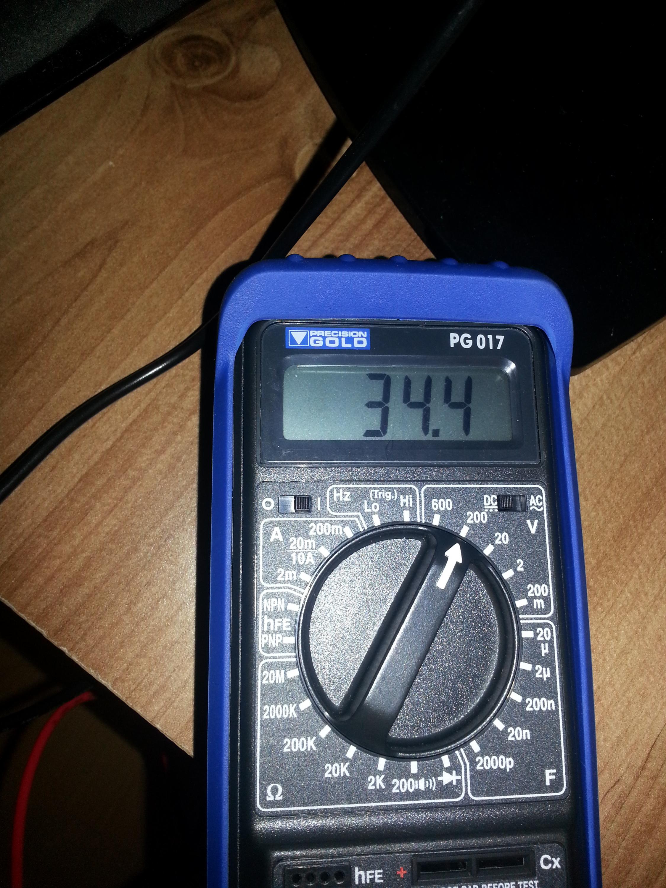

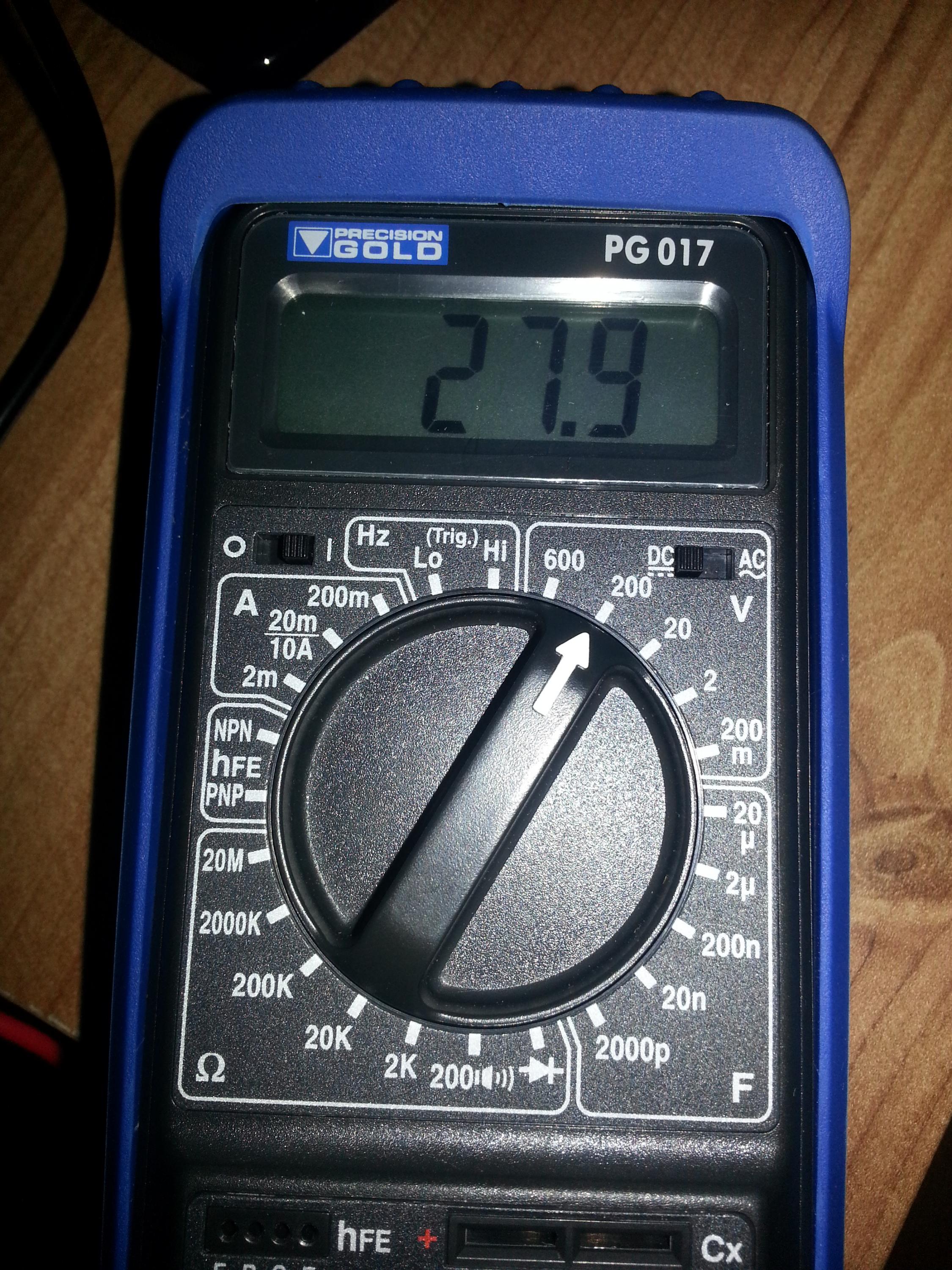

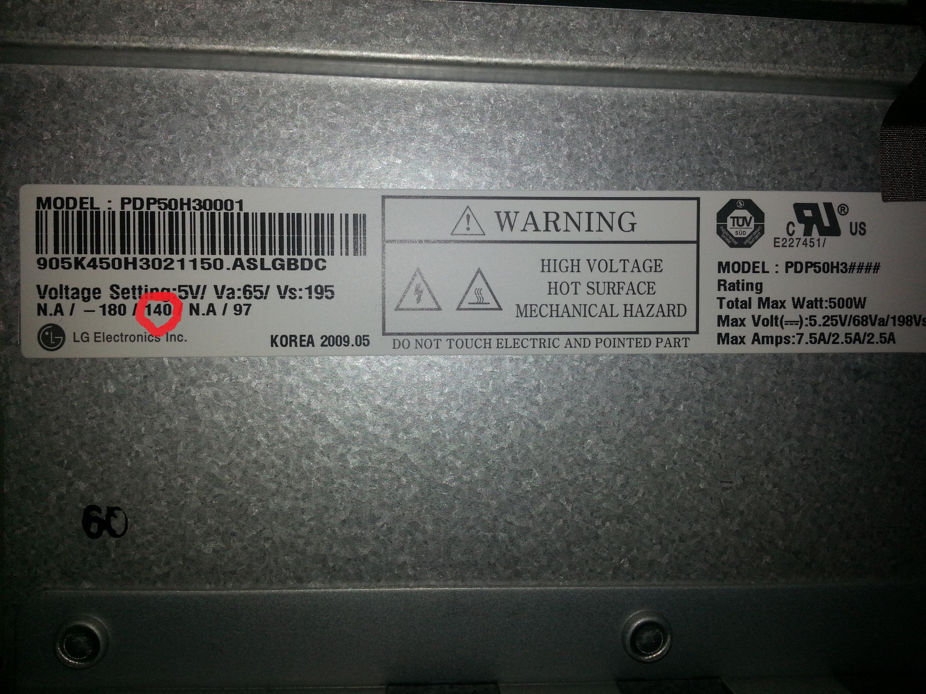

    Ok so I've confirmed that the Vsc is supposed to be +140 and I'm not sure if I'm doing something wrong or I've tested it wrong but the Vsc currently reads 27.9 and the maximum adjustment that I can make only takes it up to 34.4.
    Am I testing it wrong (bearing in mind this is all new to me, so this seems likely)? or is the Vsc resistor faulty?
      Re: 50" LG Plasma-couple of (hopefully minor) problems
      Nope... it sounds like something on the Y-sus is faulty. Do you want to chase the fault down or simply swap the board?

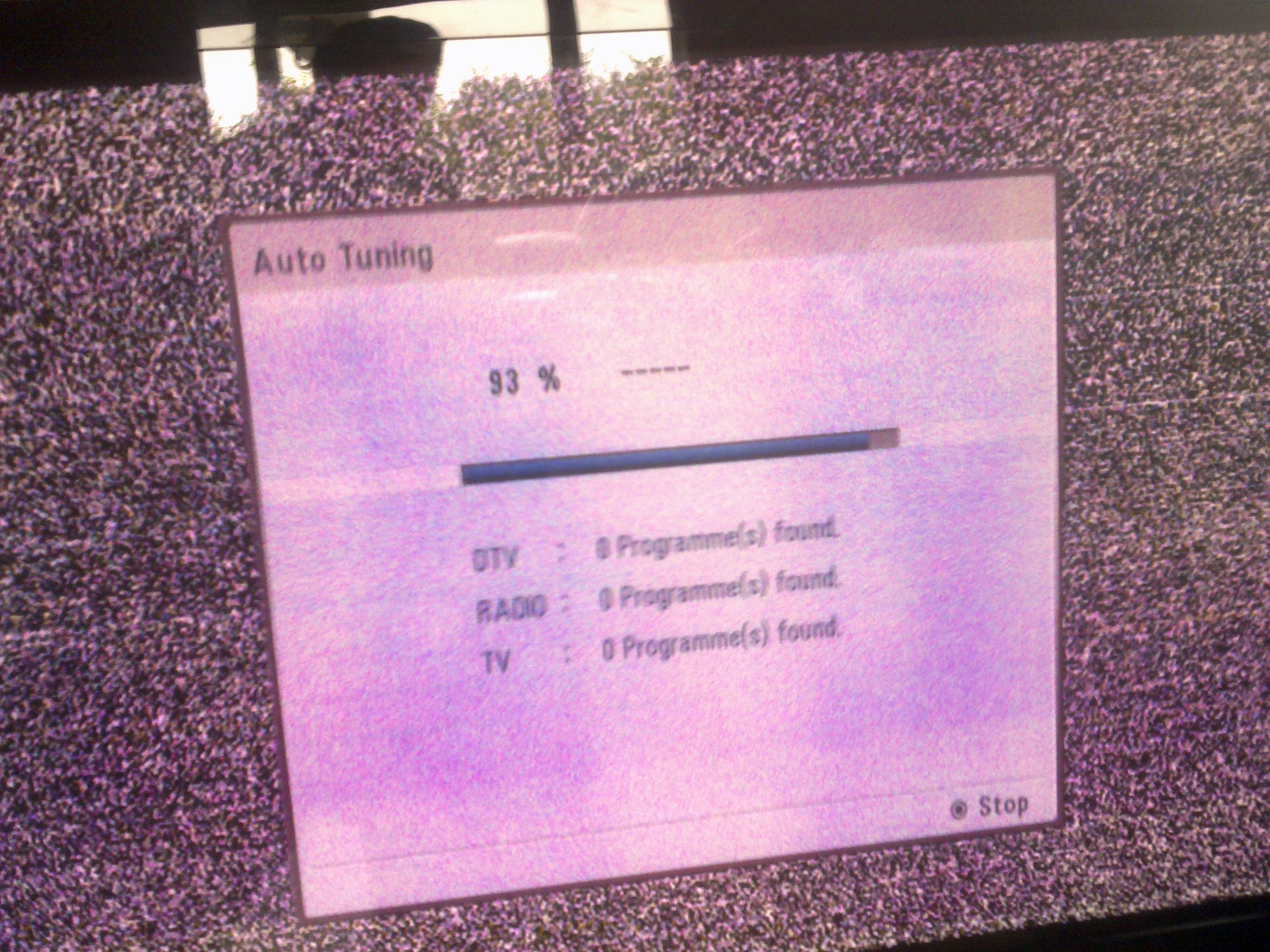

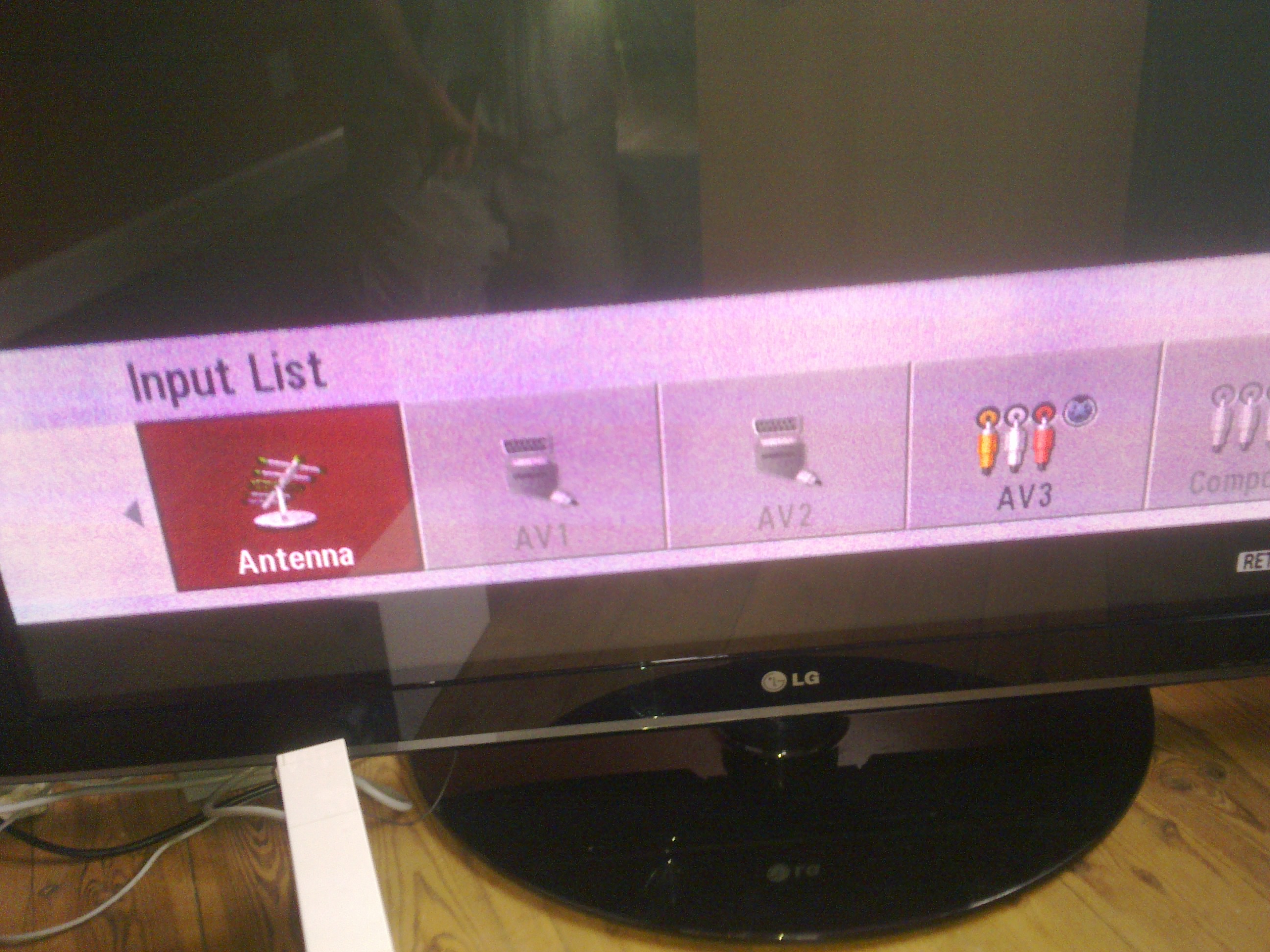

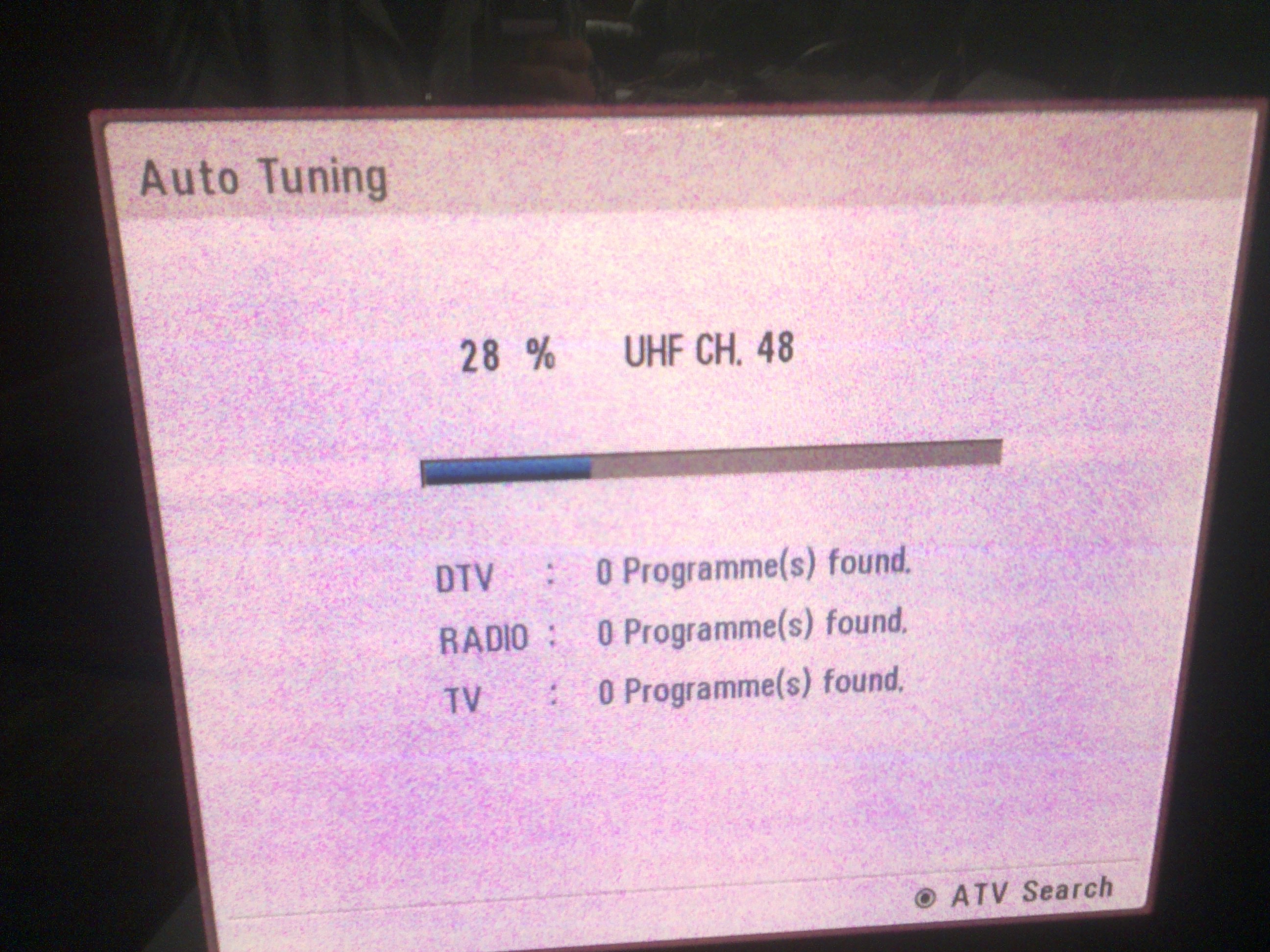

            The problem is really quite bearable but I'm worried that it may get worse and also worried that if it gets worse that it will cause damage to other areas?
              Depends how much it bothers you -- but the Y-sus is pretty cheap and I'm fairly sure that is the issue.

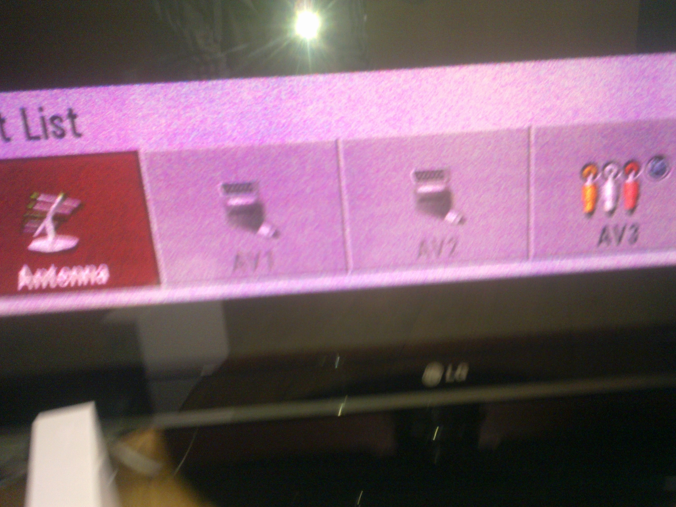

                                        #39
                                        hi i have just collected same tv with what looks like similar fault
                                        see pics i hope they are clear enuff & wait to hear what you recommend
                                        thnx as always
                                          #40
                                          Looks more like a Zsus fault, common problem with these, repair kit is about £20 and involves replacing about 15 parts.
