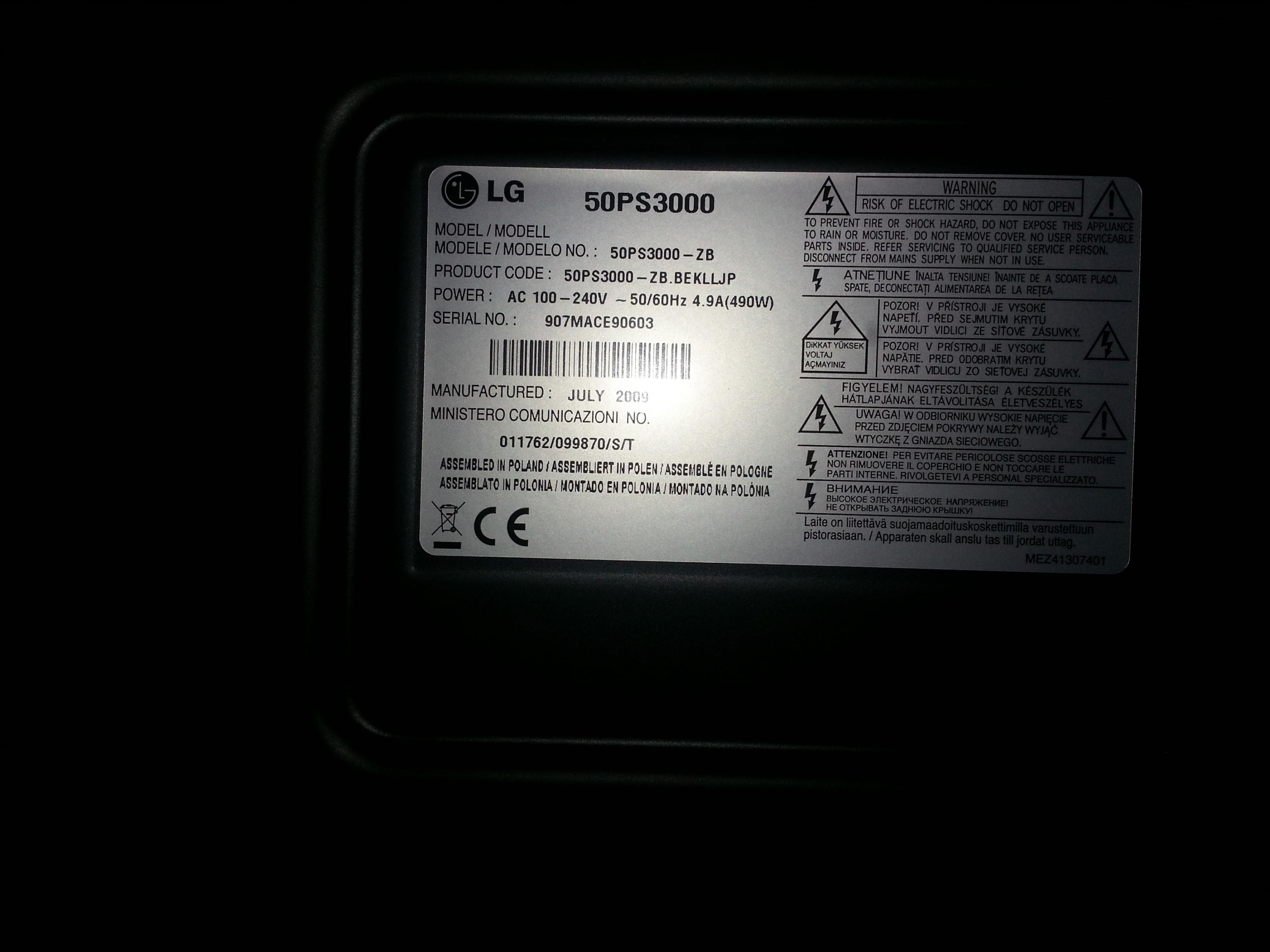

    50" LG Plasma-couple of (hopefully minor) problems
    I have a 50" lg plasma model no. 50ps3000-zb which was manufactured July 2009 and has a couple of problems. There's what looks like red/green and blue snow across the whole screen which is currently not very noticeable; when sat back from it it is not even visible and can only be seen when up close.
    The second problem is very faint white lines that seem almost ghost like which move up the screen and again are not really noticeable except when the screen goes dark during a programme/movie. As it stands I could probably (begrudgingly) put up with it as it is but I'm really concerned that it may get worse. I have been unable to find any other posts with these same symptoms and would greatly appreciate any advice/suggestions?
    P.S. I could try taking pictures of the problems if it helps, though I'm doubtful as to whether anything would show on the pictures.

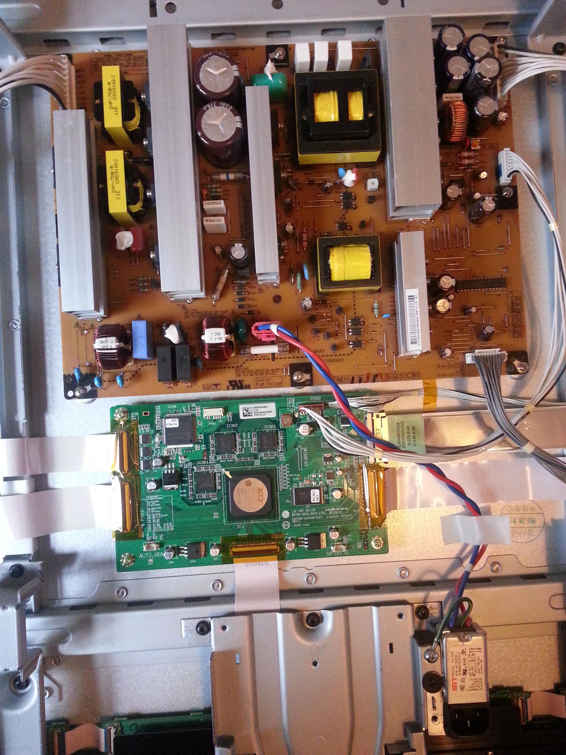

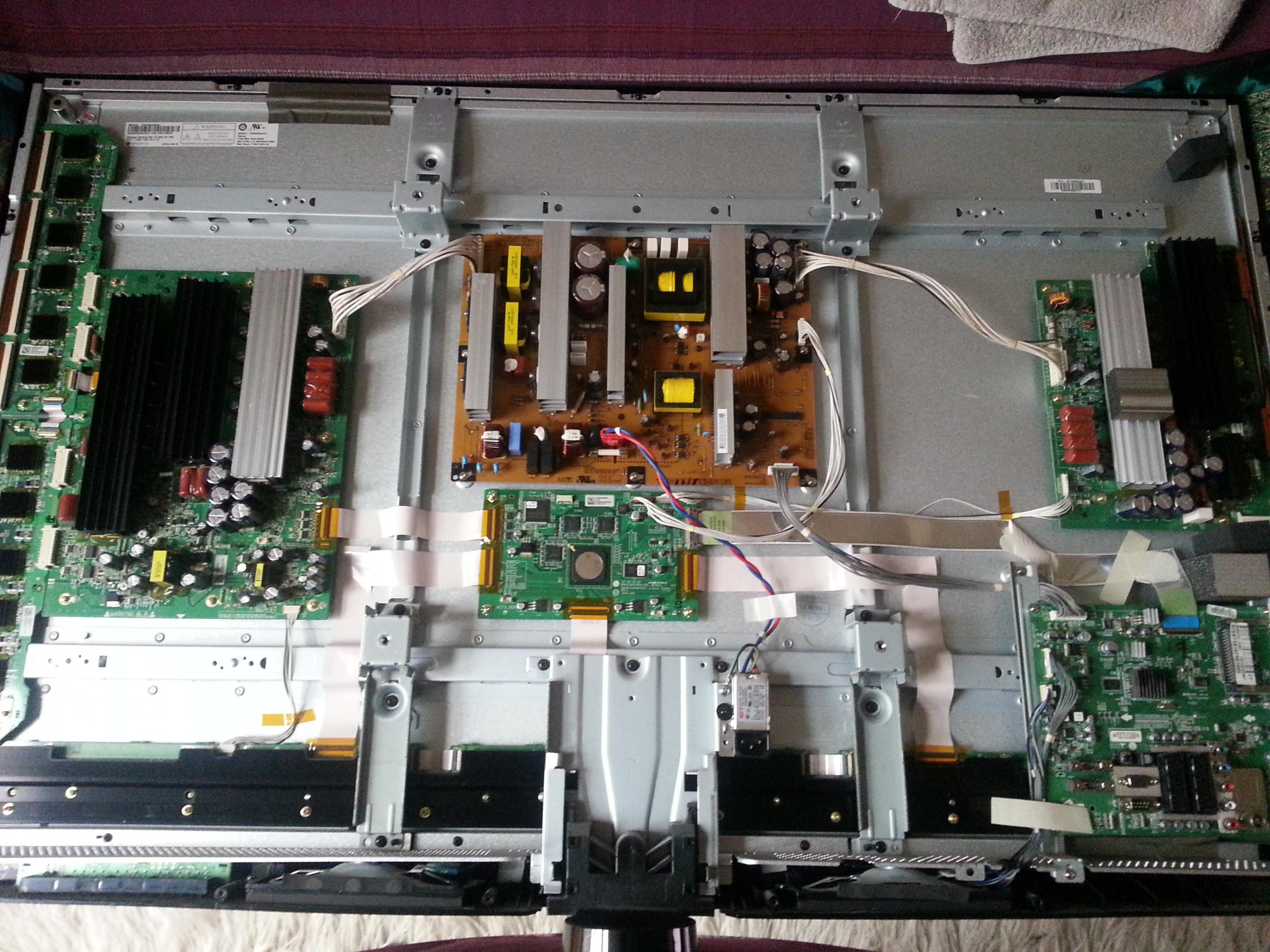

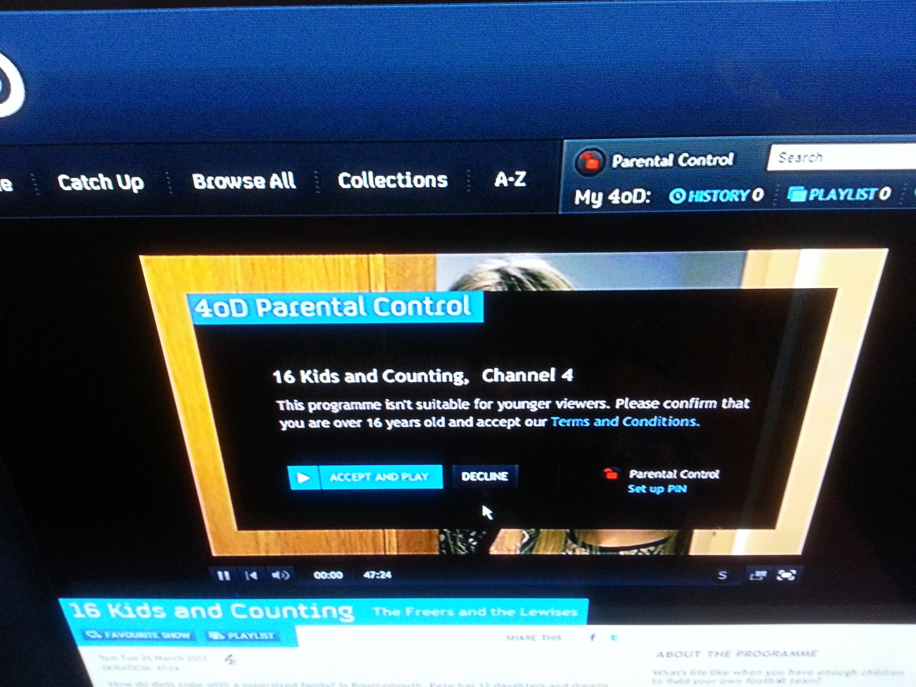

        Re: 50" LG Plasma-couple of (hopefully minor) problems

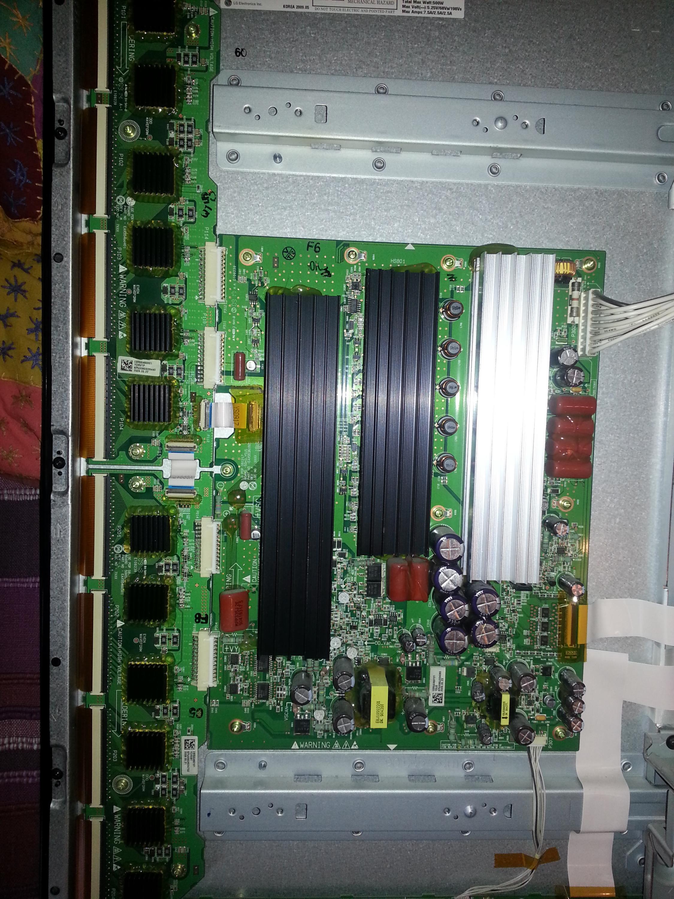

        Thanks Tom66 I really appreciate this, I should probably point out that I'm a complete novice with tv's (though not altogether tech' illiterate) but I'm a fast learner and fairly handy when it comes to taking things apart and putting them back together, also worked on many pc's and am well versed in the 'trial and error' technique
        Apologies for not posting the pic's in the original post.

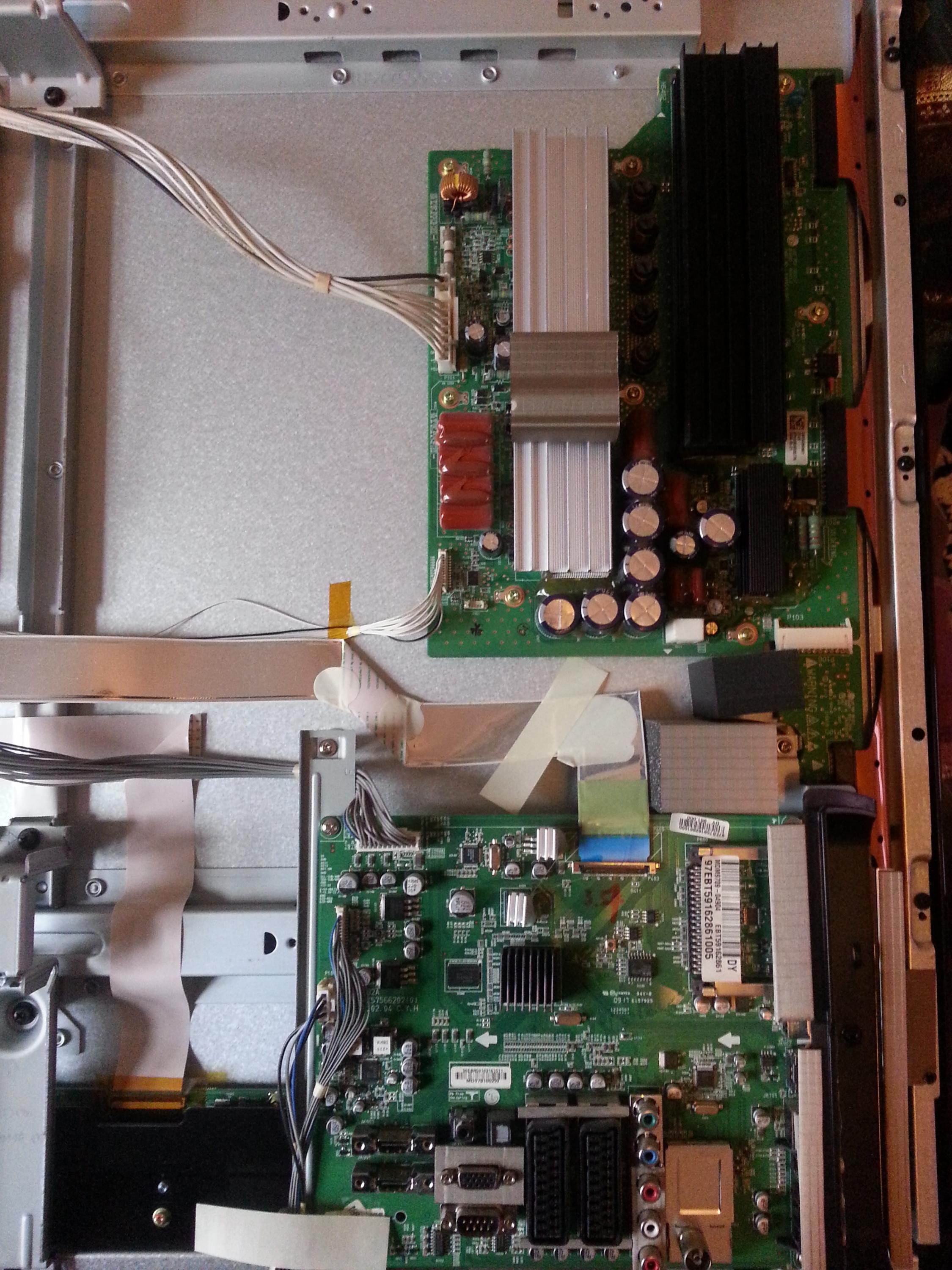

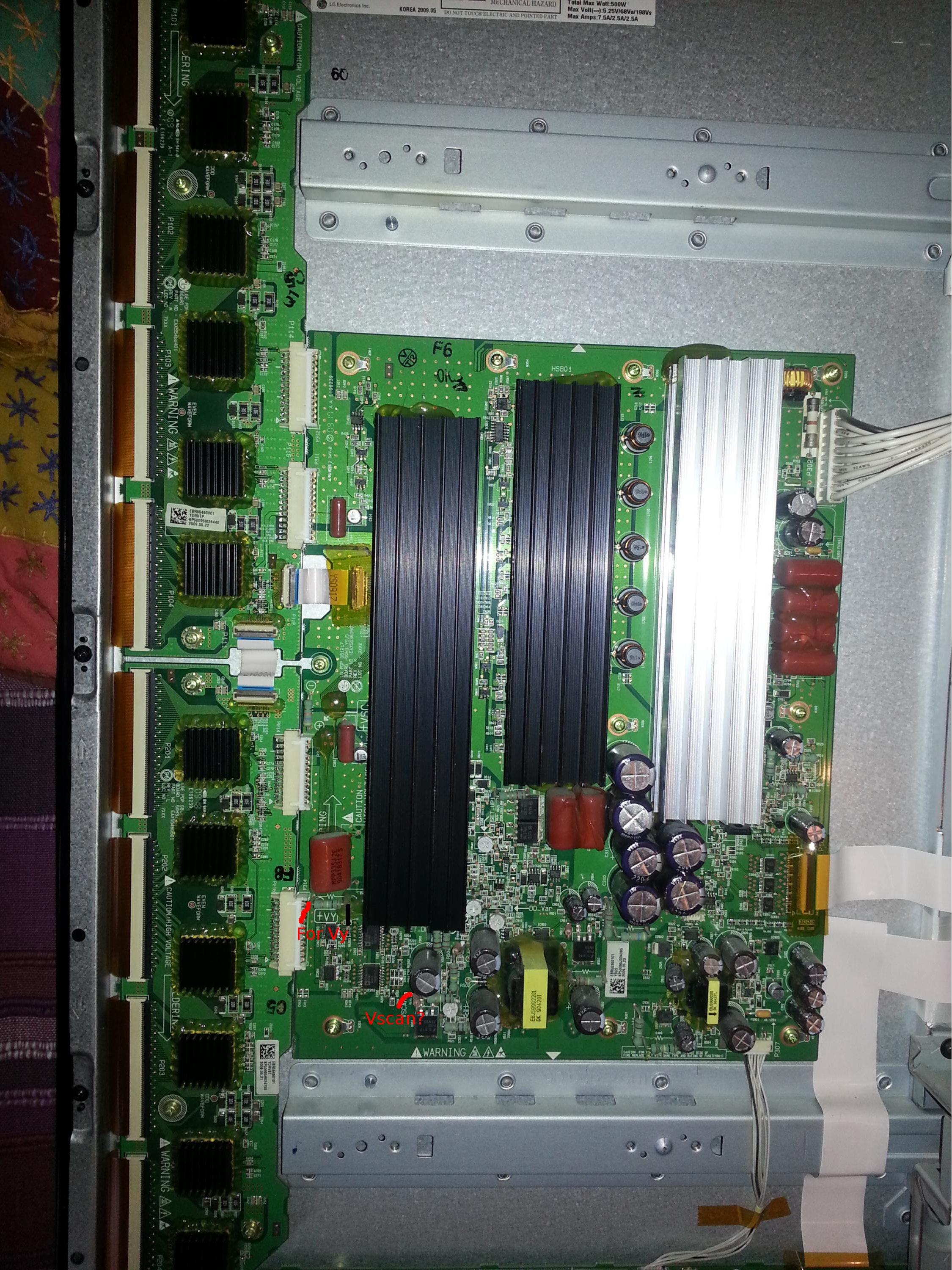

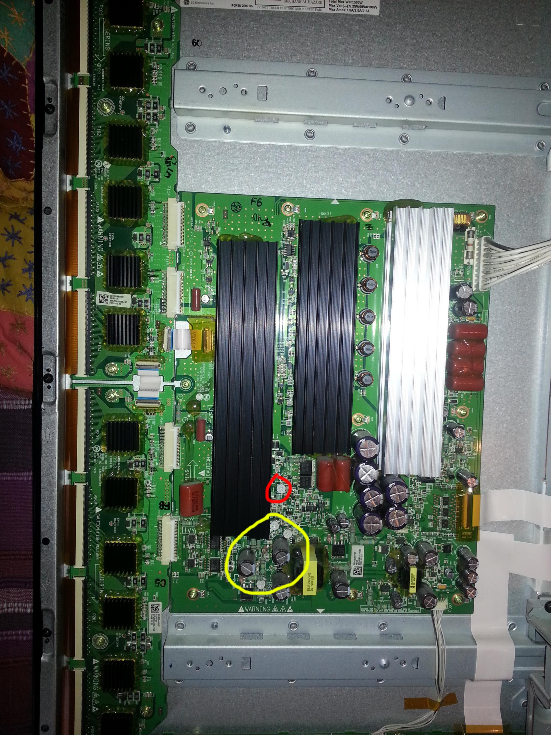

          OK -- in the red region you have the SETUP pot (the little screw-adjustment.)
          Can't see a SETDN pot but it should be somewhere in the yellow area.
          You want to try adjusting SETDN first. Try to get rid of the red/green/blue sparklies. Mark factory preset with marker pen. Power must be on during the adjustment and TV should display video. It's a good idea to use an insulated screw driver to make the changes. If you can't quite get rid of all of the sparklies find the minimum point and then adjust SETUP. Also, note SETUP controls the black level, so for deeper black level (higher contrast) you can adjust that control.

              Ok so I tried adjusting the SETDN which was very interesting! at one end of the spectrum was the white-ish snow like picture which I've seen as a problem that a lot of people seem to suffer from and the other end or slightly before was the best picture I could get (actually not at all far from the factory setting). It is slightly better (and it wasn't really too noticeable in the first place) but despite adjusting the SETUP and playing with the contrast levels I have been unable to remove it altogether. Does this mean that I may need to (if it gets worse) replace the Y-sus board? I may be being naive but it doesn't look too difficult a job?
                I'd first try looking for a -Vy and Vsc test point. These may be them.
                -Vy should be -180V
                Vscan should be +140V
                Check if these are so.
                For -Vy you need to put red and black on the points I indicated.
                For Vscan you can check with red lead on test point, black on chassis.
                Set DMM to 200VDC.

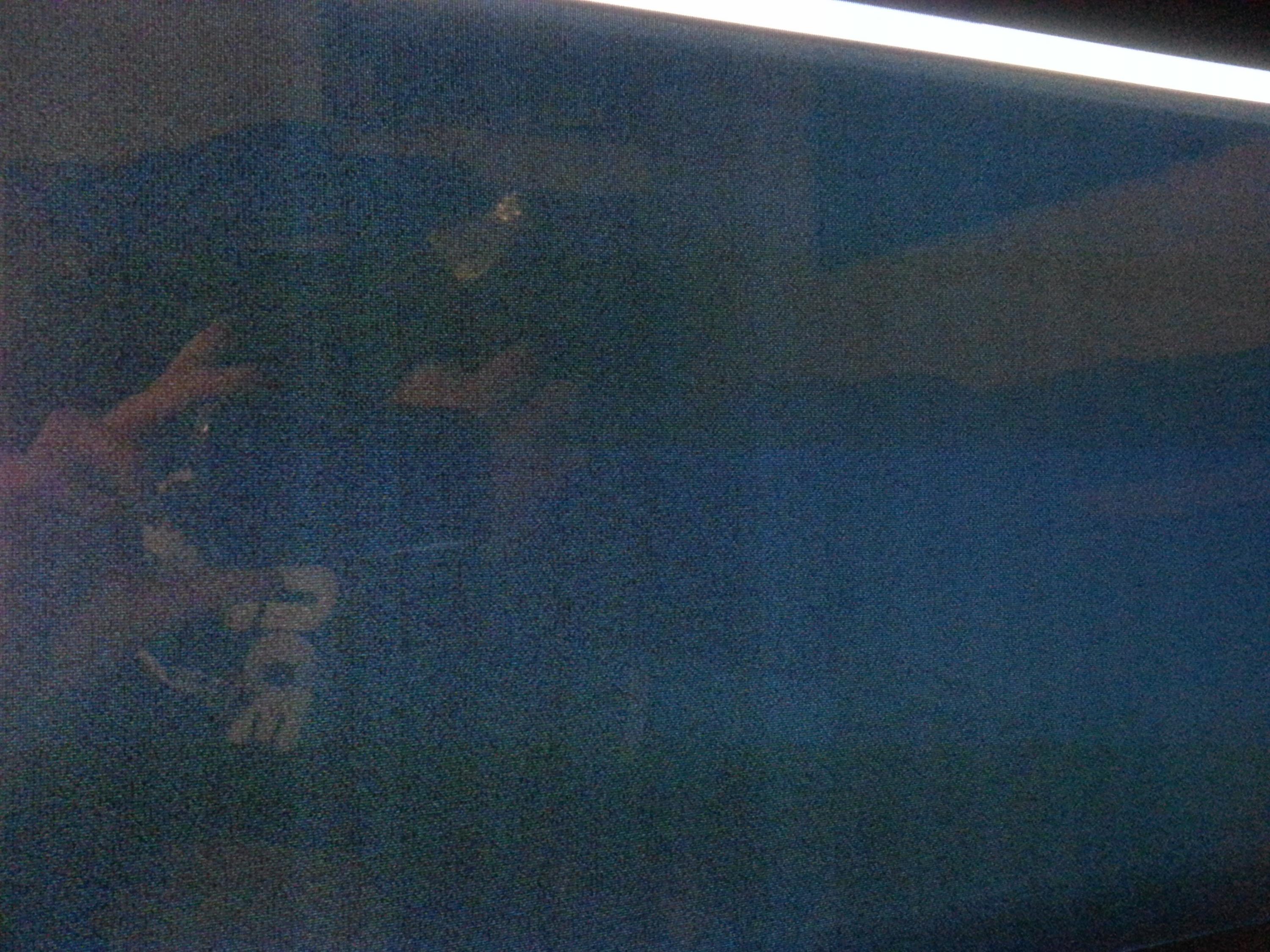

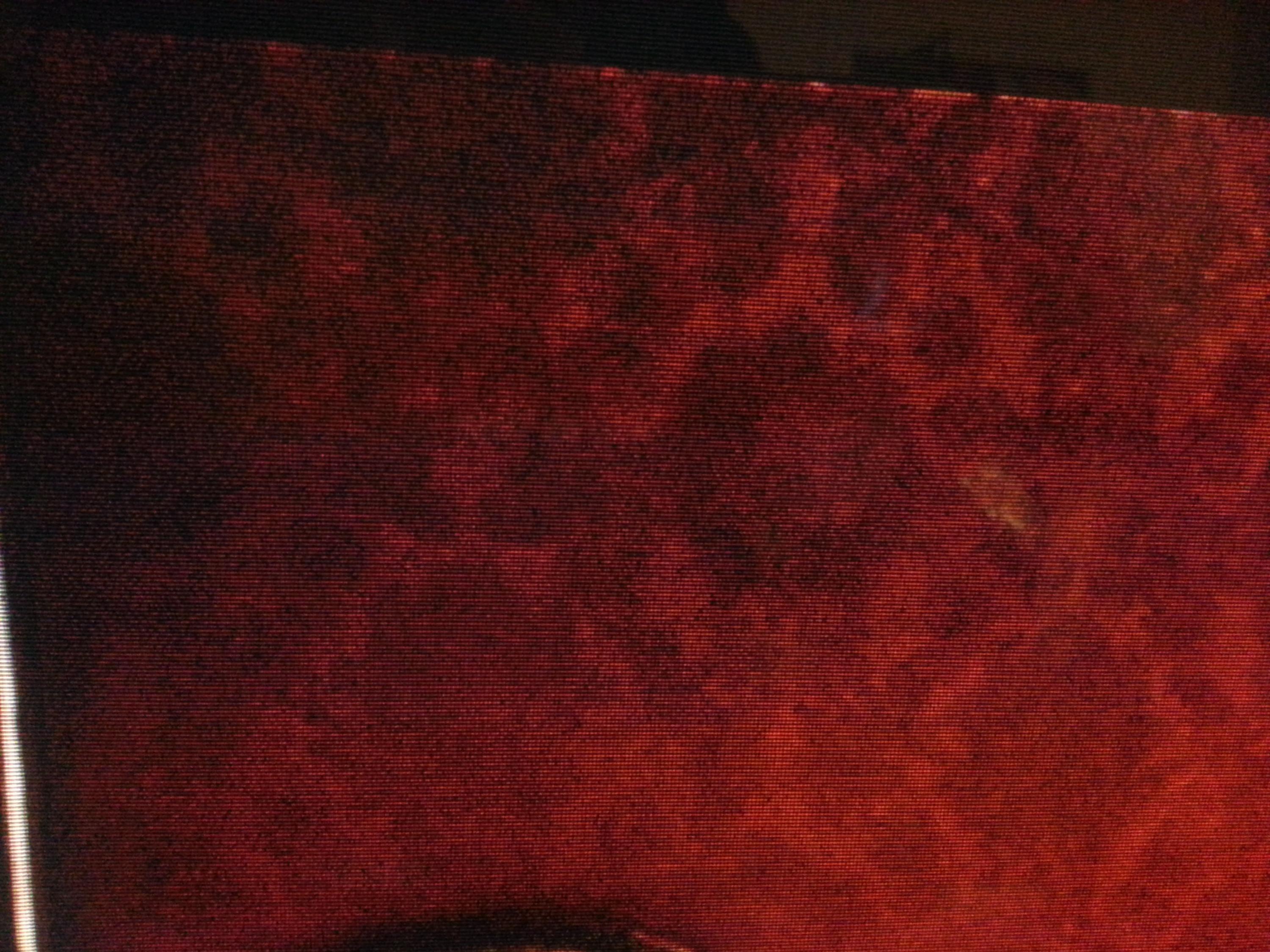

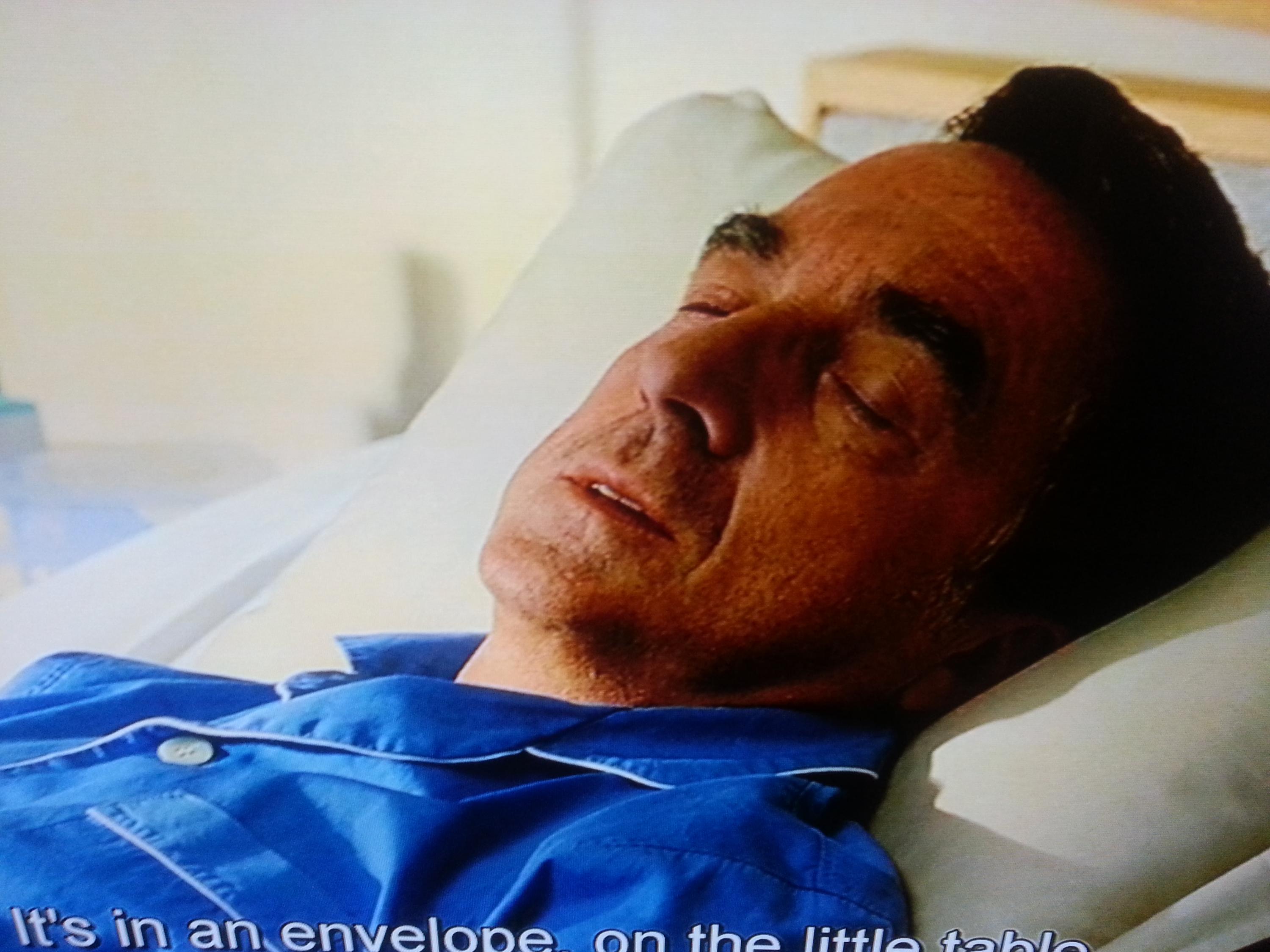

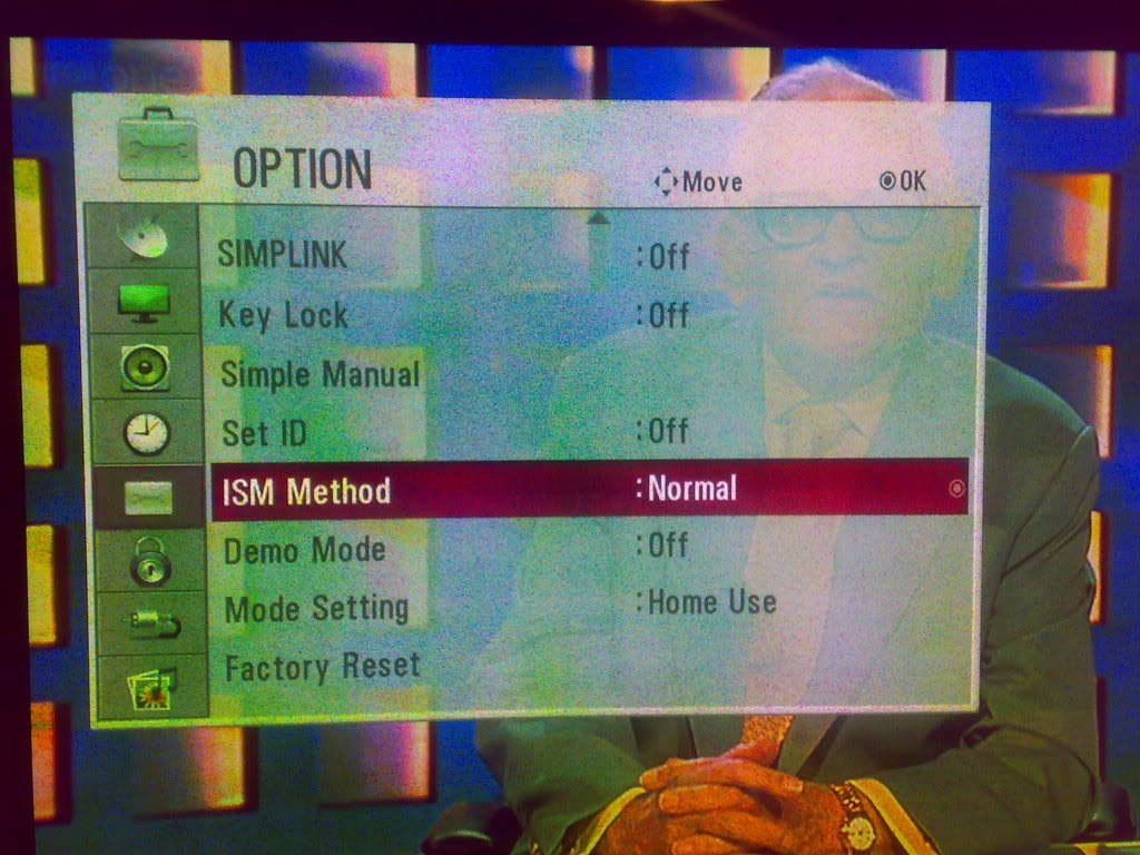

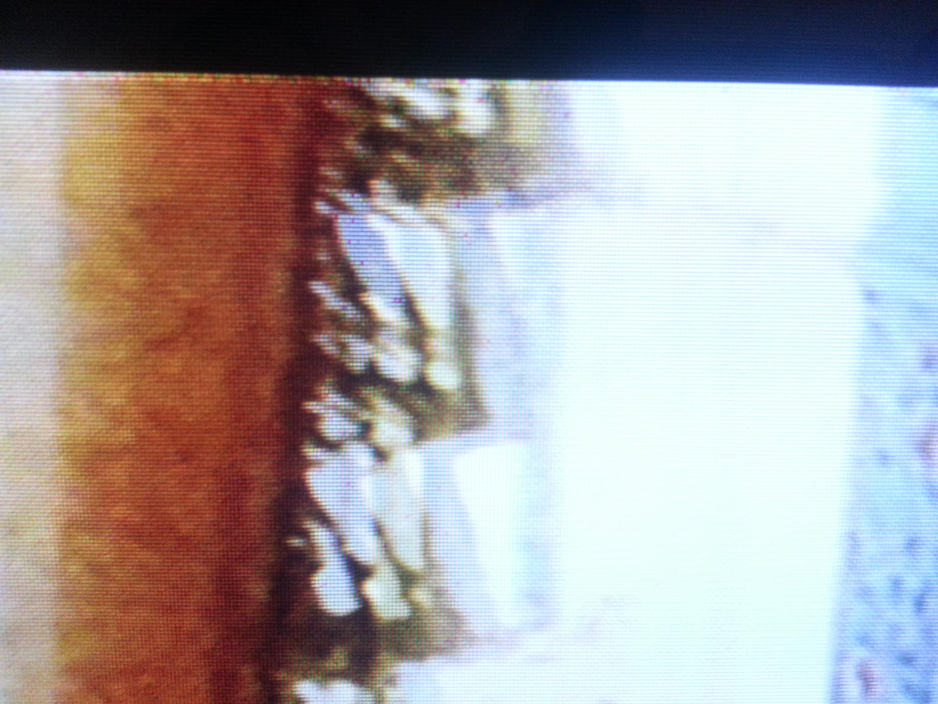

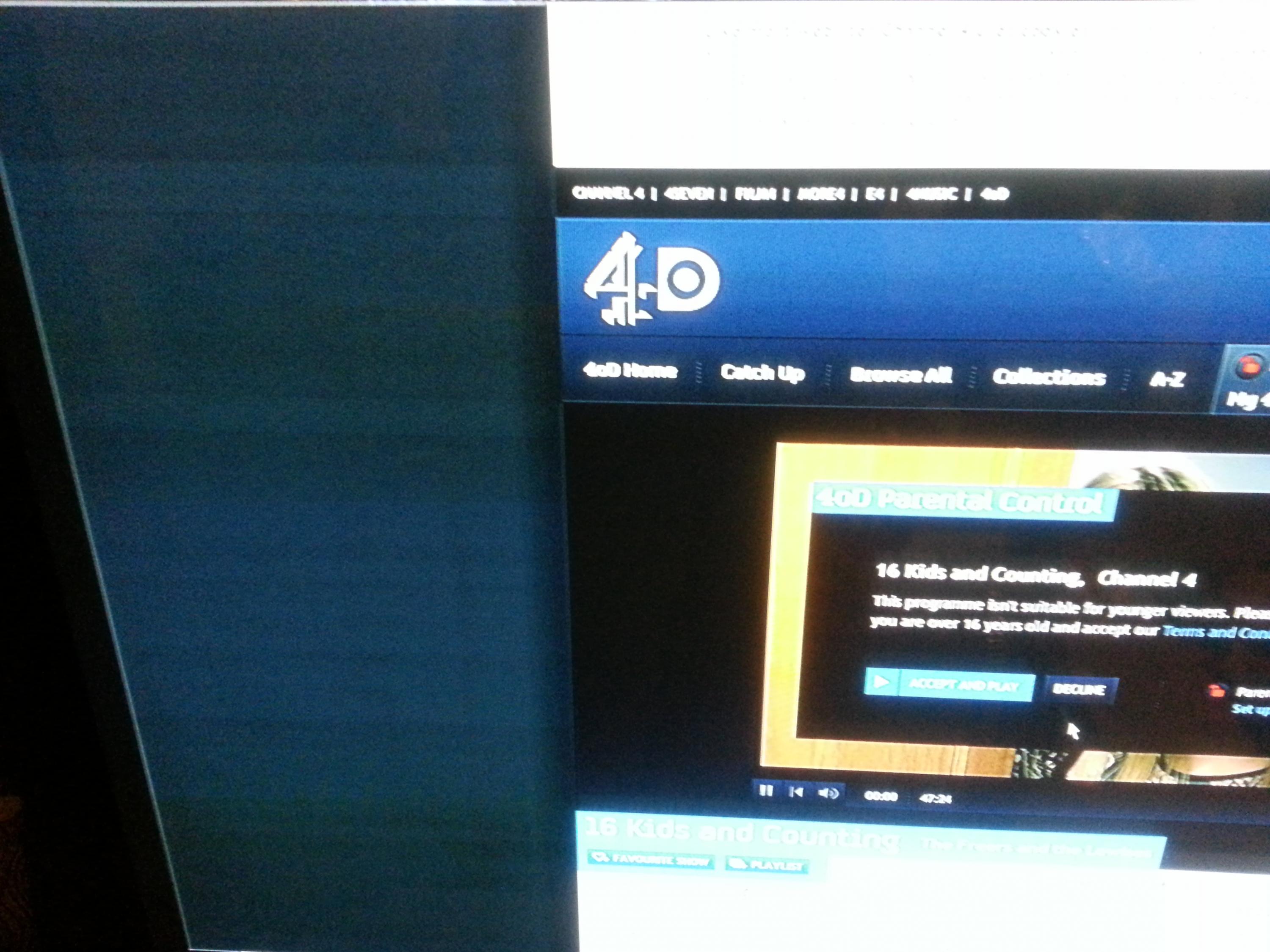

                          Thanks for the responses, not sure what the problem is now. It is actually a lot more noticeable on dark backgrounds rather than white/light...
                          The dots do not seem to be overly red though it could definately be described as poor picture quality. I've struggled to get the problem to show on any pictures so I've taken a collection of photo's of differing scenes and types of image in the hope that you'll be able to discern the problem. Thanks so much for this it really is appreciated.
                          • d-animator
                            • Mar 2013
                            • 30
                            • England
                            It doesn't seem to have a pink tint... in the 1st image you can see the whiteish ghost like horizontal lines that can sometimes be seen moving up the screen but these can only be seen on dark scenes the other problem can only be seen very close up and then again are more noticeable on the darker scenes. I don't have my multimeter with me at the mo so can't check the voltage but will get it tomorrow and will check that then.
                              So this looks to me like maldischarge which is caused by Vscan, -Vy, SetUP and SetDN; please test the points I indicated.

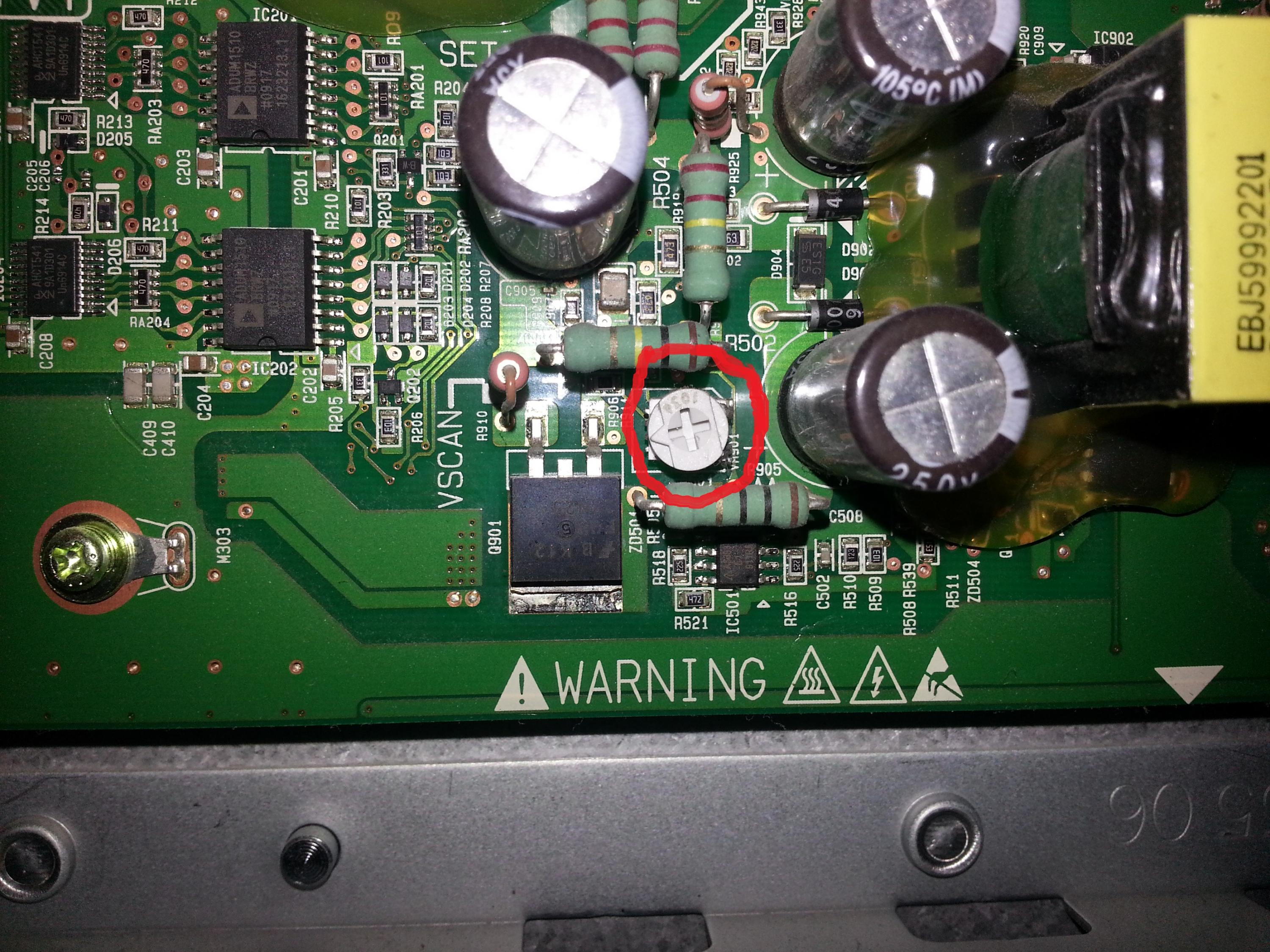

                                  Hmm now I'm fairly new to this side of things so I'm not entirely sure I'm doing this right, I think I've followed the instructions correctly; the Vy came out as -179.8, so far so good I thought, now the Vscan reads +43.3 and not +140!
                                    Yeah, that Vscan sounds like your problem... do you see an adjustment point?
                                    • d-animator
                                      • Mar 2013
                                      • 30
                                      • England
                                      Not sure. There's an adjustment screw nearby but it's not labelled very clearly. What do you think?
                                        Panel alignments manual:
                                        http://www.tgohome.com/ServiceManual...&Search=Submit
                                        (page 122)
                                        That does appear to be Vsc(an) control.
                                        However I may have got the Vsc measurement wrong. See the diagram for where to test. Please do not adjust until you have verified Vsc.
