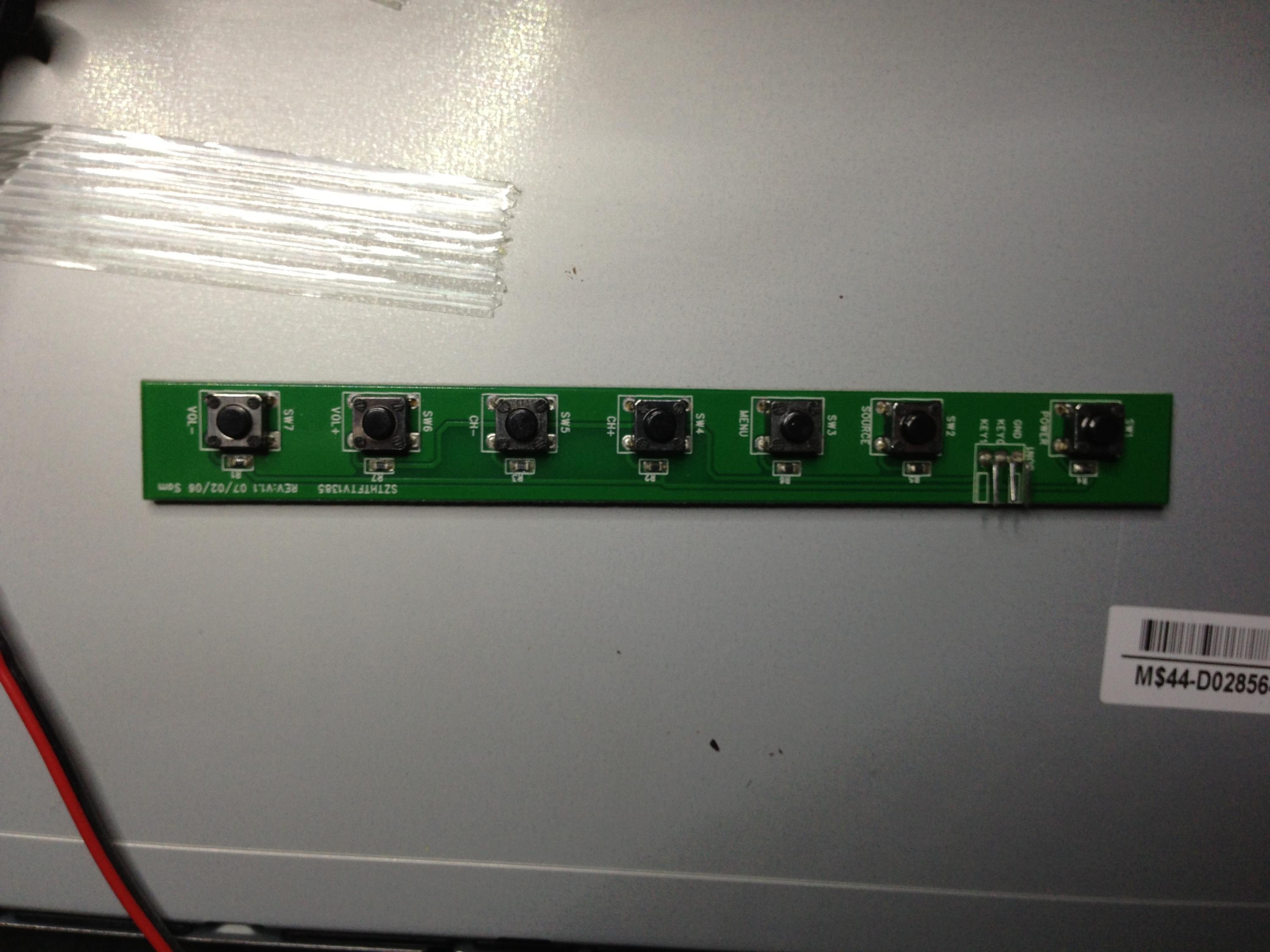

        Ok, i disconnected the buttonboard. I have full control with the remote now. Even with the buttonboard reconnected. The buttonboard is still dead. Its a very simple board with just the buttons and some resistors. These components are fine. I fear the fault might be on the main pcb.....?

          Re: Technivision 22 wont switch channel. Dead Buttons on TV
          I would say if the tv works with the button board disconnected then the button board is likely bad.

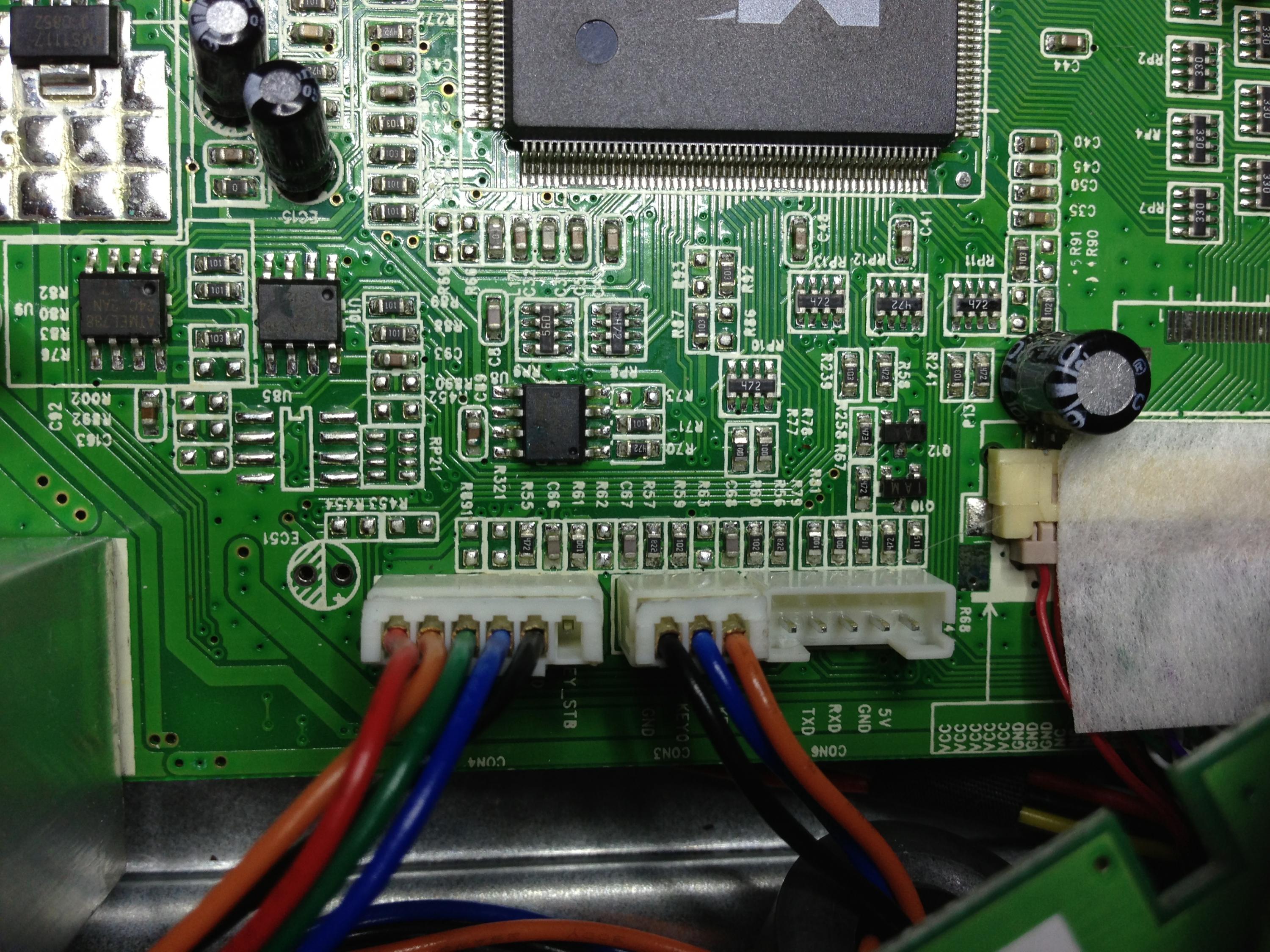

              Cable is good.
              Button board is tested good.
              Some Pics:
              Buttonboard is Con3
              Gnd (black) to C67,
              Key0 (blue) to R57 and R59,
              Key1 (orange) to R60 and R56
                Any voltages recorded between key and ground when a button is pressed
                (try all) - Test the resistors and caps mentioned at least for continuity.
                Can you tell where the circuits go after those components.
                If I recall we have had you doing very similar things on something else a few months back?
                • Mr_K
                  • 111
                  Voltage between key and ground is 3.3V and dropping when a button is pressed.
                  Resistors and Caps seem fine.
                  R59 and R60->to the big IC
                  R57->R70 and RP8
                  R56->RP10 and RP13
                    I dont know what RP8 is but in the pic it looks a bit odd - pitted at the top.
                    Can you have a look with a magnifier.
                    Have you been able to find a reset sequence or a way to get to service menu?
                        I will try and have a look tomorrow.
                        I think its just an network of resistors?!? Will check the rest now.....
