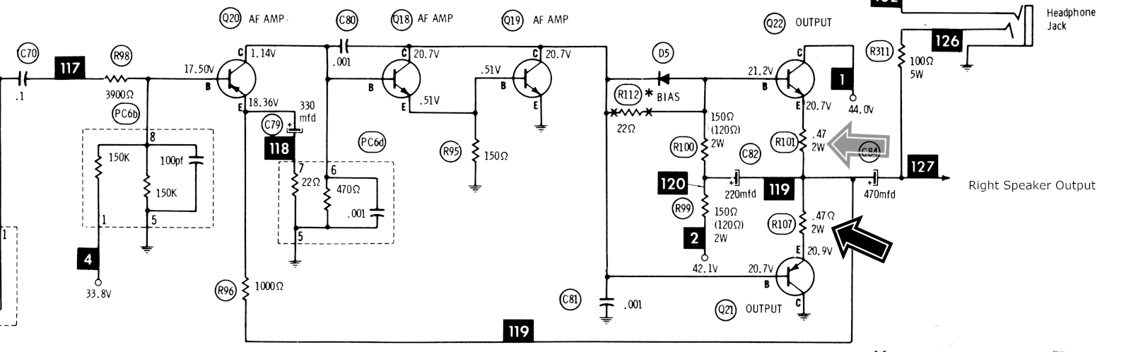

    I am working on repairing a 1970s Magnavox stereo console. The Left channel works perfect, but the right channel is dead at the speaker. This happens in all modes (Tape, Phono, FM Stereo). Now, I do have audio from the right channel via the "Tape Record" output, so this confirms the problem is in the right channel AF and Output amp? I also tested the speaker itself. I attached a schematic of the Right channel: AF and Output.
    In addition to a recap, I found that R101 and R107 were both open (see arrows). I replaced R101 and R107, but they both become very hot. MUCH MUCH hotter than the left channel. Also, transistors Q21 and Q22 became very warm so I removed power. Q21 and Q22 both test fine (even after the heat). The voltages at Q21 and Q22 were both pulled down low. So a ton of load is being put on the output transistors and R101, R107. The left channel also had low voltages, but no heat. I believe the problem in the right channel was pulling the whole power supply down, too.
    I am just now learning about amps, so forgive me for using terms incorrectly. I believe R101 and R107 have to do with the push pull system of Q22 and Q21? I read somewhere that you can run into oscillation problems and thermal runaway when this section acts up? I can't find any other bad parts. Tested Q20, Q18 and Q29, all the resistors.. Really looking for some advice.
    Thanks.

    Don't worry about oscillation yet.
    Oscilloscope would be helpful, or a battery operated handheld amplifier/speaker to trace.
    Voltages at all the test points in range?
    Is D5 working or is it open?

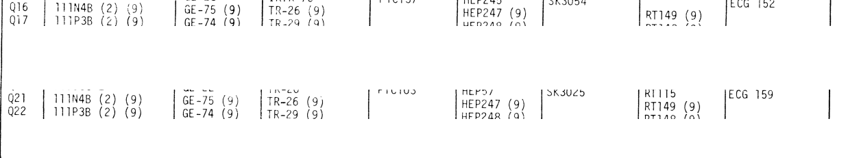

                        Q21= 111N4B (replacement would be a NTE130)
                        Q22= 111P3B (replacement would be a NTE219)
                        I use the diode test on my Fluke 88V. I also double check everything using a Proster BM4070.
                        So, with R101 and R107 open (or removed), the readings in the right channel are not right, as you would expect. These are the reading I got when troubleshooting before removing/replacing any parts:
                        Q22:
                        C=48v
                        E=44v
                        B=44v
                        Q21:
                        C=0v
                        E=0v
                        B=44.3v
                        On the left channel(see new attachment),
                        Q16
                        C=48.2v
                        E=22.3v
                        B=22.9
                        Q17
                        C=0
                        E=22.3
                        B=22.1
                        Now, If I install new parts for R101 and R107,
                        Q22
                        C=30V (the input voltage from the PSU, should be 48)
                        E=4.4 (should be 22ish)
                        B=5V (should be 22ish)
                        Q21
                        C=0v
                        E=.39v
                        B=5v
                        Q16 (left channel)
                        C=30v
                        E=16v (the voltage starts at 12, then rises up to 15 in about 5 seconds)
                        B=16v (the voltage starts at 12, then rises up to 15 in about 5 seconds)
                        Q17 (left channel)
                        C=0
                        E=15 (the voltage starts at 12, then rises up to 15 in about 5 seconds)
                        B=15 (the voltage starts at 12, then rises up to 15 in about 5 seconds)

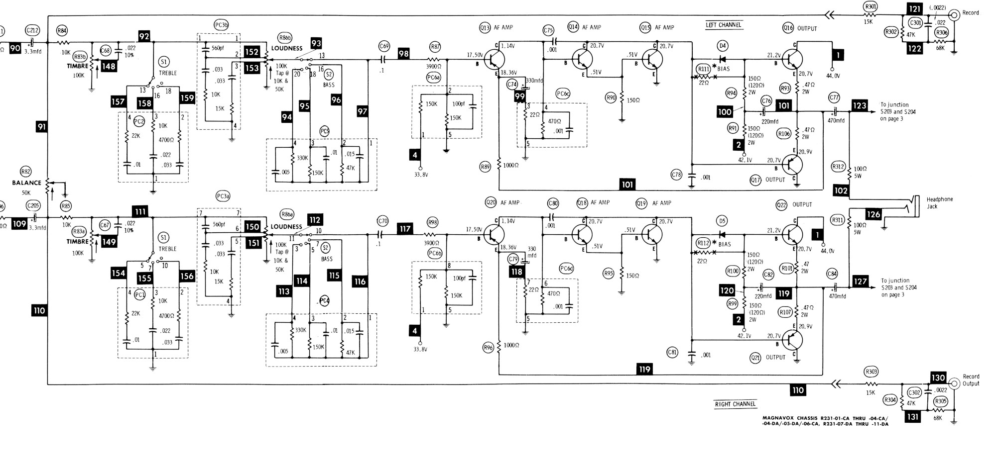

                        Just to help a bit, I attached the whole AF/Output for both channels.

                          Re: 1973 Magnavox. One dead channel.
                          Have you checked R99, R100 & R112? Also Q18, Q19 & Q20

                            I have tested Q18, Q19 & Q20
                            R100=122.8ohm
                            R99=128.1ohm
                            R112=22ohm
                              ^Is this how you installed the outputs? ^
                              Q21 is a PNP transistor (nte219)
                              Q22 is a NPN transistor (nte130)
                              I suspect tor transistors are in backwards

                                Let me take a closer look at this. I gave you the part numbers based off the parts list, not based off the unit itself.
                                • JunkForLess
                                  • Nov 2021
                                  • 44
                                  Yes, this must be an error in the parts list.
                                  As-installed:
                                  Q22 and Q16 are the same parts
                                  Q21 and Q17 are the same parts.
                                  This would look like an error in the parts list, correct? I have noticed some other errors. For example, the parts list has 35v caps where 50v caps are installed from the factory.

                                    Q21 must be PNP. If C is 0V, B is 5V and E is .31V this looks like saturation and is a problem. This does not make sense as the transistor should be cutoff, seems it either has an E-C short or you have an NPN transistor installed here.
                                    But according to the data presented, this is impossible that it had the wrong parts installed at the factory...or there's some history not here? Where are the transistors installed? Chassis? Any way to have an erroneous identification of the two transistors?
                                    Having 50V caps installed instead of 35V caps isn't of concern, it will work just fine. Swapping a PNP for NPN, that's a problem.
                                    Yay Q16=Q22=NPN=111N3B=NTE130=our favorite 2N3055
                                    Q17=Q21=PNP=111P3B=NTE219=MJ2955
