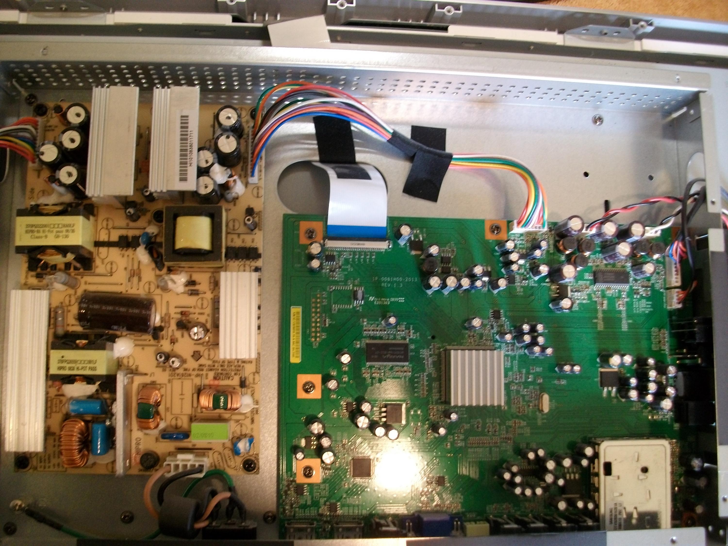

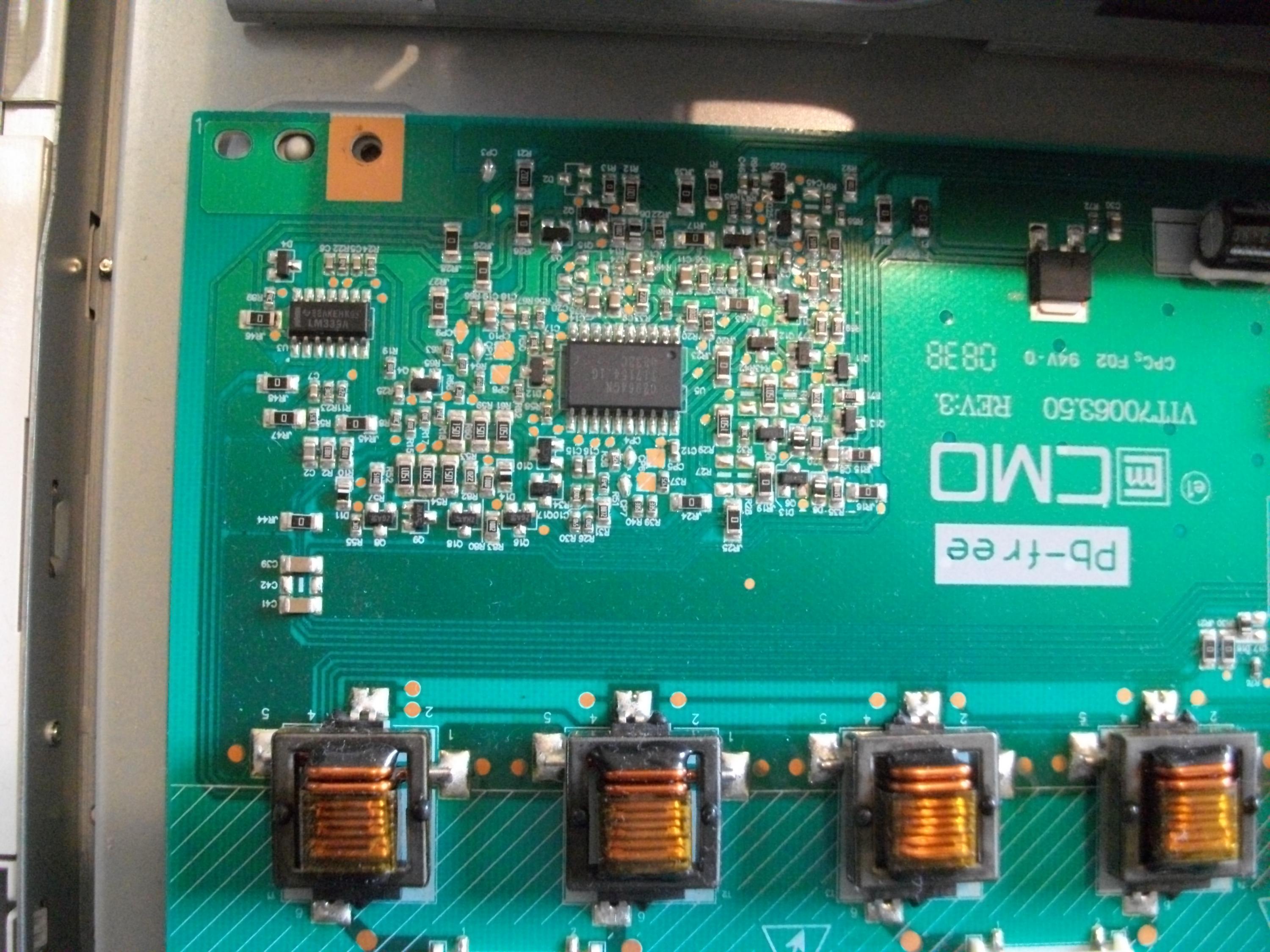

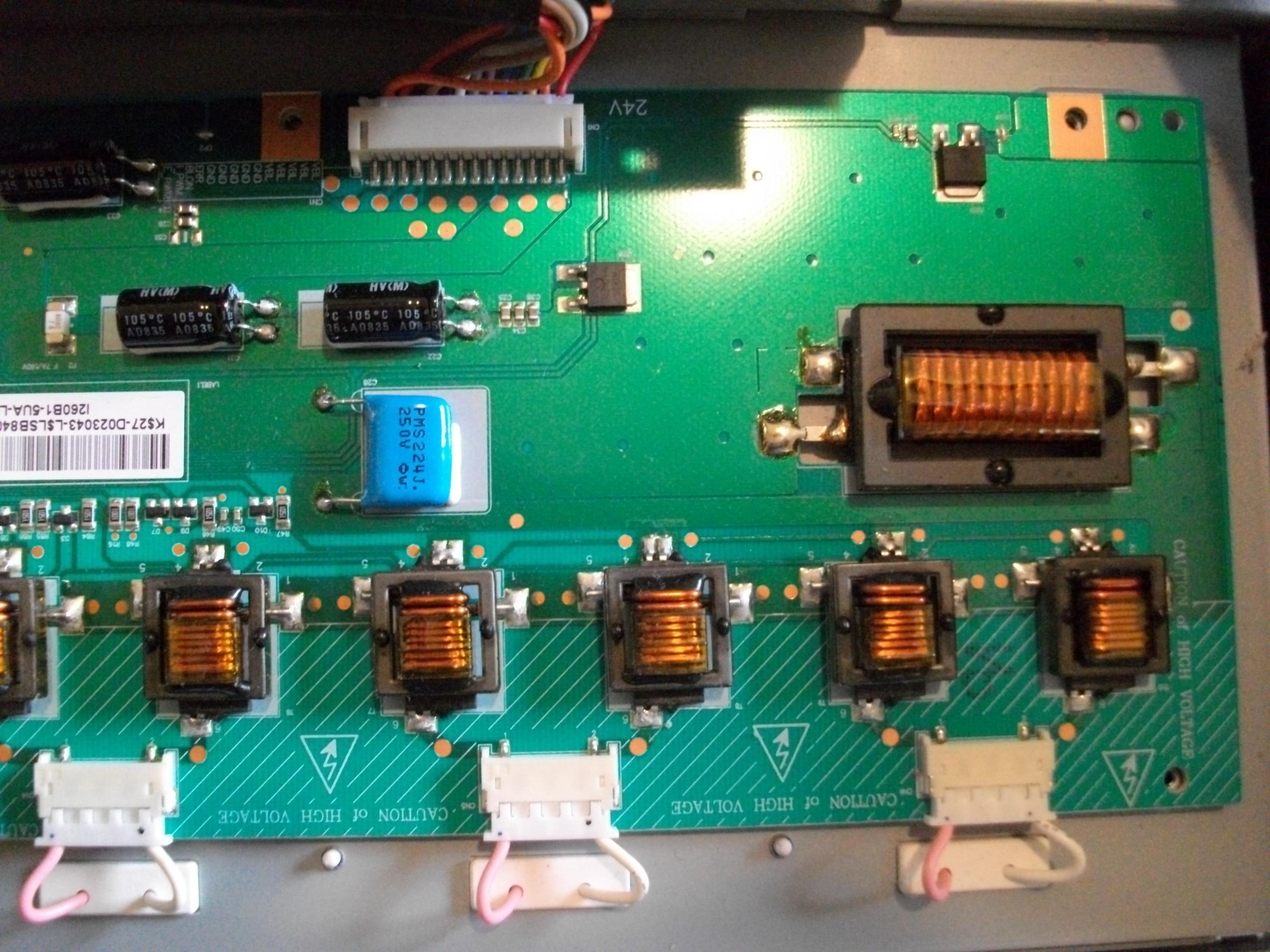

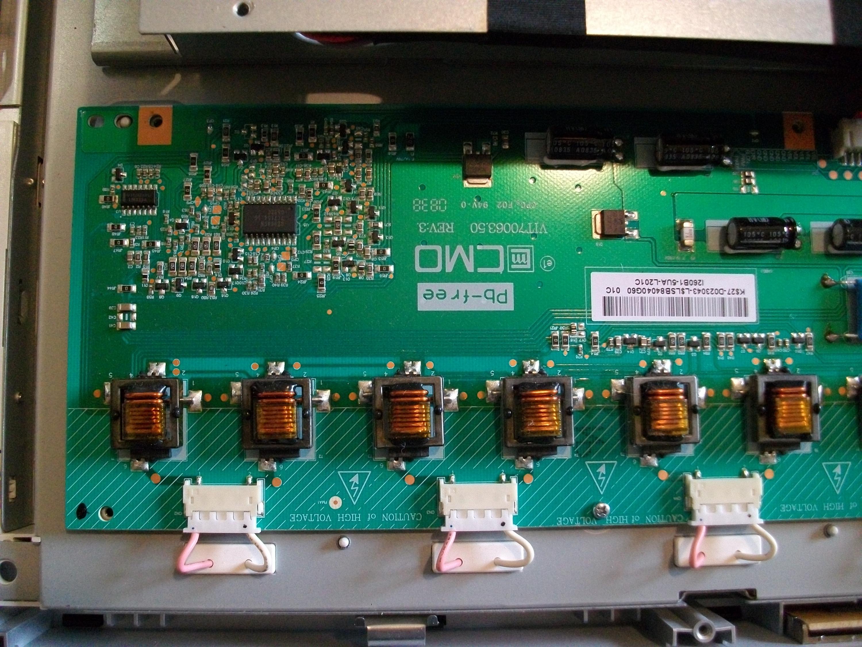

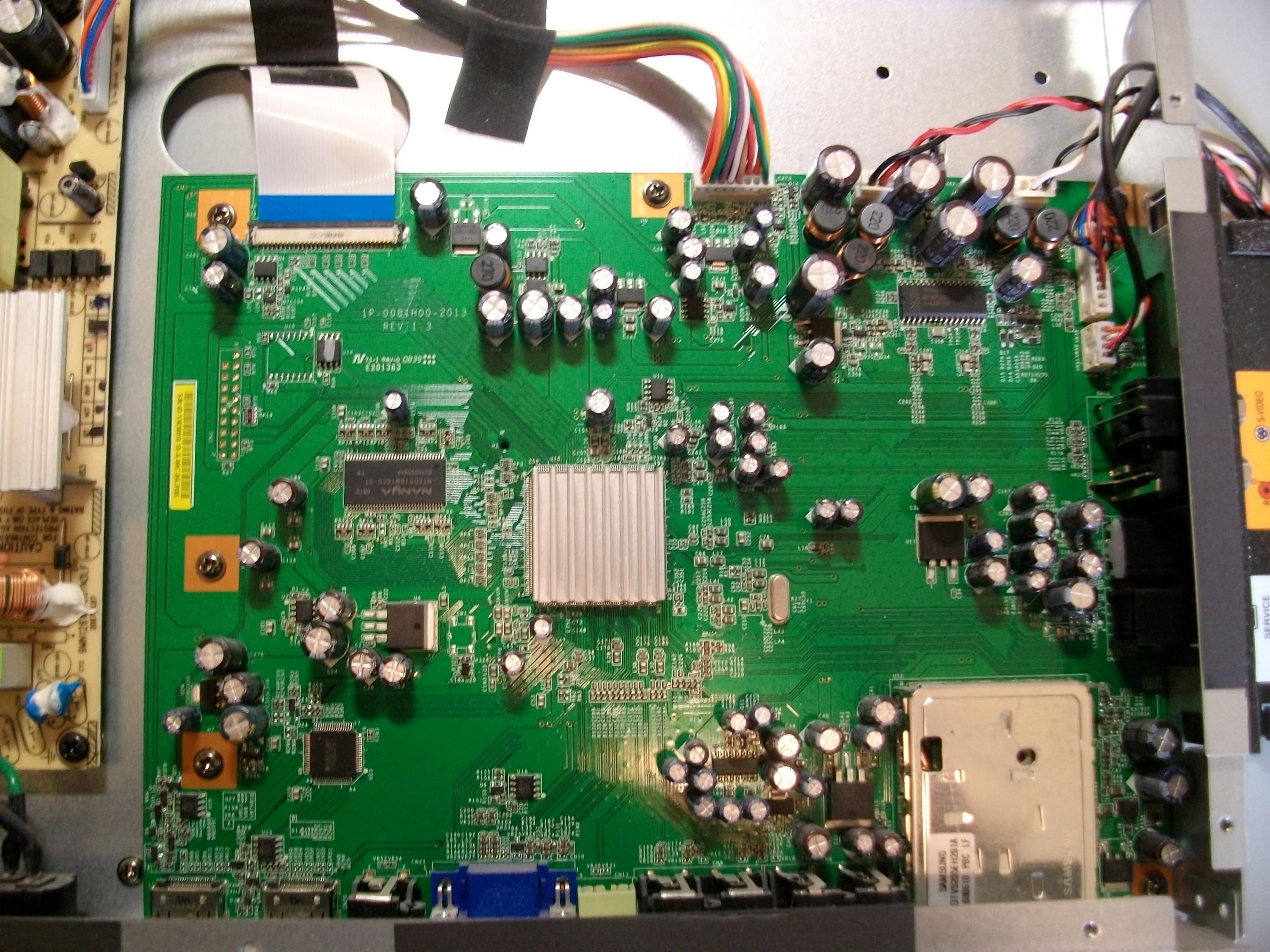

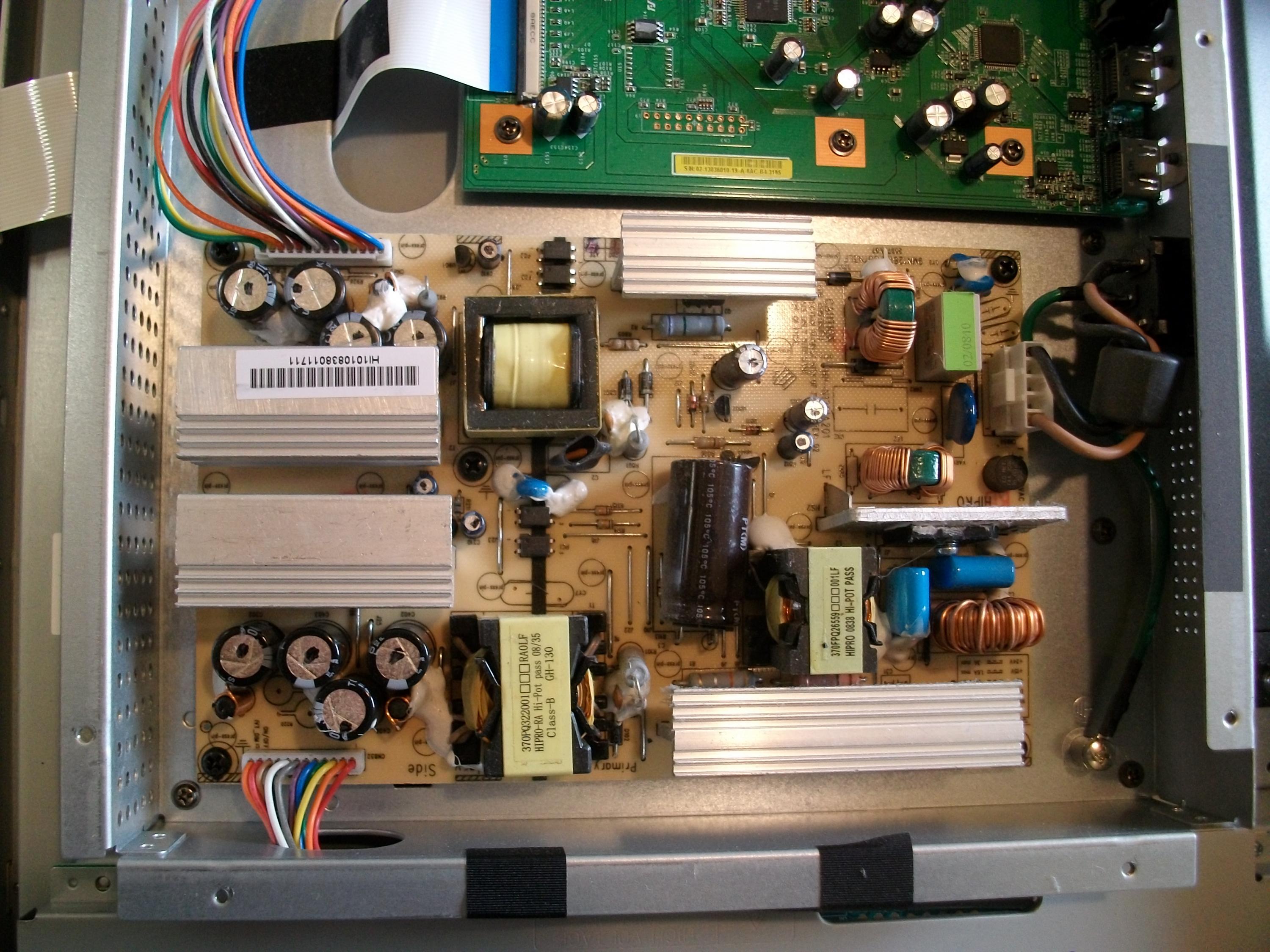

      Re: Vizio 26" VW26L Flickering white screen
      here's some pictures
                                  Here are the pictures of the one I worked on:
                                  http://s807.photobucket.com/user/bud...92377915704561
                                  Not the same as youir chassis.
                                  It sounds like you haver two problems, one is flickering backlights, and dead T-CON board.
                                  I would get to the T-CON board and checjt he fuse and the voltage on both ends of the fuse. T-con is under the metal shield.
                                  • CR Designs
                                    • Dec 2012
                                    • 430
                                    Not the same as your chassis.
                                    BudM I looked at your photo's yesterday as you say not the same. I can not find the tcon board on this tv.do have any idea's where it's at? I looked under the main and power board
                                      Not good news for your chassis, you have one of those LCD panel with integrated T-CON board (some kind of setup uses in the small PC LCD monitor). You will have to take the LCD pnael apart to get to the board to check the fuse, not sure if it will be worth it for 26" TV
                                      • kevinm34232
                                        • May 2012
                                        • 1884
                                        It looks like it's integrated into the main board, there's a ribbon cable coming off of the top left. I just got a 47" Vizio E471VLE today, same thing..
