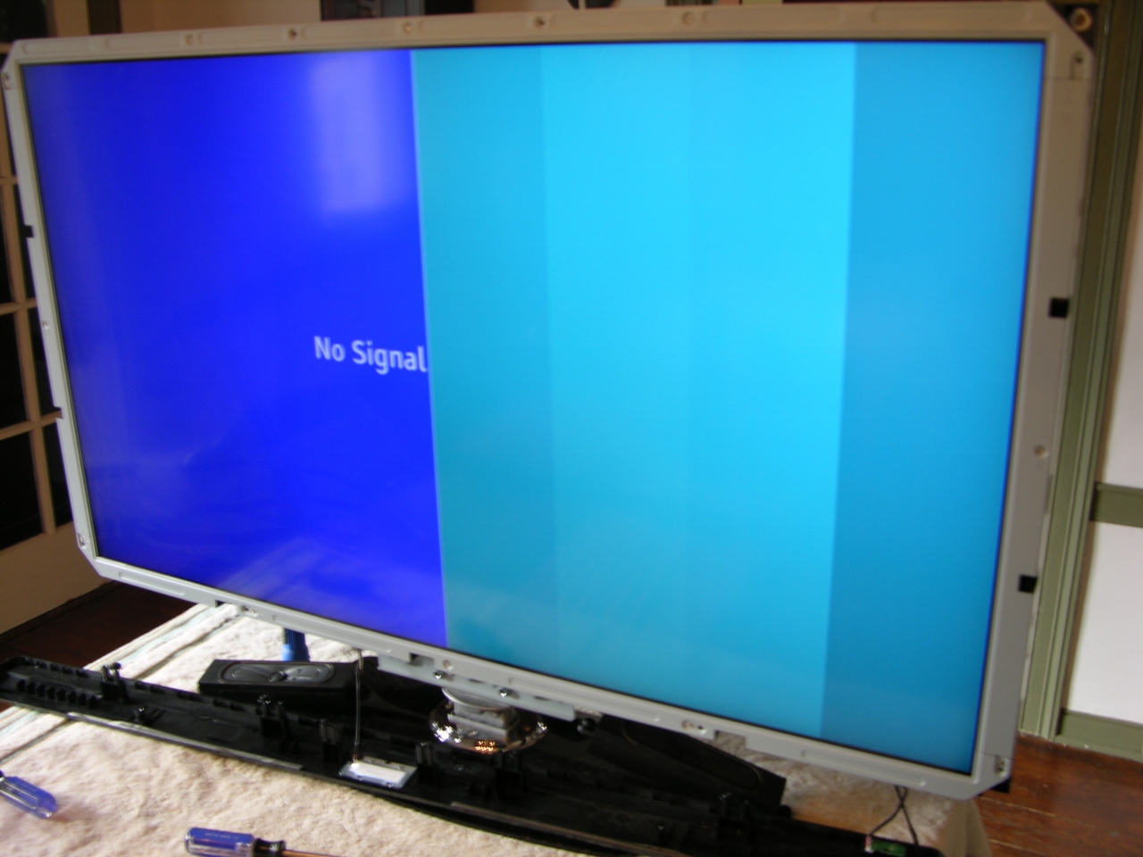

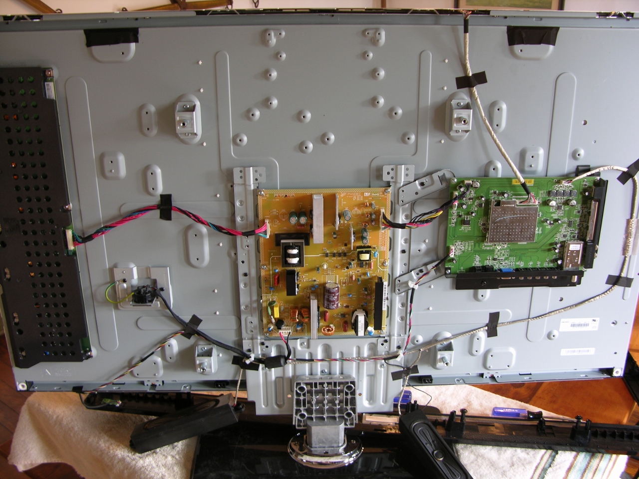

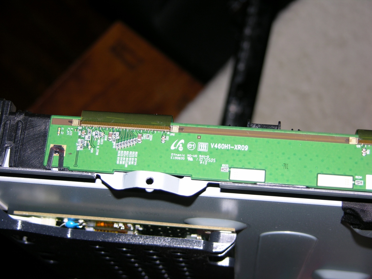

I have a Vizio E460ME 46" LCD tv that is suffering from large vertical bars of color on the right side of the display, exactly half. Unfortunately this model has two separate T-Con boards that are directly connected through ribbon cables to the display - can't replace the board without replacing the entire display. I've gently played with the ribbon cables that are glued to the display, unseated and reseated cables that go from the main video board to the T-Con and nothing seems to help. From everything I have read it seems that the diagnosis for most line problems, vertical or horizontal are diagnosed as ribbon cable problems or "replace LCD" display.
I know many of these circuit boards are basically unrepairable unless you have surface mount equipment - many of the components need a magnifying glass to be seen!

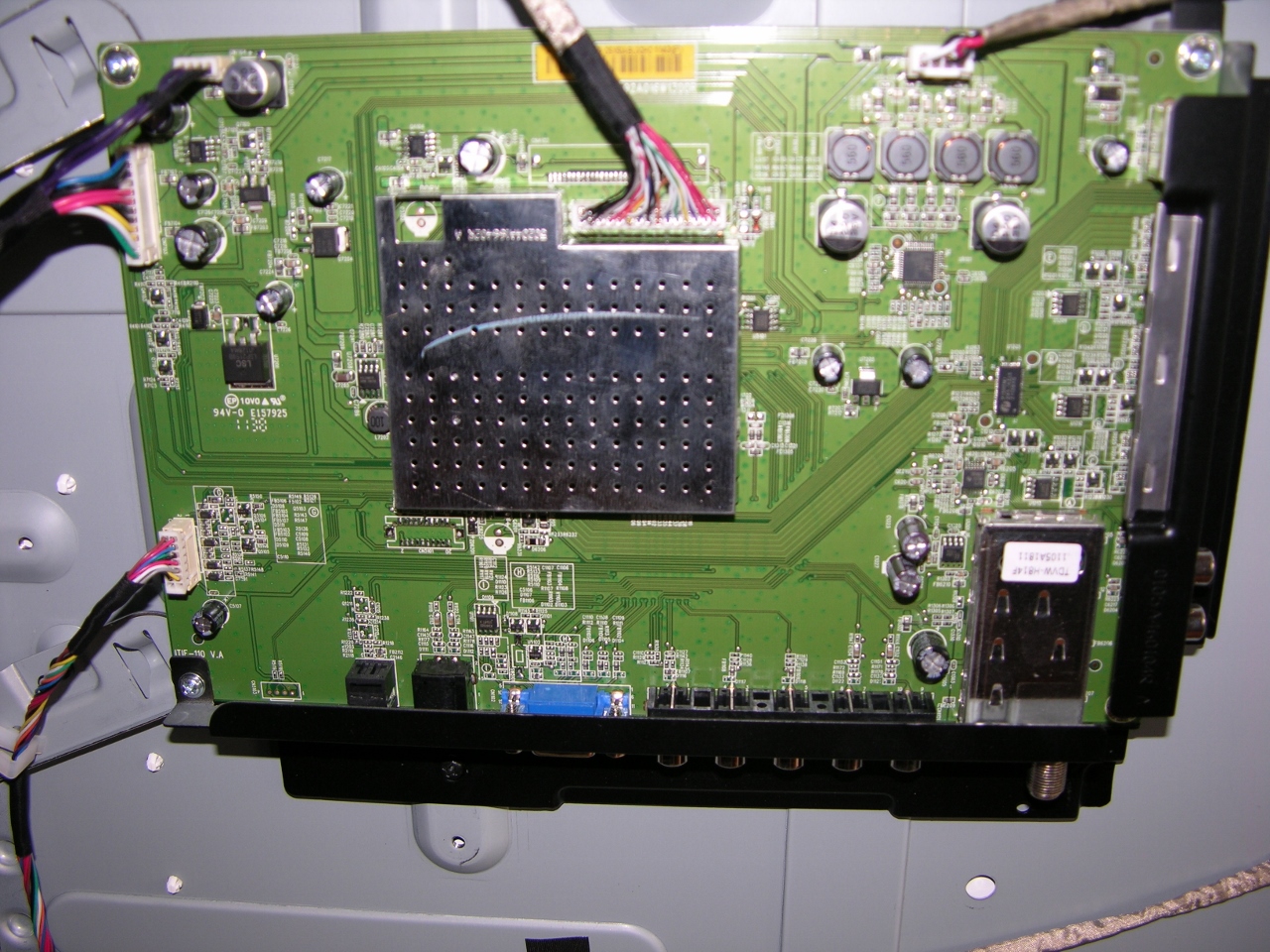

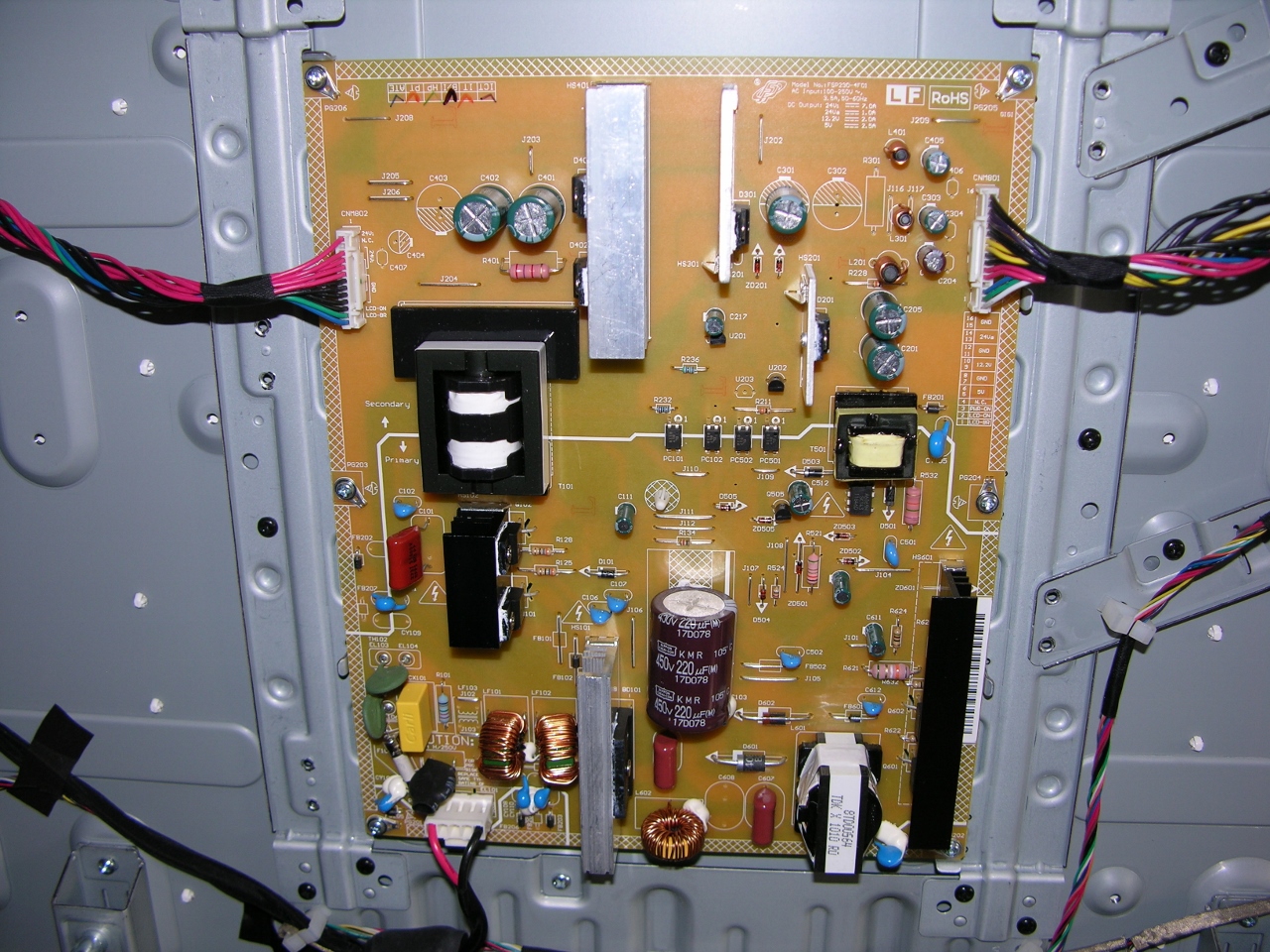

I am thinking a good first step is to measure voltages to see the health of the power supply. No obvious failed caps. The video/tuner board also has quite a few electrolytics - wondering if one of these could cause the problem but I am not sure how these circuits work.

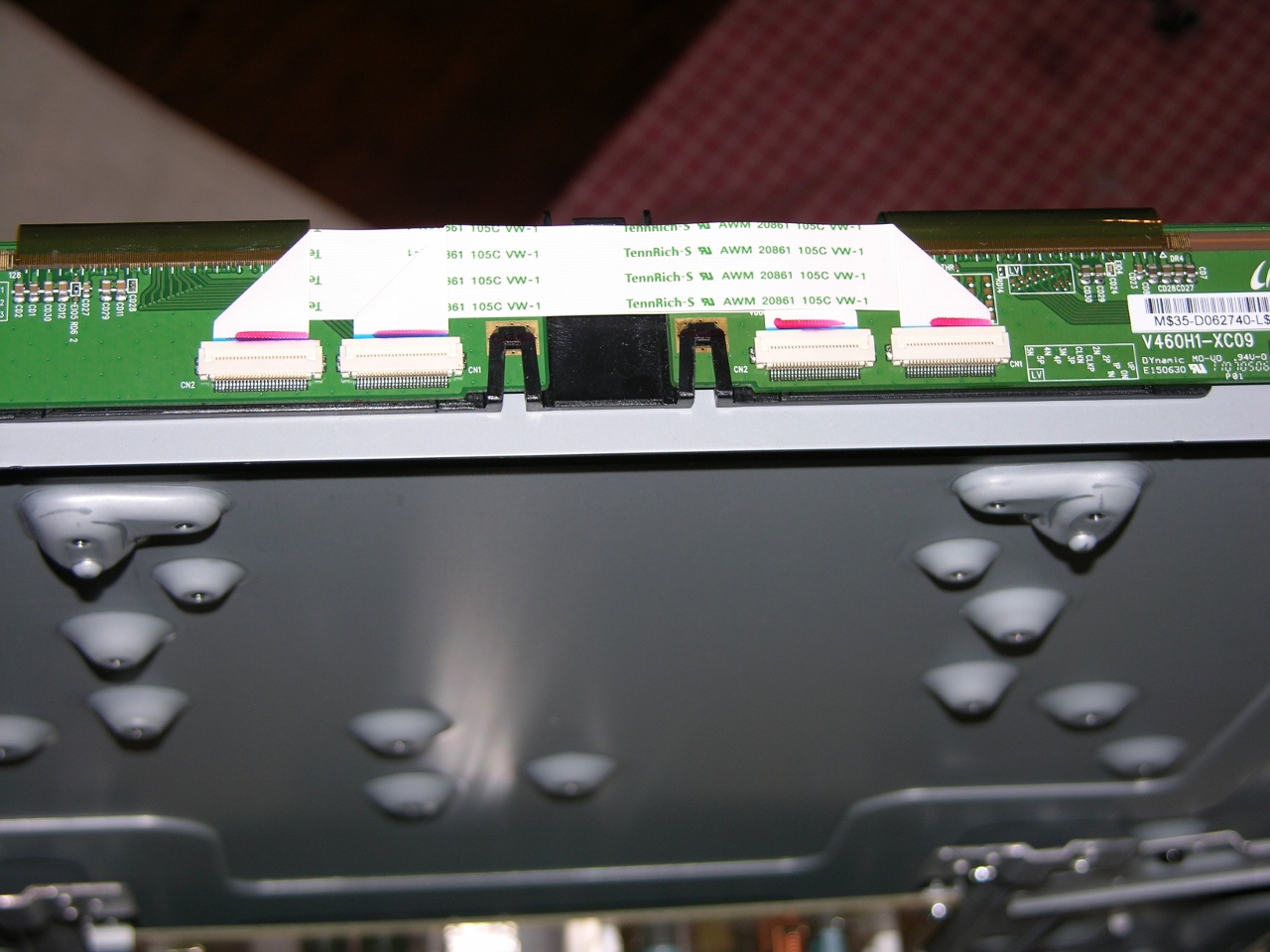

The video board is connected to the main T-Con via a cable of about 30 or so wires. Then there are two small ribbon cables that connect one T-con to the 2nd T-Con. (I have re-seated these with no improvement) I am assuming each T-Con is responsible for half the screen - so I am assuming the T-Con responsible for the right screen has failed, hence my problem.
Not sure how the signals are processed and was wondering if maybe I have a bad cap or to on the video board.
