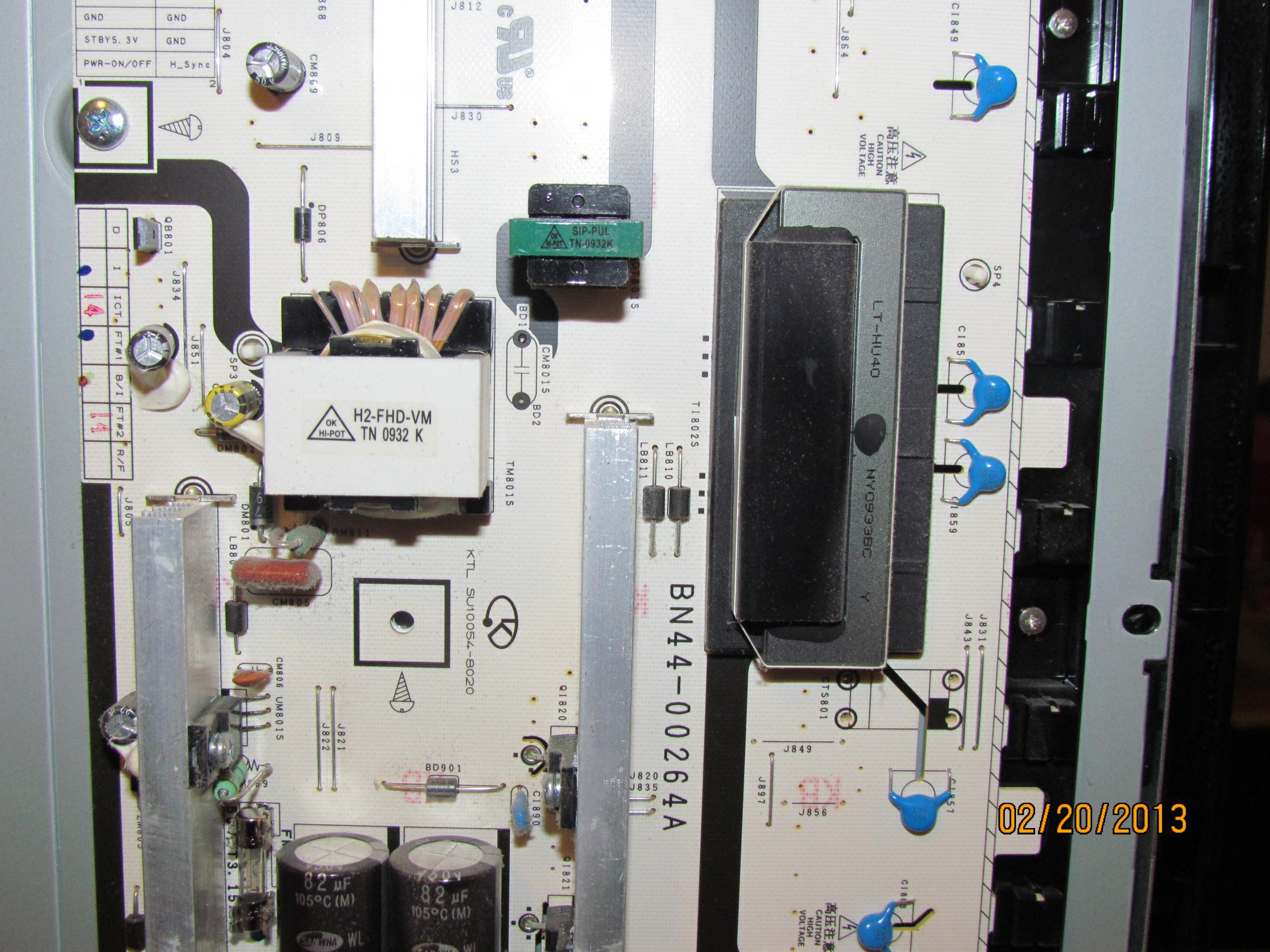

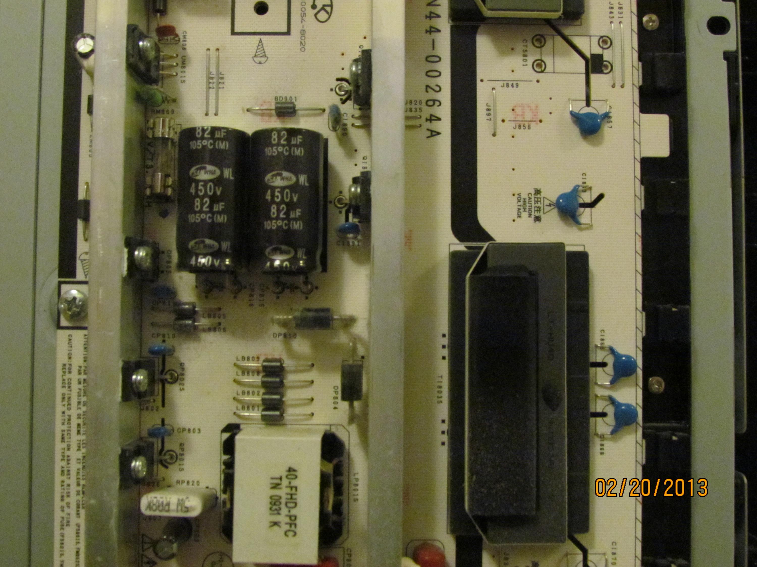

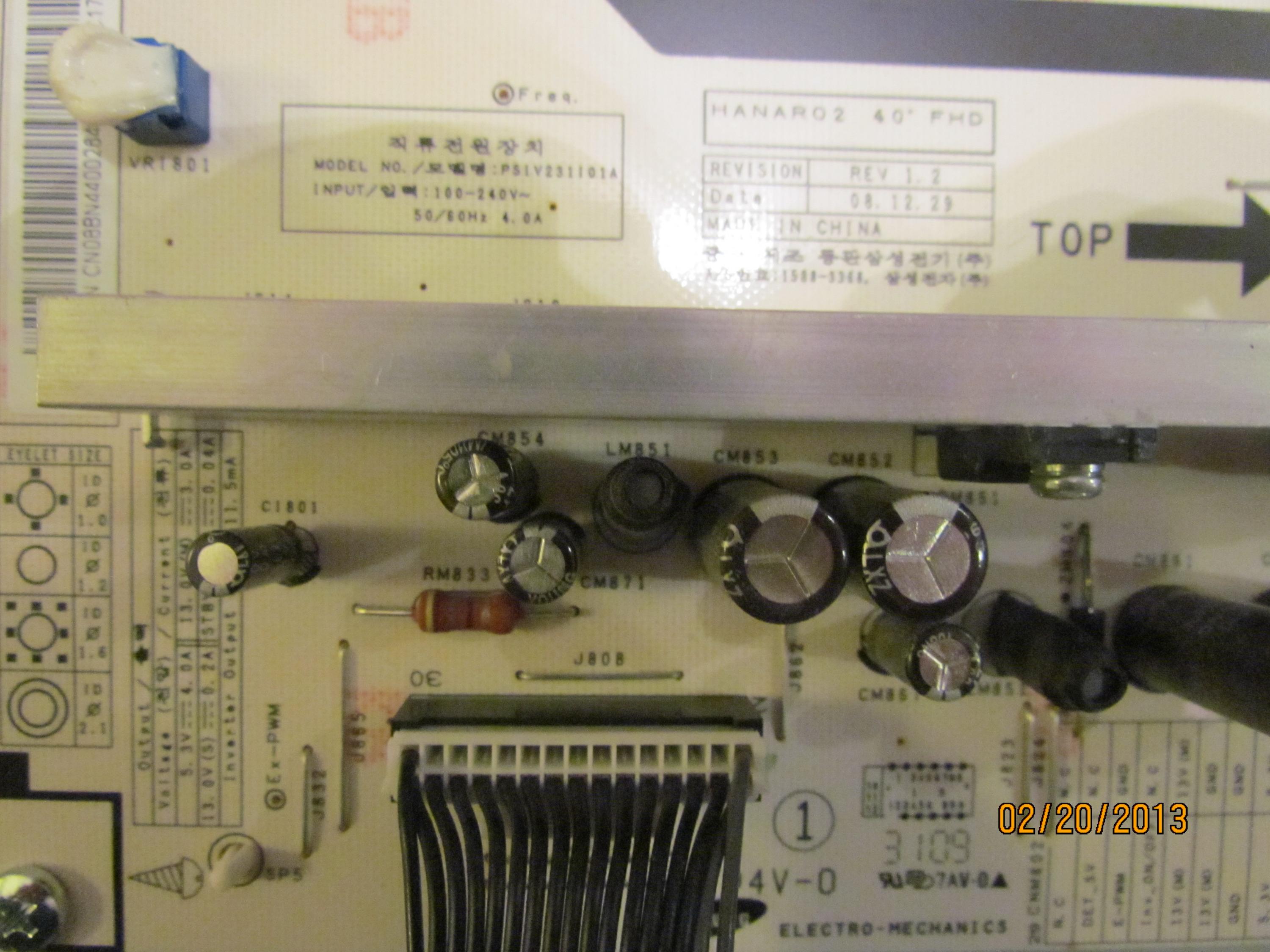

    my samsung 40" lcd tv will not turn on, i found that a small fuse (3.15a 240v) was blown, i tried to replace it with a new one and as soon as i plugged the tv in it blew, i was told to check the capacitors and all of them seemed to look good can anyone give me any clues as to what is causing the fuse to blow or what i should be checking for? I appreciate any suggestions, thank you
    Re: Samsung LN40B500P3F power on issue

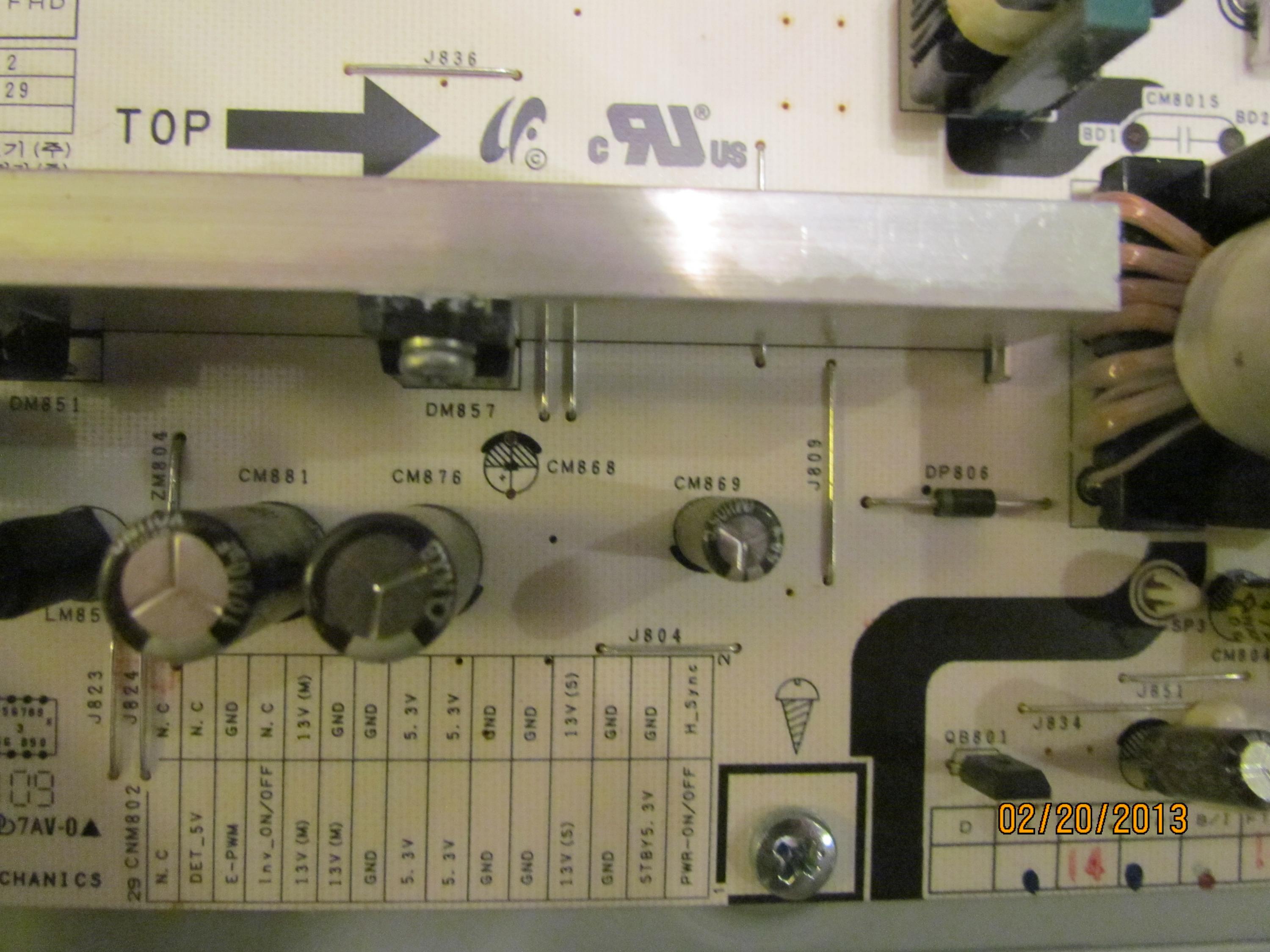

    Please post good clear pictures of all the board, at this point you either have shorted bridge rectifier, or shorted out MOSFET.
    Also, what is the P/N as printed on the power supply board, BNXX-XXXXXX?
    Make sure to use file attachment function in the GO ADVANCED to up load the pictures, do not post pictures in line.

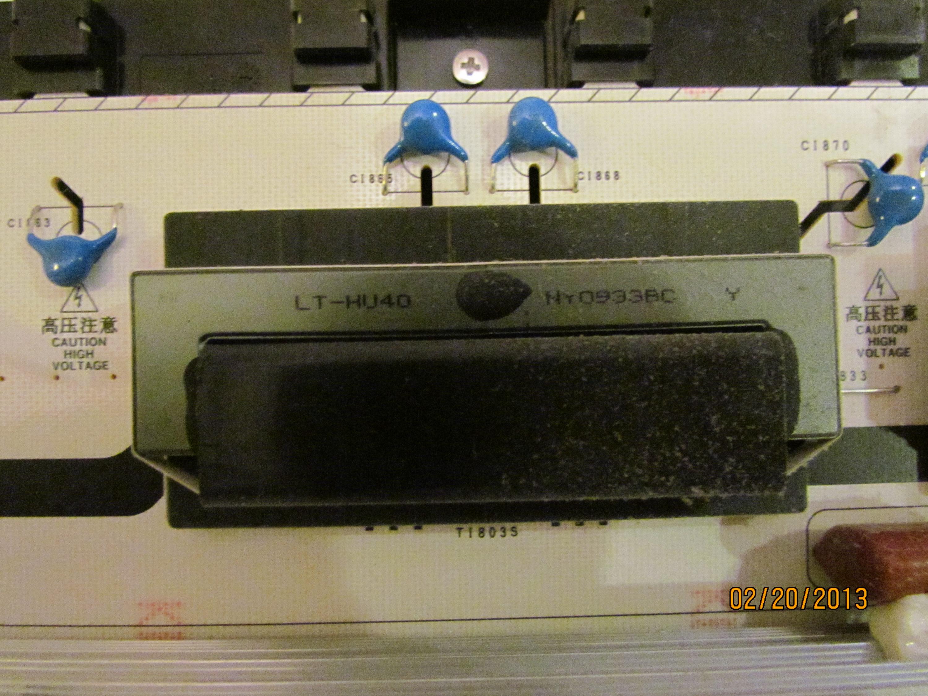

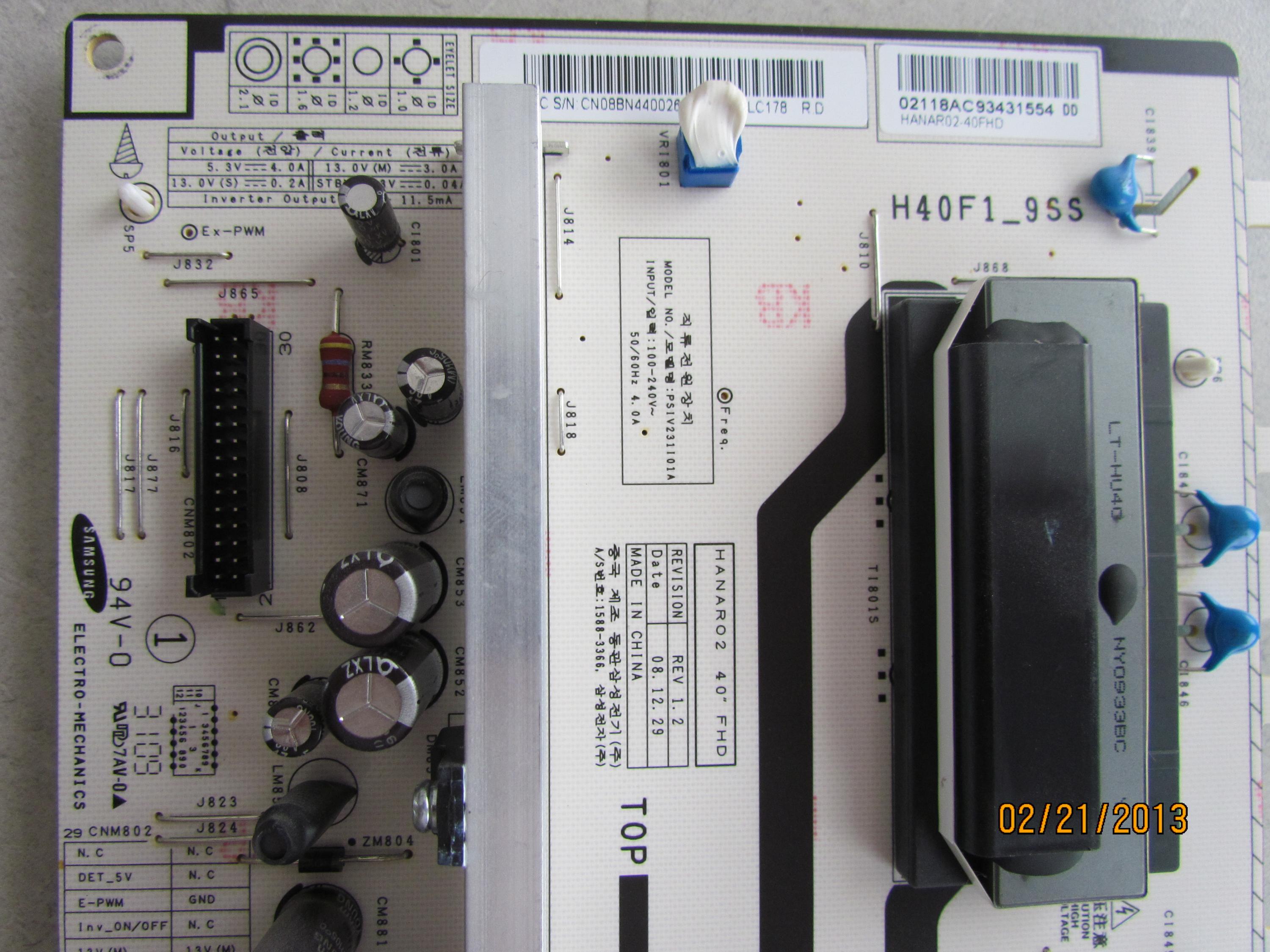

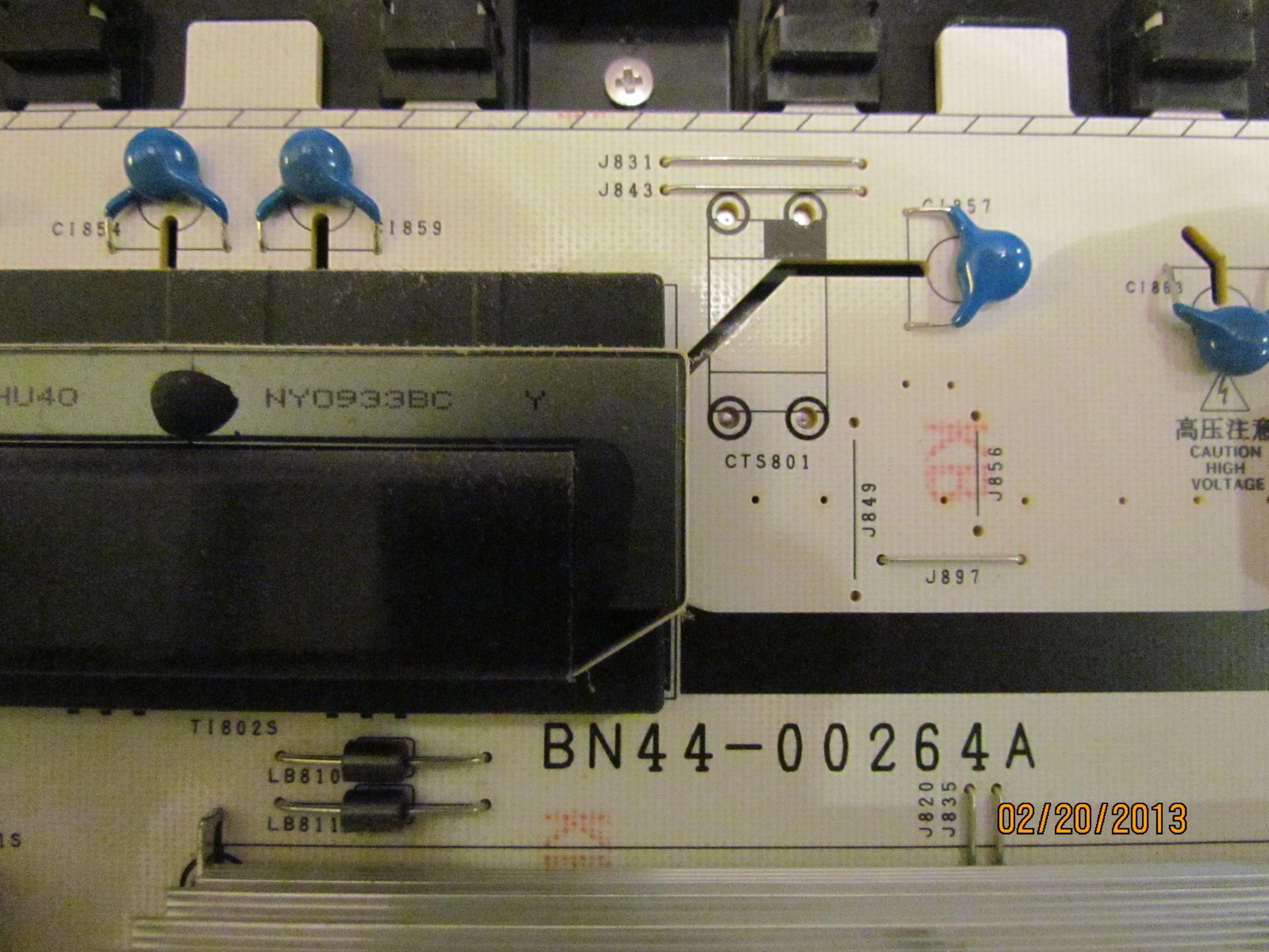

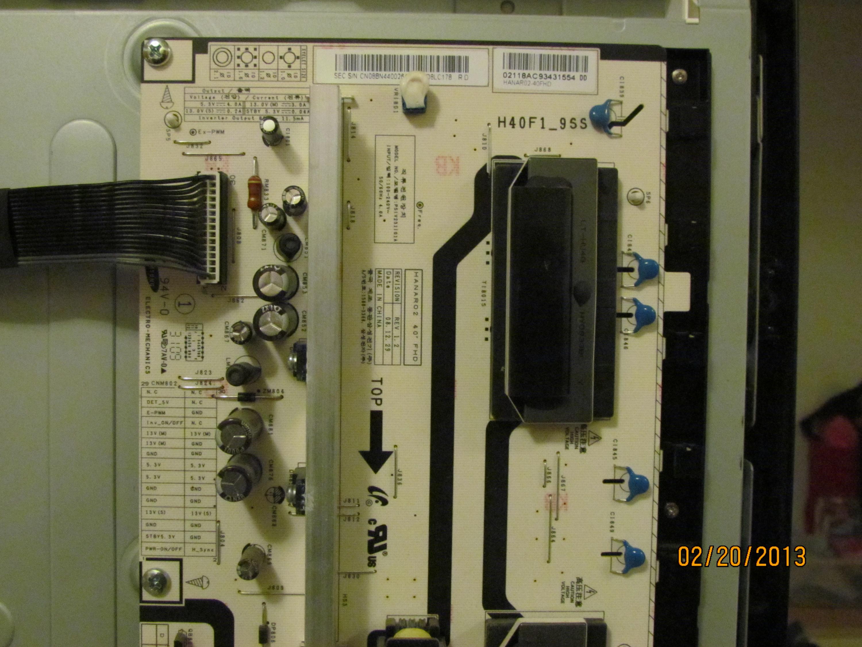

        these are the pictures i took, hope they work, let me know if you need more or better ones, closer etc. thanks

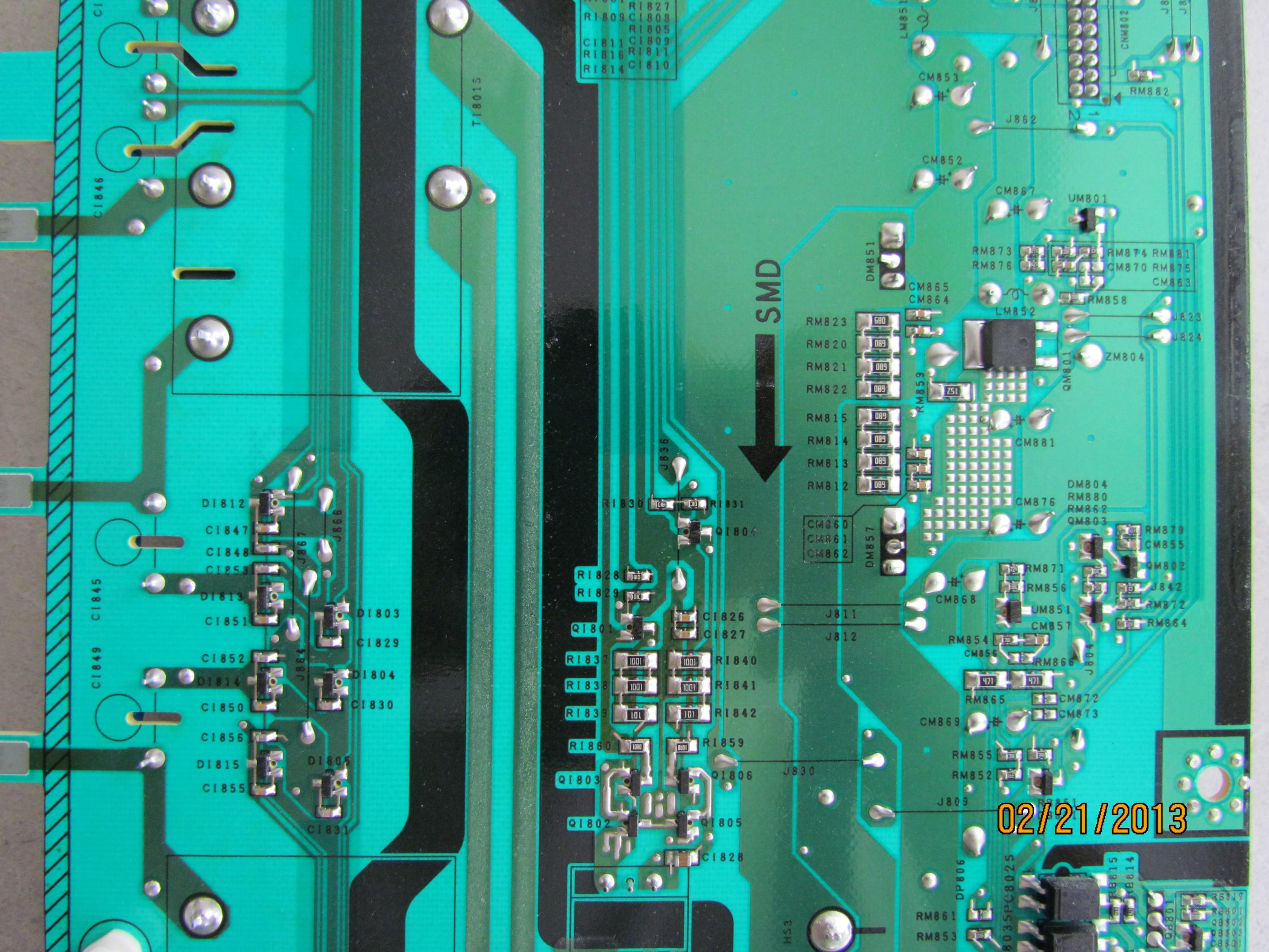

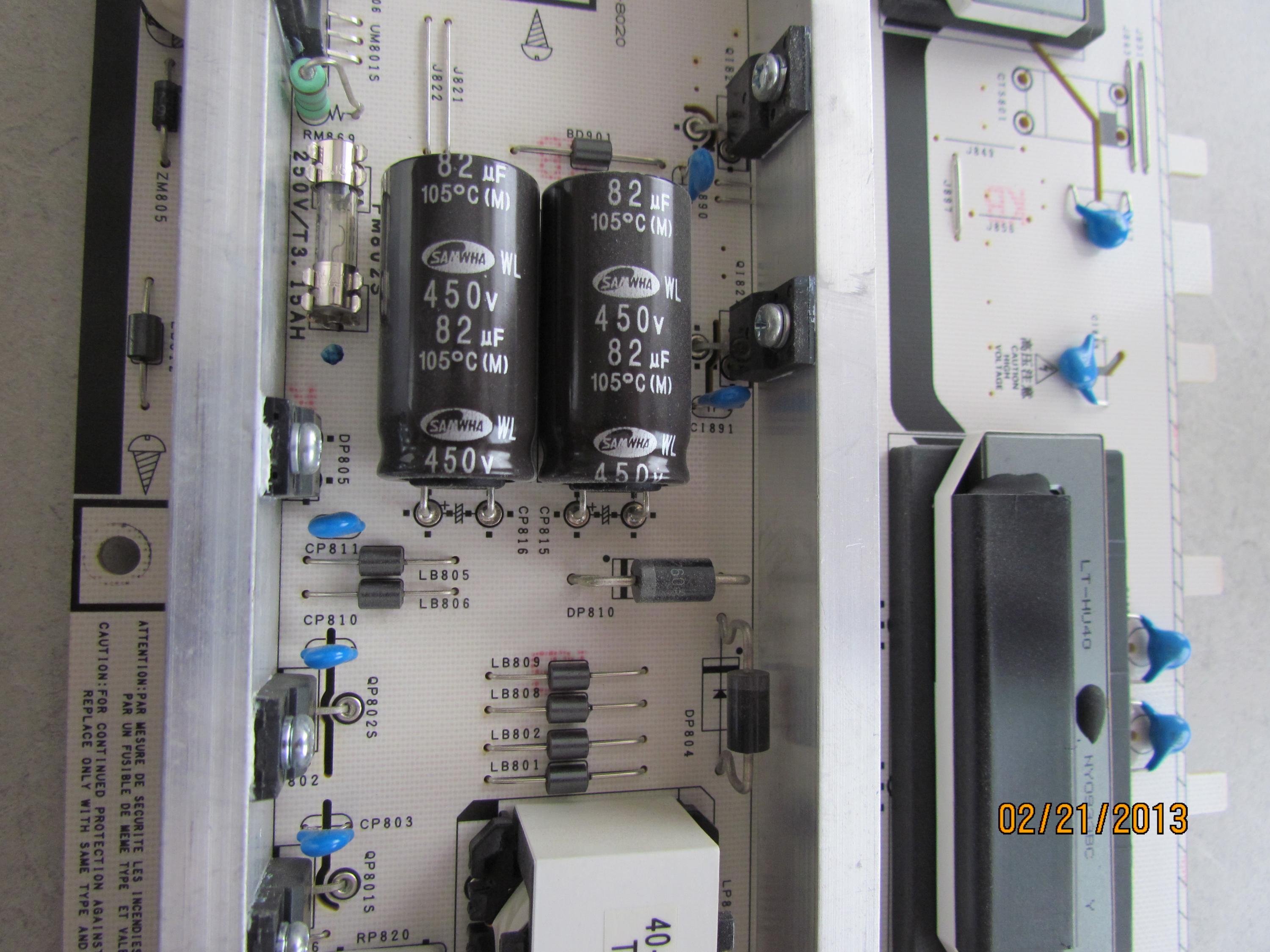

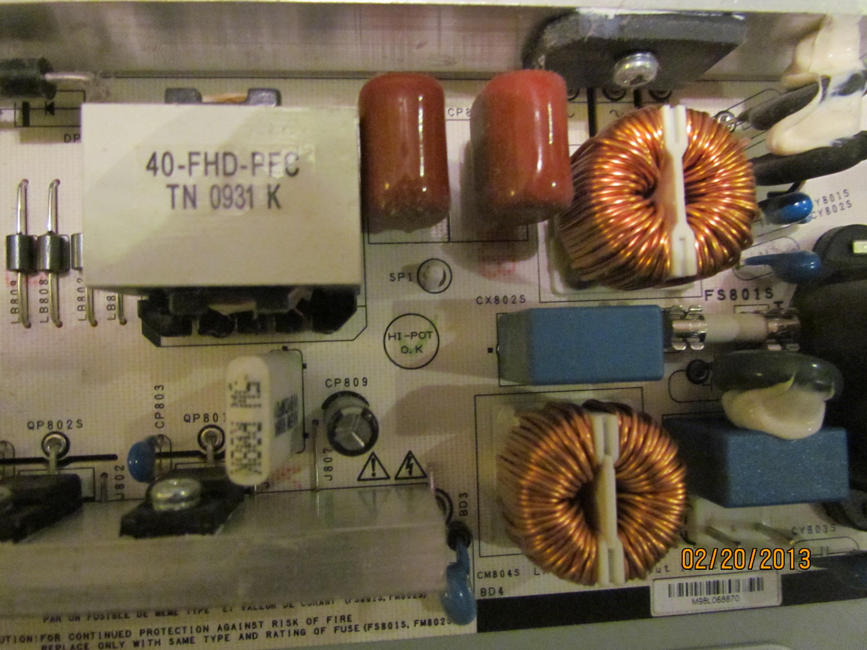

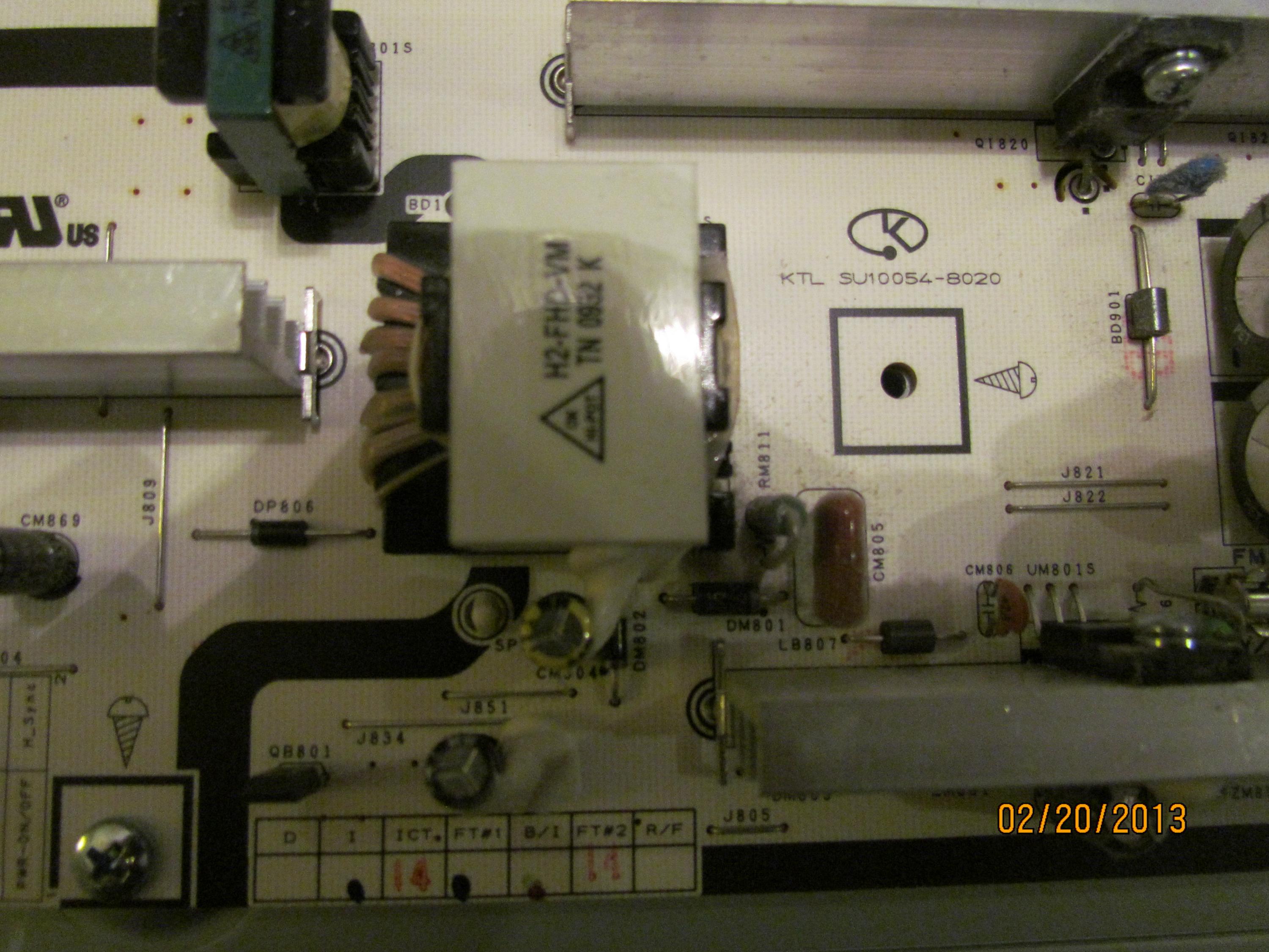

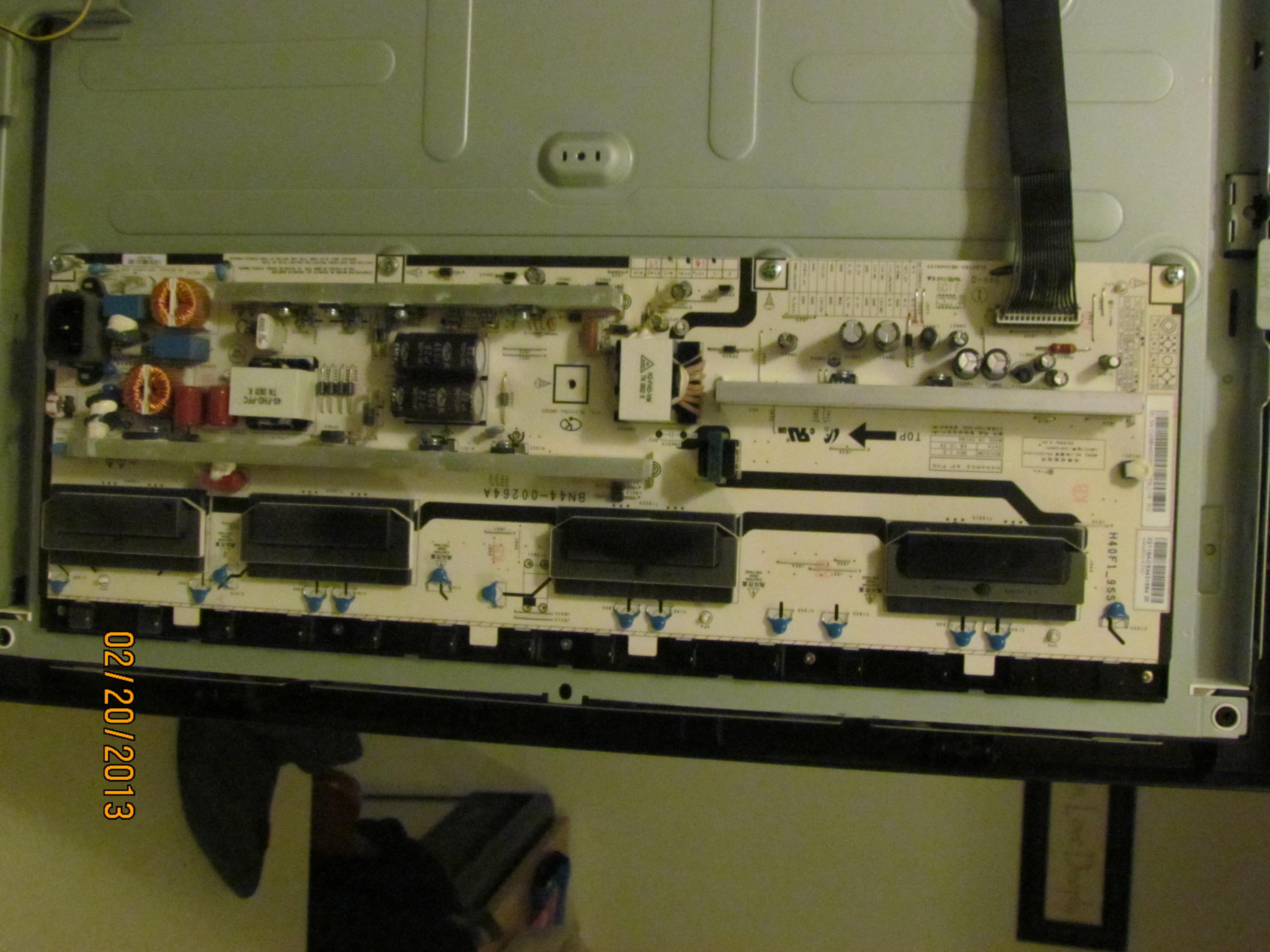

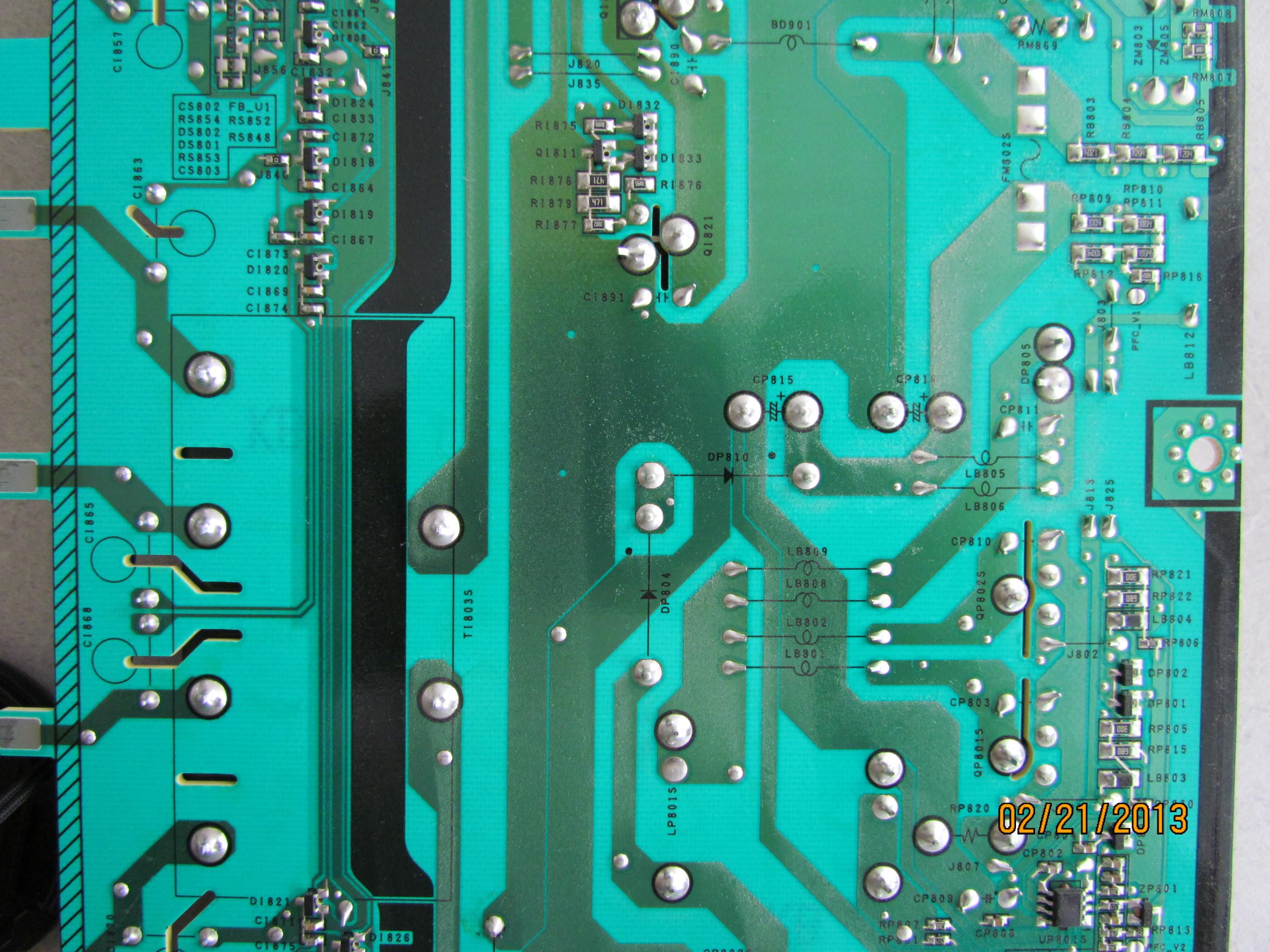

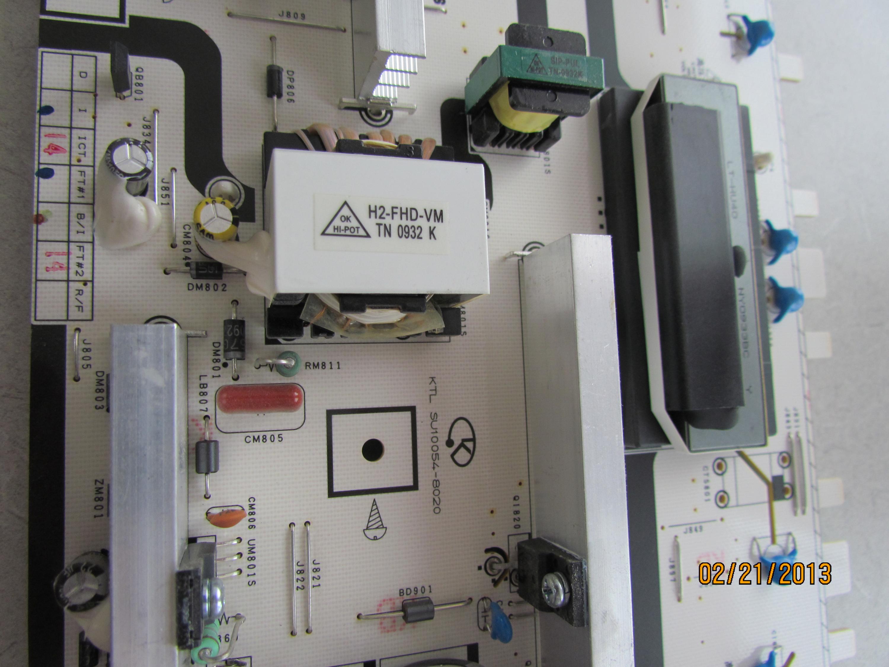

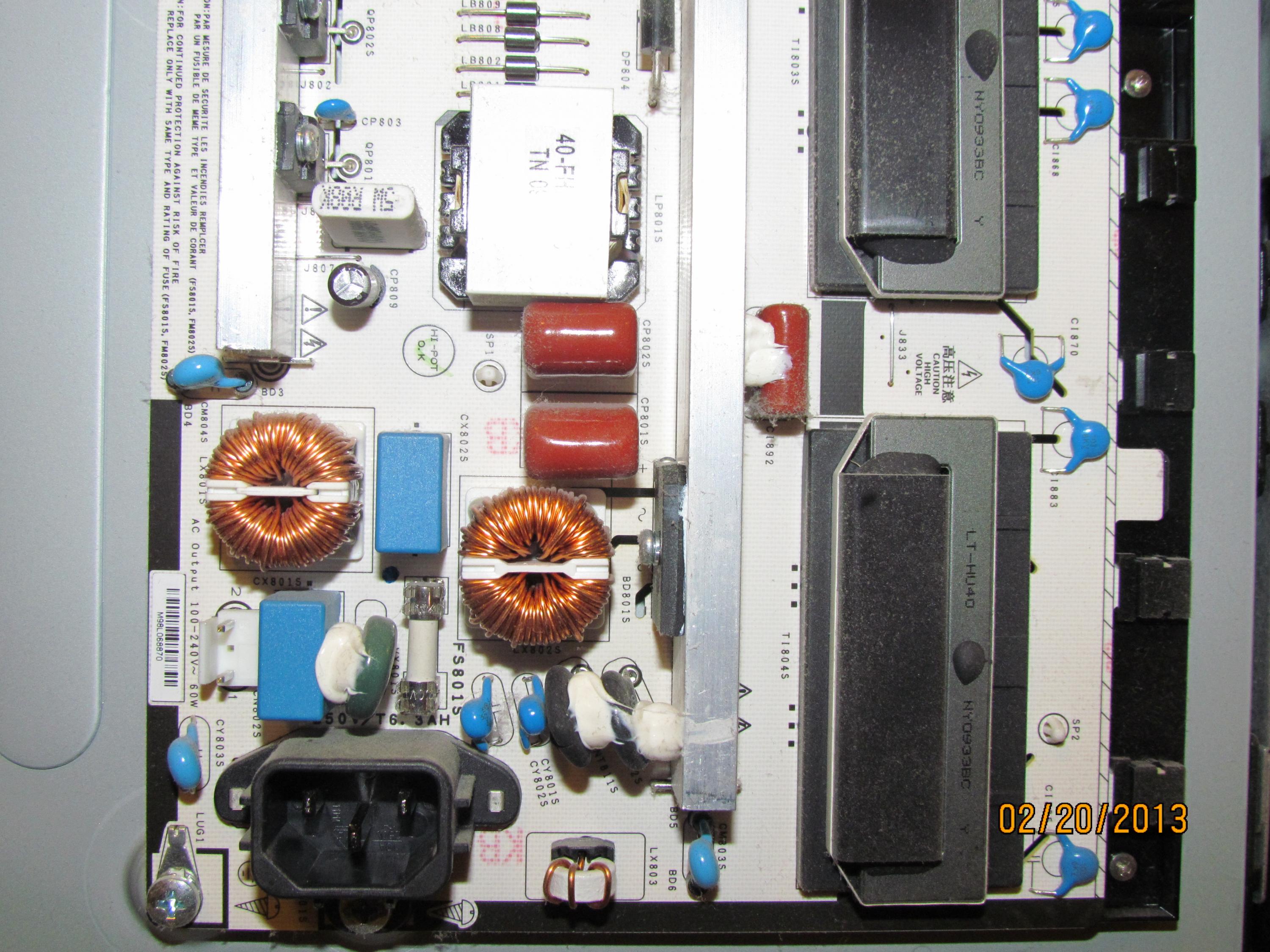

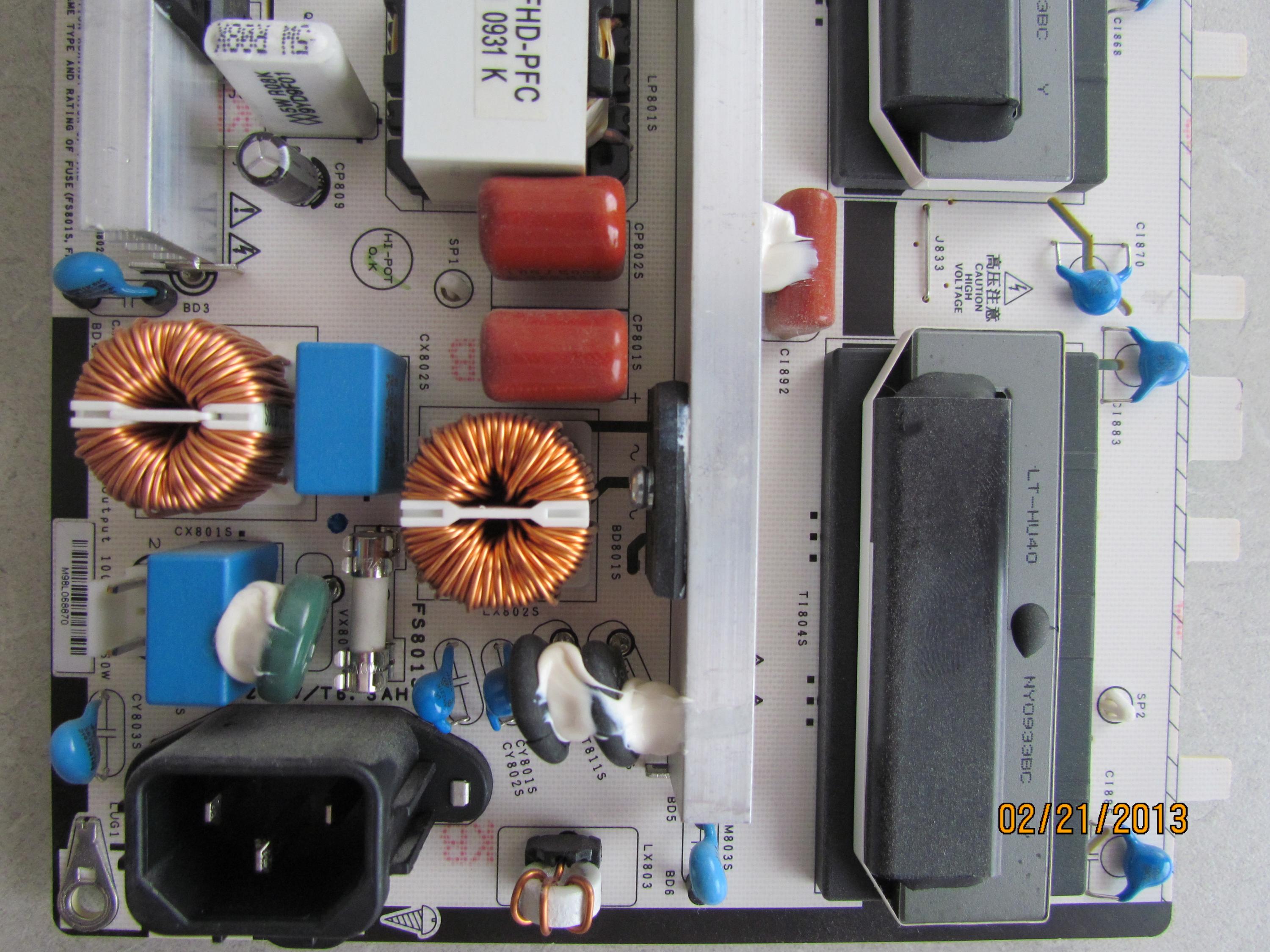

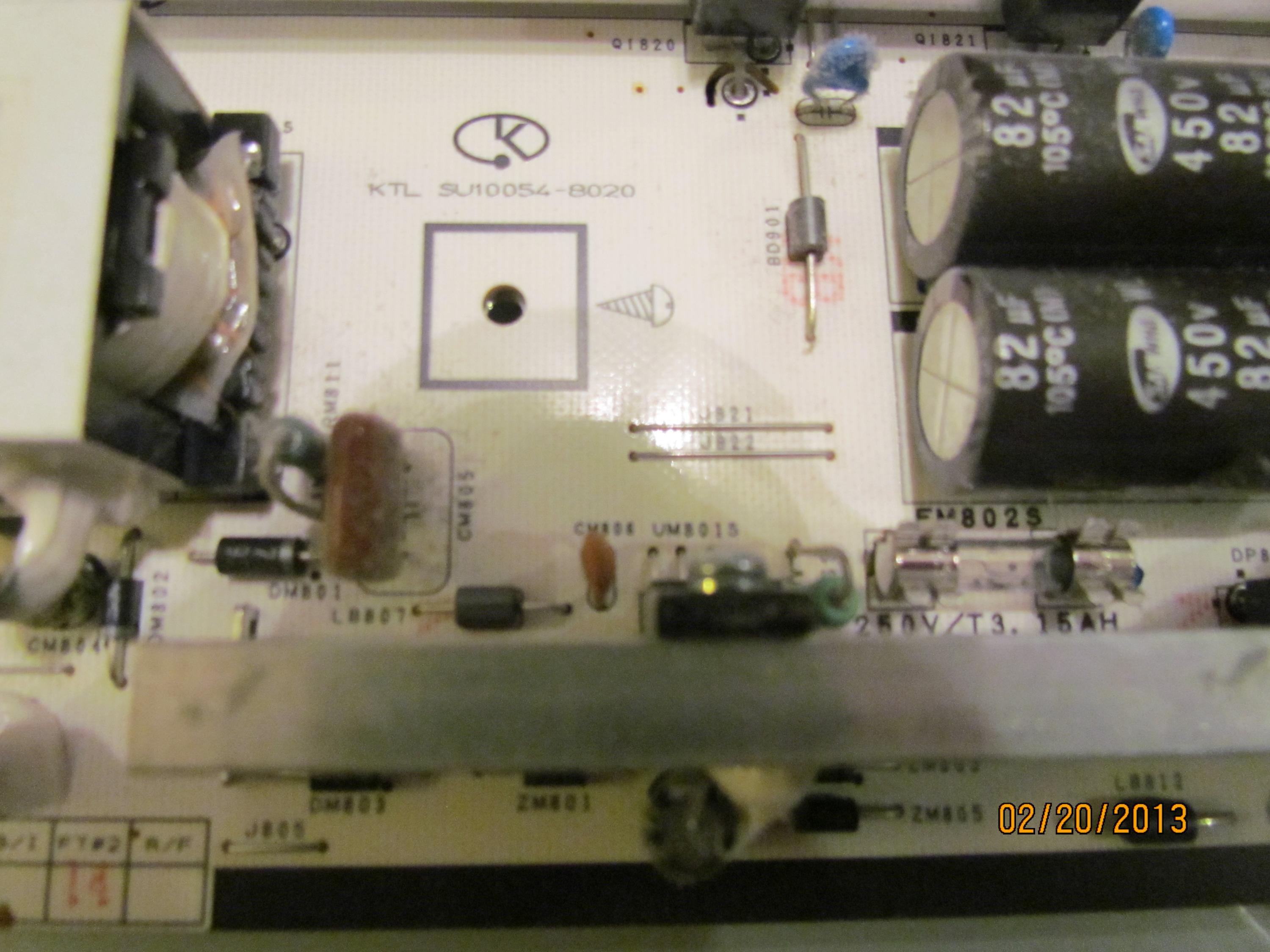

                        Next thing I need will be the pictures of the top side of the power supply board, take the pictures in 5 sections so I can easily read the part designator (for example: I want to be able to see Diode DP801, ETC.). Do the same for the bottom side of the board, this will allow me to see the traces on the board so I can tell you the test points on the board. Just remember that I do not have the board in front of me to look at.
                          You will have to remove the board from the chassis, it will be tight fir due to lamp connection fingers on the board, you will have to slide the board away from the sockets so be careful not to break the fingers.

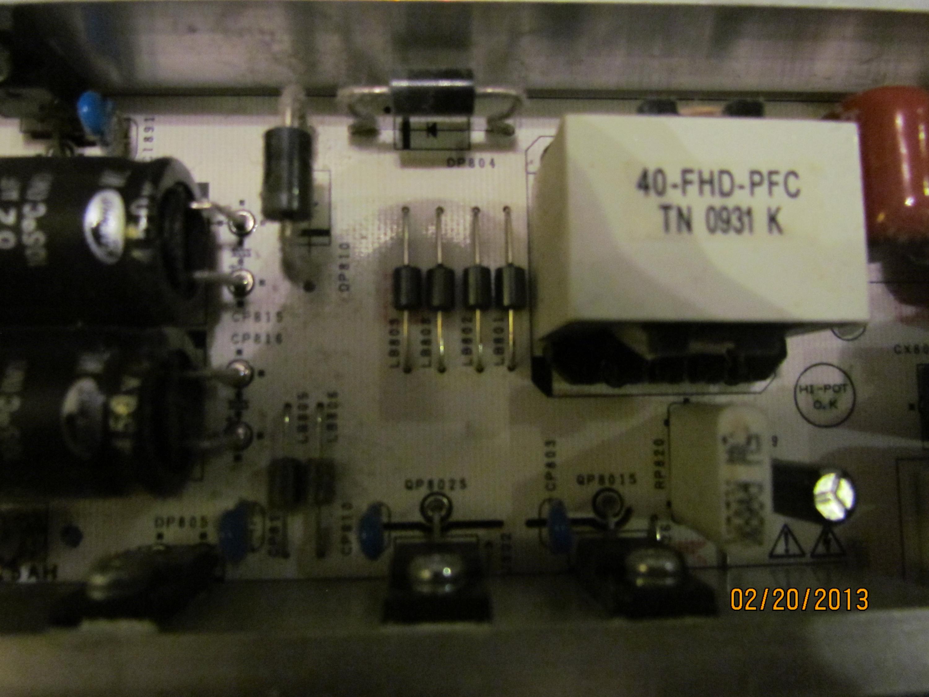

                            hopefully this works, its alot harder than i thought to take clear pictures of such small numbers, if these dont work let me know it might work better during the daytime with better lighting,

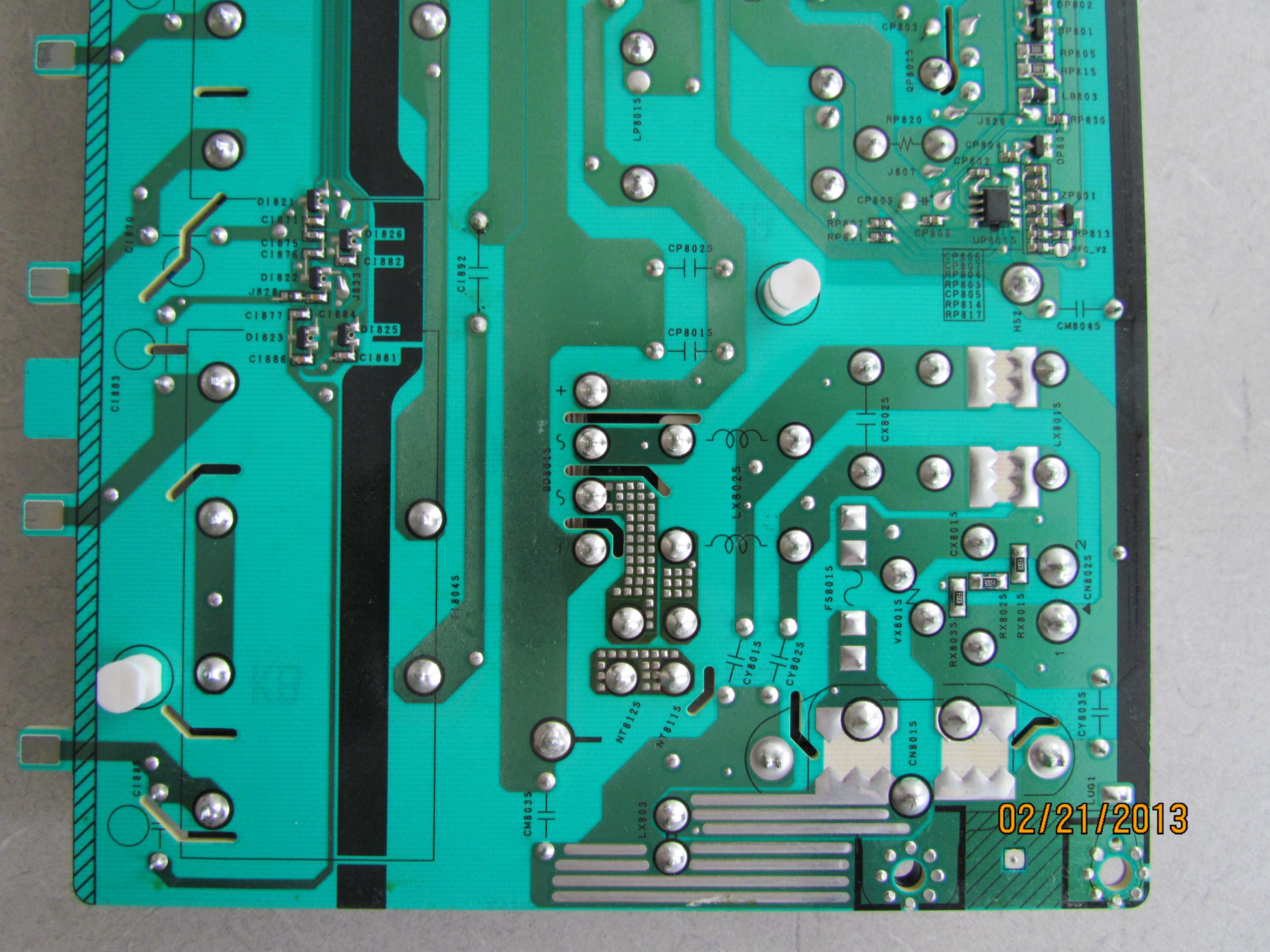

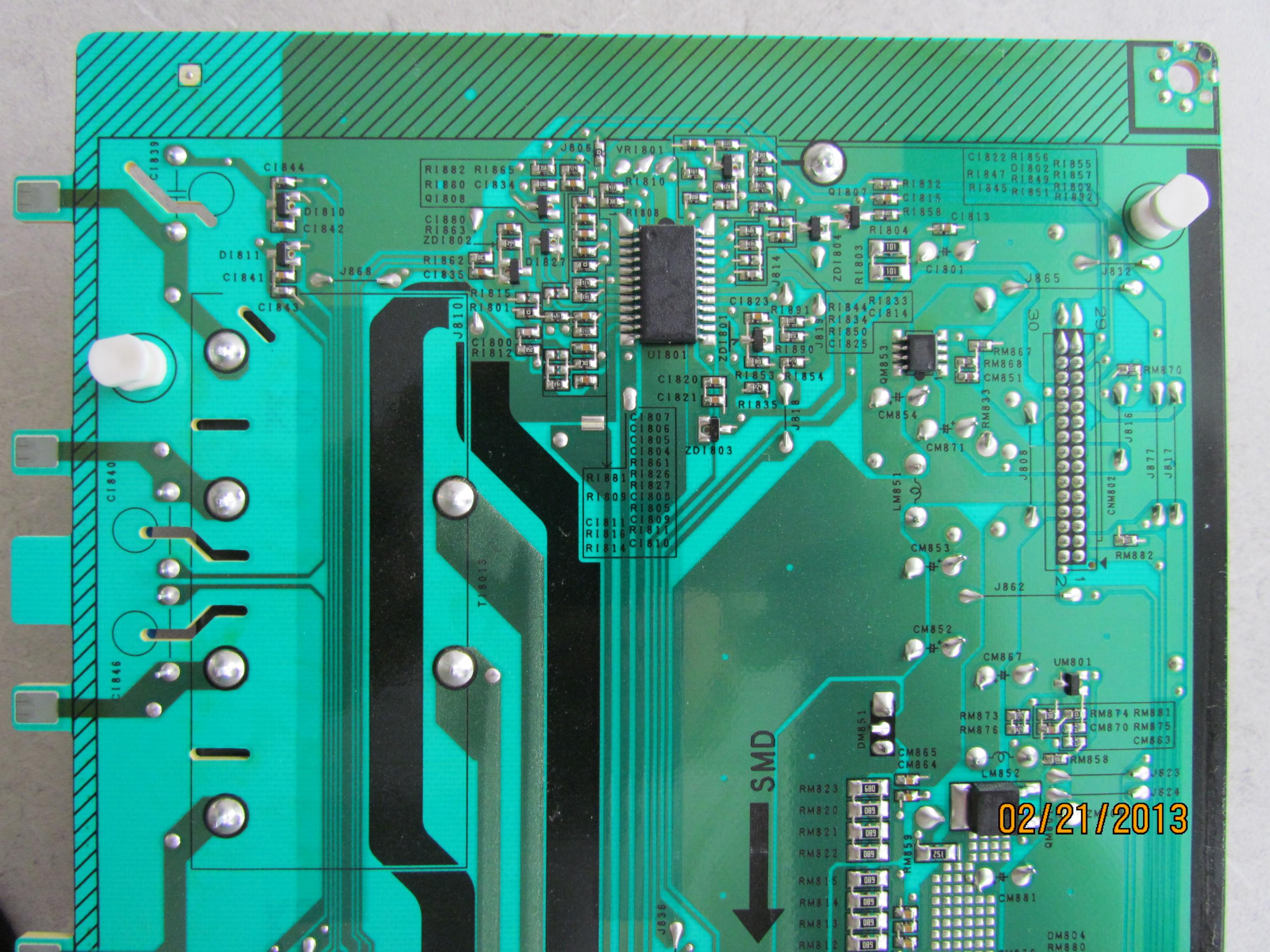

                              I need the same thing for bottom side also which where you will be probing.
                                    here is the pictures you requested, thanks again for your patience
