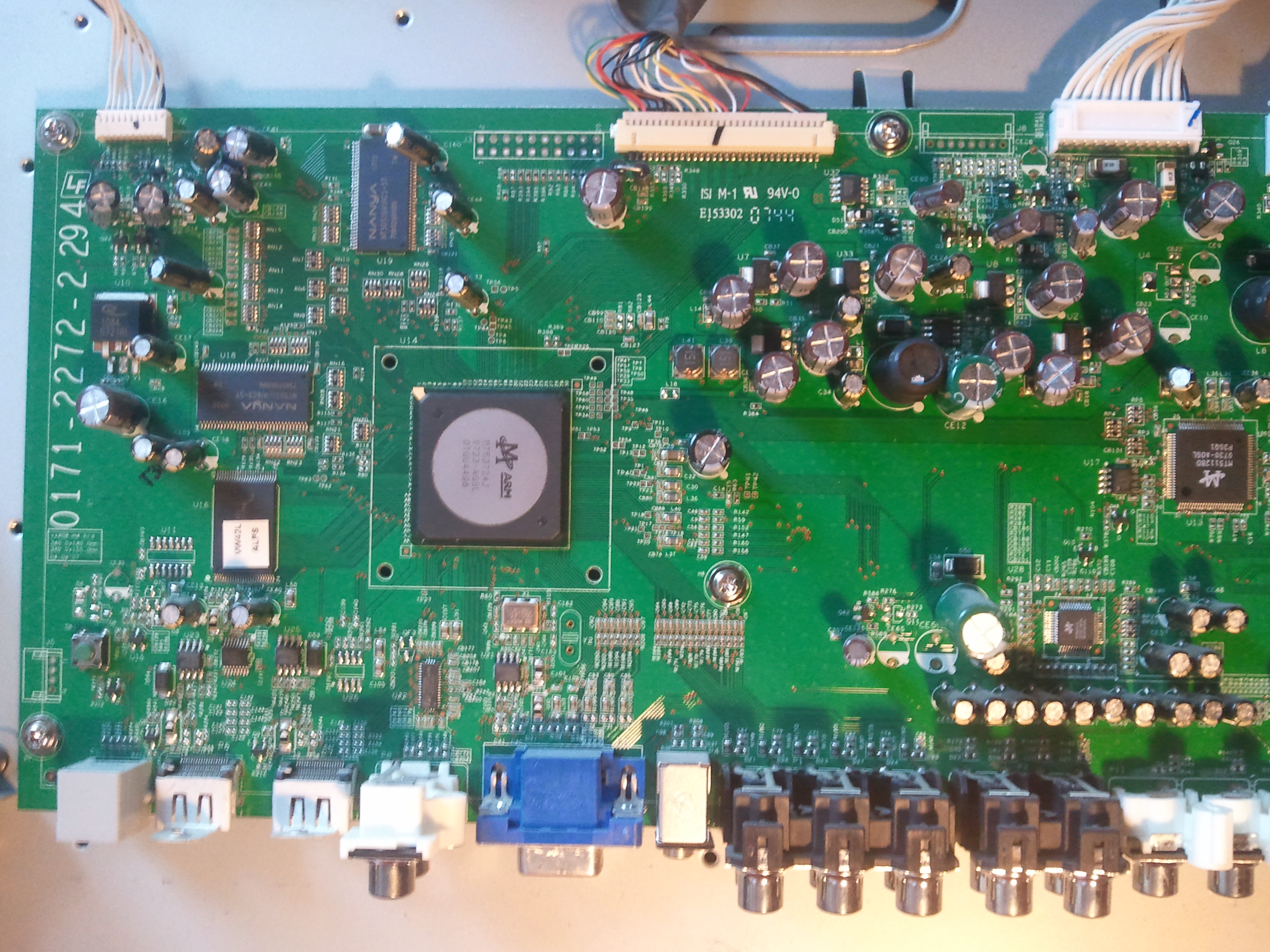

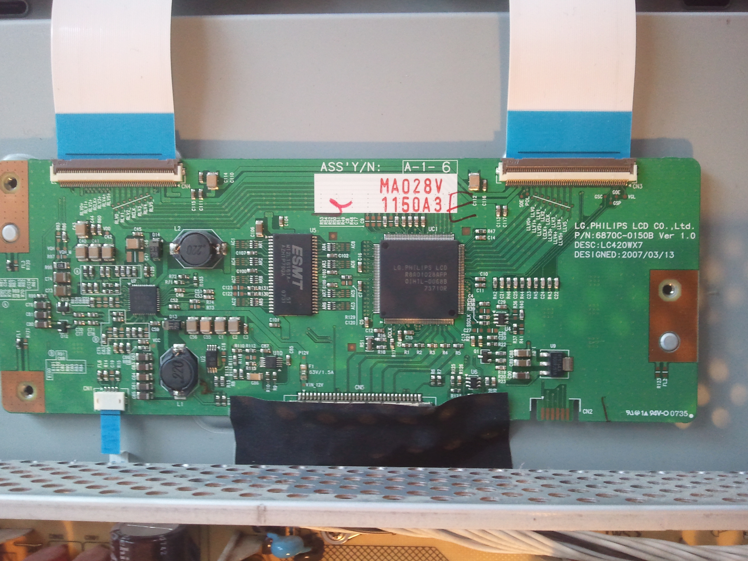

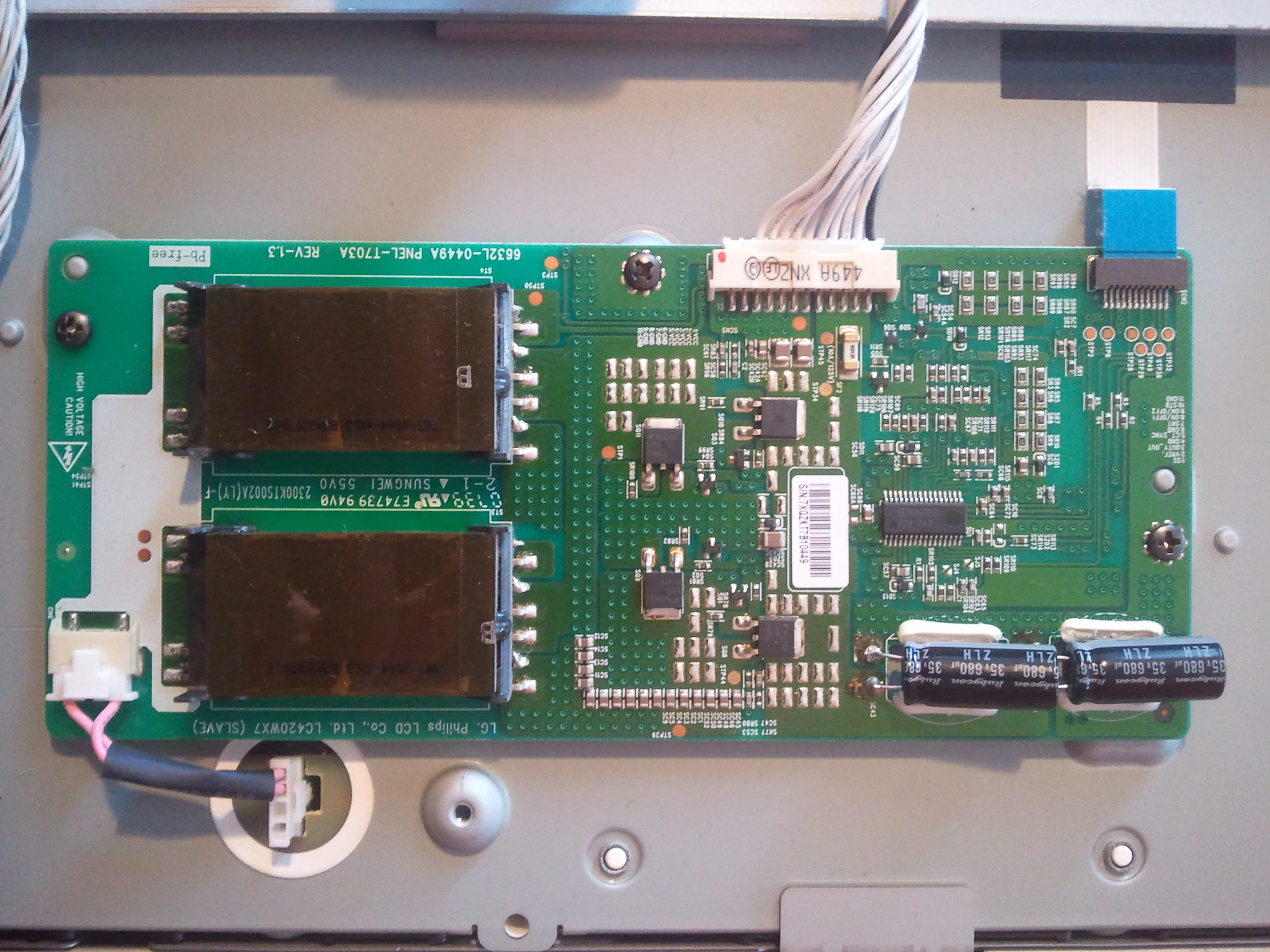

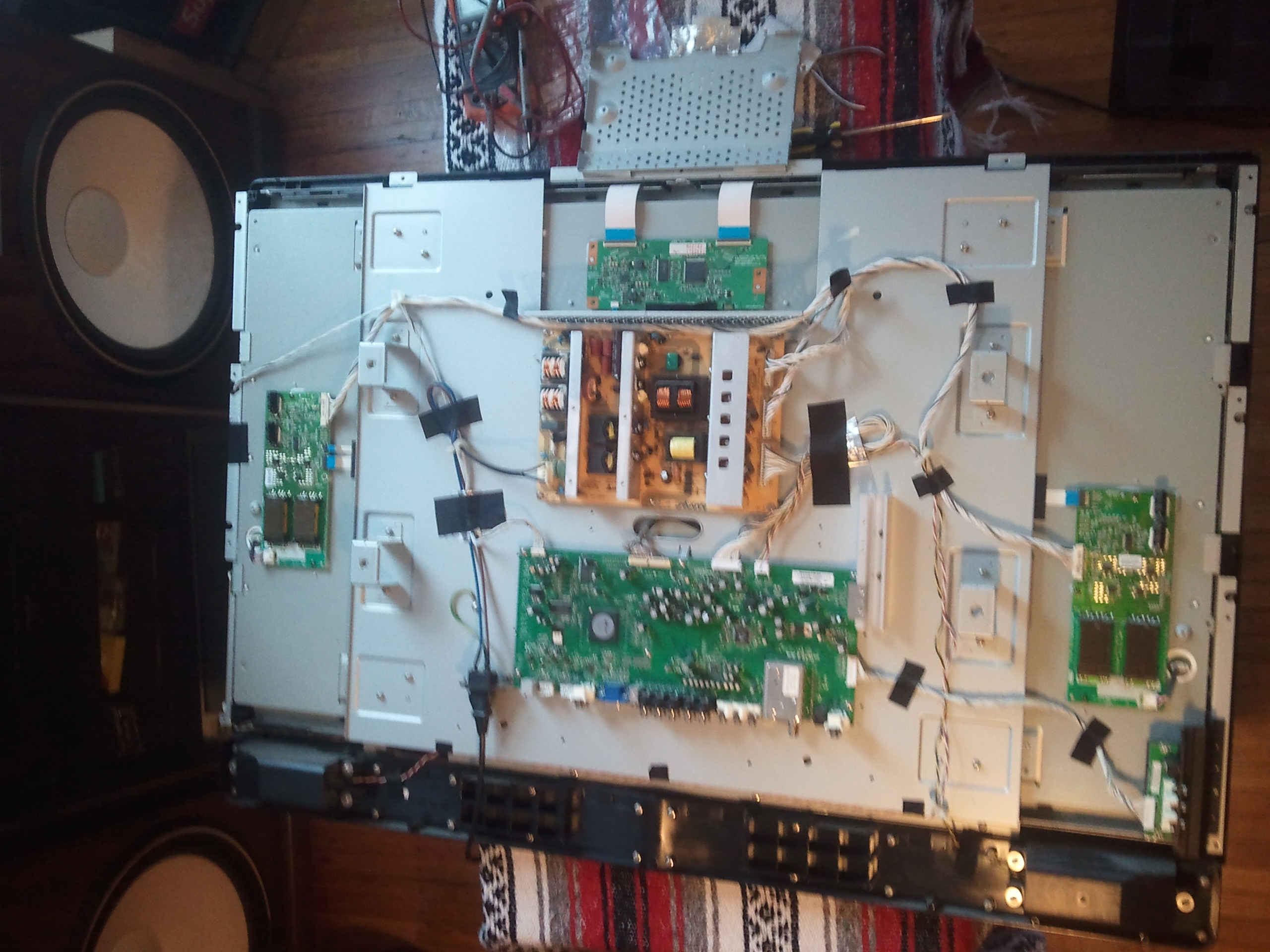

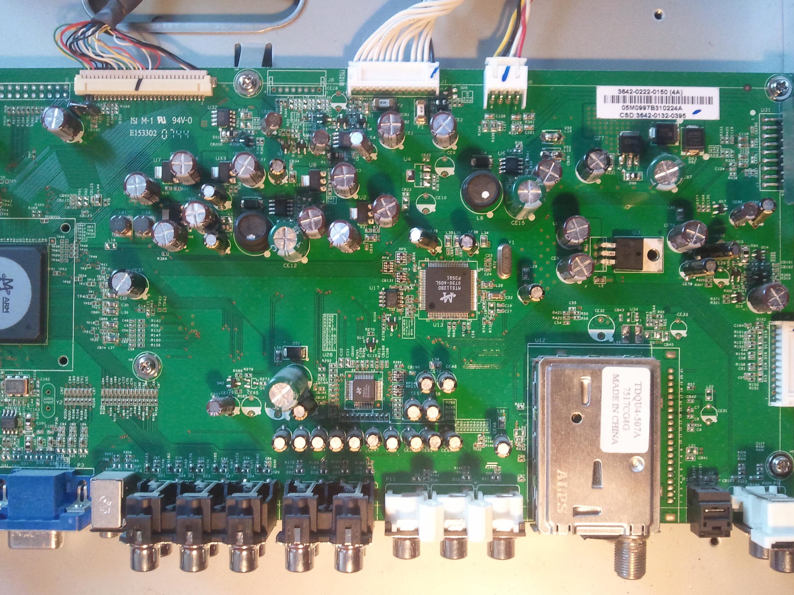

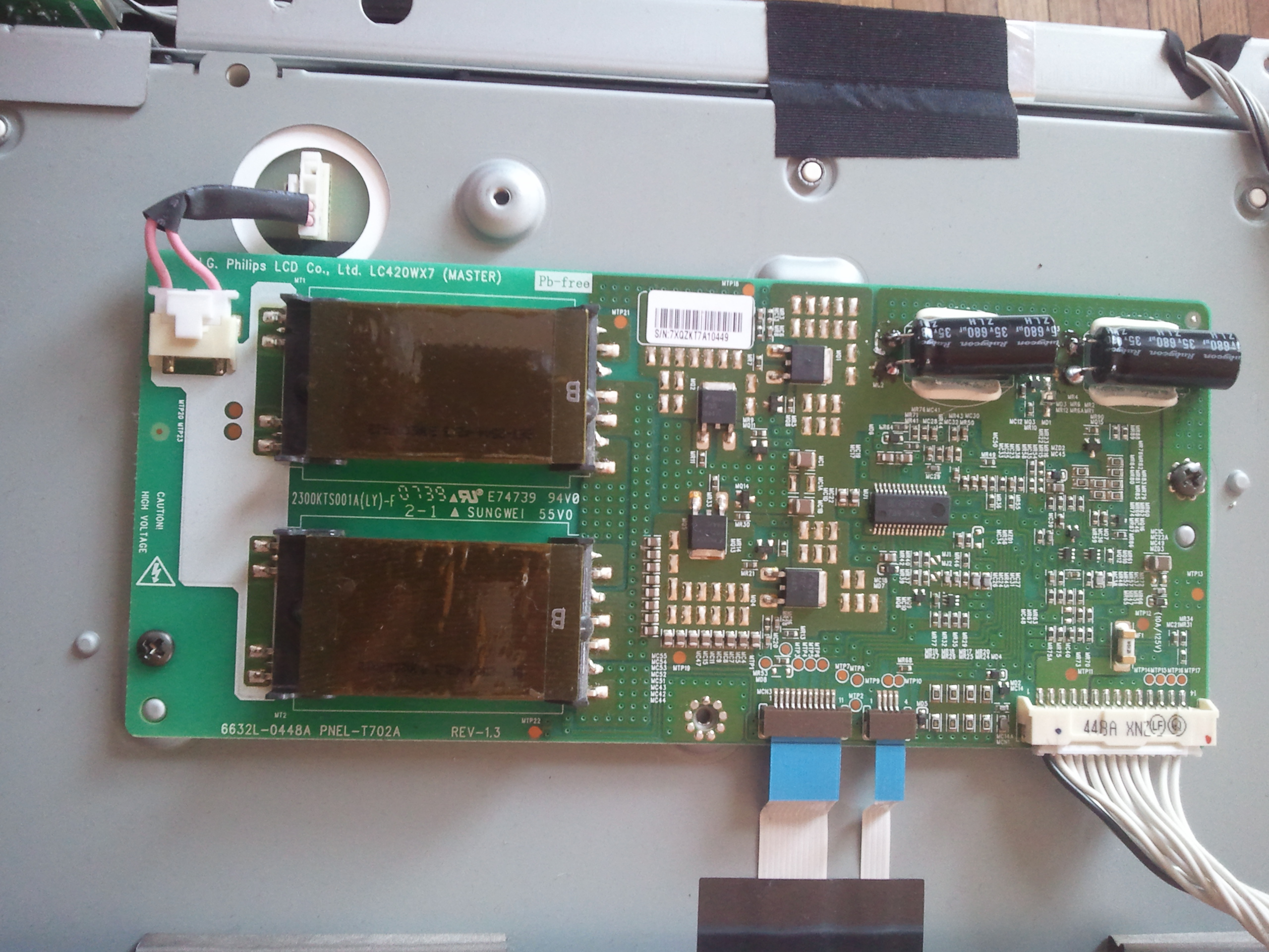

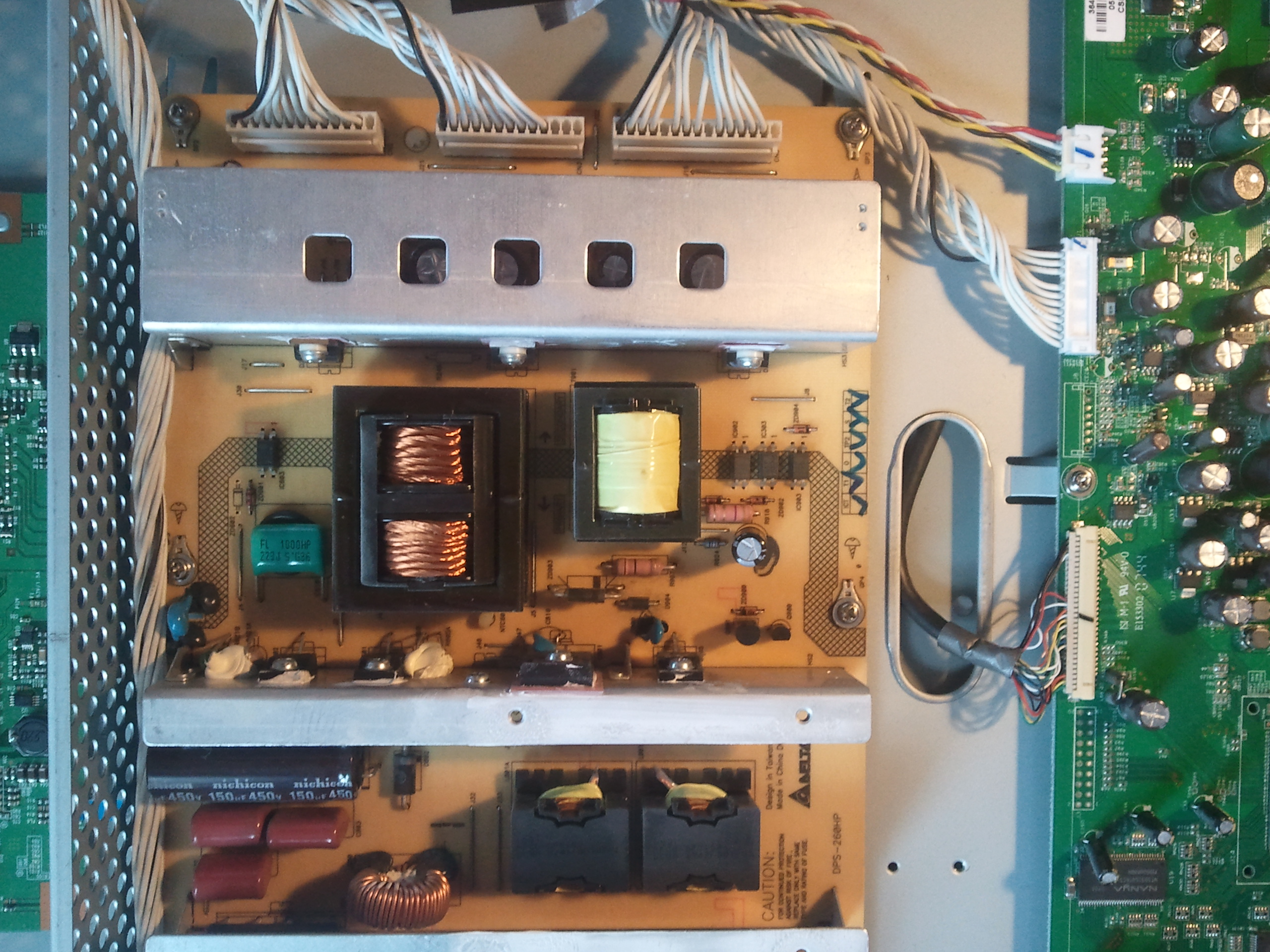

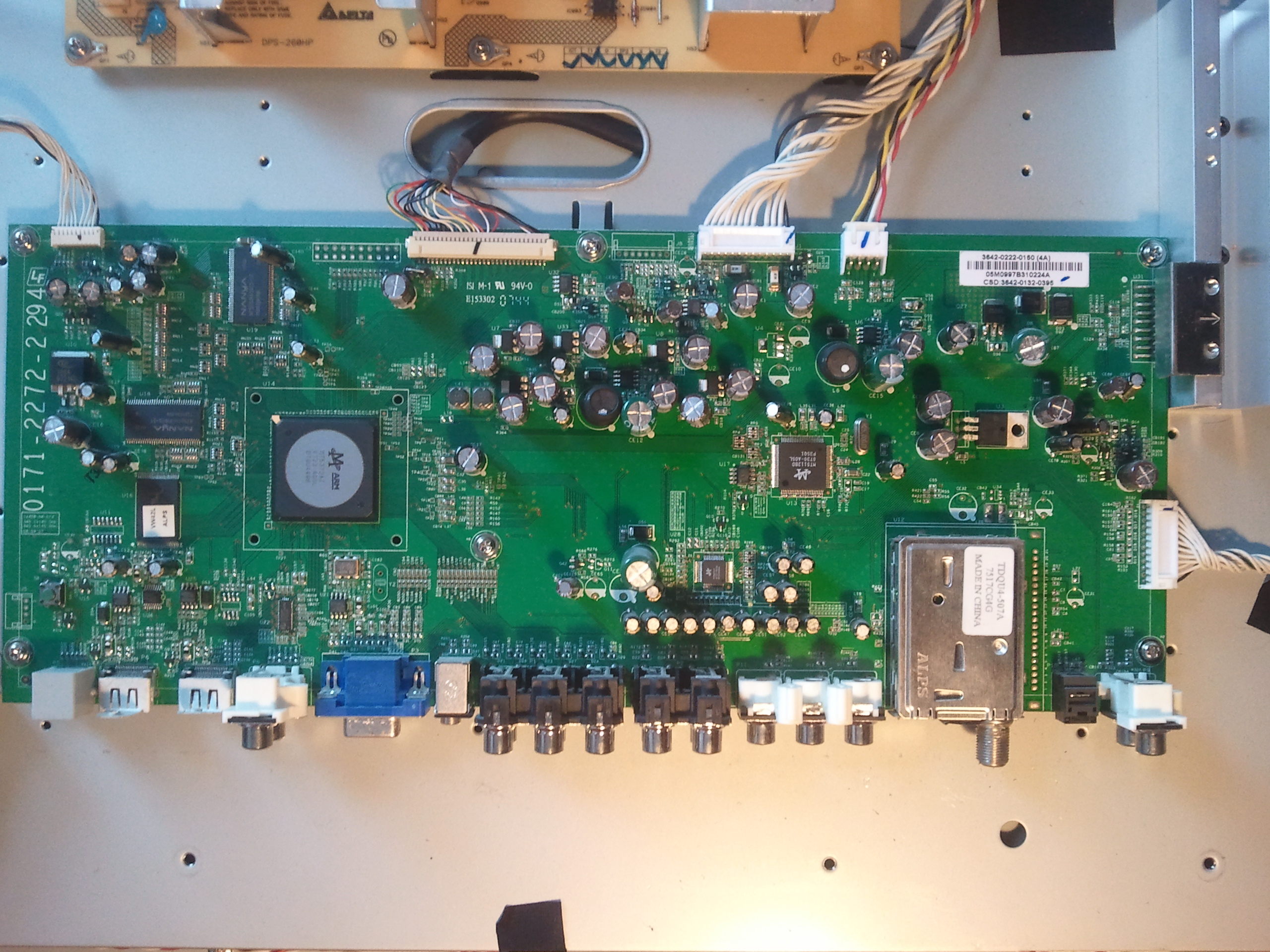

              so here are the best photos i could get, thanks for all the help.
              if i hold the power button in, it cycles from amber to white every 9 or so seconds. when the white comes on, its bright, and then slowly fades.
              • chopsawkev
                • Feb 2013
                • 24

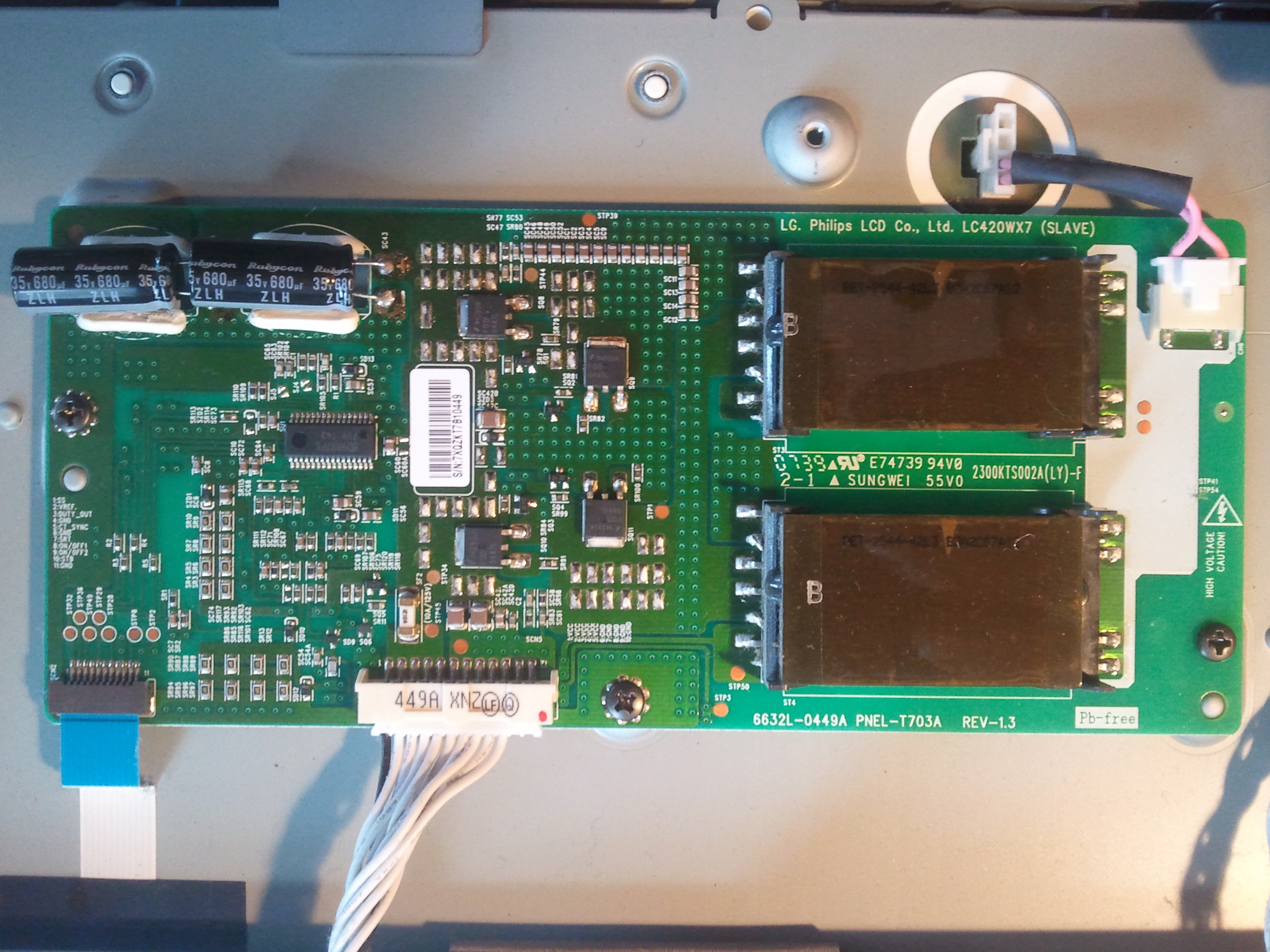

                Re: Vizio VW42L problems
                sorry i posted two pictures of the slave, here is the master.
                also you can see the caps that I replaced on the master and slave unit.

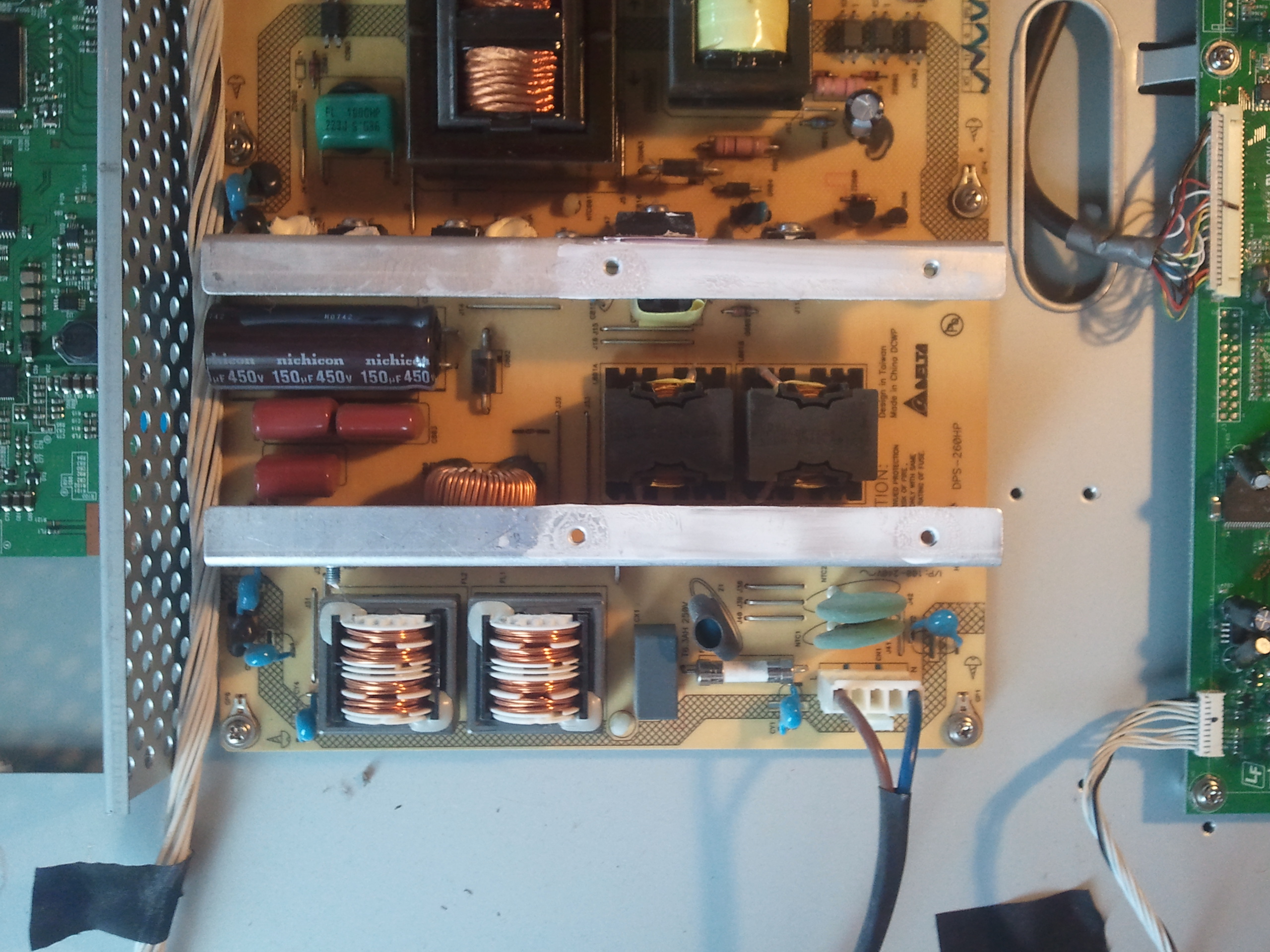

                • selldoor
                  Slow Learner
                  • Dec 2010
                  • 7870
                  POWER OFF
                  In Pic 8 under the middle top connector there are two white smd fuses - meter on ohms can you test them.
                  • chopsawkev
                    • Feb 2013
                    • 24
                    im getting 0 ohms on both. I get continuity between both ends of the fuse.
                    • chopsawkev
                      • Feb 2013
                      • 24
                      same goes for the barrel fuse (I think that's what it is) in pic 4 on the left.

                        I see SMD fuses on the inverters as well. You should check them.

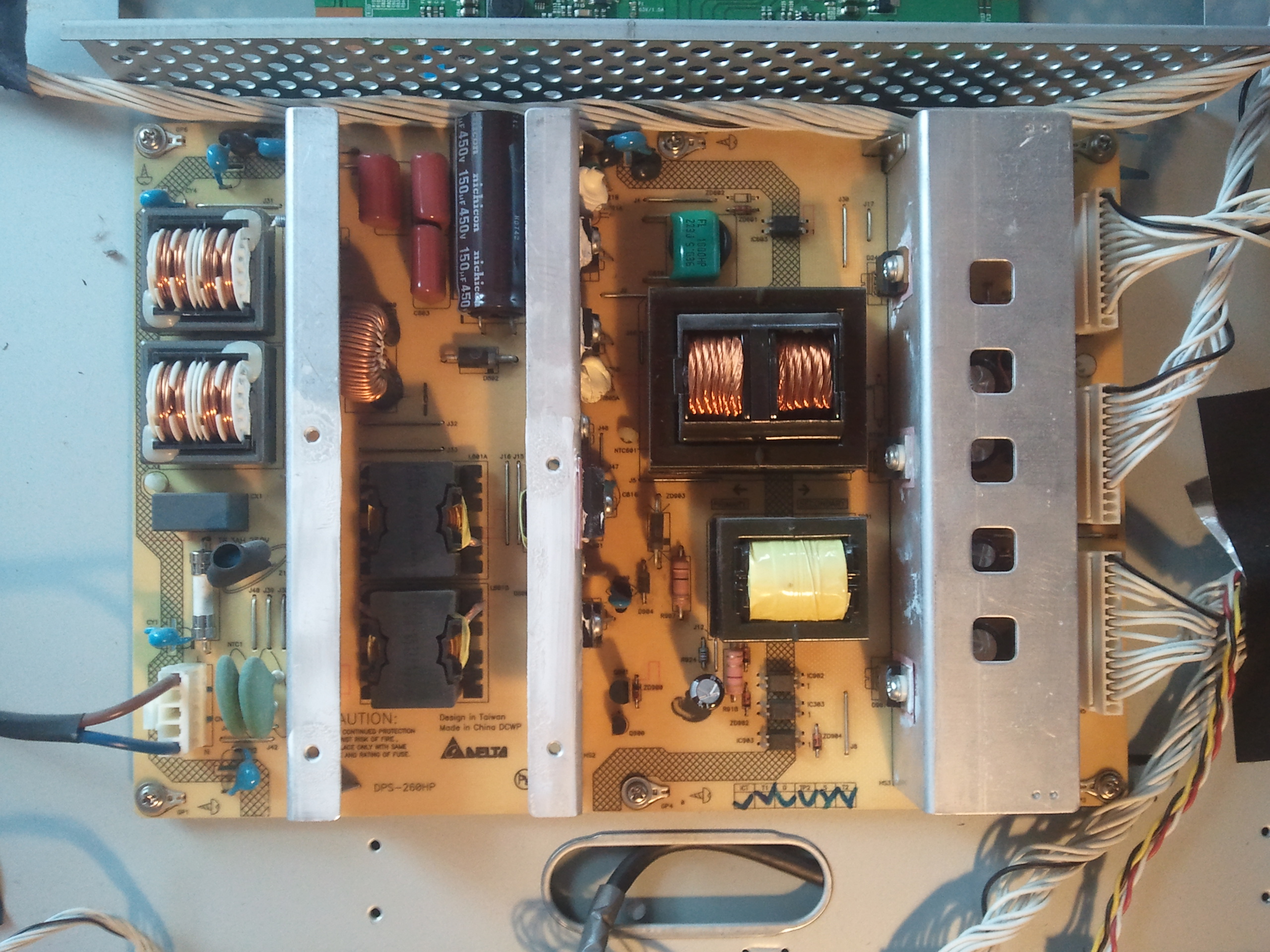

                        Also, may I suggest stepping back a minute to have a look at the PSU? Have you monitored the voltages on all pins of the connectors while you turn it on?
                        PSU sounds like a possibility here. When you say they inverter caps were blown, did you visually see bloating or did you test them? (what about the caps on the PSU?)

                          im not getting 24v or 12v on any of the pins the PSU. however, the set won't stay on long enough for me to get a good measurement. I agree that the something is wrong on the PSU, im just not sure on what im exactly looking at/for. how do i check caps besides visually?
                          when the power button is pressed the voltage spikes and then quickly trails off ... the most I see with my multi is 3 to 5 volts peak.

                              You said the VIZIO logo stays white for 90 secs, that should be enough time to monitor the voltages on the connectors. Of course, you will have to power up the set anew each time you retest since you can't so them all in 90 secs.
                              Also check the BL_ON and PS_ON pins, and it's important to see what they read "while" it's trying to power up.
                              You can also try disconnecting both connectors that feed the inverters from the PSU(with power off)
                              Then, try to power up the set and see if it will stay on. If it does, you have narrowed it down somewhat.

                                    Alright, this may sound crazy, but you can try taking a hair dryer and heating up the PSU components for a bit, then try power up. Focus the heat on the secondary side when you heat it up. Don't melt anything, just get 'em toasty
                                    Also, I believe either A or B is going to be the backlight-on pin.
                                    Try the heat test and let us know if anything changes. There is another test that can help you rule out or identify main board.

                                      whats the slave transformer part numbers i would test them next

                                        vinceroger, what part is the slave transformer? could you point it out?
                                        all of the 24v pins are grounded on the slave side. I don't know what that means, but just thought maybe that doesnt seem right. if I fire the tv out without the slave plugged in, I get a blue LED on the master inverter for a couple seconds.
