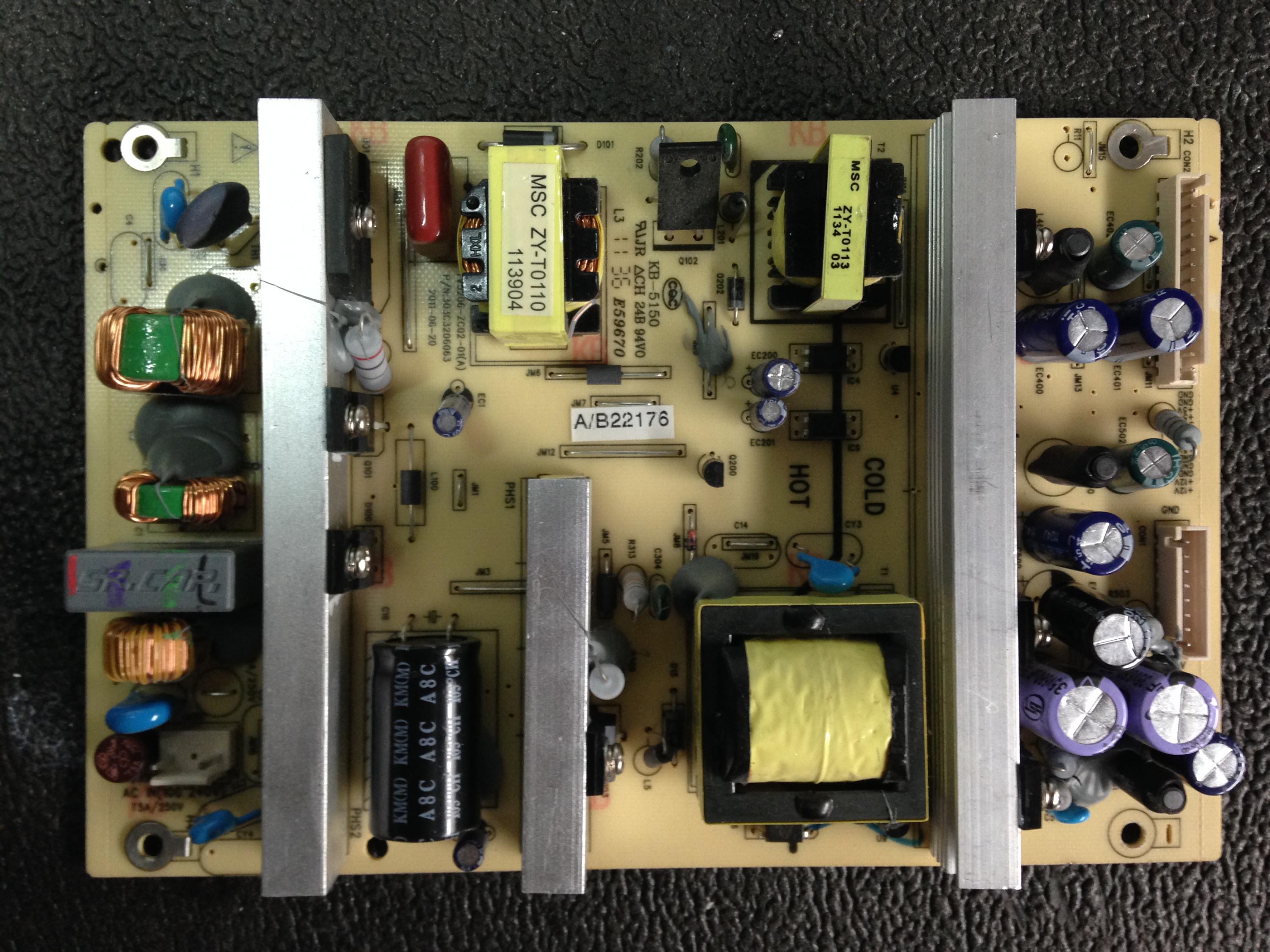

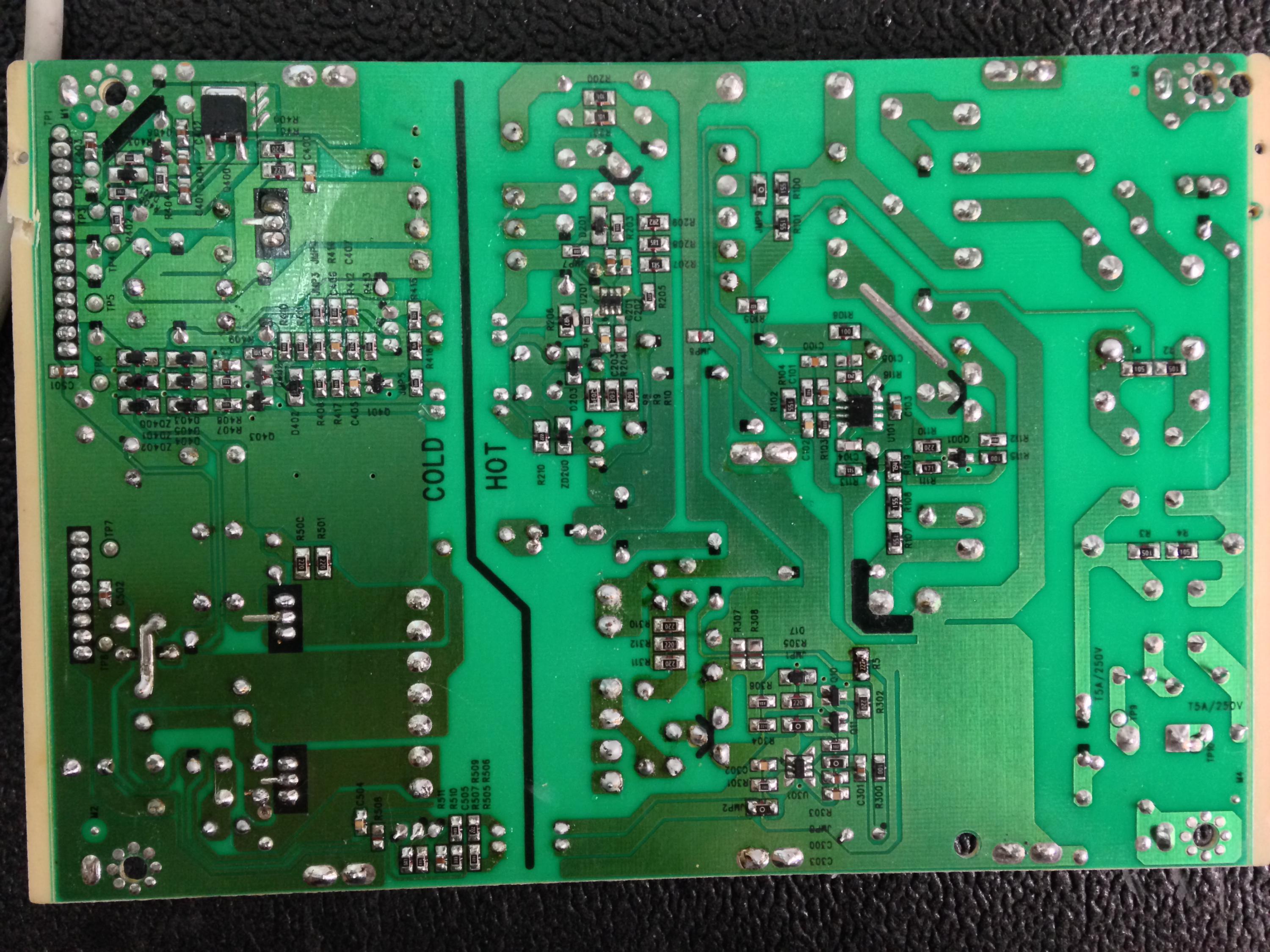

            I have same issue. No 12v, 24v. Big cap reads 391v. Using 1k resistor between STB and 5vSB.
            I have checked diodes D500 and D501 and there is no input voltage. Ordering a board is an option but I'm very curious on finding what's wrong with this power board.
            I will appreaciate any help. Pics are attached.

              Re: westinghouse vr3215
              The pictures are cutout and do not show the whole board.

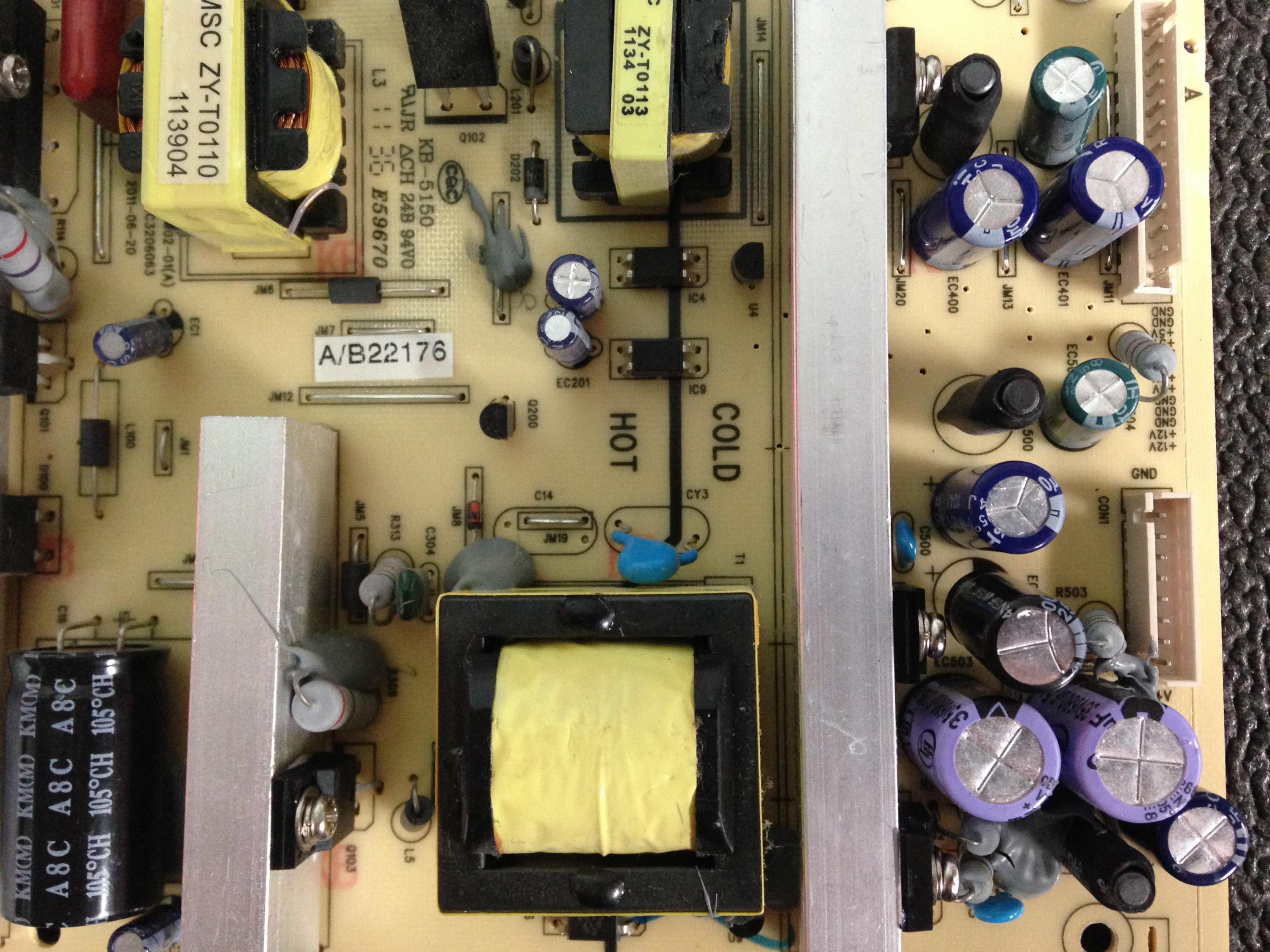

                #87
                Hope these pictures look better.
                Thank you

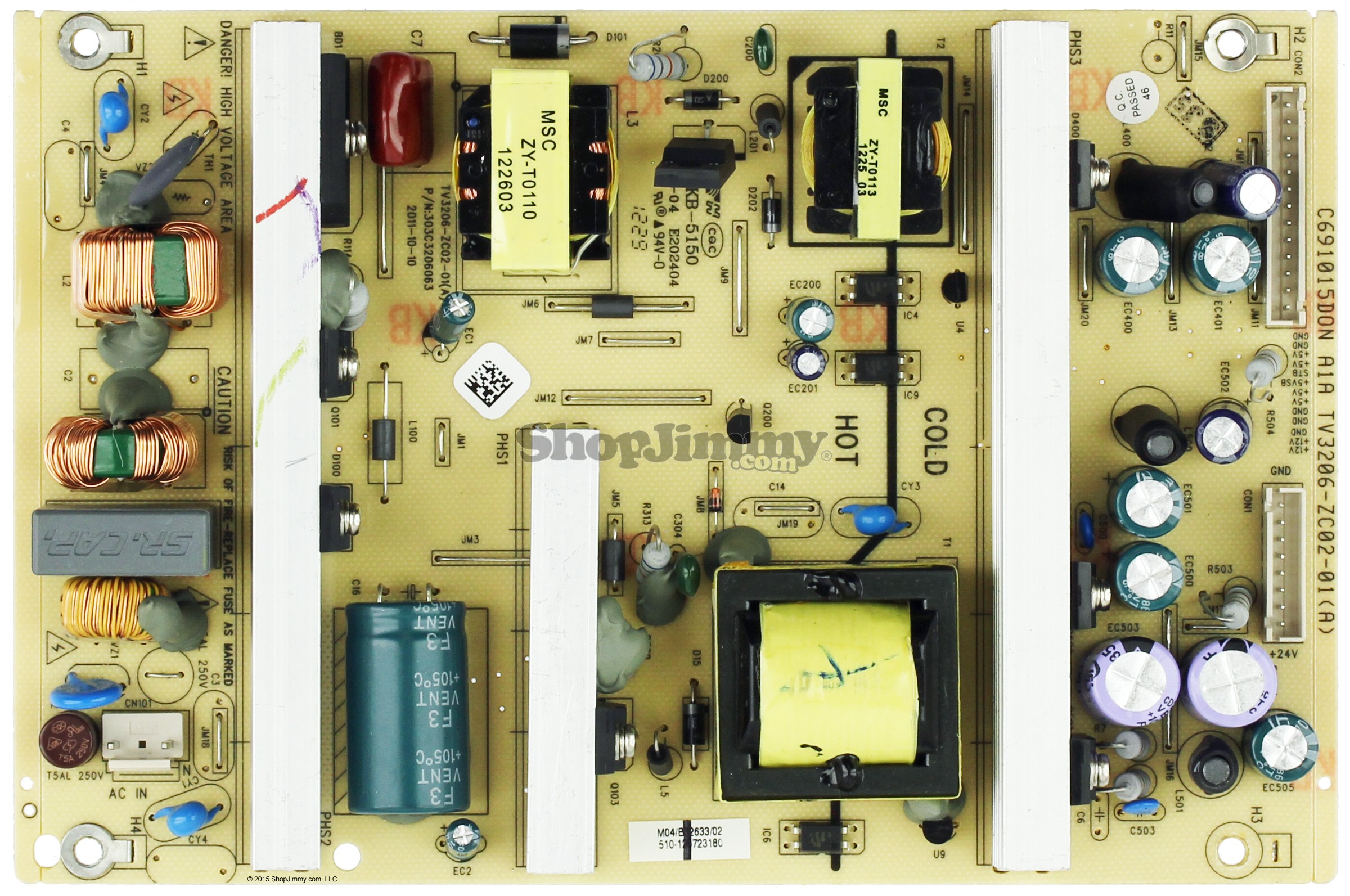

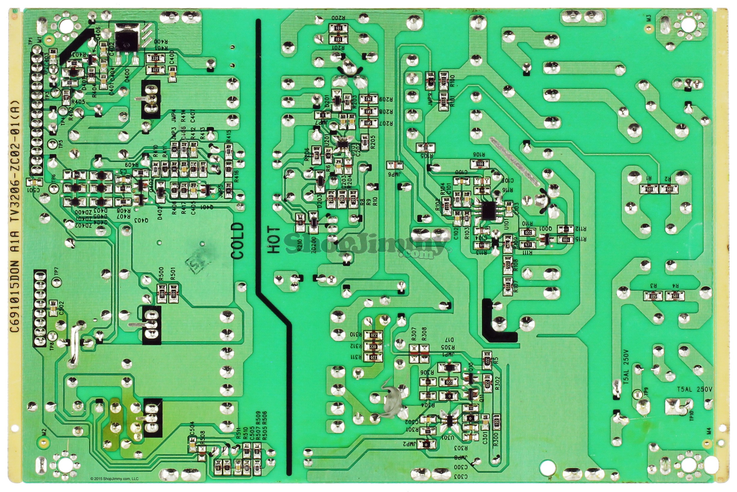

                  #88
                  Better pics from Shopjimmy.
                    OK, the 12V and the 24V are generated by the same power transformer T1 which is driven by the power MASFET Q103. Q103 is driven by the SMPS IC U301.
                    The 12V/24V power supply section is turned on by the PS_ON (STBY) signal and we know that the signal is OK otherwise you will not have the PFC Boosted Voltage.
                    You need to find out the P/N of the SMPS IC U301 to see if it is geTting the VCC to run the IC.
                    Also check the Source resistor that is connected to the Source pin of the Q103, it should be < 1 Ohms.
