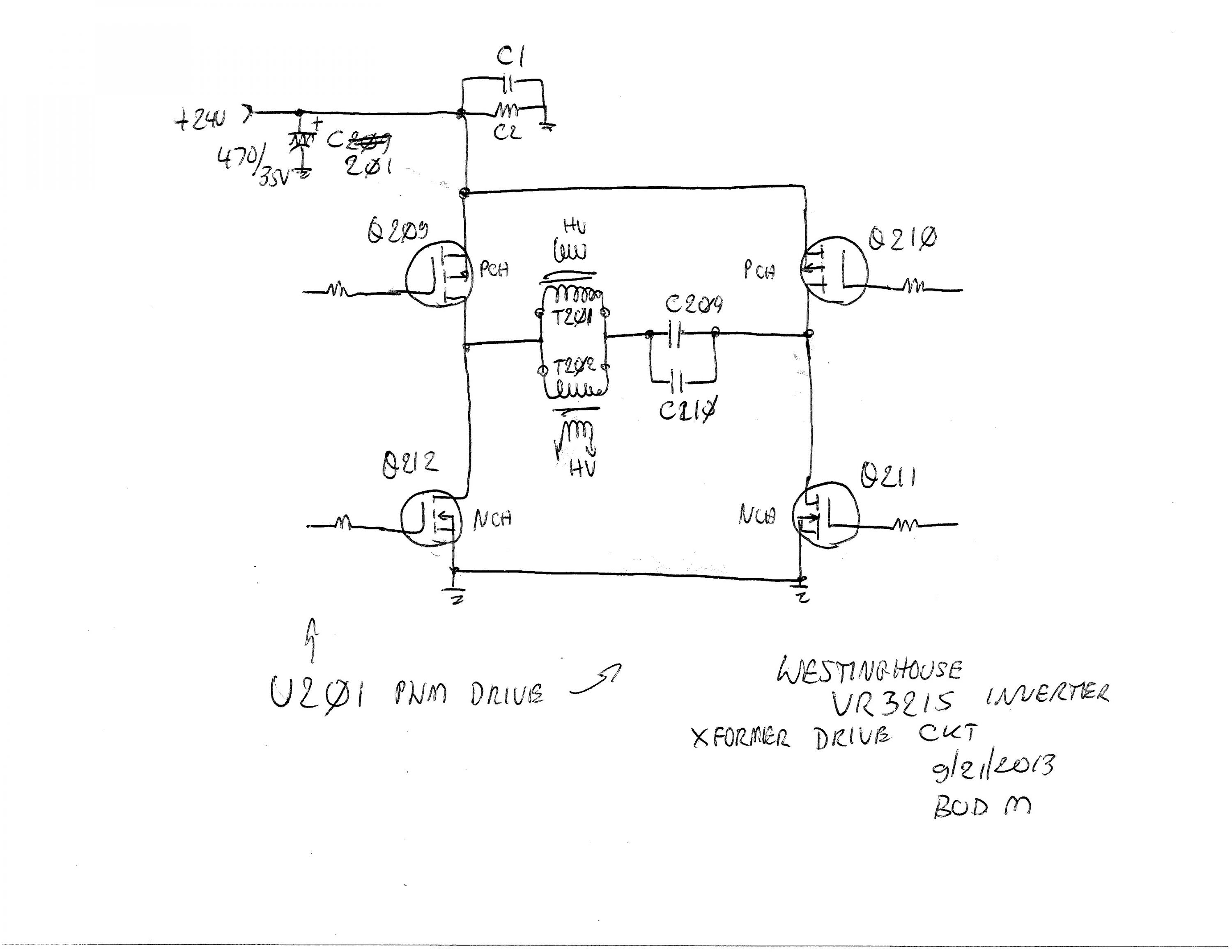

                      OK, it is just a simple full bridge drive circuit driving the Inverter xformers primary side in parallel, since all the lamps are not getting full drive voltage, it has to be a fault in the common circuit some where. Can you get the P/N of that SMD PWM IC?
                      This is the simplified diagram, you should take the resistance reading between the Source and Drain pins of the 4 MOSFETs. C209, 210 should be check for resistance leakage and value (I do not know what the value is).

                          OK, sorry I took so long. The numbers on the SMD PWM are line one B13022, line two 0B3328UQP. Resistance readings on the MOSFETs are 10.01k, 41.9k, 39.1k, 9.99k. No way to check the caps right now. I'm going to look for an ESR meter on eBay right now.

                                        So I did some live testing on the inverter board and think I made some valuable observations. 1, there is no power to the common side of the HV transformers. I think we already knew that though. 2, I have either positive or negative voltage on every terminal of the PWM IC, I don't know what those voltages should be but figure, since there are no terminals which are just nothing, that its probably working. 3, I have neither positive or negative voltages on either side of caps C209 and C210. 4, the big resistor on the top side of the board gets hot enough to burn you. This I found by chance when I was done and went to pick up the board. I hope some of this makes sense to someone reading this.
                                        ------------signature starts here------------
                                          #40
                                          Re: westinghouse vr3215
                                          What is the value of that big resistor? It is hooked as a bleeding resistor (it is connected to the 24V+ and Ground) per my drawing. There will no DC across the primary side of both transformer due to the DC blocking caps, but there will be high frequency AC on the primary side.
