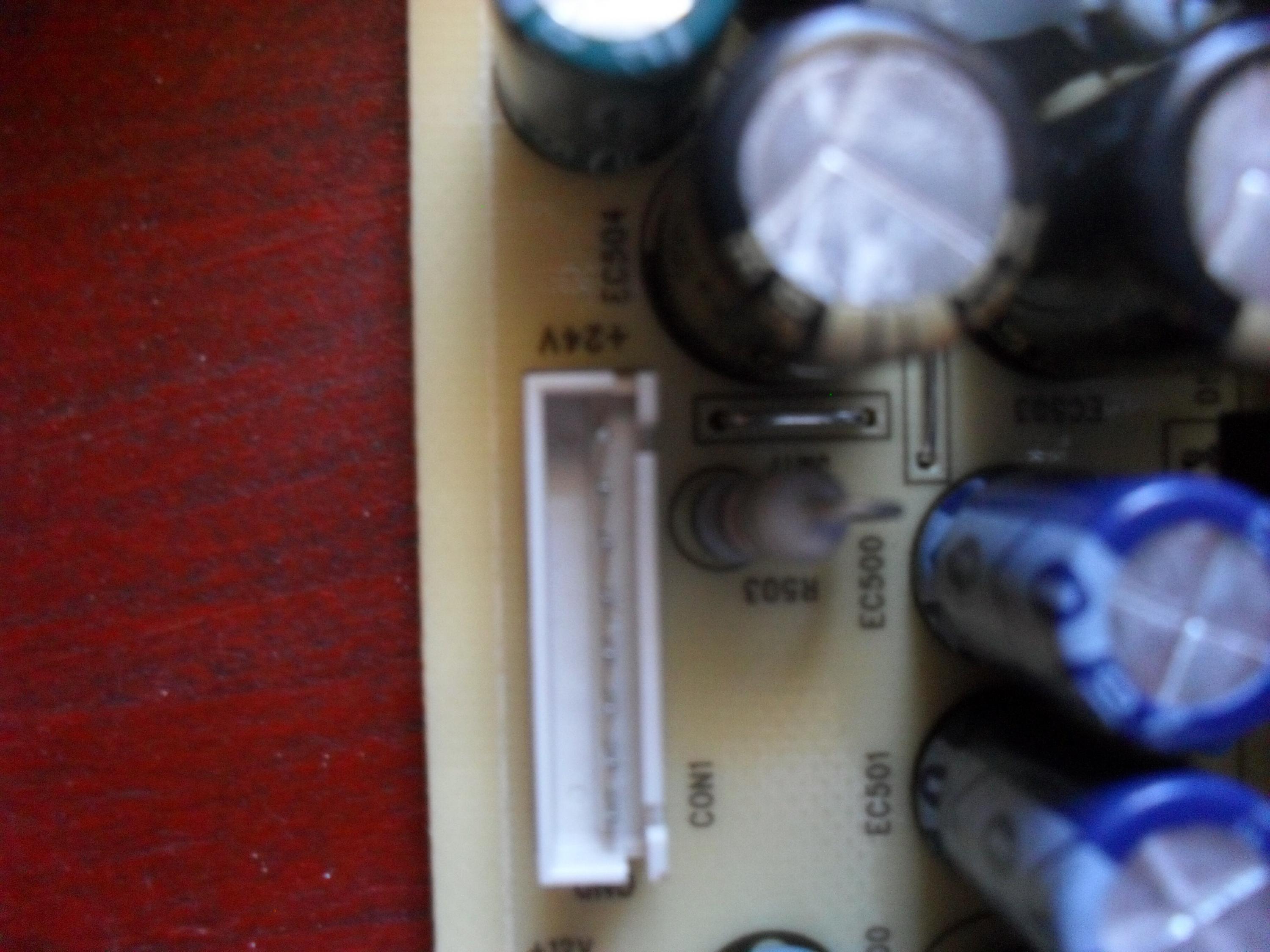

    westinghouse vr3215
    westinghouse vr3215 has 5v but no 12v or 24v?? Help what to check next here are some pics..I have replaced all the caps.

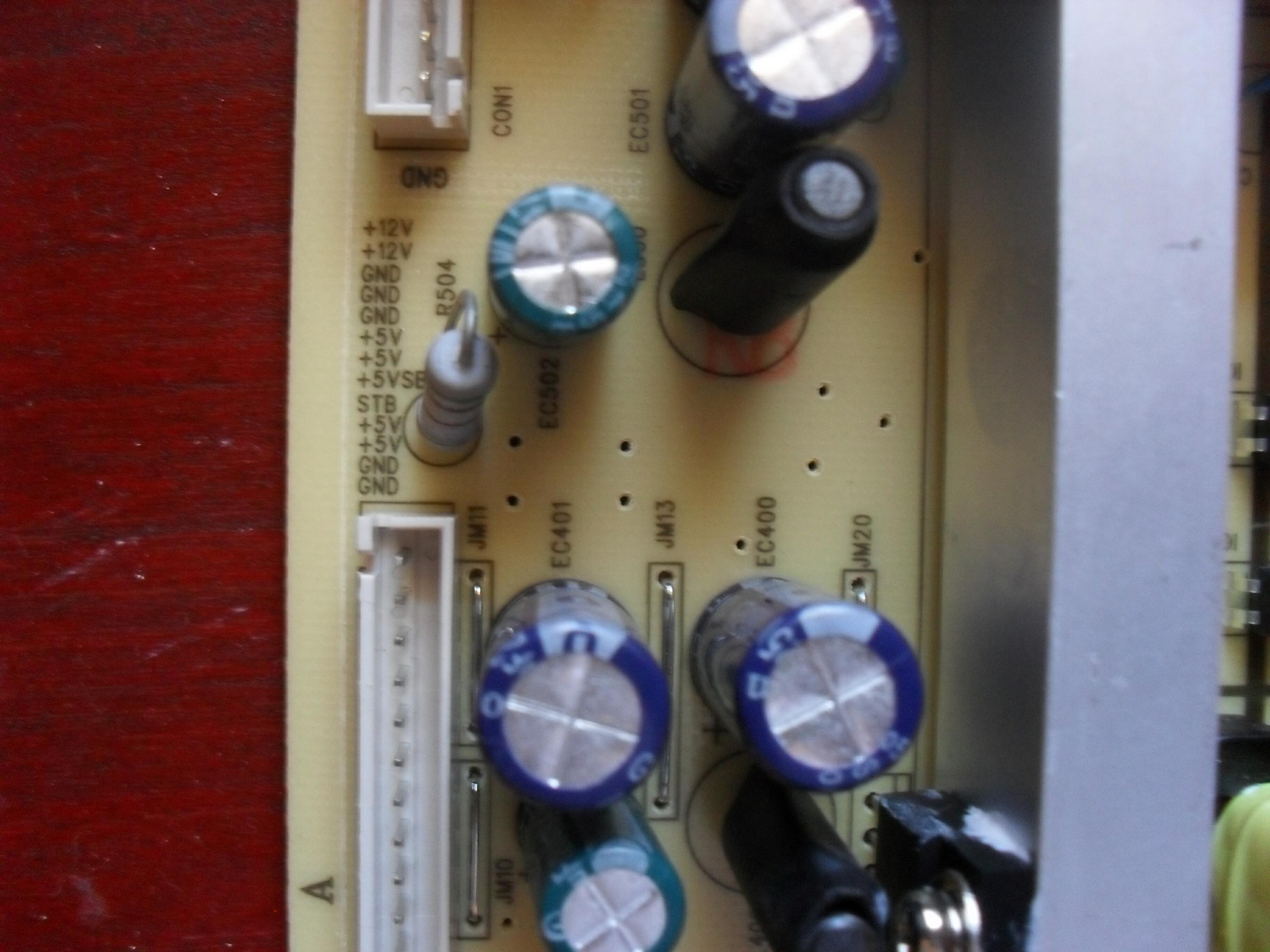

    Re: westinghouse vr3215
    ok here are somre readings i got
    +12v = 0
    +12v = 0
    GND
    GND
    GND
    +5v =5.2
    +5v =5.2
    +5VSB =5.2
    STB =3.5
    +5V =5.2
    +5v = 5.2
    GND
    GND
    NO 24v all 0

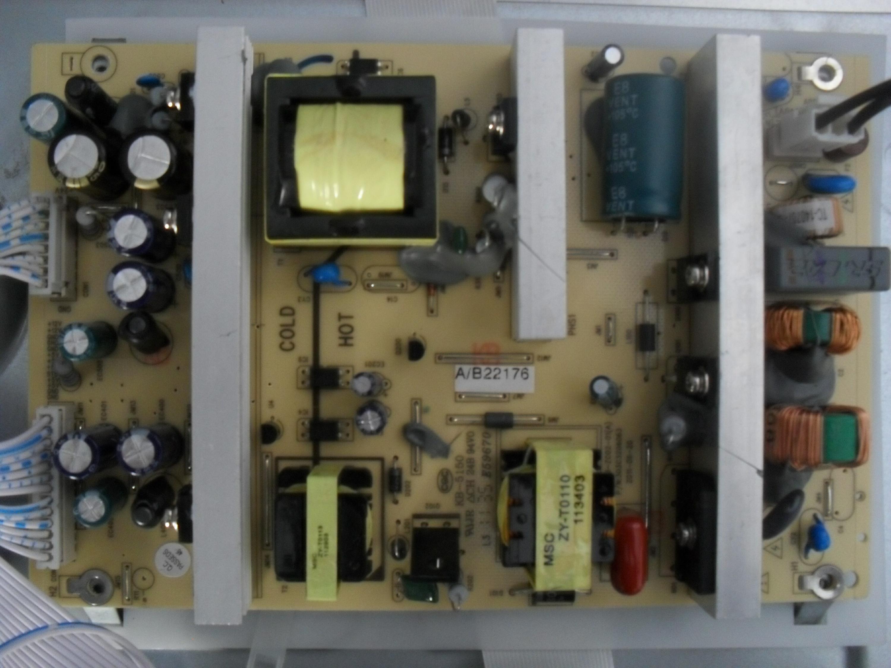

      The problem is in the power supply since it is getting the correct signal feeding it.
      What voltage do you have on the two legs of the large filter cap (you will be working in the primary hot side, so be real careful not to touch anything), it should have about 380~400VDC on it.
      • johnz
        • Jan 2012
        • 66
        It jumps between 393 to 397..
          Good, the PFC is OK, if the 390v is not present, the 12v/24v circuit will not run. So now we need to check the 12v/24v SMP section. I will have to trace out the copper traces on the bottom side of the board to see how they are connected, it will be really time consuming task. Did you look and find out how much the new board will be yet?

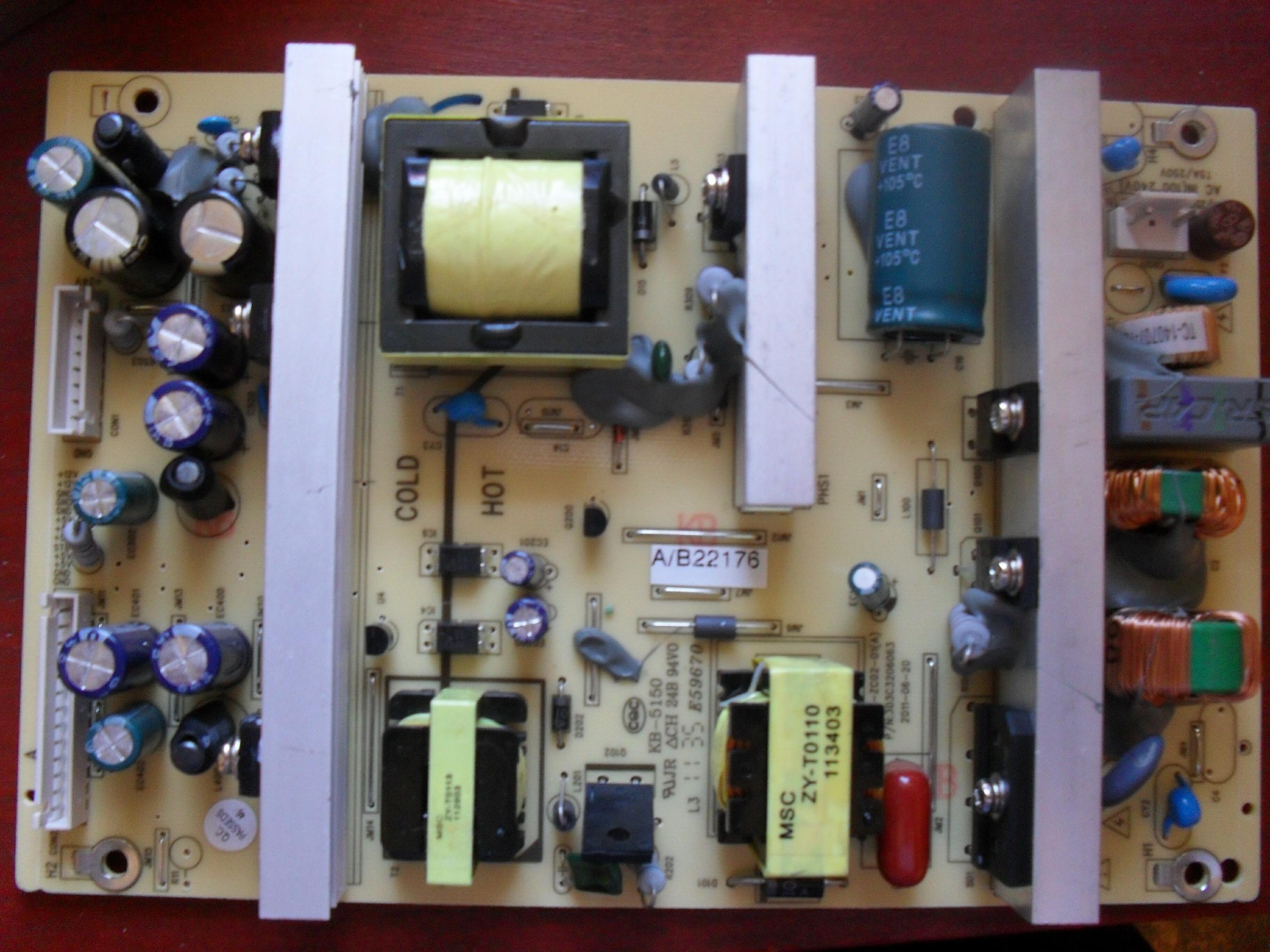

            yes .....59.99+tax ..http://www.shopjimmy.com/westinghous...upply-unit.htm ...thanks for helping me out here..!
              That will be worth it for quick fix.
              • johnz
                • Jan 2012
                • 66
                just wanted to know if it was the power board..thanks for your help.

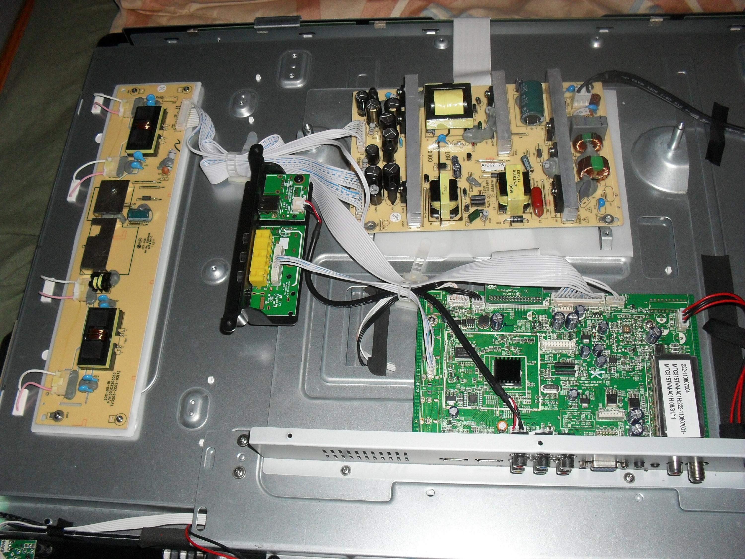

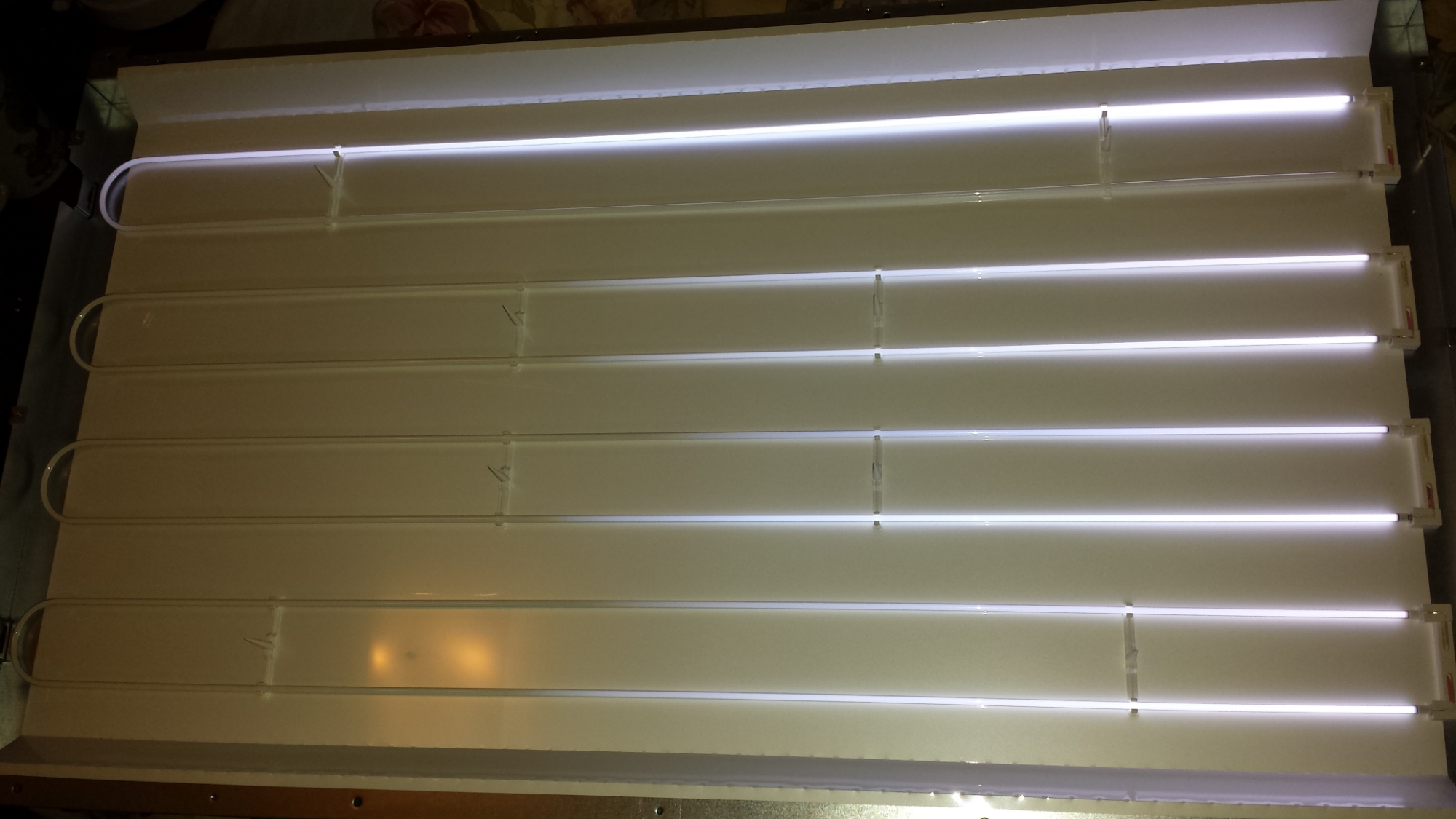

                                  OK I put the board back in and reconnected everything. I have the correct voltages on all the terminals. I guess that brings it to either the inverter board or a bad ccfl. I took the screen out and looked at the ccfls. Here is a pic of them when I power on. They don't fully light and go out in about 1 second. I also hear a slight humming sound.
                                  ------------signature starts here------------
                                    OK, so now you do get the 24vdc to feed the inverter board? if that is the case, you will need to see if the inverter board is OK, you can check all the fuses, the resistance readings of the high voltage side of the inverter transformers, etc.
                                    • lookimback
                                      • Aug 2013
                                      • 1489
                                      On the inverter board I have 2 wires that come from the main board. They are BK and DM. BK voltage is 2.9v and DM is 1.2v. I don't know what is normal.
                                      OK the resistances on the high voltage side are, if I did this correctly (I tested via the solder points which lead to the ccfl connectors), 1.308k, 1.303k, 1.282k, 1.280k. As for fuses, I don't see anything I recognize as a fuse. I'm new to SMD components so if some of them are fuse I'll need you to describe them. Thanks.
                                        "BK voltage is 2.9v and DM is 1.2v."
                                        BK is more likely to be Backlights ON signal from the main board.
                                        DM is the Backlights Dimming control voltage from the main board, 5V = Max lamps brightness, 0V = dimmed.
                                        So it looks like the Main board is sending out the correct signals to the Inverter board, but the Inverter board will need 24Vdc from the power supply board to run. So do you have 24VDC? Pictures of the inverter board needed before I will go further.
