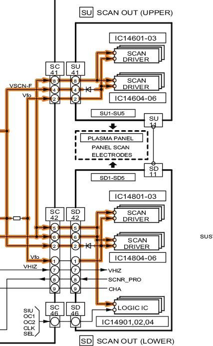

          I just watched the video and have a question. can I pick any of the terminals coming from the Y Sustaining board to reference from or is there specific pins I should be looking for or not using to check fo continuity? I'll check my buffers tonight
          Also. I know the Y Sus. boards have several versions depending on size of the Tv. My board number is TNPA5081AF . I can not find any "AF" boards in stock at the moment, Has anyone used a different suffix board with success?

            Re: Panasonic TCP50GT20
            Where the buffers screw in is your reference.
            Best bet may be to find a cracked screen and harvest the parts. You may be able to use 58", 60" or 65" board in a 50" set. Maybe.
            Or if you replace that IC and the nearby FETs/IGBTs, I think it should work too.

                                  OK, I am not sure if this is helpful to anyone but I tested all the Test Points to ground on the bad board and found that all of them were shorted to ground except for points 96,and 100.
                                  TP95 would slowly rise to being open
                                  TP58 started as a short and rose to 1161 and held there.
                                  SC46 had pin 1 open and the rest shorted
                                  SC41 had pins 106 open and 7,8,9 were shorted
                                  SC42 had all pins open
                                  SC50 had pin 1 shorted and pin 2 open
                                  TPVSUS= shorted
                                  SC2=shorted
                                  most of the SC20 ribbon pins were shorted
                                  All testing was done with the meter in continuity mode and one end on ground.

                                      Better hold off installing that SC board, I think you've mixed the connector designators up. Do mean on the buffer boards SU41 & SD42?
                                      I have concerns about SD42 pin 2 short which is the Vscn-F, I have 220k roughly that's in resistance mode, black probe on the earth plate and red on the test point. Pins are 1,3,5,7,9 on one side, 2,4,6,8 the other on the connector.
                                      I'd prefer to see straight out resistance measurements, not diode mode. I found it hard to get consistant results on the higher readings as the circuit is charging up and if I reverse the probes, different again but pin 2 on the SU41 I get about 220k both ways, pin2 on SD42 also 218k both ways. I don't get any S/C on pins 1-9 on SD42?
