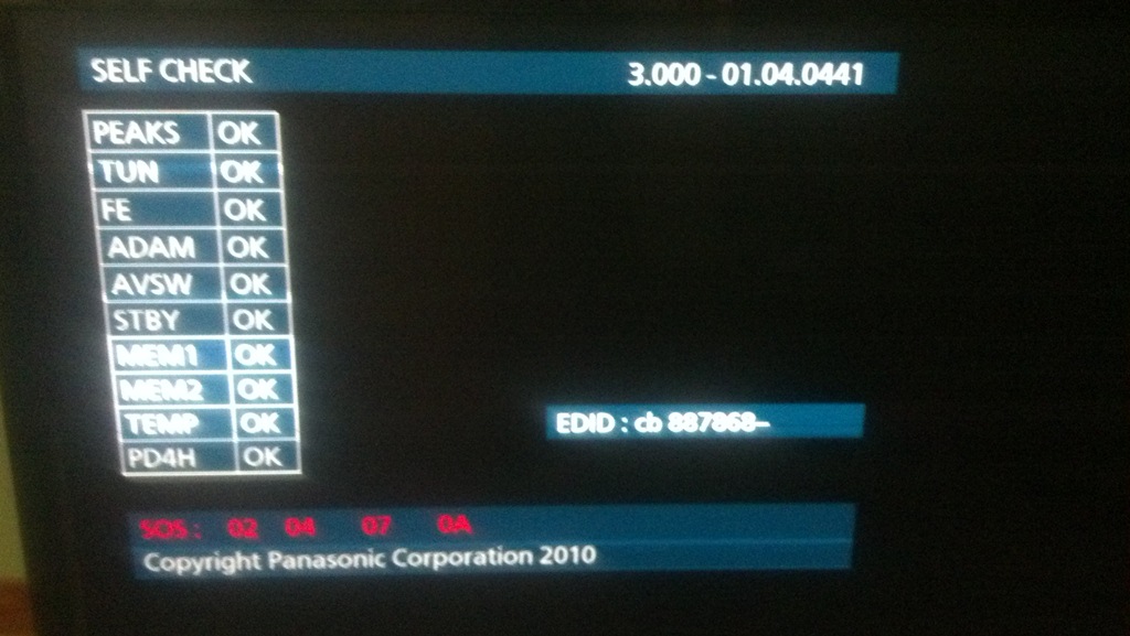

              The upside for you guys is that I pulled some more measurements. I am not sure if this is helpfull to you. I tested the buffers per the youtube video some time ago and there were no shorts.
              Meter set to 2m, one lead to ground. NOTE: the ribbon cables to the screen are connected.
              SU41
              Pins 1,3,5,7,8,9 all open (meter reads 1)
              Pin 2= 1.896
              Pin 4= 0.282
              Pin 6= the value slowly rose to open.
              SD42
              Pins 3,4,7,9 all open
              Pins 5,6,8, slowly rose to open
              Pin 1=1.800
              Pin 2=.220

                That seems comparable to the set i have which I feel is good. Results differ I guess because the range is set to 2Mohms, mine just auto ranges so the slow to rise to open mine heads to 4-6 Mohms. I tested mine completely removed and isolated from each other. I got straight open on SU41 , 6 but SU41, 2,4 & SD42 1,2 are very close to mine. I reckon chances are it's good.
                So what was the pin2 short you had? Was that on the SC board or an errror?

                  You would not have pin 8 and 6 mixed in that result on SU41. Pin 8 potentially on that setting may show slowly rising to open. Mine slowly goes to about 6meg pin 8

                    My Meter does not autorange. It's just a $17 velleman I have had for years. I believe the short on pin 2 may have been O.E.
                    I am pretty confident that the buffers are good. I saw no signs of heat or failure on the PS so I feel it is ok as well.

                      The paper I wrote everything down on shows pin 6 rising to open and 8 open.

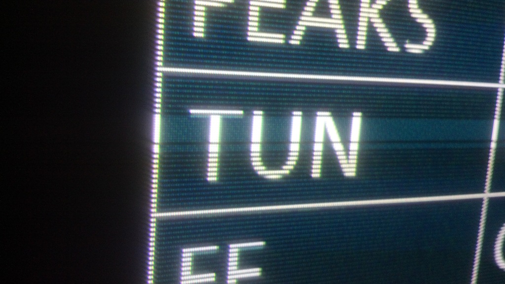

                                  New board worked BUT now i have 2 horizontal black lines on the screen. They go the whole way across. Any ideas??
                                    #37
                                    Re: Panasonic TCP50GT20
                                    You replaced the SU or SD right? In which case, locate the ribbon for that particular portion which has the defect on the display, unplug it, and reseat it. (You must do this with power off.)

                                      I reseated the ribbon cables and here is what I have....

                                        I replaced the SC board (5081AF)only. I removed the buffers to check them and thats it.
                                          #40
                                          If you removed them, getting the cables back in is very fiddly, and it's hard to do right. You'll have to reseat them all until the picture works better.
