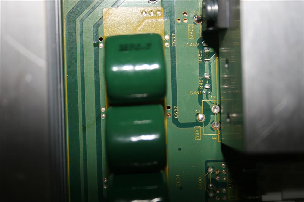

          Originally posted by tw2005
          Hey that's fantastic, if you have a chance get some clear close up shots of the board for us to look at. It may give some clues.
          Which board do yo want close ups on? the bad one or the good one?
          Thanks for all the help guys
            #45
            Re: Panasonic TCP50GT20
            Can we ask for both ?

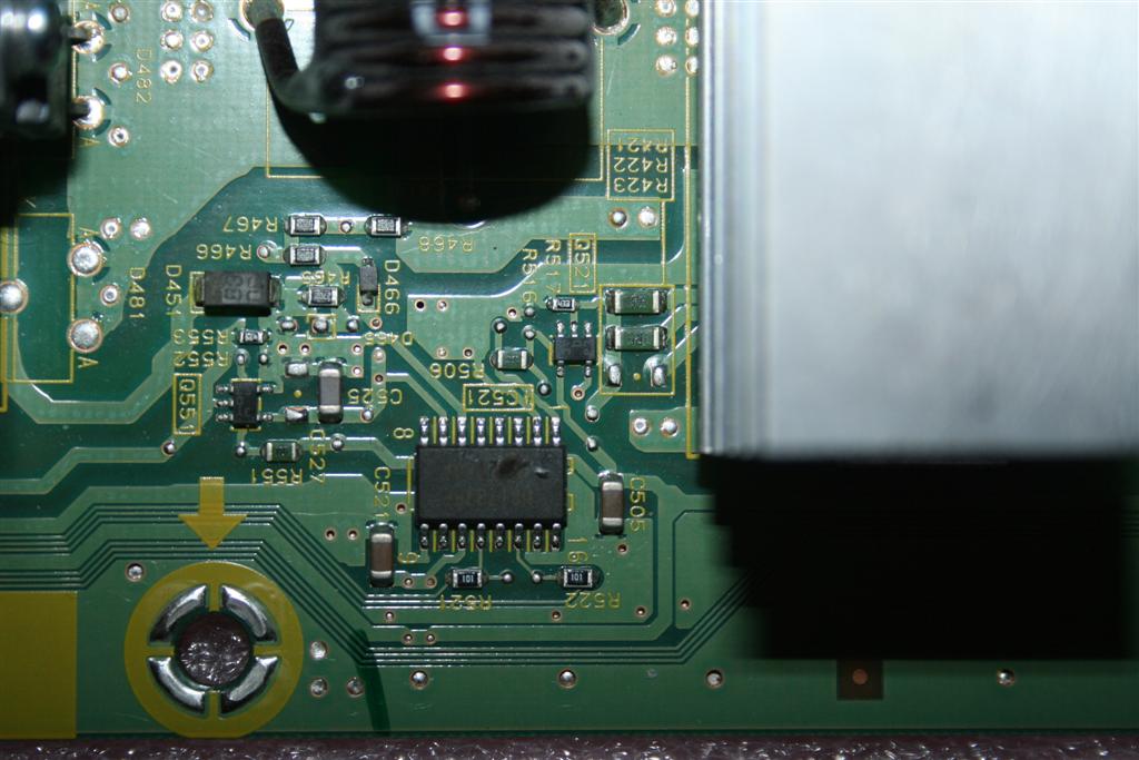

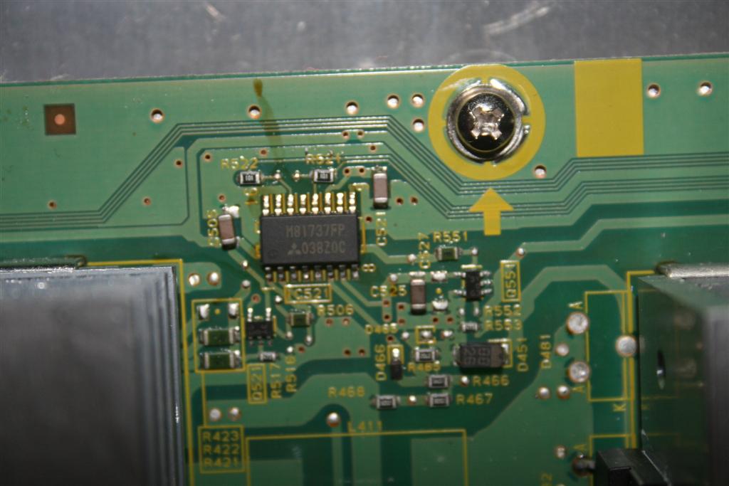

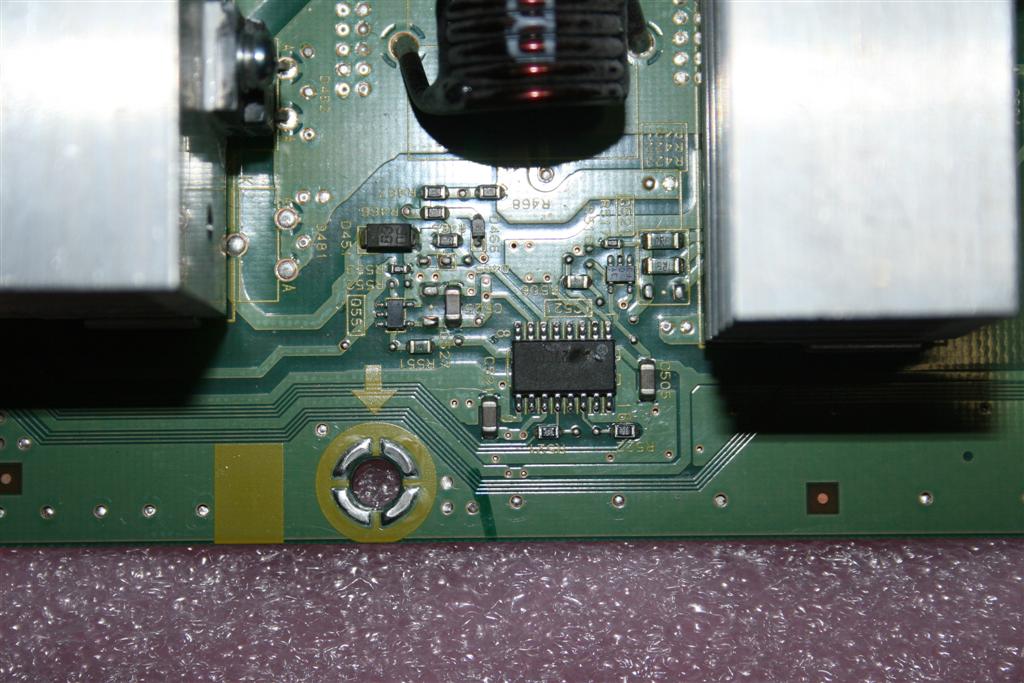

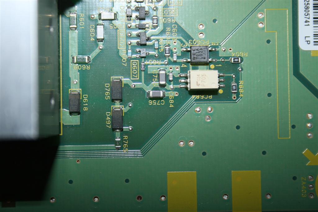

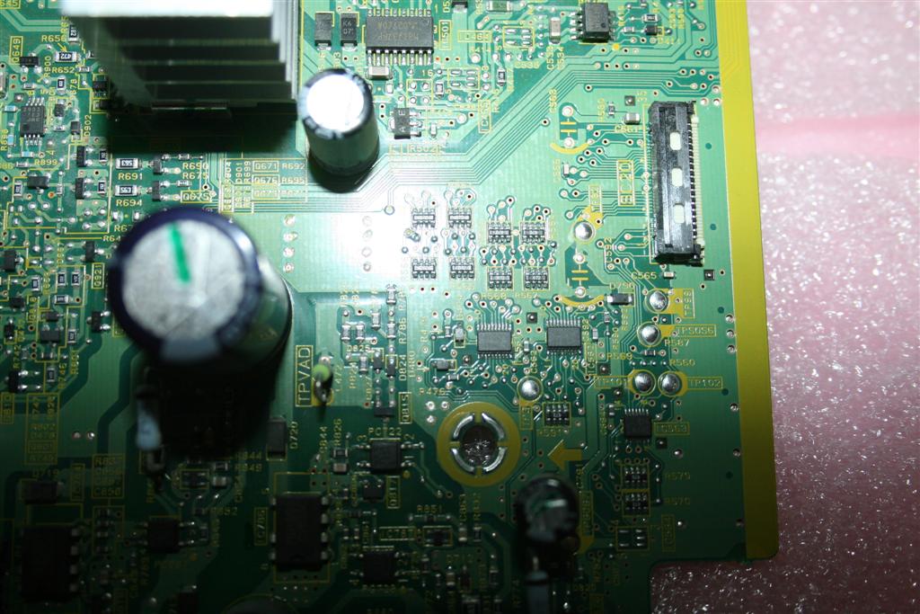

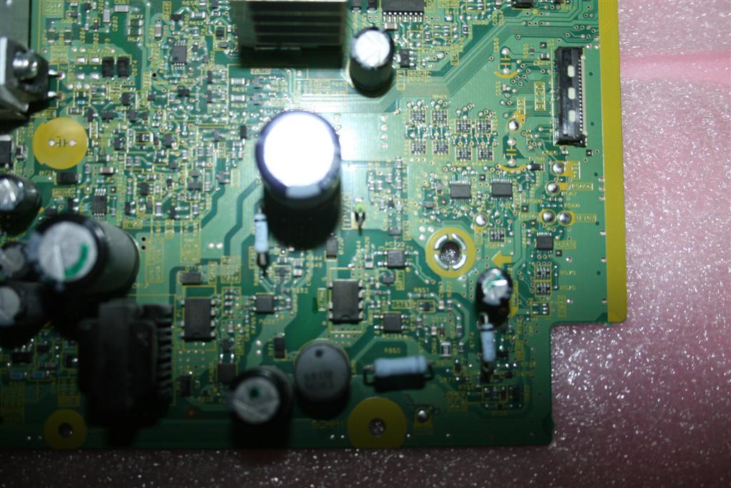

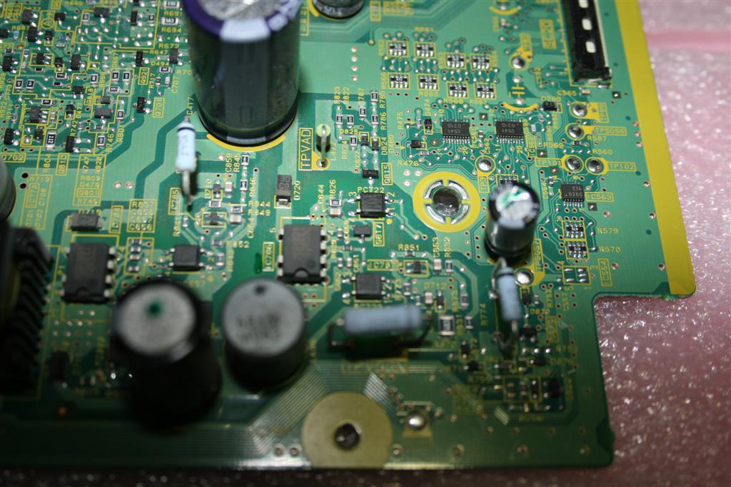

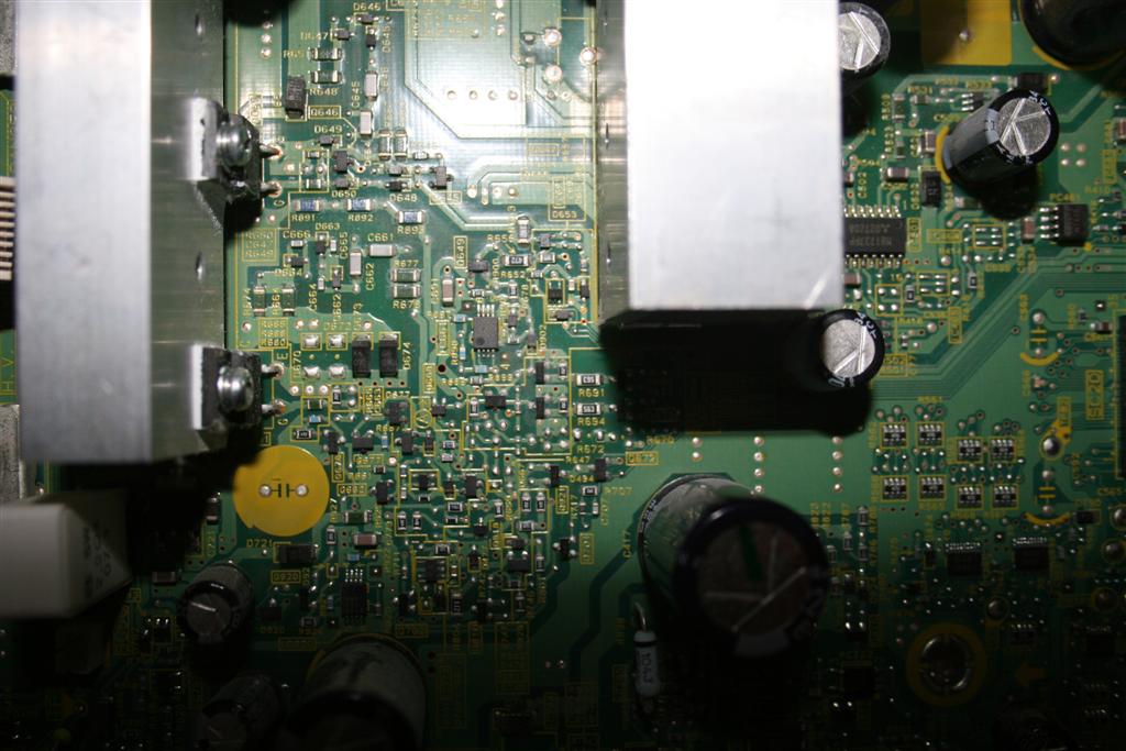

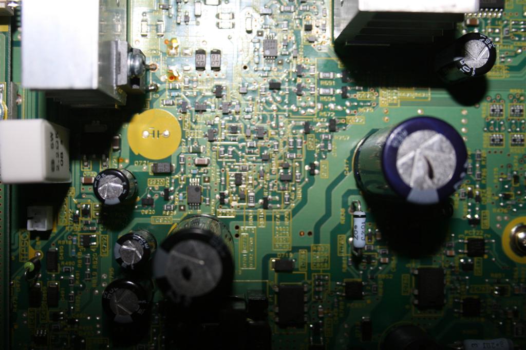

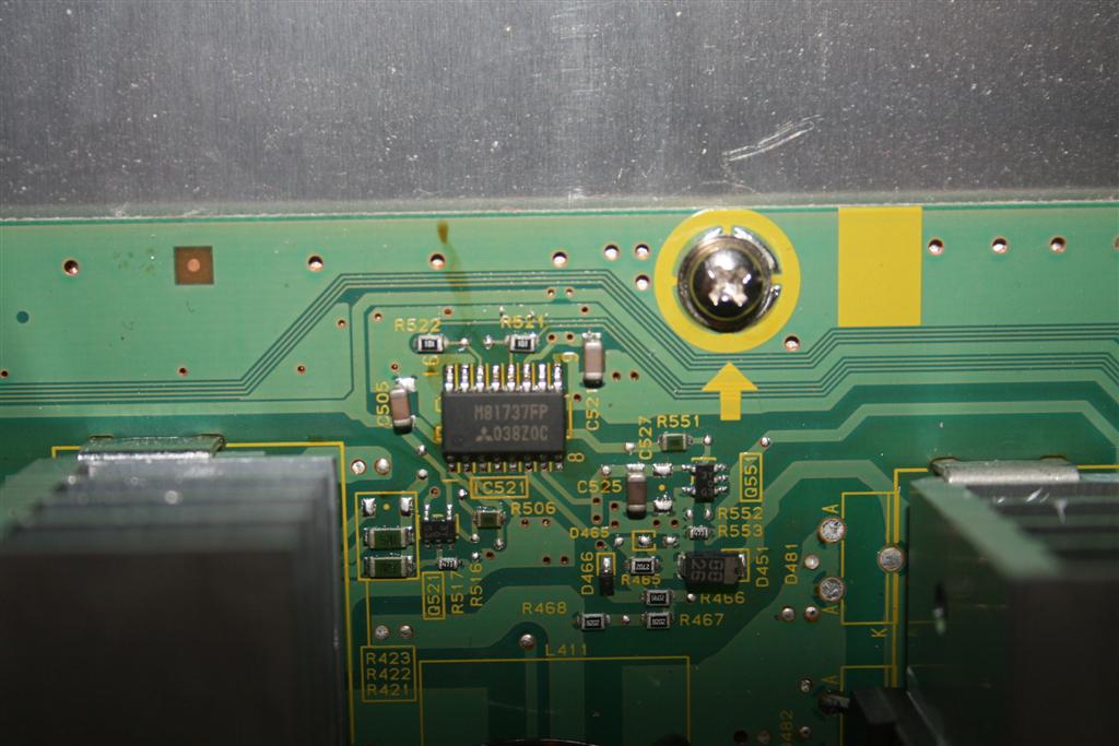

                    I'm primarily interested in any evidence of SMD replacements. You've already confirmed the fet driver ic which is one of the easier things to check but I'm worried I'm going to miss some very tiny device which is shorted.
                    I got lucky and stumbled on a tiny inverter chip shorted on all 3 boards , IC773 , 5pin smd, located near that large cap C813.
                    If I miss something and it simply does not work ok, but if it destroys other devices then I won't be happy.

                      #50

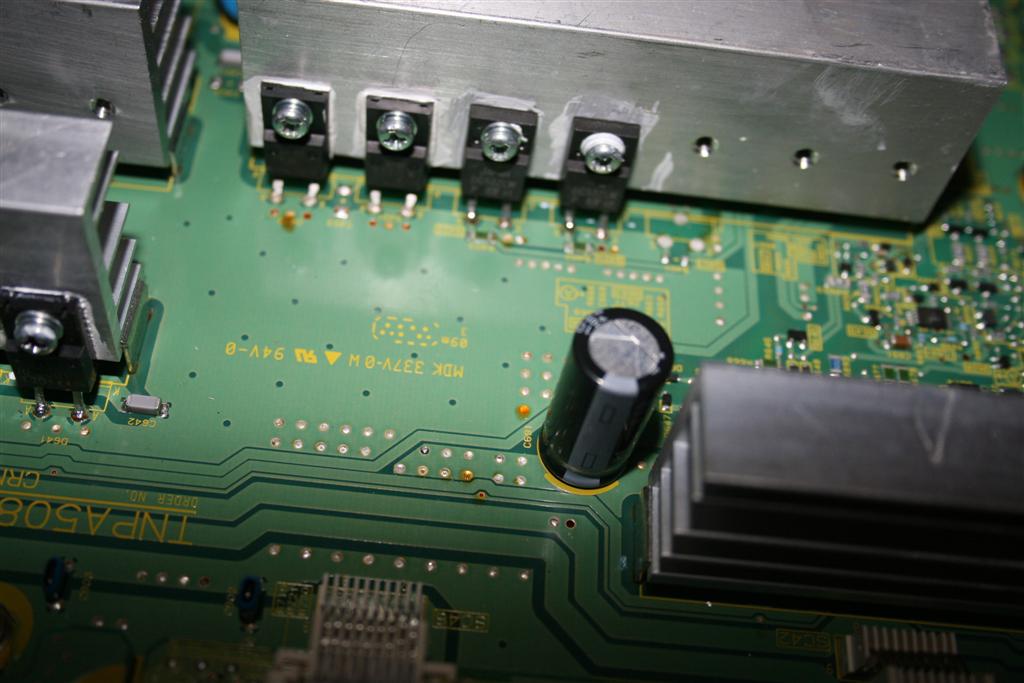

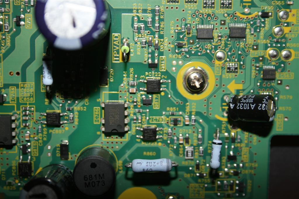

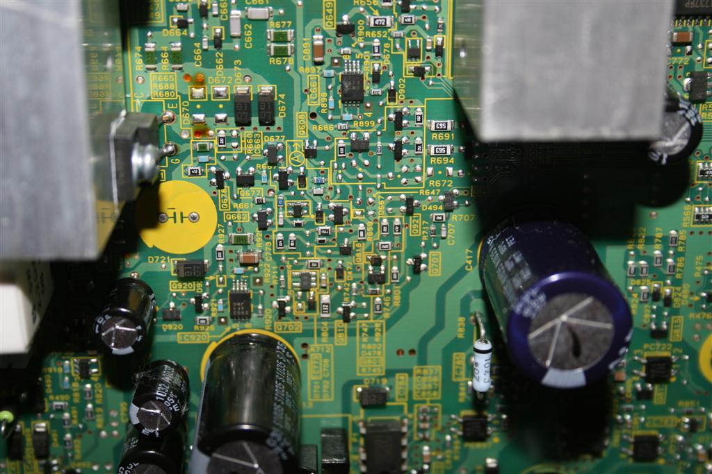

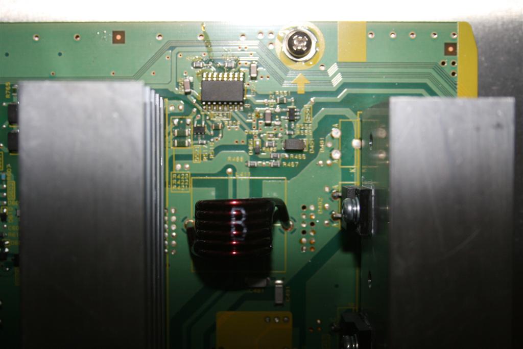

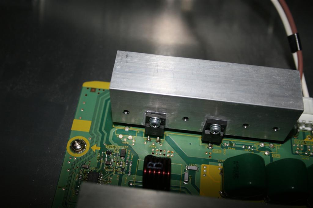

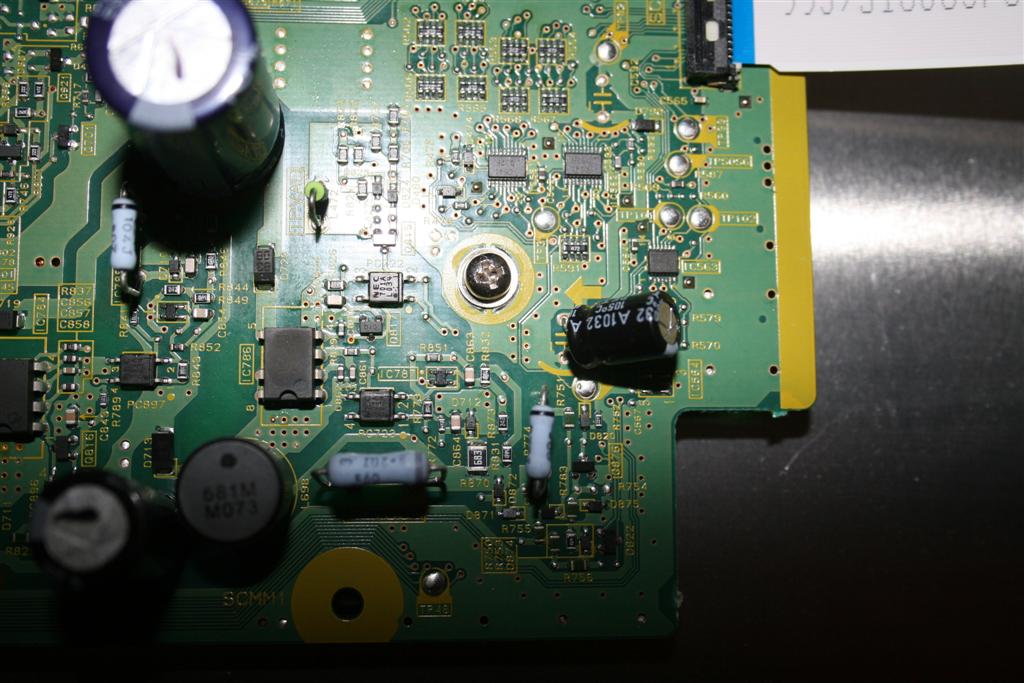

                      Pics of BAD board.
                      • rcpilot82
                        • Feb 2013
                        • 33
                        #51

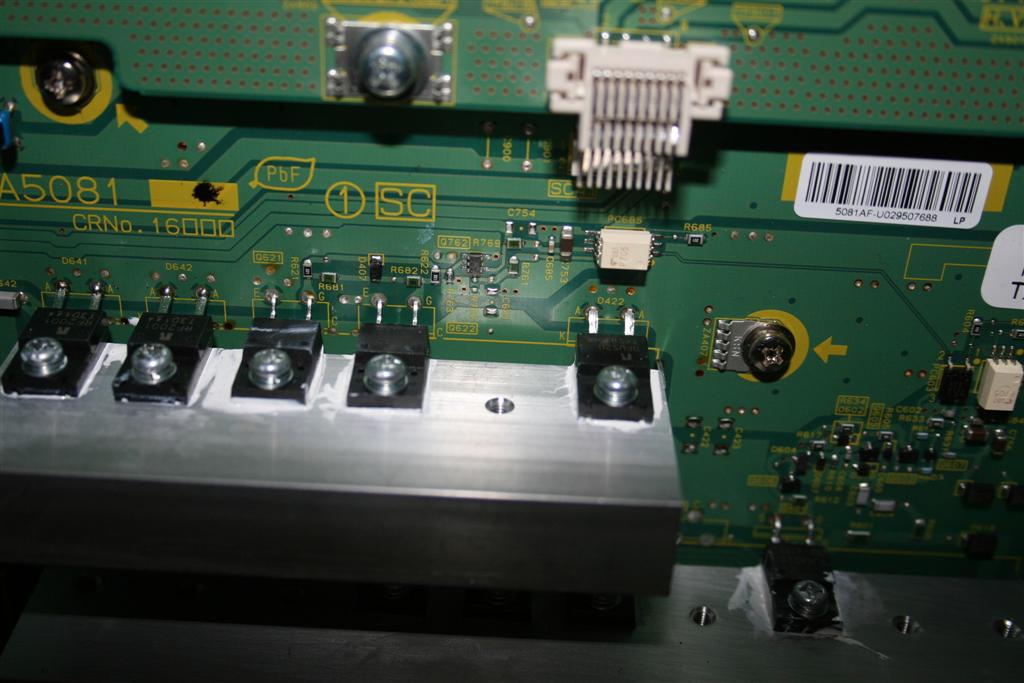

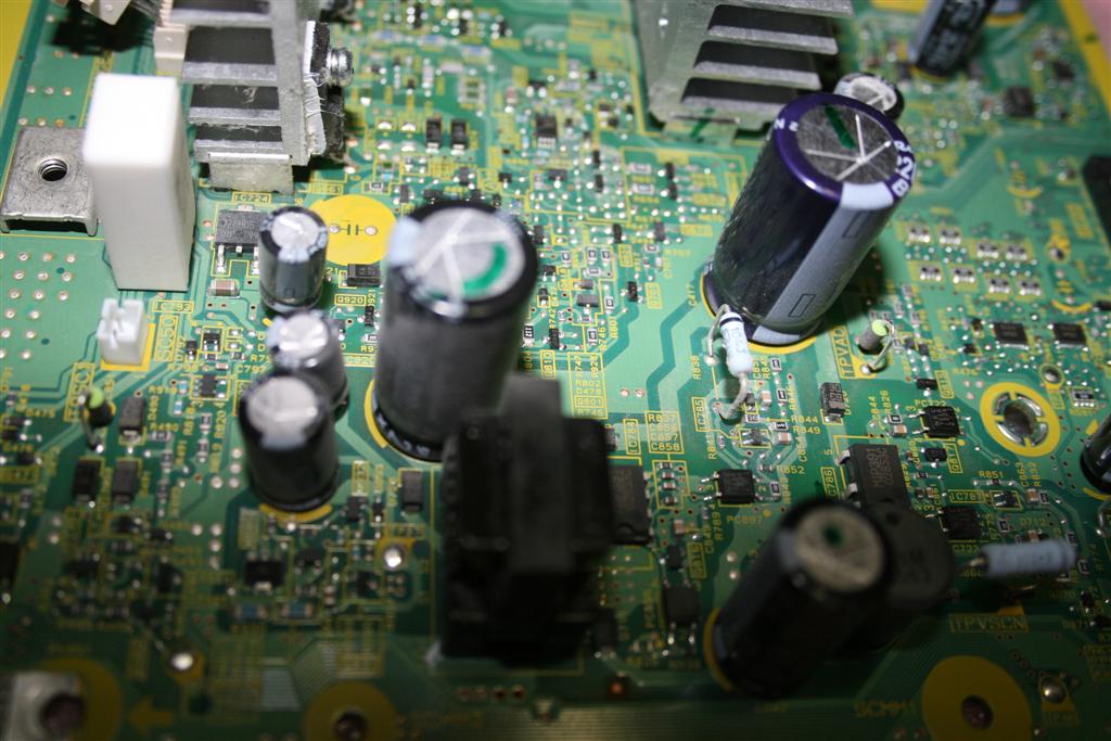

                        Pics of Refurb. board

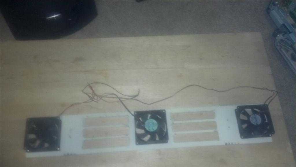

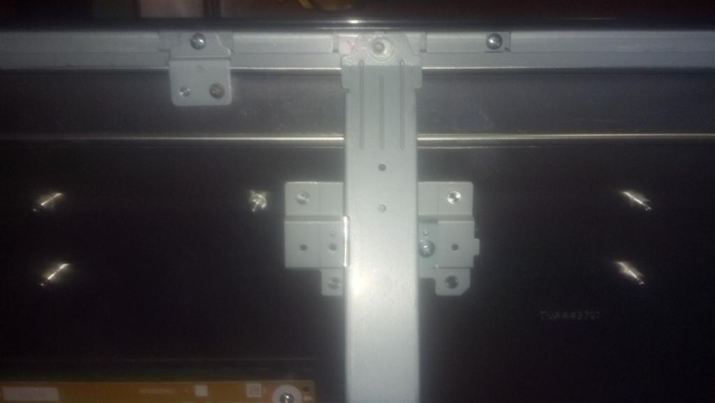

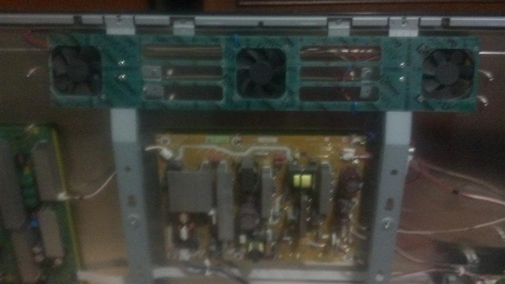

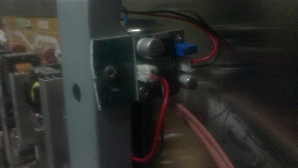

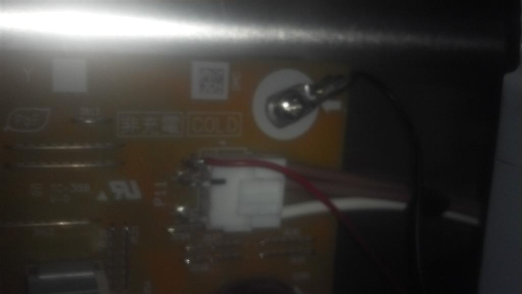

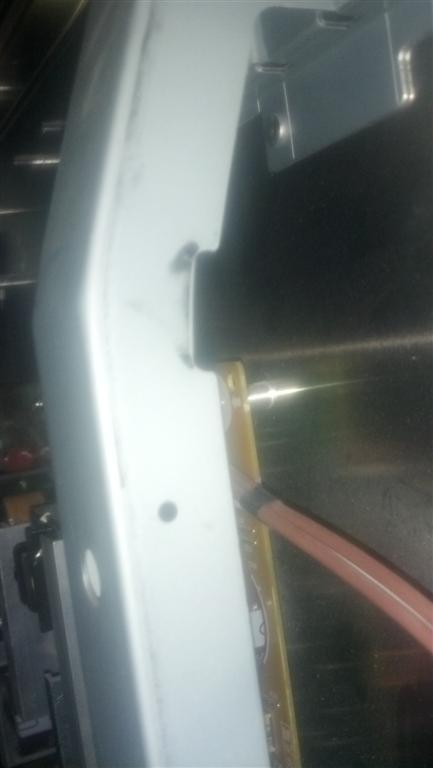

                                      Well, The fan mod works.
                                      Below are several pictures of how it all came together. I used pop rivets to assemble everything so there is no drilling on the TV. I also used existing holes to mount everything.
                                      assembling and mounting the fan shroud;
                                      1. Cut out acrylic fan shroud, I had a junk piece of material and since this was not going to be a visable Mod. I used that.
                                      2. Mount fans, I decided at the last minute to use 3 fans instead of 2 so that all the boards would get some air moving over them.
                                      3. Wire fans, all joints were soldered and heat shrink applied. Reds to red, blacks to black, no brainer. All wires were connected to the supplied jumper with the DC-DC.
                                      4. I loosened the one screw about 1/3 down on each of the mounting supports. This allowed me to slide the wires for the outboard fans under the mounts so they would not pinch.
                                      5. Pop rivet the shroud into place. 4 rivets using 4 existing holes.
                                      Done.
                                      Mounting the DC-DC.
                                      1. using a scrap piece of acrylic, I made a mount for the DC-DC. This required a few holes and notches to clear the solder joints of the Thru Hole mounted components on the board.
                                      2. mount the DC-DC on the acrylic with a rivet.
                                      3. mount the DC-DC to the side of the mount support nearest to the SS and A boards.
                                      4. plug in the connector from the fan shroud assembly to the "OUT" of the DC-DC.
                                      Done.
                                      Wiring the DC-DC.
                                      I found that Connector 11, Pin 4 had 15VDC output when the unit was switched on and 0 volts when turned off. This is the connector to use.
                                      1. Using the jumper provided with the DC-DC I soldered a ground lug to the black wire to mount it to the screw on the PS directly above connector 11
                                      2. I then wrapped the positive end of the jumper around the Pin 4 between the PCB and the connector housing and soldered it.
                                      3. plug in the Jumper to the "IN" on the DC-DC.
                                      Done.
                                      Final setup:
                                      Check all wiring for chaffing spots or interference, and power up the set. Have a small flat screwdriver on hand to adjust the pot on the DC-DC for best speed/sound combination. Once you are happy unplug, wait a few mins and re-install the back cover. Hopefully the boards will enjoy the airflow for many years.

                                        That's a top effort, seriously. Not exactly a hatchet job. I did'nt think those boards got too hot in this but every bit helps. However if there was one part which had me concerned it was the large heatsink on the A-board which was virtually too hot to touch. not sure what your boards are like ours are slightly different.
