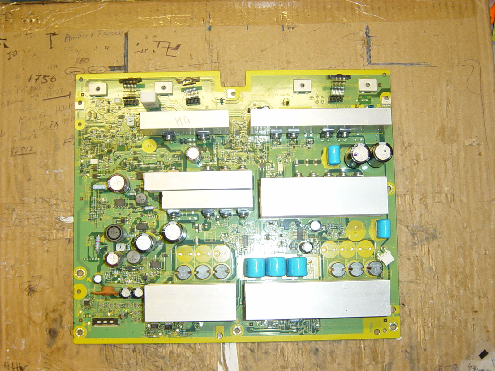

                  Alright, found some time to get back into this project for my brothers tv!
                  So from what i found not all the transistors were shorted. As shown in the photo. Looks like the transistor on the left of the photo with the question mark (q661?) is only shorted from emitter to collector, was yours this way?
                  And the others in green are not shorted on any of the pins.
                  Also im not to sure how to check the other components correctly?
                  Appreciate your hard work, would love to fix this dang thing, cant find any online and id rather fix it myself than trust another board!
                    Re: Panasonic sc tnpa5081 rebuild
                    Q661 all boards was shorted. From memory it always failed short across all 3 pins. Short across 2 pins is still bad and I assume by short it's dead short, 0 ohms continuous beep in diode mode.
                    Pull it out and recheck if need be but I would expect that transistor to be shorted.
                    I see D16482 B0FACP000003 DIODE 1 RFN25TM4SWSHORT & Q16452 B1JAEP000012 TRANSISTOR 1 GT45G128 you have listed as SHORT.
                    None of mine were except the last which it only failed with repeated failed repair attempts.
                    The diode the 2 outer pins will show short, center to either outer will test like a normal diode.
                    If that one has failed I could not find that one to purchase unless you want to try a genuine part online from a panasonic stockist.

                      Interesting, i figure ill just replace all the stuff you replaced since i have it out! Do you by chance have a mouser.com list of the stuff you ordered? will the part numbers you posted earlier be similar and work on mouser? Thanks
                        I did not get anything from mouser although some items you may find on there.
                        I doubt you'll need the lot. You should be able to test in cct the resistors for abnormalities.

                        They're grouped into sections of the board,
                        Opto PC16461 B3PBE0000054 IC 1 PS9856-2-F3-A, could only get from panasonic, only one was bad and it had a short across pins 7 & 8 , check for shorts between 5,6,7,8 is all i can suggest as a quick check.
                        Measure the resistance on the P5V line in at sc20 , 5.6kohms from memory
                          Thanks i really appreciate all your hard work on this, i know theres people selling $80 kits for the repair in ebay, but i really appreciate you taking the time to figure out and share what was wrong with your board, ill report back once i get some new parts in!

                            Is it assumed the FET drivers always go on these(IC501, IC521)? Also, what's the best way to check those double transistors? (Q551, Q521, Q501, Q531) I don't have the board in front of me right now but no pins were shorted except where the bases connect obviously. One other thing I found was a 13 ohm reading across the 5V reg. from common to output (IC771). I took it out of circuit and the resistance is still there. The reg. itself is showing about 5.6k now if I remember correct.
                              Remove IC773, Toshiba TC7SH14F, marking HA, Schmitt NOT. Short should then be cleared. Test both input and output of that small 5V reg or simply replace that too.
                              Locate in the schematic that inverter IC and pay close attention to all those small transistors, diodes, fet.
                              If this is not working correctly Q661 will blow and further damage may result in the fault spreading to lots of other stuff.
                              Should be covered somewhere in this thread, the last board I fixed was a result of missing something here.
                              Your best chance is your first attempt of repair, be patient. Some of these smaller parts are easy and common to find, any doubt I would say replace.
                              Measure resistance for P5V and P15V lines in at SC20 for indication.
                              I have 50" boards here I can cross reference results in cct, 54" will have extra IGBT and Diodes but that should not stop you using my repair info.

                                suprised to see Q660, that's all the big stuff, time to hit all those little bits.
                                IC521 FET driver is fairly common to fail and sometimes the surrounding components like those little npn-pnp 5pin transistors.
                                IC501 usually ok, none replaced but one board I got away with none. probably good idea to replace 521 , can go short or low ohms on the 15V line and open on some pins 6,7,8?
                                  Yes, buffers do short, 50/50 chance, I would make checking these mandatory unless you want to risk blowing the SC again which I stupidly did
                                    I appreciate the reply. Good call on the inverter, removed from circuit and the 13ohms went away. In it's current state, I'm getting 5.6k on PV5... this is black probe on ground. If I switch probes it goes to 5.24k. PV15 is 2.66k black probe on ground, switched it becomes 1.55k. Takes a sec for readings on PV15 (caps charging?) Also, I'm getting a ~65 ohm reading on collector to emitter on Q702. I will check my buffer boards when I get home.
                                      5v line is normal, 15V looks ok too, there's a chance the FET driver is ok at this stage at least. The 15V feeds those , we'll do more pin out checks later.
                                      I found if you get this wrong and you'll get a blowup everytime of Q661.
                                      Q661,Q818,Q701,Q702,D702,IC771,IC773, maybe Q810 you'd have to go back with my lists of parts
