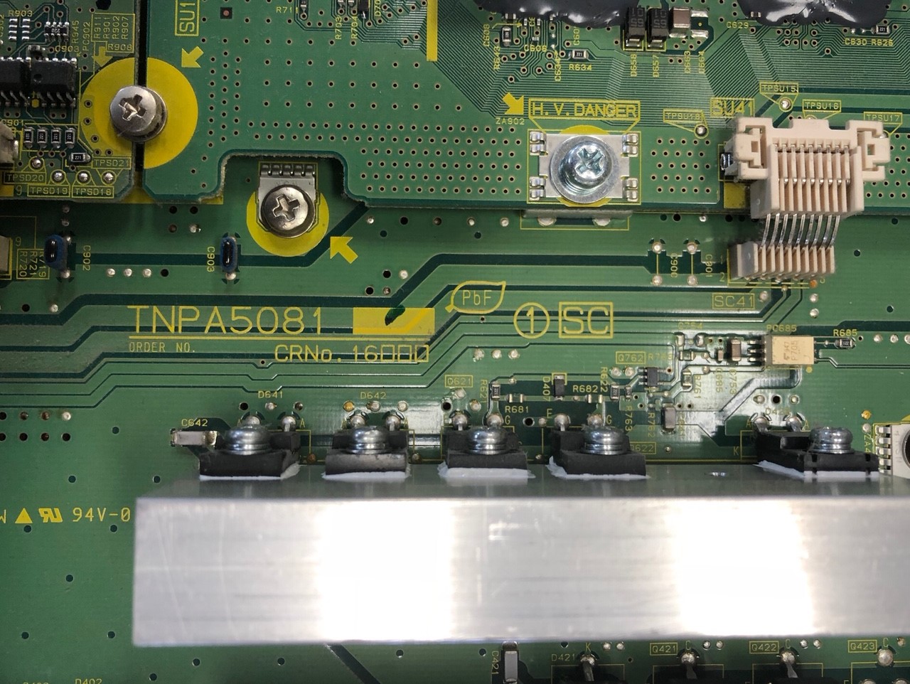

                Hi, I've diagnosed a shorted SC board, but I'm struggling to identify which TNPA5081 I have. Meaning, AH, AK, AY, etc? Does it matter?
                My board doesn't have anything in the yellow square, where I notice other boards do.

                  Replaced the SC board, and the SS board...TV is working again!
                  But the black is not black, there is "snow". Does that indicate another failure, or did I need get all the ribbon cables properly reconnected?
                  Should I post this question in a different thread?

                            Woo Hoo! Just fixed my first TNPA5081
                            I had a few snags. first attempt failed as I did not detect 2 shorted smd transistors which fed the inverter chip. Result of that was flash of light, and pop. The only casualties were the inverter chip I replaced and the 3.9k 1/8w resistor.
                            2nd problem is these Toshiba IGBTs which have 2 variations and I'm getting no feedback from the post.
                            I'm in 2 minds, sub the replacements in the board and see if it works or leave it alone given the amount of hours I've put in.
                            This is the list of parts replaced.
                            IC16501 M81737FP FET driver
                            IC16521 M81737FP (only one failed but replaced both)
                            Q16402 DG502LW shorted
                            Q16403 DG502LW shorted
                            Q16421 DG402RP shorted
                            Q16422 DG402RP shorted
                            Q16661 RJP63F3A shorted
                            IC16773 TC7SH14F, Toshiba , Schmitt inverter ,marking HA
                            Q16701 MMBTA92 NXP (7E W) shorted
                            Q16702 2PD601ART NXP (C3 W) shorted , these I cannibalised from the first board as they cost stuff all but have to order large quantities and I was so close to fixing it I could'nt wait to get one going.
                            Q16021 30F125 ®
                            Q16022 30F125 ® only one had shorted on each board. Have not located this version transistor so one board has become a donor for these
                            Q16441 Q16452 45G128 ® & 45G128 ended up fine.
                            On the first board, IC16724 5V 78M05 is shorted, the 5V line on the matching buffers was also short.
                            Not on this fixed board it was fine, so to the other is fine.
                            I hope someone out there can help me out with the IGBTs.
