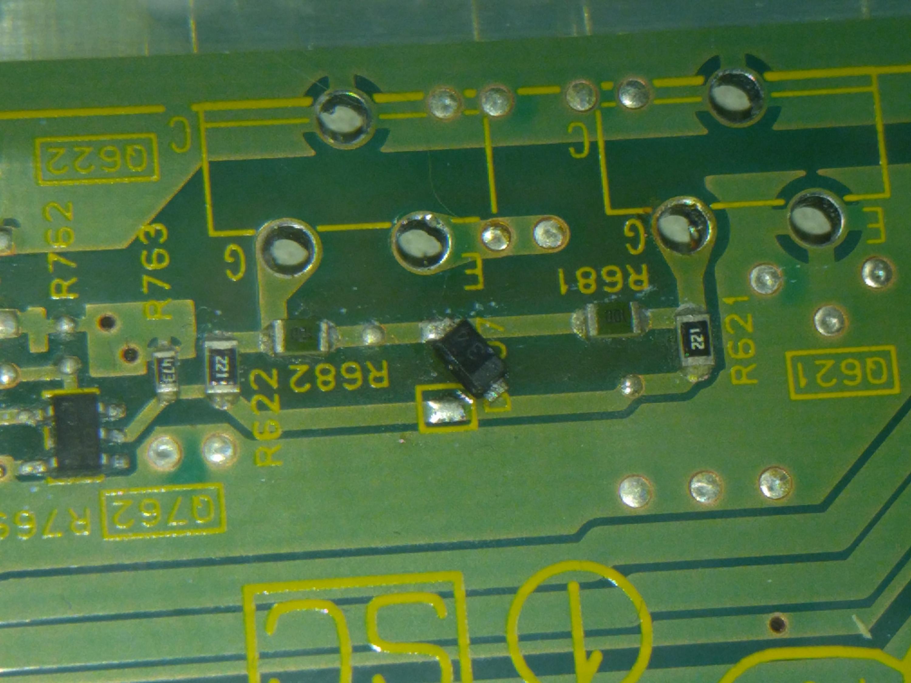

            Here's a picture of the RJP63F4A that I have received.
            I am also wondering if I might have made a bad parts substitution?
            I used this part for D461 & D462
            Original Part # RF2001TM3SW ( Do you have any information on this part?)
            Part # I am using RF2001T3D (FAST 300V 20A)
            The plan right now it to test every component on the board I will be removing all transistor to test out of circuit. Maybe there is another leaky transistor like I found on Q608.
            Anyways keep the feed back coming it helps just in case I missed something.

                            Here is a picture of the D790 & D407
                              TC74VHC541FK, TC74VHC14FK are OEM number for the 14 & 20 pin devices. problem is the package and I've looked pretty hard. To my knowledge only Toshiba make them and some of these lines are becoming obsolete out of production too. Example the HA Toshiba schmitt invereter but TI have a direct replacement.
                              Got nothing on those diodes as I've never needed to touch them. Q441 & 452 are 45G128 but one may have a R stamped on it
