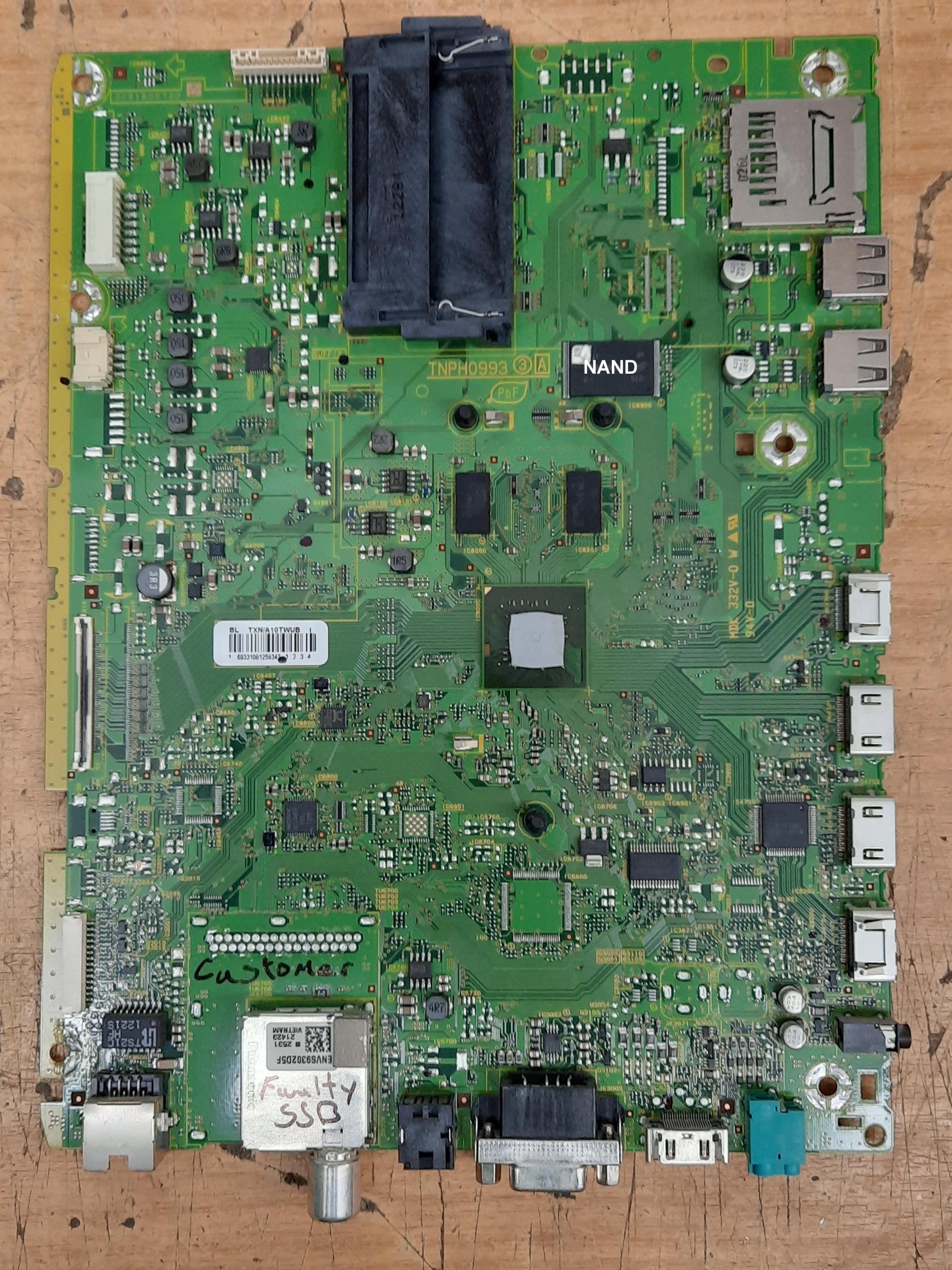

    Hi all
    Issue with this set is that after a few minutes of working , the remote control & on board functions stop working .
    Current software version is 1267-10402 , which i assume is the latest available , as i cannot get set to take an upgrade.
    Managed to obtain a working main board , which has same software version .
    Transplanted the TSOP 48 NAND chip , IC8900 ( 29F4G08ABADA ) from the working board into the faulty board , which now is working .
    This proved NAND chip is the problem , in the form of corrupt data.
    Used my TNM5000 programmer to pull data from the good NAND , then programmed up a new blank .
    All i get with the programmed chip is a constant flashing standby LED .
    All i can think of is that Panasonic have partitioned off some of the data & protected it , so that it cannot be copied.
    Can anyone help , as this is about as far as my knowledge on software goes .
    MAIN BOARD DETAILS
    PART NO - TXN/A10TWUB
    PCB NO - TNPH0993
    LG DISPLAY - LC470EUN ( SE ) ( M2 )

    According to the datasheet for that NAND flash, it contains a special one time programmable area that cannot be erased. In order to program or read from it, you must use the special OTP commands.
    Perhaps your programmer is not reading this area from the working flash and therefore not writing it to the new chip.
    I don't know enough about that programmer to be able to tell you if it can access the OTP area or not. I have always just rigged up my own programmers using a microcontroller or FPGA board. Perhaps you could rig something up to read the OTP area of the working chip and compare it to the blank chip you programmed.

            Hi
            In answer to the first question , these boards are quite rare & it took me a month to find one .If i require another in future , it may not be available .
            In answer to second question , chips are from a very good source . I also tried programming the original chip .
            I suspect as stated in previous post , that the one time programming portion of chip cannot be read by my programmer .
            First time trying to pull date from a Micron manufactured chip .
            Also thanks for the offer Canadaboy . If it comes to it , i'm quite happy to pay for your services .
            May be another way round issue , as i have discovered that there is a later firmware upgrade available than the one installed on TV , therefore might try that first .

                Thanks very much for your input .
                May have solved the issue .
                Had a Panasonic SD card , that i probably ordered from China some time ago.
                Formatted using FAT system , then loaded software .
                Powered TV , inserted SD , as per instructions , but set wouldn't recognise it .
                Started again , this time formatting with FAT 32 .
                Powered on TV , then was prompted to upgrade from 1267 to 1269 .
                Software now updated .
                Need to test for a while , but looking good .
                Would normally expect to be locked out after a few mins , but still working .
                Will test further & update post .
                • nomoresonys
                  • Jan 2013
                  • 12276
                  • U.S.
                  Re: Txl47e5b , panasonic nand chip advice
                  Ok, so it just needed pairing.
                  • zen
                    • 511
                    No , there was a later update for the set , that i wasn't aware of .
                    The software is written to the chip i had previously been messing about with .
                    I fitted the original chip with issue back onto the board , then upgraded software via SD card.
