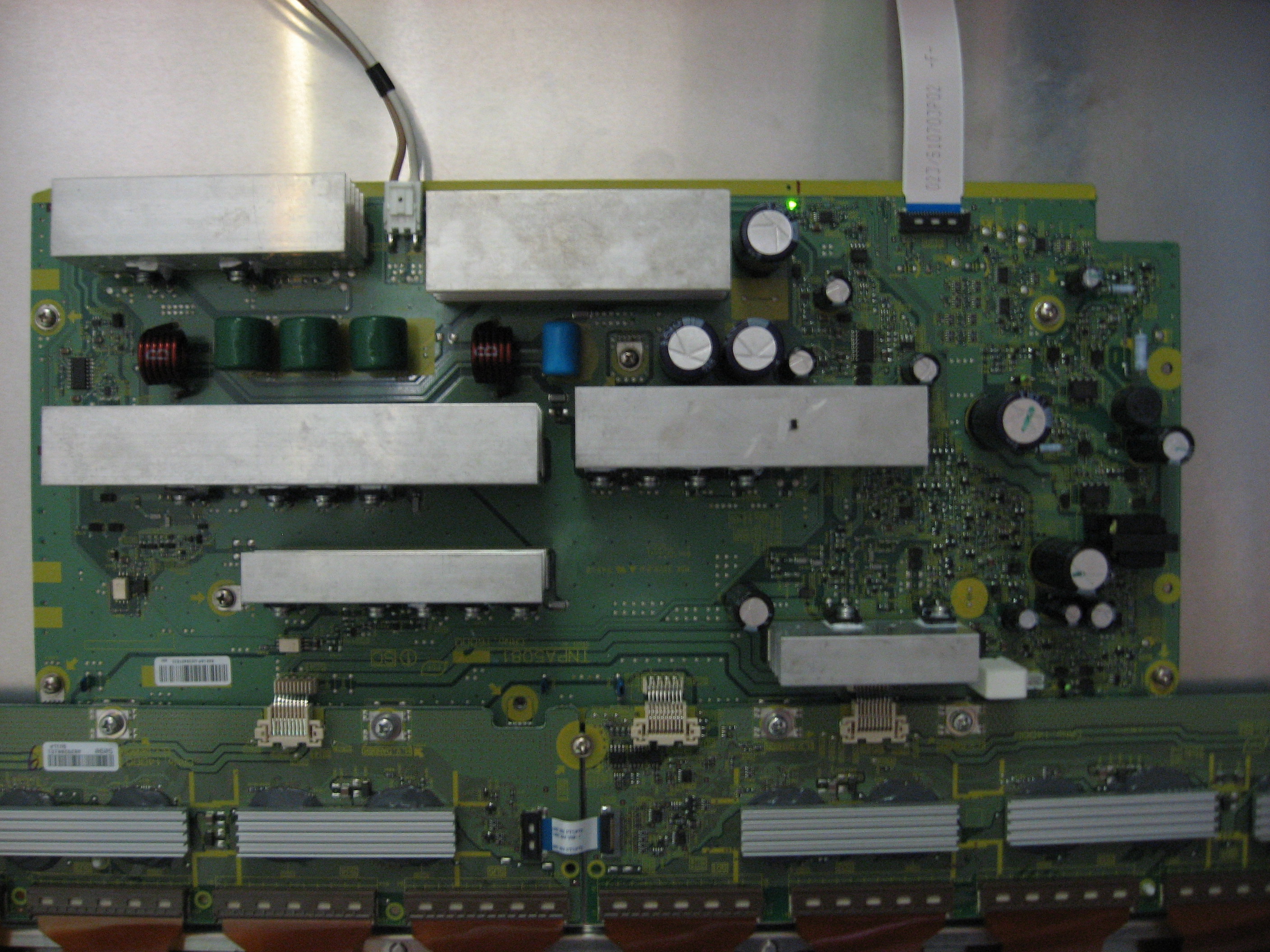

      Woo Hoo! Just fixed my first TNPA5081
      I had a few snags. first attempt failed as I did not detect 2 shorted smd transistors which fed the inverter chip. Result of that was flash of light, and pop. The only casualties were the inverter chip I replaced and the 3.9k 1/8w resistor.
      2nd problem is these Toshiba IGBTs which have 2 variations and I'm getting no feedback from the post.
      I'm in 2 minds, sub the replacements in the board and see if it works or leave it alone given the amount of hours I've put in.

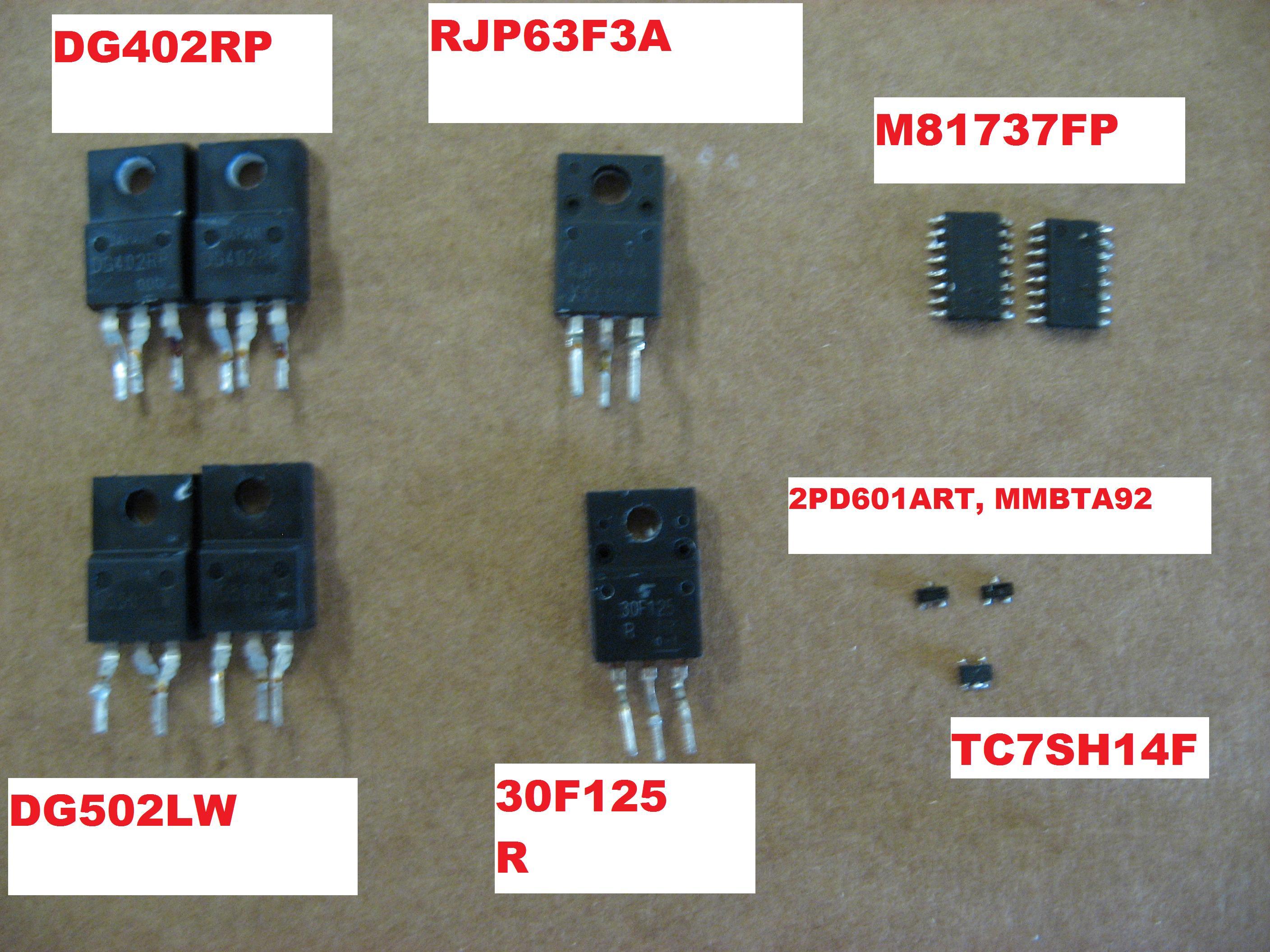

      This is the list of parts replaced.
      IC16501 M81737FP FET driver
      IC16521 M81737FP (only one failed but replaced both)
      Q16402 DG502LW shorted
      Q16403 DG502LW shorted
      Q16421 DG402RP shorted
      Q16422 DG402RP shorted
      Q16661 RJP63F3A shorted
      IC16773 TC7SH14F, Toshiba , Schmitt inverter ,marking HA
      Q16701 MMBTA92 NXP (7E W) shorted
      Q16702 2PD601ART NXP (C3 W) shorted , these I cannibalised from the first board as they cost stuff all but have to order large quantities and I was so close to fixing it I could'nt wait to get one going.
      Q16021 30F125 ®
      Q16022 30F125 ® only one had shorted on each board. Have not located this version transistor so one board has become a donor for these
      Q16441 Q16452 45G128 ® & 45G128 ended up fine.
      On the first board, IC16724 5V 78M05 is shorted, the 5V line on the matching buffers was also short.
      Not on this fixed board it was fine, so to the other is fine.
      I hope someone out there can help me out with the IGBTs.

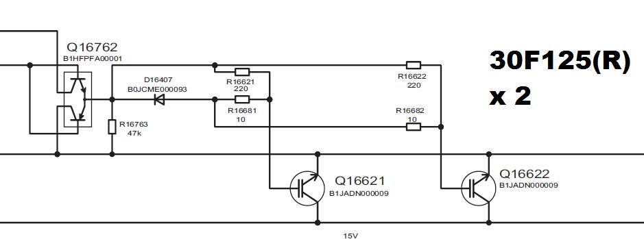

          The hitch is the R marked 30F125 and I've got no response to my post.
          I may just try the standard 30f125 and see how it goes.

              No, I believe it's electrically different. The SS board has both R and no R versions onboard. Panasonic have different part numbers listed for each.
              They react differently when tested.
              I'm suspecting it has an inbuilt diode and it's to help with reliabilty but it's the sort of thing an engineer would know more about.
              It would not surprise me the standard version would work but at what expense for durability?
              I can only guess and presume, hoping there's somone out there who has a deeper level of knowledge of IGBTs and there applications.
              The schematic symbols give no clues of any difference.

                Got the part number wrong 30F125 ® is B1JADN000009
                Just looking at the 45G128s, they both have identical circuit setup resistors and cap so I'm thinking what i have will work. One is R, the other no R?
                The only thing I can think of is the 30F125s are paired so I wonder if that has anything to do with the different versions.

                  Huh. Yes, that's more than possible. I notice the non-R version usually has an external diode. I think that replacing them all with "R" versions would pose no hazard, if you could source them. Perhaps Toshiba have similar equivalent semis available?

                    My problem is the reverse. I've purchased all non "R" versions, originals were "R".
                    Anyway, just fixed another. Have taken the risk and used non "R" 30F125 in this one and it works!!
                    We'll see how it goes as I'm going to leave this in the TV for research.

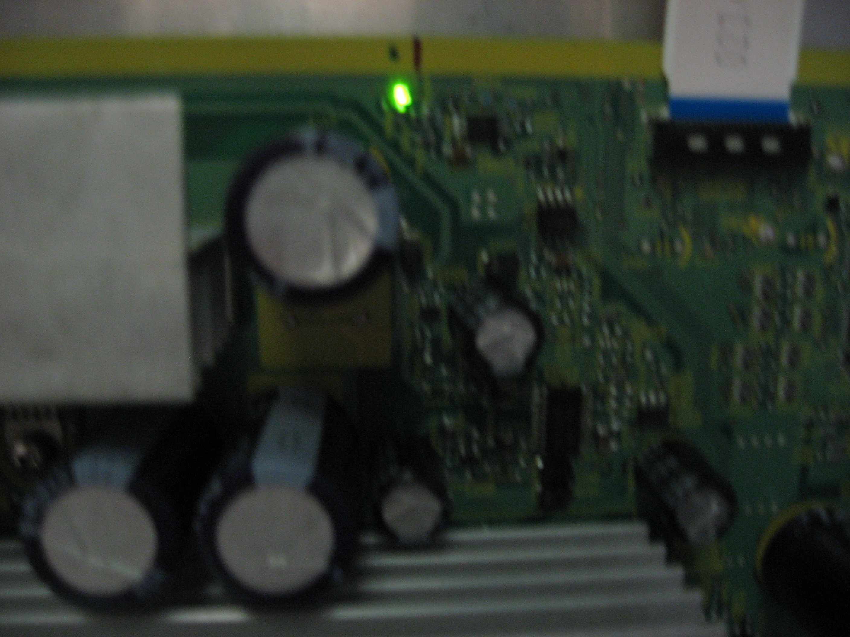

                    This one was much cheaper in parts. This is the purchased faulty board.
                    5V line on buffer board short.
                    Q16021 30F125 ®
                    Q16022 30F125 ® only one had shorted . Replaced both with non "R" I purchased.
                    IC16724 5V 78M05 is shorted, pilfered 5V reg from a dead samsung buffer board. Same package but up a level for current output.
                    FET driver ICs were good.
                    Blurry picture as I have the shakes.

                        If there's a spot for a diode (e.g. next to the IGBT) it would probably be good to install one. Maybe a 250V schottky, if available.

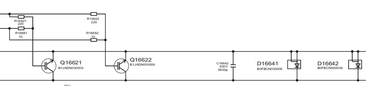

                            There's 2 , Rohm RF2001 TM3SW Fast Recovery Diodes as part of the setup so maybe I have nothing to fear?
                            I just had a quick look through RS and stuff me this kind of device is $20 a piece.
                            Dead boards are valuable for stripping then. probably why new genuine I've seen $400 price tags!
                            Have not found exact specs but suspect 300V 20A which makes sense since the 30F135 is a 330V 30A IGBT.

                              Interesting... You can most likely use any 250V (>Vsus) or higher fast recovery diode. Current rating isn't that important.
