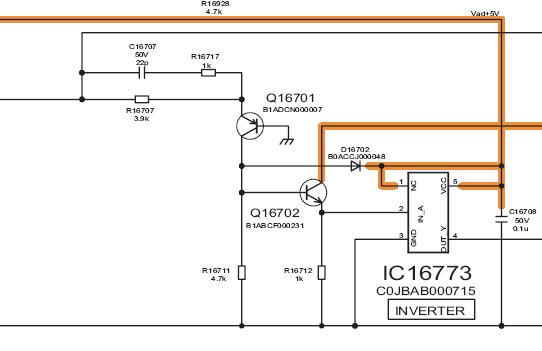

    I've got 3 of these boards now and had no luck finding somone with a good one so I'm biting the bullet and going to have a go at component level.
    I've worked out most of what i think is failed when I stumbled across a reading across the 5v reg IC16771 VAD +5V between gnd and out of 5.2ohms. The other 2 boards have 2 & 8 ohms.
    This seems too low and would exceed what the little reg would handle I believe.
    Through elimination I've tracked it to what I believe is a 5pin, 2 input NAND gate. It has a marking "HA" which I believe I've tracked down as a 74HC1G00GW, SOT353 .
    I've confirmed out of cct the resistance between gnd and Vcc to the same 5.2 ohms and there is no longer that resistance present on the 5v reg.
    Just looking for advice or confirmation of my findings. Does anyone know what you'd expect to see across the nand gnd/Vcc?
    If I do get lucky and get one going I'll be adding all my research down the track.
    The pictures are one out of the manual & the other is from the datasheet for what I believe this is.

    You'd expect to see more than a kohm between Vcc and GND so it's definitely bad. Question is why did it go bad. A logic gate is pretty reliable. Perhaps something on what it is connected to shorted to a higher voltage like Vsus.

        May have jumped to a conclusion too soon. just looked at some inverter cmos logic chips at RS and they have the exact pinouts. I was thinking they labelled NC as it was not used(pin 1) But the case is marked HA?
          Re: Panasonic sc tnpa5081 rebuild
          It's an inverter, not a NAND. Something like 74LVC1G04.
            Cheers, I'm leaning that way too although no idea what spec. I'll check it out.

              Ok I've found this on only one board shorted. D16790 markings 34 and I think it might be this diode pd3s120l,
              What do you think? Is this simply cct protection? The way I see it if it was removed the cct would work.
                  Looks like a transorb (TVS) to absorb spikes on 15V line.

                          Confirmed, IC16521 short or 6.2ohms across gnd/vcc. Diode now checks ok.

                            Tom, I ordered that 74LVC1G04 from RS and arrived today but last night I believe I found the correct item.
                            Toshiba TC7SH14F, marking HA, Schmitt NOT
                            http://home.zcu.cz/~ronesova/index.p...uitem=tos1gate
                            I think the 74LVC1G04 should still do the job or should I try and get the Toshiba which are out of stock at RS until early march.
                            Any thoughts?
                              The normal inverter doesn't have Schmitt tendencies, so it might pick up more noise. I would suggest a Schmitt substitute.
