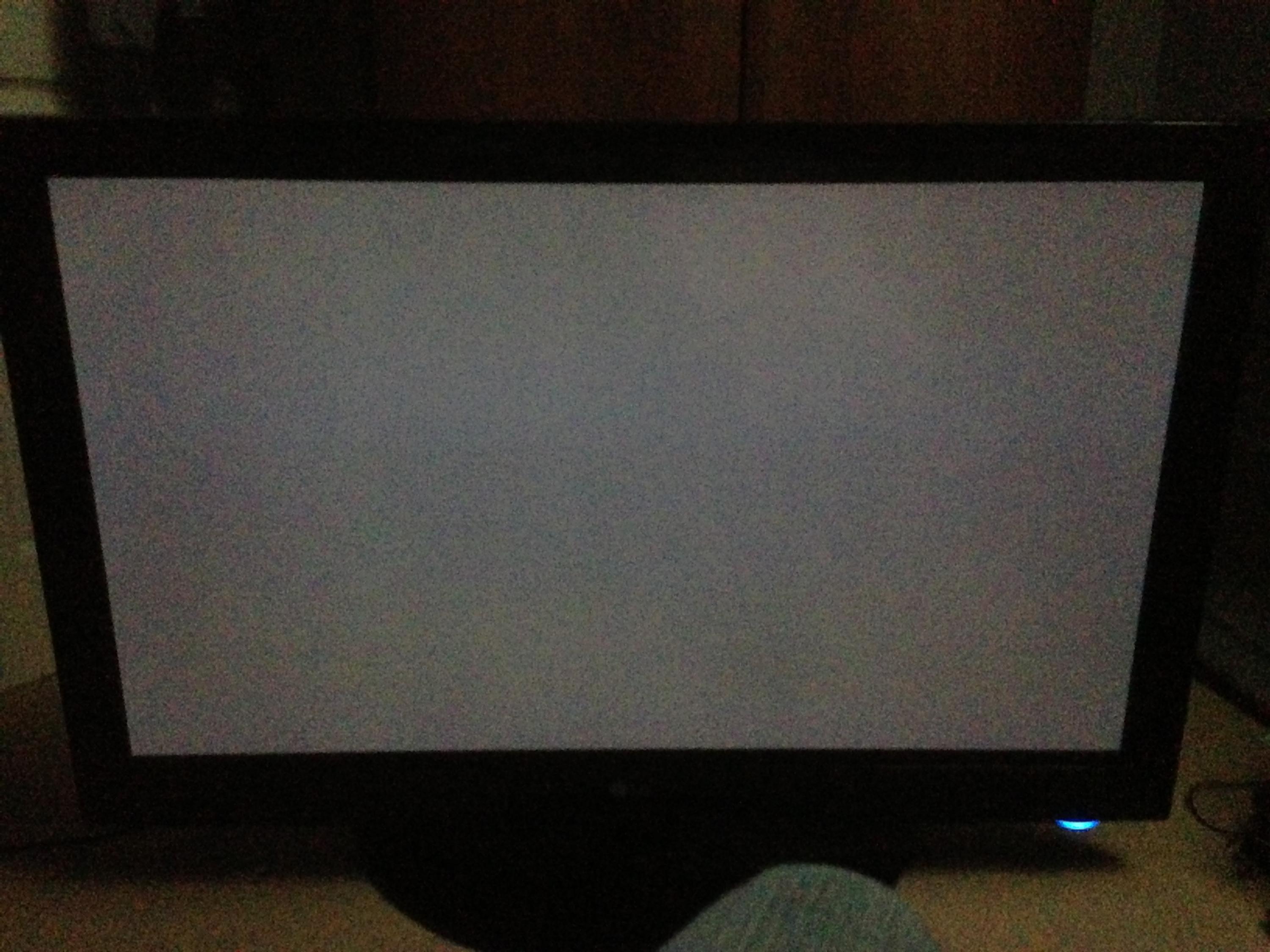

    Hi can anyone help me at all ive got a lg 42pq3000 plasma tv here when i switch it on i get no picture its just glowing as you can see in the picture i get like a snowy sound like a hissing i no its sound as if i press mute it dissapears please can anyone help me diagnose this problem at all many thanks
    Re: LG 42pq3000 just backlight
    OK, this is a plasma. It does not use a backlight. Each cell emits its own light. But that means the panel, sustain boards and power supply are probably working. Probably.
    Let's rule out the plasma panel, sustain boards and the power supply: Do you see the points marked "EXT_AUTO_GEN" on the control board?
    • Turn TV off.
    • Disconnect LVDS cable from control board (this is the top most black tape connector in this picture: https://www.badcaps.net/forum/attach...2&d=1359559144.)
    • Take a 100 ohm resistor and jumper between the auto gen holes.
    • Turn TV on.
    • The panel should show test patterns - does it?
