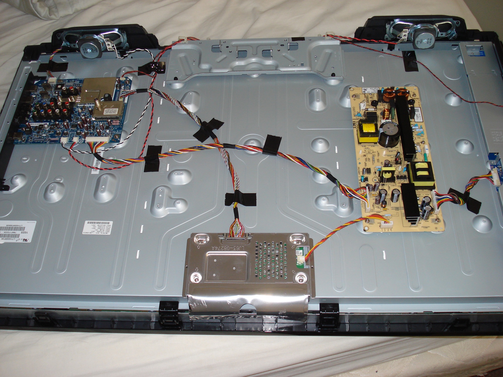

    Tore the tv down to its backlights and watched the CCFLs but they all seem to be working. It would brighten up intensely then dim to half intensity (as when it goes to hdmi input) then shuts off and repeats.

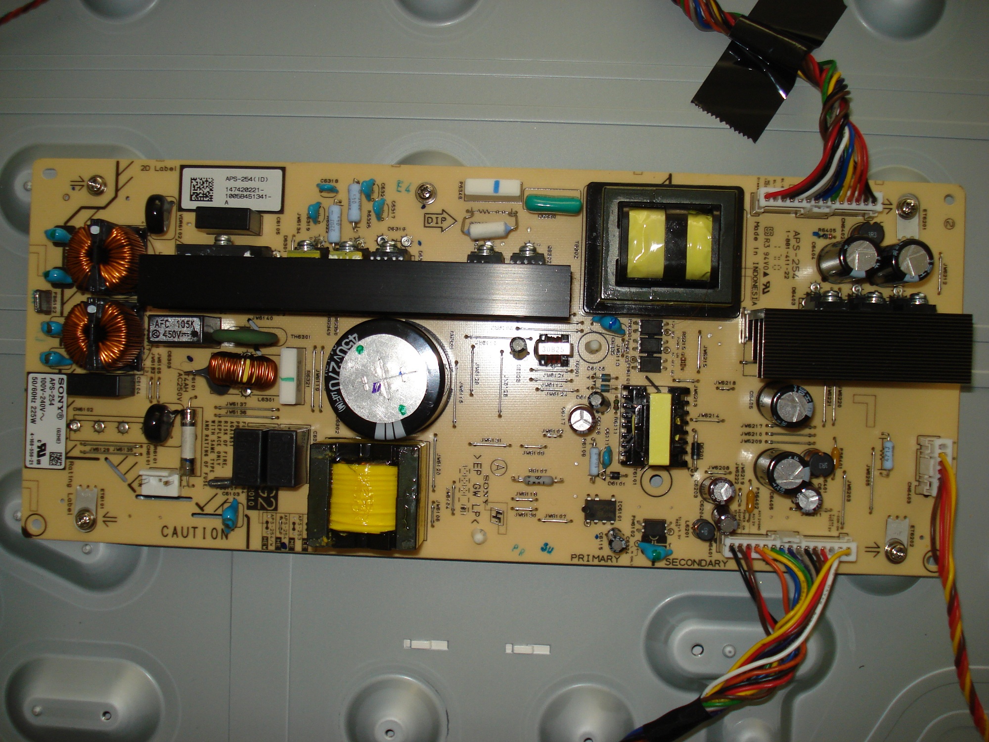

        Can we have a picture of parts of the chassis?

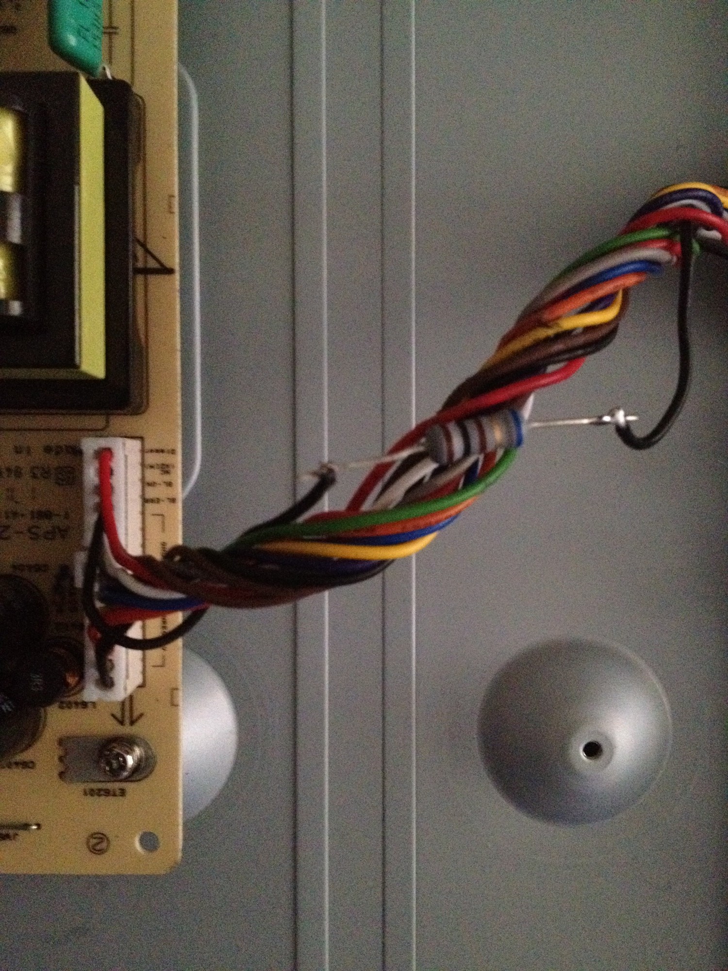

                Can I make a suggestion: Cut BL_ERR and force it low, using a 100 ohm resistor. Then see if the cycling continues. If not, then you need to suspect the inverter board itself.

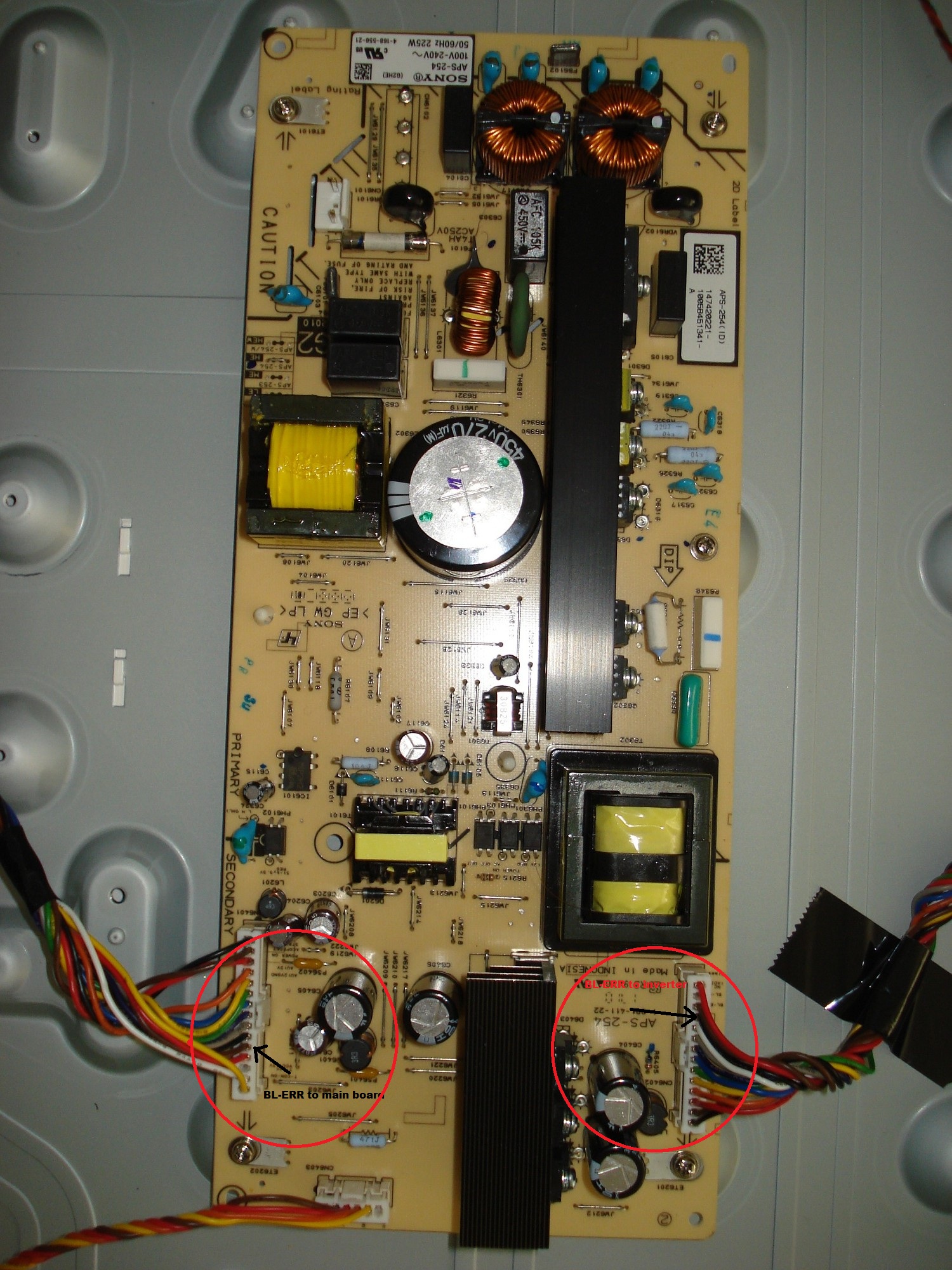

                  Which one should I cut? theres one output going to the main board and one going to the inverter. I'm guessing the one leading to the inverter? I'll have to find a 100 ohm resistor from a salvaged board.
                    Re: 40" Sony LCD KDL-40EX500 Seconds to black (6 blinks)
                    One from inverter to main board; the signal is a message from the inverter saying "houston, we have a problem", main board says "shit guys! let's shut this whole show down" and then restarts.

                      Kind of confused, the inverter board isn't directly connected to the main board. Or I'm guessing it goes through the psu first?
                        Yep, it just goes thru PSU to reduce wiring clutter.

                          Just put the 100 ohm resistor in place. I'm still measuring 3.3V on the BL-ERR though and theres no change at all.
                            On which end is that?
                            The BL_ERR on PSU needs to go to ground thru 100 ohms. Inverter side disconnected. Is this what you have done? But you still measure 3.3V?

                              Ohh okay, it was on the side going to the inverter. So the right end of the resistor should go to ground?
                              • tieny
                                • Feb 2012
                                • 478
                                Alright just grounded it, okay now it turns on normal, sony logo comes up, goes to hdmi input, then backlight shuts off. With a flashlight I can see the input and also when the menu if I bring it up.
                                So the cycling stopped, thus the problem is with the inverter board itself?
                                  Yep.

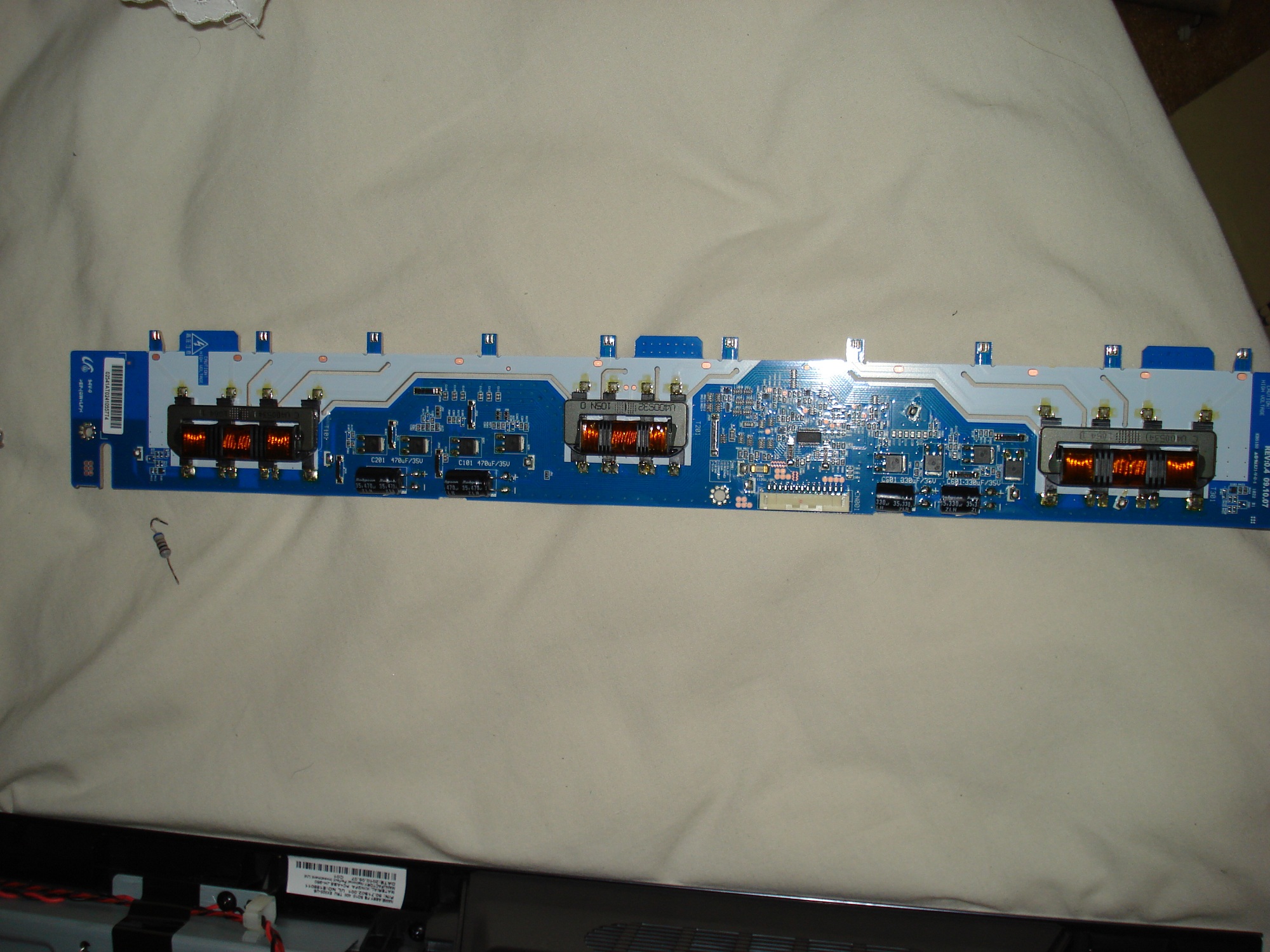

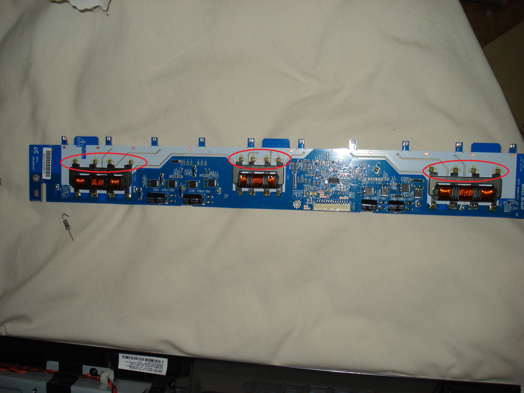

                                  Gonna need a pic of the inverter.
                                  • tieny
                                    • Feb 2012
                                    • 478
                                    Here it is.
                                      OK, I'd suspect the transformers (test secondary resistance); if it's not that, could be the bulbs in the panel.
                                      • tieny
                                        • Feb 2012
                                        • 478
                                        Those are the pins toward the output to the ccfls correct? Do I just measure the resistances in circuit? pins 1-2, 1-3, 1-4, 2-3, 2-4, etc?
                                        I also have an inductance meter.
                                        Heres a video of the backlights when I tore it down
                                        http://www.youtube.com/watch?v=AVvDn...ature=youtu.be
                                        All the lamps seem to turn on fine. Would it still be a bad transformer?
